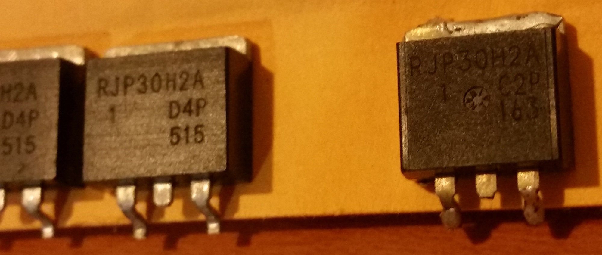

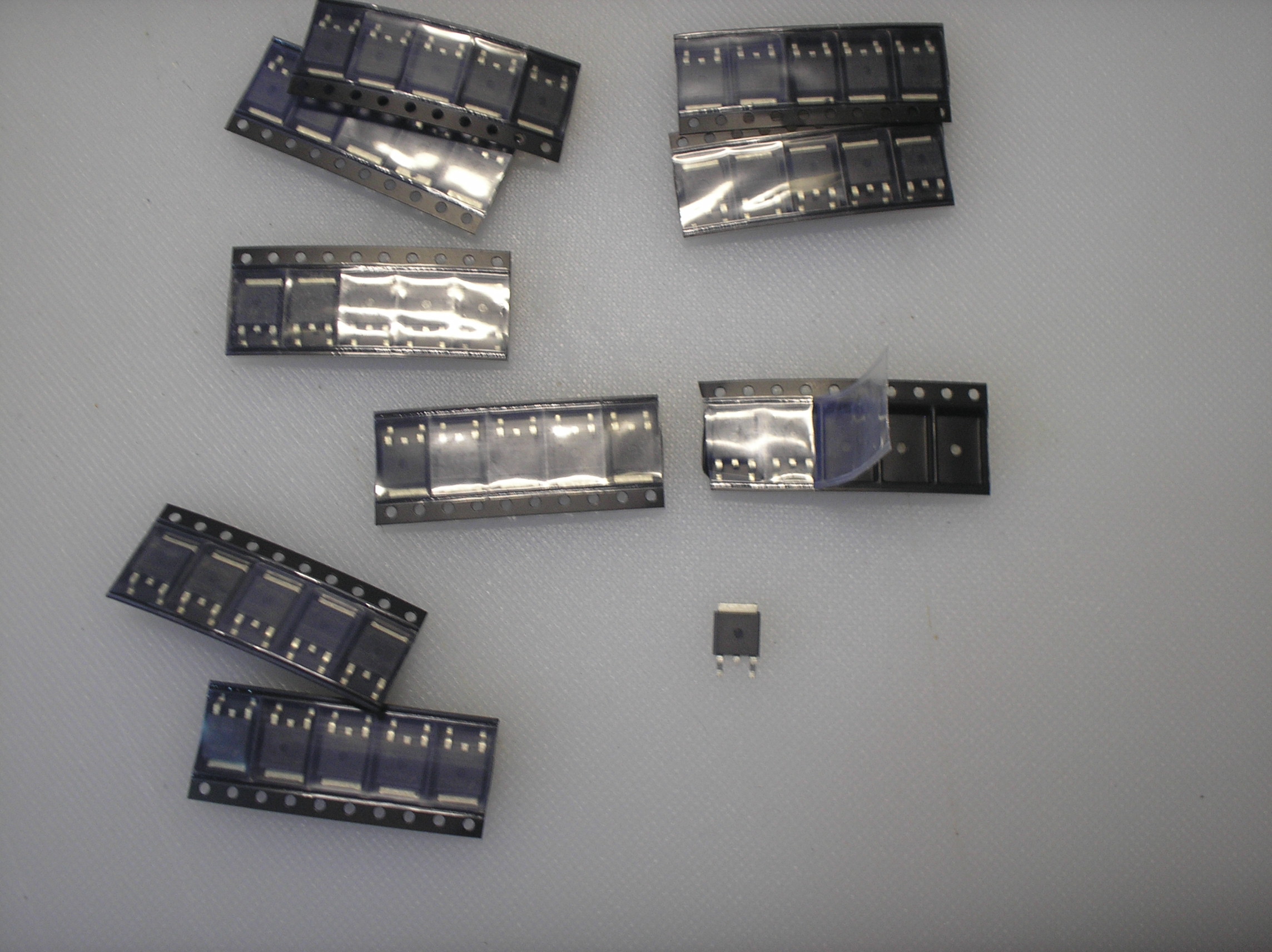

    Another report on some parts I got from E-BEST TRADE.
    Previously they too had fake 30F131 which blew.
    I've used them for buffer ICs , no issue there and also up until now the RJP30H2 were originals.

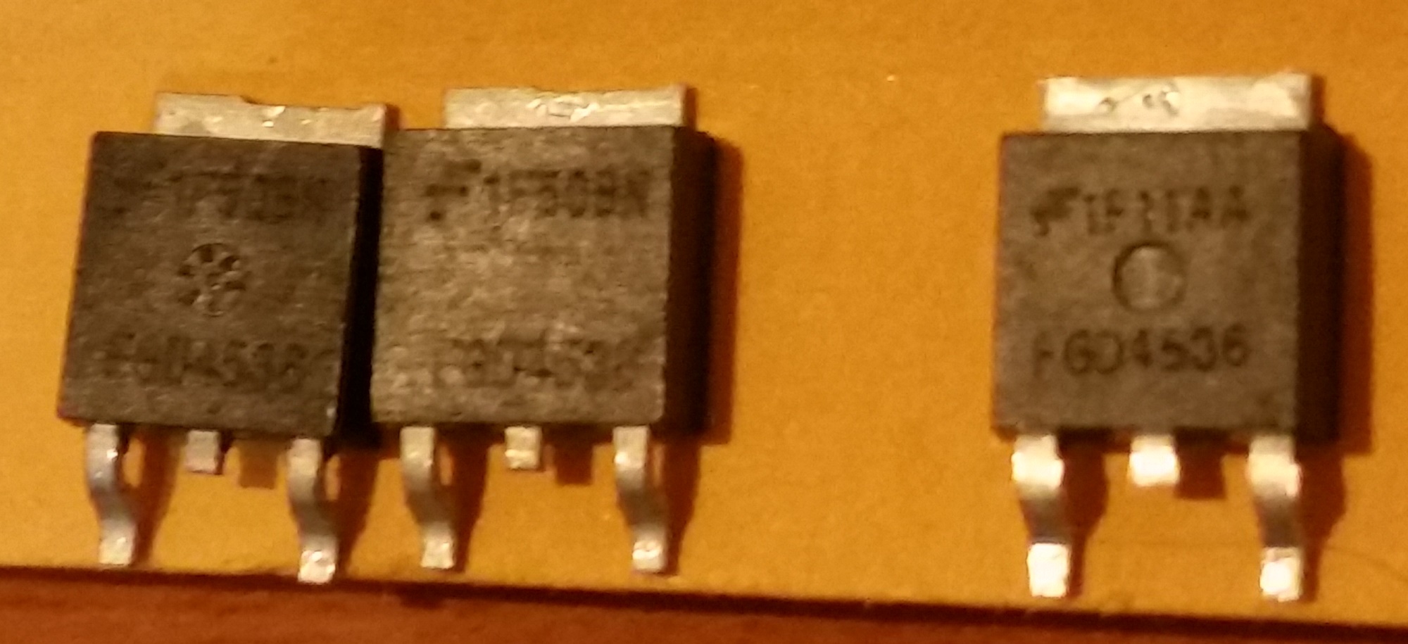

    Not any more. Also ordered 2 x FGD4536 . They too definitely fake and measure quite different.
    Have a good look at the images.

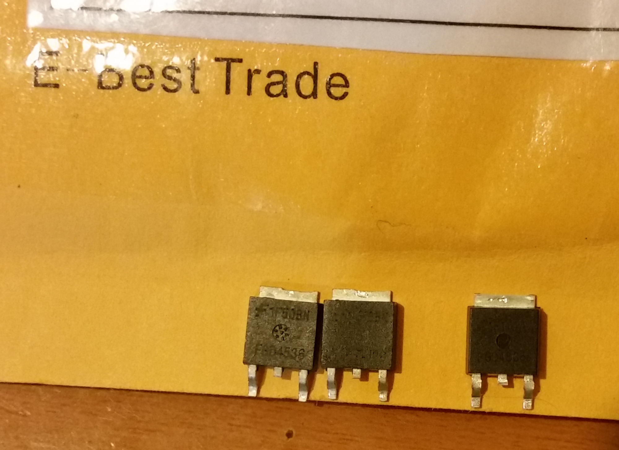

    For the FGDs, the 2 on the left are the same batch number ,one has a centre marking, the other not andthe marking is not of original as seen on the right. Also look at the tab and the notch.
    You can also see the sanding marks and the Fairchild logo also is incorrect.

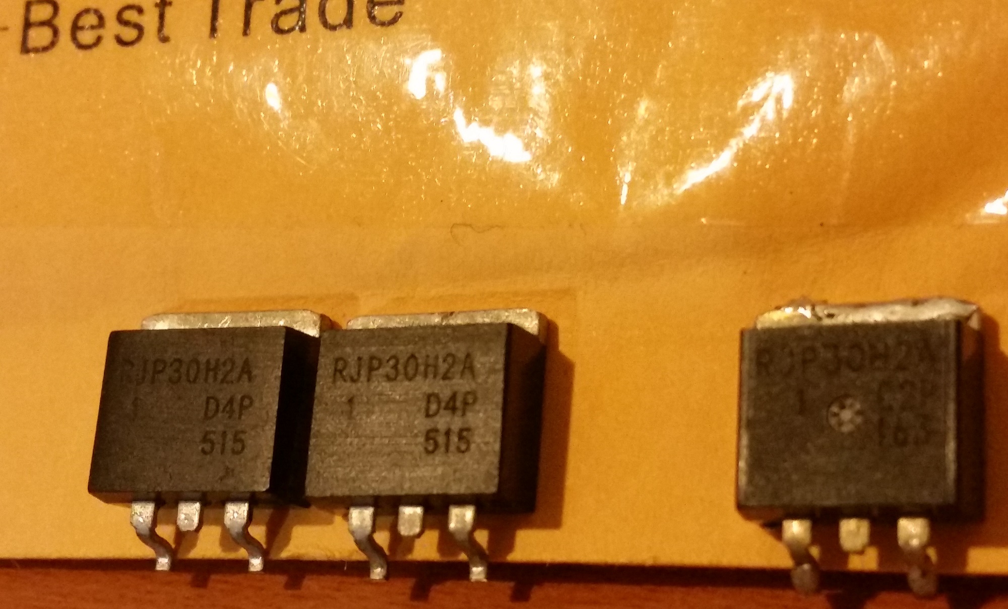

    The RJP30H2, two left supplied and original on the right. Even more obvious the sand marks, missing centre stamp, the edges on the original are cut down where the fakes are not and one is sanded so much the edges have been rounded.
    Most likely restamped parts, I expect the RJP to work the FGD I'm real suspicious.

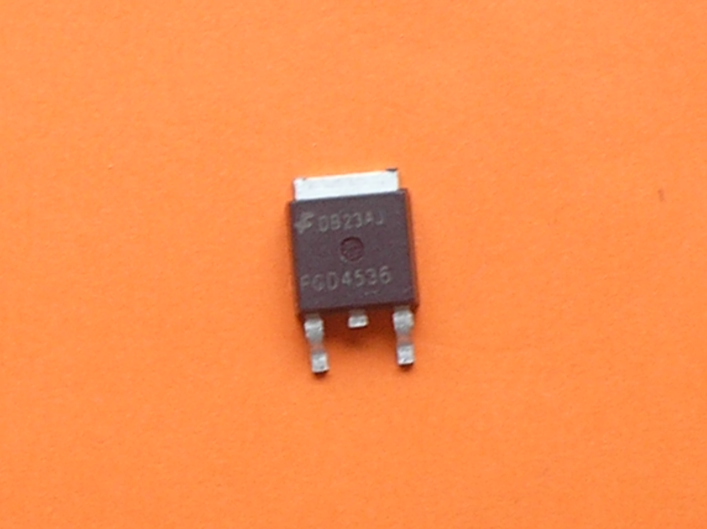

        I have had no problems with the Fairchild FGD4536 I have been receiving , over 15 repairs all good,and have used over 60 of these IGBTs
          what do they look like? items on left or the original on the right? you getting them from china not local?

            Re: Chinese supplied IGBTs
            The ones from mouser all work fine. The ones from china are fake and blow up the sc board.
            The ones from mouser are cut on both sides , the ones from china are not cut.
            I bought them from china because mouser is out of stock and i dont know where else to buy them!!

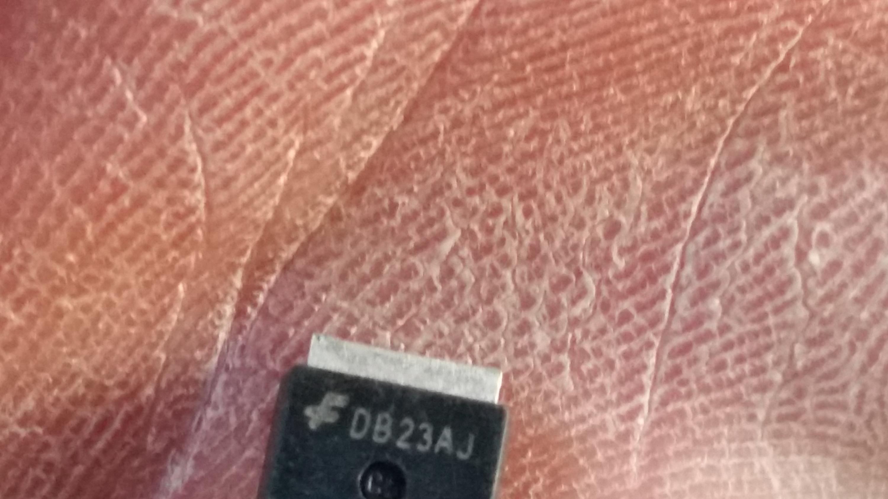

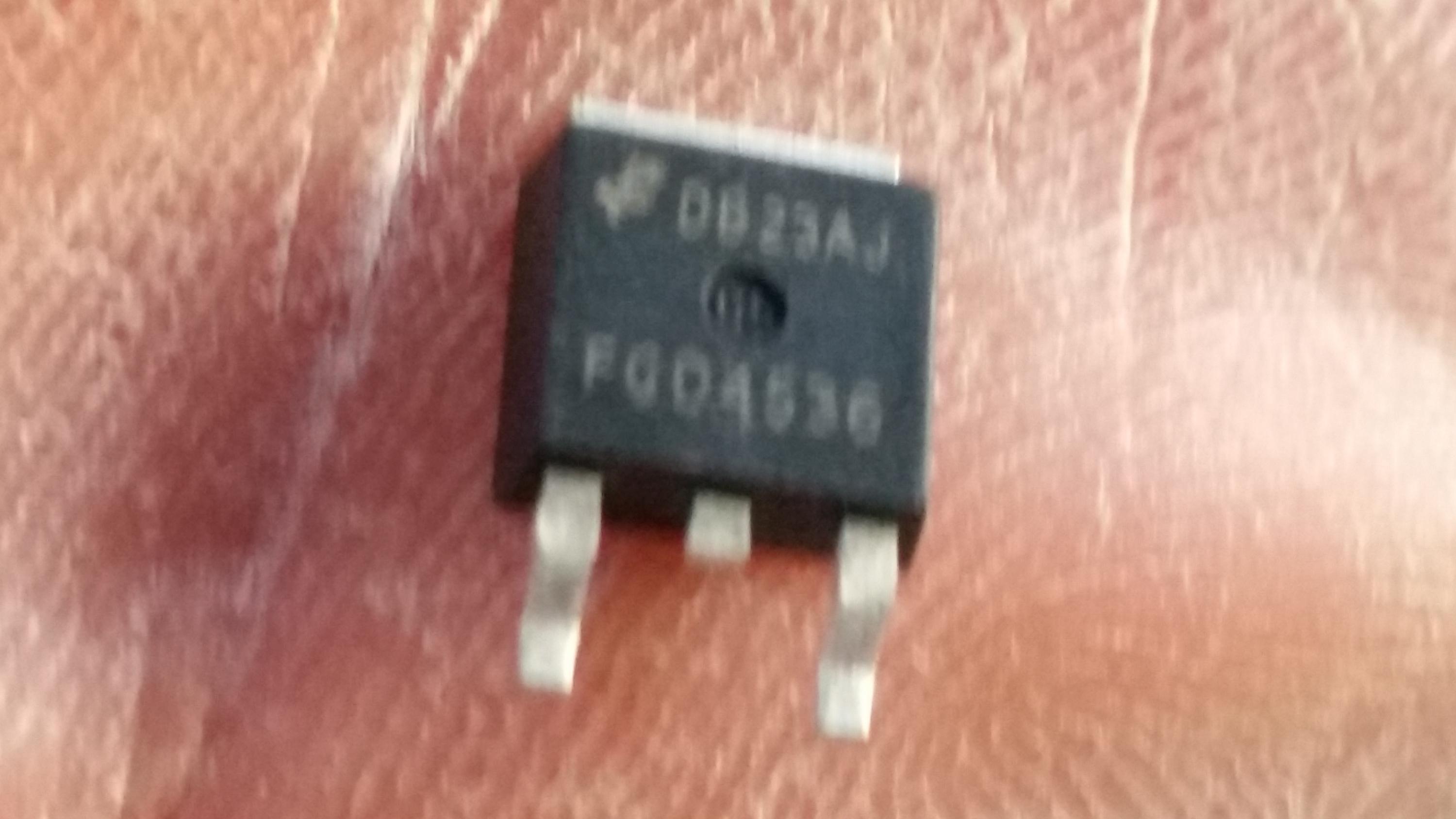

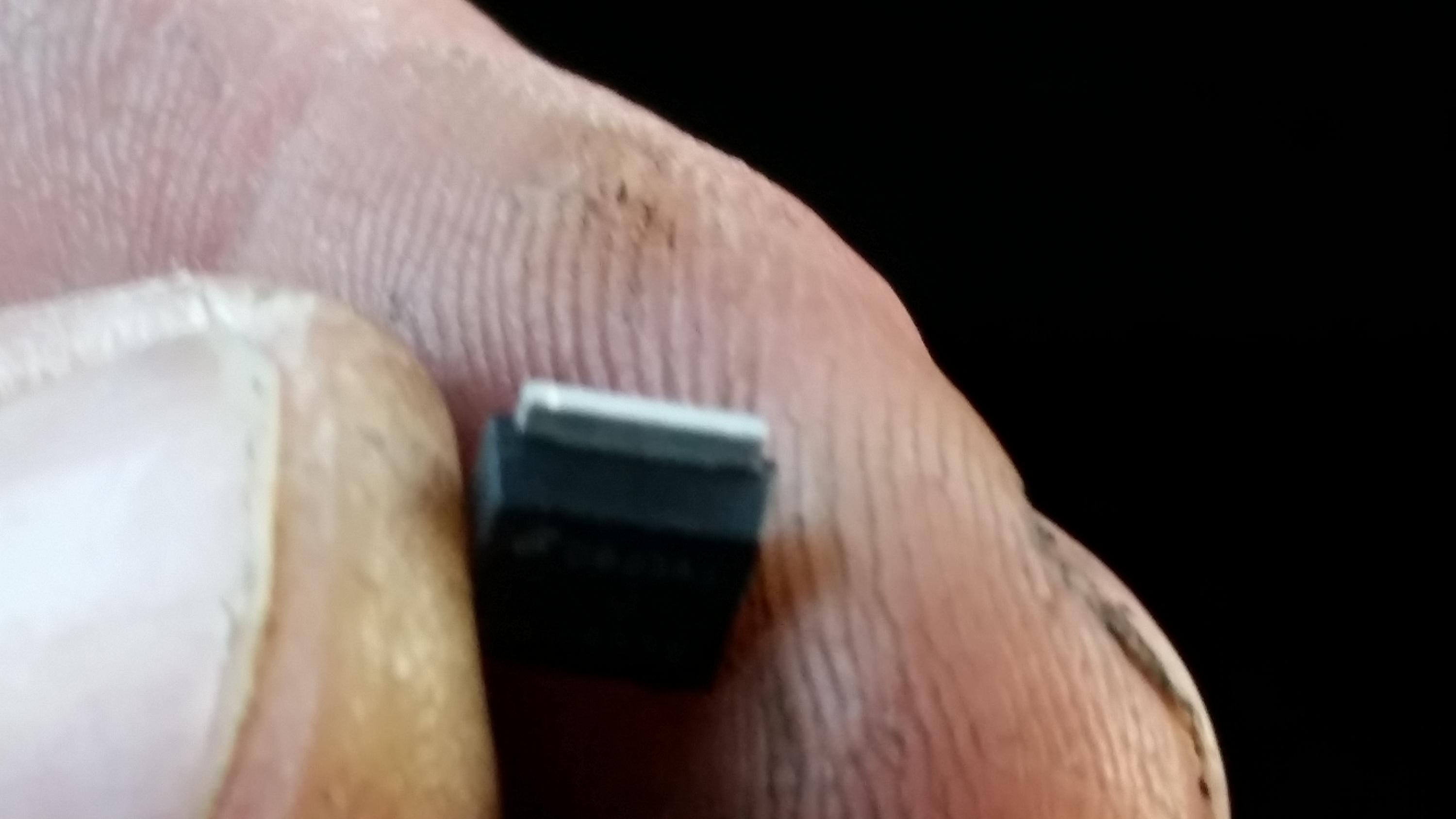

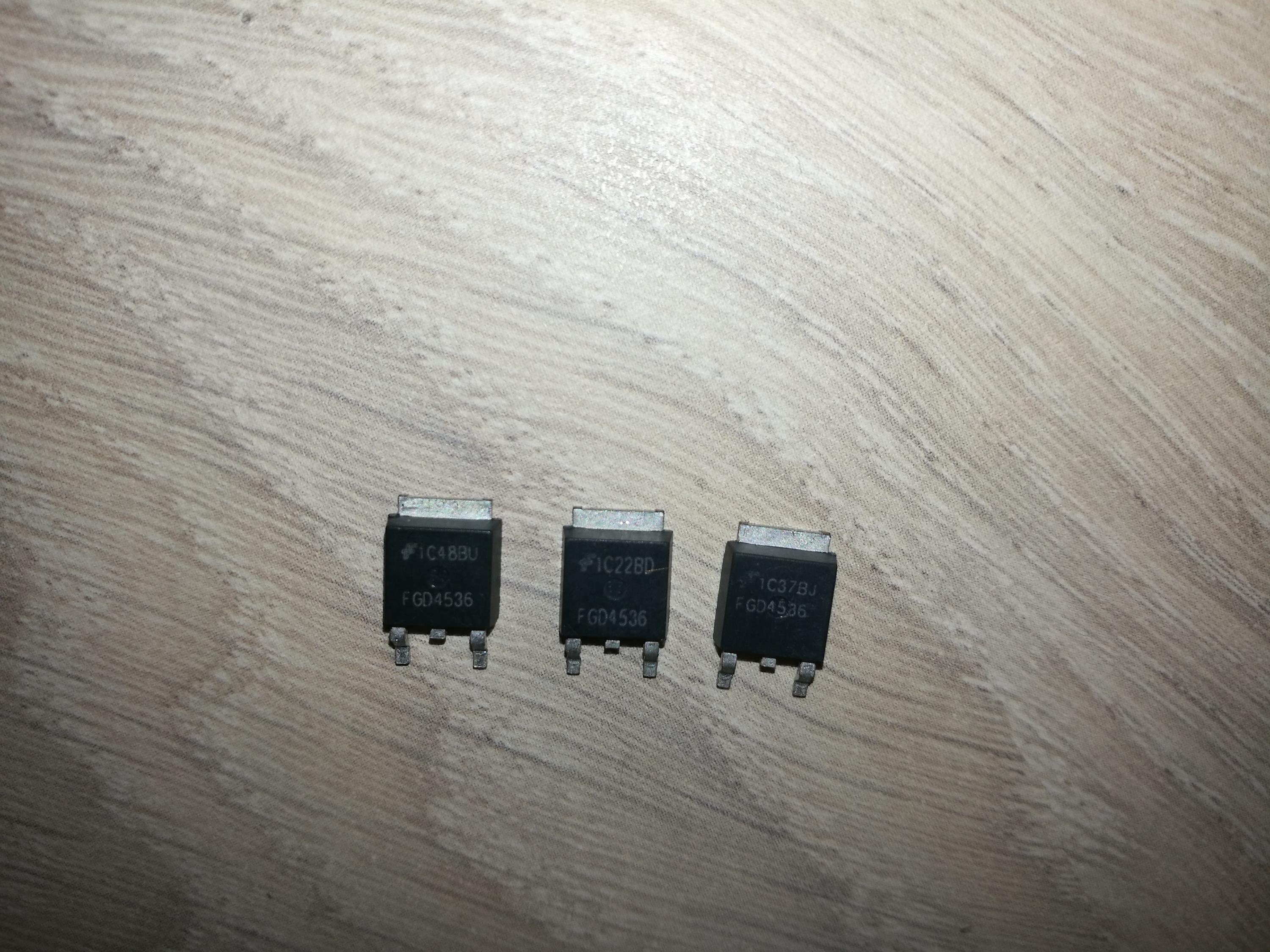

                                    Got a 50VT30 that i want to repair and the FGD4536 from utsource came in.....
                                    Im really afraid to use them just looking at the stamps....
                                    They look so bad compared to the ones from mouser. All 3 on the picture are from utsource.
                                    Anything i can do to check these?
                                      You can try testing to see if they switch on/off ( test IGBT in diode mode, if your meter has over 3v output in diode mode),but the problem with these fakes is not the switching but the voltage and current they can handle when switching and the only way to test that is to use them in a repair, and if they blow they are no good, and if the set runs for a year or two they are good. Looking at your photos these are fake. But I think you know that already
                                      • Moreno83
                                        • Jun 2014
                                        • 2008
                                        • The Netherlands
                                        Grr...thought so! Could you tell me where you buy them? I want to be sure to deliver good repairs.
                                        Will report it to utsource...
