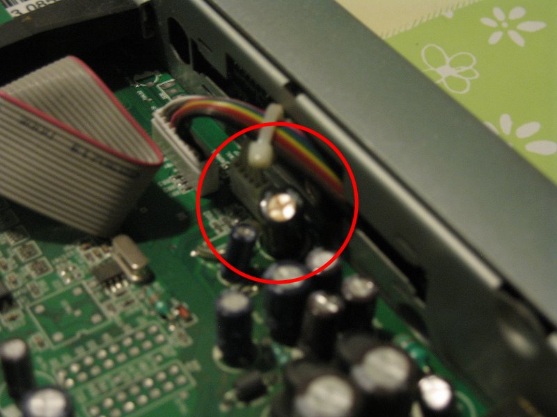

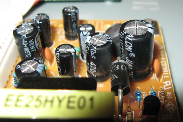

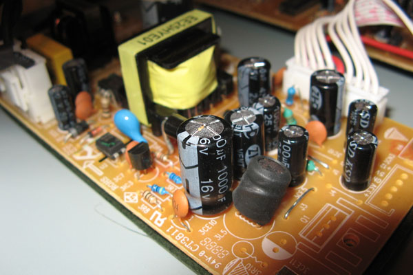

    its a DVB decoder. Even though they still have only 4 channels and the whole thing did not get off the ground yet, this unit already dead with one bulging capacitor in power supply
    1000uf 16v JIALON bulging
    rest of the caps are ZHD and SD KSD but mostly small values. This unit really should have the
    1000uf 16v (1 piece)
    470uf 25v (3 pieces)
    to be a good brand.
    so thats 4 caps only......

    dont have any 25v caps so just replaced the 1000uf 16v which had a massive 5.4ohm esr.....with Rubycon MCZ and working again nice. The 470uf ones measured .10 i am not sure of their specs.
    I wonder how many of these popular machines (its a greek product) ended up in the trash because of one cap.

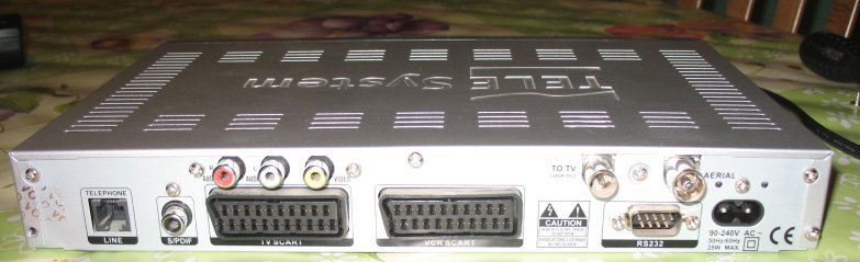

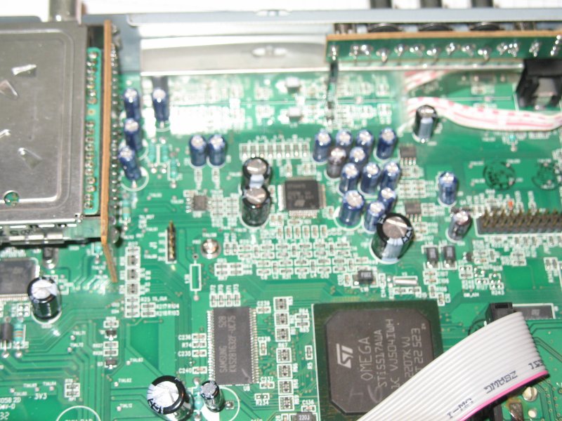

                            it's a strange that this happen to me today after your post but here I am.

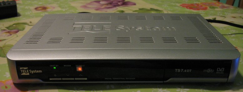

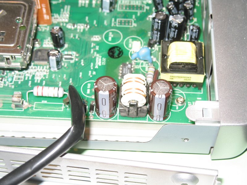

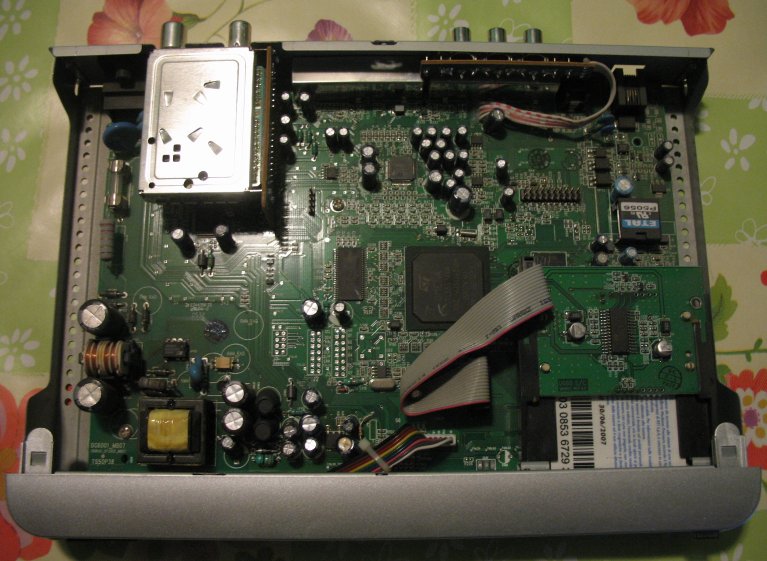

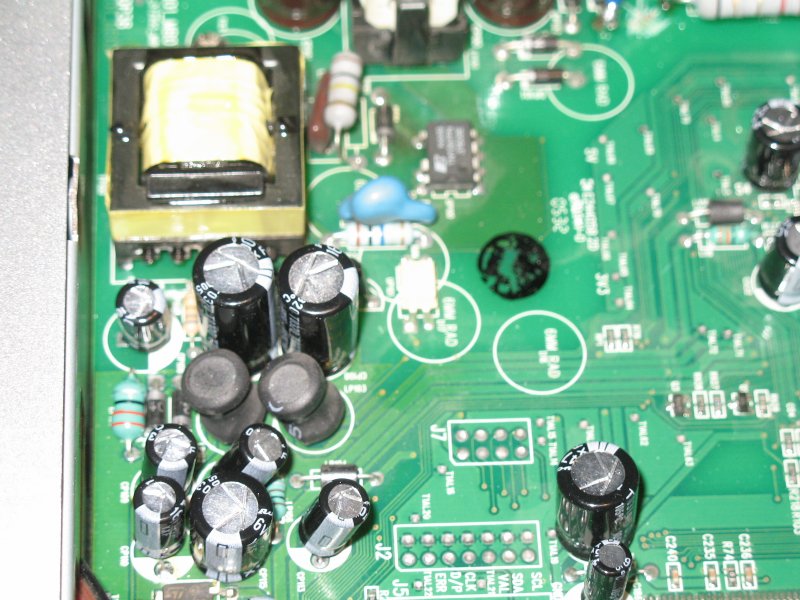

                            Today I went to visit my parents and my father asked me to check his DVB-T receiver and you can imagine what I found: I opened it and I found a Suscon 1000uF 6.3V with some rust on the top. All other Suscon look OK, at least they are not bulged or leaking.
                            The receiver is always in stand by, it doesn't respond to remote control or buttons on front panel.
                            From the pictures here attached you can see a particular way to avoid X2 cap for EMI noise: immediately after the input bridge there is an electrolytic cap, than you find the input inductance and after it the second electrolytic cap. In this way you have to split in 2 caps the bulk electrolytic cap for the PS but you can save the X2 cap which probably costs more than electrolytic cap.
                            The brand is Telesystem and the receiver is built in China
                            I hope it will be enough to replace all caps to make this receiver working again.

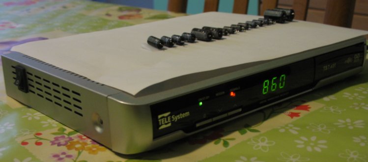

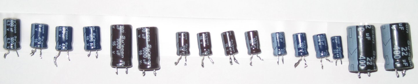

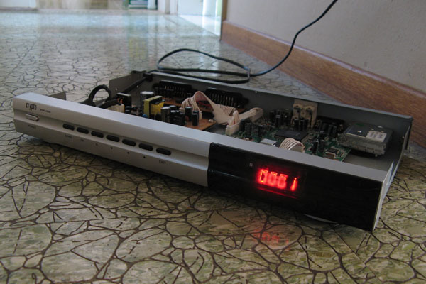

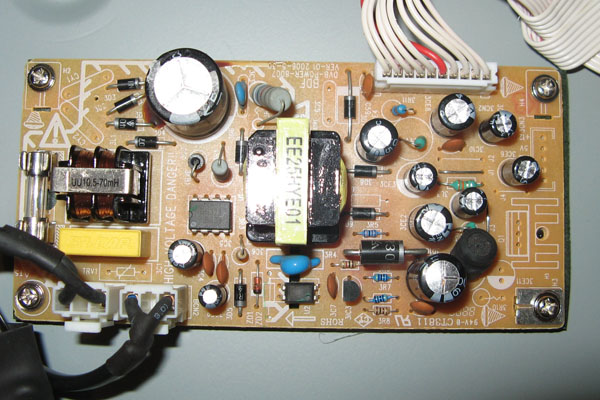

                                  The rusted capacitor was not the worst, here its measured values:
                                  1000uF 6.3V --> 580uF 0.37 ohm
                                  After replacing it, I tried to turn on the receiver but it was always in the same state, so I started
                                  top remove all caps around PS and I measured their values:
                                  1000uF 16V
                                  --> 543uF 0.65 ohm
                                  --> 730uF 0.18 ohm
                                  470µ 16V
                                  --> 328uF 0.49 ohm
                                  --> 376uF 0.17 ohm
                                  --> 384uF 0.19 ohm
                                  100uF 16V
                                  --> 400nF 548 ohm
                                  --> 6.5uF 82 ohm
                                  --> 12uF 40 ohm
                                  --> 16uF 36 ohm
                                  --> 64.74uF 1.24 ohm
                                  470uF 6.3V --> 376 ohm 0.23 ohm
                                  10uF 25V --> 6.6uF 19.2 ohm
                                  220uF 16V
                                  --> 188uF 0.32 ohm
                                  --> 167uF 0.77 ohm

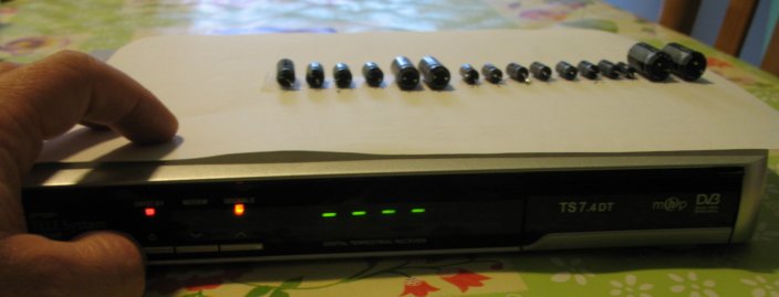

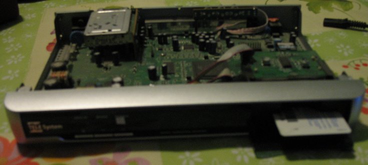

                                  I replaced them and also the 22uF 400V input caps even if they were still good; unfortunately there are a lot of small caps but I didn't replaced them because I have not such values from good brand in my lab.
                                  Now the receiver works... and I hope the Suscon present in the board will last for long time.

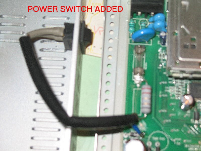

                                  The nice thing I discovered is that it consumes 8.6W when it is on while in stand by the power is ONLY 9.2W .
                                  For this reason I have modified it: I have add a power switch so my father can turn it on only when he need it so saving some energy/money.
                                  Here attached the pics of the shit I removed, the good Rubycon I mounted and the working receiver.
