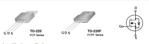

                  #68
                  Re: Samsung LA26R71BA cannot power up
                  mosfet correct type not shorting on the heatsink?
                  Interesting possibility.
                  John_Doe
                  Was the original mosfet a TO-220 as shown in the picture or a TO-220F and did you replace like for like.

                        #71
                        The original mosfet is the TO-220F type. The mosfet I replaced is the FCPF11N60NT and it is the TO-220F with the plastic tab. It is not shorted to the heatsink.
                        I attach the datasheet.

                            #73
                            Are you 100% sure that QP801s Source and Drain pin is not showing very low resistance (<10 Ohms)?
                            RP819 is still showing <1 Ohm?
                            I also expect the QP801S to be rated at 800V or more.

                              #74
                              QP801S: Resistance
                              Pin3 (pos) to pin2 (neg) = 192.3k ohm
                              Pin3 (neg) to pin2 (pos) = 280k ohm
                              Pin3 is shorted to heatsink. Strange?l
                                John-doe
                                Can you confirm that when the NT811S burnt up that the fuse did not blow?
                                What was the result of testing the bridge rectifier between pins 1-3, 2-4 (post #64)
                                There's also an internal diode across D-S of QP801S (see pdf) so can you check with your meter in diode mode across these two pins that the diode is OK
                                The mosfets Source pin is connected to hot ground via RP819 and the heat sink is probably also connected to hot ground which would explain your last comment

                                    #77
                                    The mosfet certainly appears OK
                                    The bridge rectifier is damaged and is why the NT811S burnt up.
                                    Both need to be replaced,
                                    Why this happened is really unclear since the mosfet did not cause it or any fault with DP801 or DP802 so I can only assume that when the mosfet blew the first time it must have damaged the bridge rectifier but blew the fuse before it damaged the NT811S.
                                    Can you check RP816, RP817, RP818, DP804, DZP801 and also if you can measure the ohms value across CP803 but ensure there is no voltage across it.
