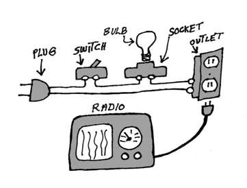

                      I have replaced the mosfet and PFC IC. Is there any final check before I power up?l

                        Re: Samsung LA26R71BA cannot power up
                        maybe build yourself a dim bulb tester this may save your new parts from blowing again.
                        I have enclosed a picture of a basic dim bulb tester circuit.
                          What wattage should I use for the bulb?
                            i usually use either a 60 watt or a 100 watt.
                              I connected the TV to a dim bulb tester of 60 watt and disconnected to the main board.
                              The bulb lighted up with about half brightness. There is 5.2 vdc standby and all other pins at CNM801 are 0 vdc or almost 0 vdc. It seems to be the same when I first started out.
                              The voltage at the big filter cap is 323 vdc.
                              Any suggestions?

                                          If the bulb light more brightly when you connected PS_ON then I would say that your PFC circuit is now working.
                                          Check the voltage again. Without PS_ON voltage at large capacitor = 323V and with PS_Connected voltage at large capacitor = ???
