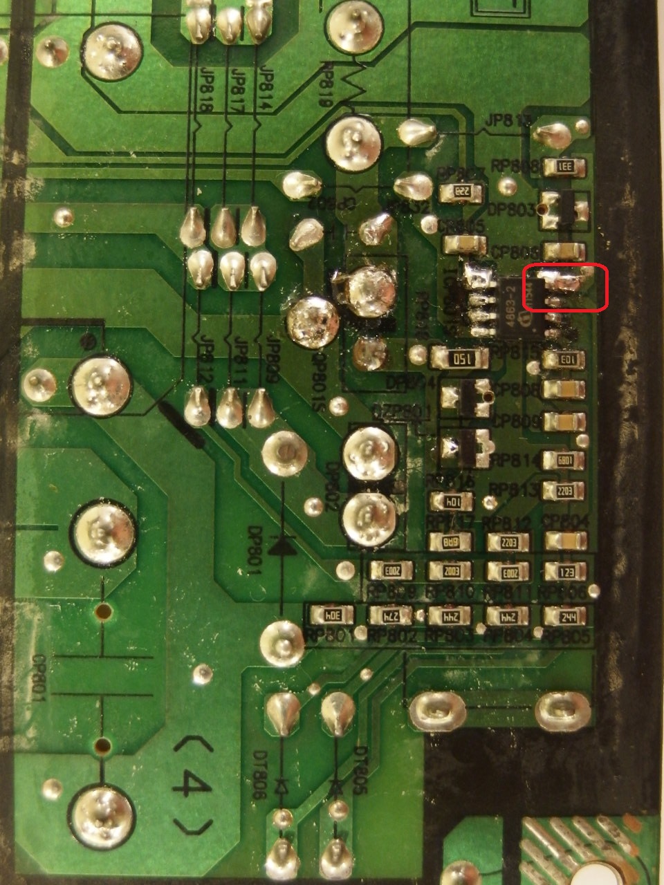

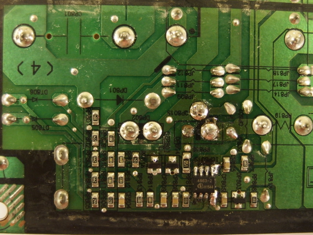

                            Can you show a close up photo of ICP801S

                                  Pic of ICP801S

                                      Could you check with your meter the resistance between Pin 1-2, 2-3, 3-4,4-5 etc for ICP801S and what is that shown on pin 4?

                                          Re: Samsung LA26R71BA cannot power up
                                          Resistance
                                          Pin1 to 2 = 8.3M ohm
                                          Pin2 to 3 = 5.6M ohm
                                          Pin3 to 4 = 12.25k ohm
                                          Pin4 to 5 = 22.4k ohm
                                          Pin5 to 6 = 22.1k ohm
                                          Pin6 to 7 = 99.5k ohm
                                          Pin7 to 8 = 106k ohm
                                          The thing on pin4 is solder.
