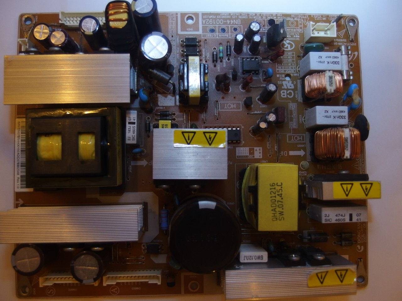

    I have a Samsung LA26R71BA that cannot power up. When I press the power button on the remote, a red light on the TV lights up and then off.
    Where should I start to check?
    Thanks.
    John
    Re: Samsung LA26R71BA cannot power up
    So are you saying you are not getting DCV output at all, not even the standby DCV output?
    Did you check all the fuses?
    I also see bad brown glues that must be removed.
    There are also lots of threads for this BN44-00192A, just search the B.C. forum for them.
      The fuses are all checked and ok. There is 5v on the standby pin. All other pins has 0 volt.
      Which are the components I should check on the power board?

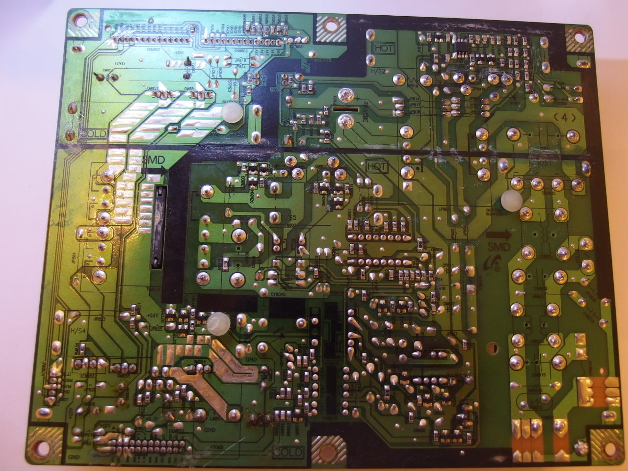

                            I cannot find ICP801S on the power board, although it is on the schematic. I can see ICB801S.
                              https://www.badcaps.net/forum/attach...7&d=1478264760
                              It is 8-pin SMD located at top right of the board as shown in the picture.
                                Thanks budm for the location. I was looking at the wrong side. Stupid me.
                                I blown the fuse FP801S. Got to wait for a few days for the new fuse.
