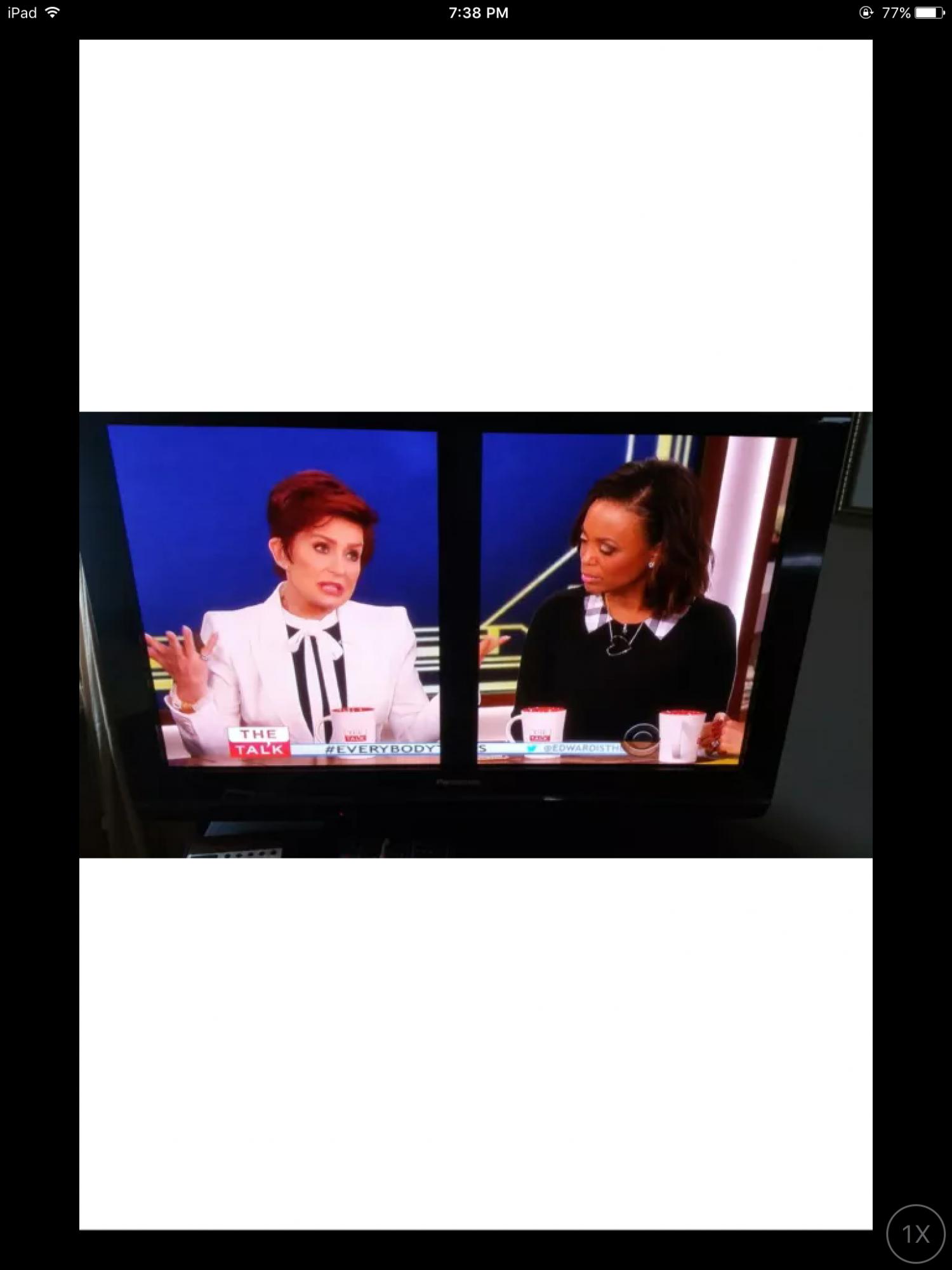

    Howdy gang!
    The symptoms: I'm pretty sure it started as a 7 flashing light error - but now - the tv will stay on for about 15 minutes until powering off and retreating into 8 blinks
    have searched and found SS board is common problem on these units - tv from 2008! Would like to save it if possible
    Have a little experience and wondering if someone would baby step me through a further diagnosis process - have a cheapy volt meter ---
    here are the pics - please help me correctly identify any testing points and the SS board ---
    THANK YOU KINDLY!!
    http://imgur.com/a/3evUx

      Doubt its the SS more likely the Controller Ic and Ceramic cap fault on the psu IMO.

              Watch this hopefully be of some help, this fault can cause a lot of different errors:
              https://m.youtube.com/watch?v=LjpGKaBt8hg

                Re: Panasonic TH-42PZ80U
                This link has a test you can try to see if its the ss board issue
                http://www.justanswer.com/tv-repair/...ght-power.html
                  Most of the time the IC is good on both "sub boards".
                  I just solder in a new cap on each. Been working for me so far(4 months).
                  You dont have to mount them the way he does it in the video, do it the easy way, small wires soldered to the boards, soldered to the caps, them glue or zip tie to something that stays cool.
