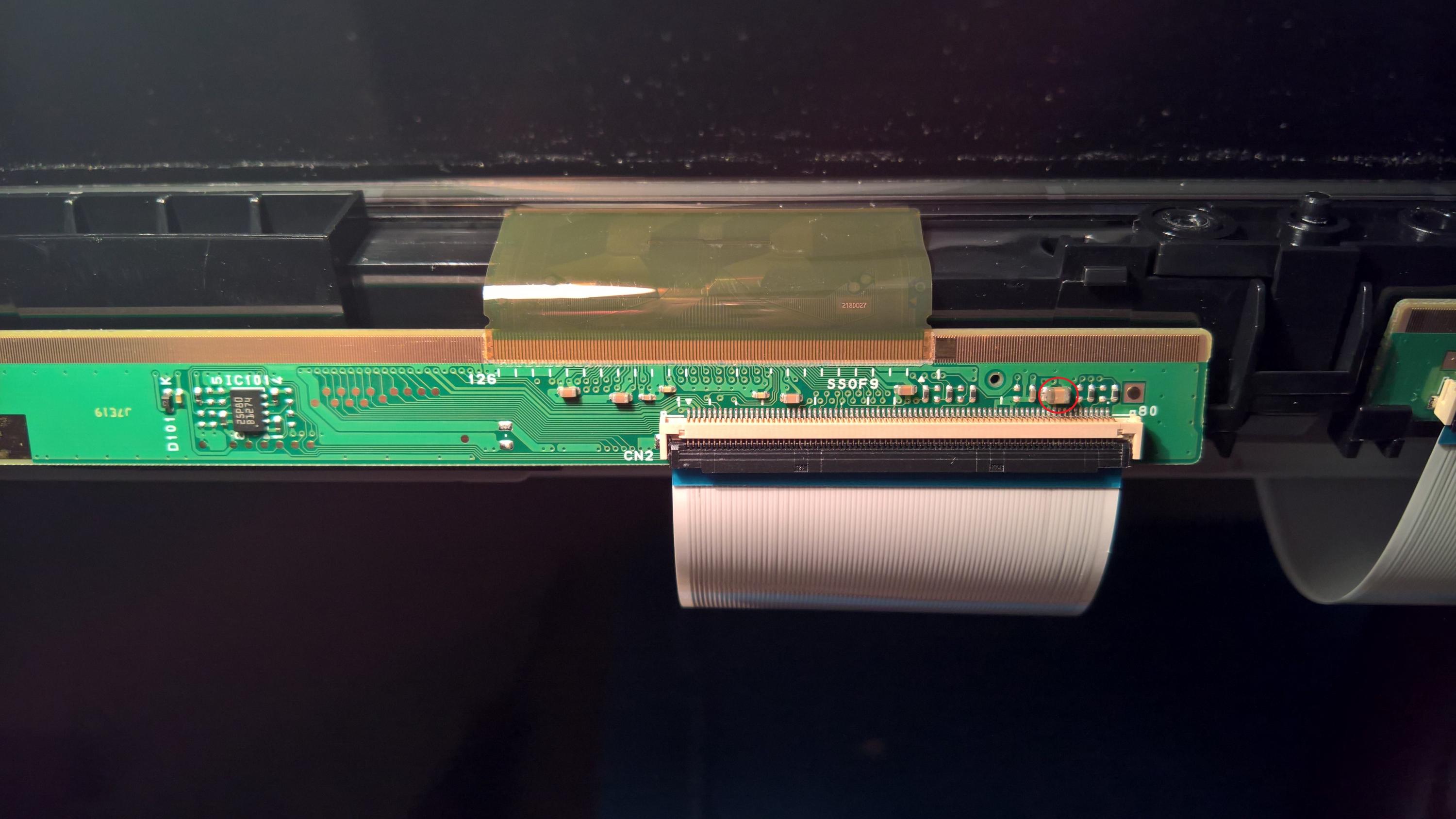

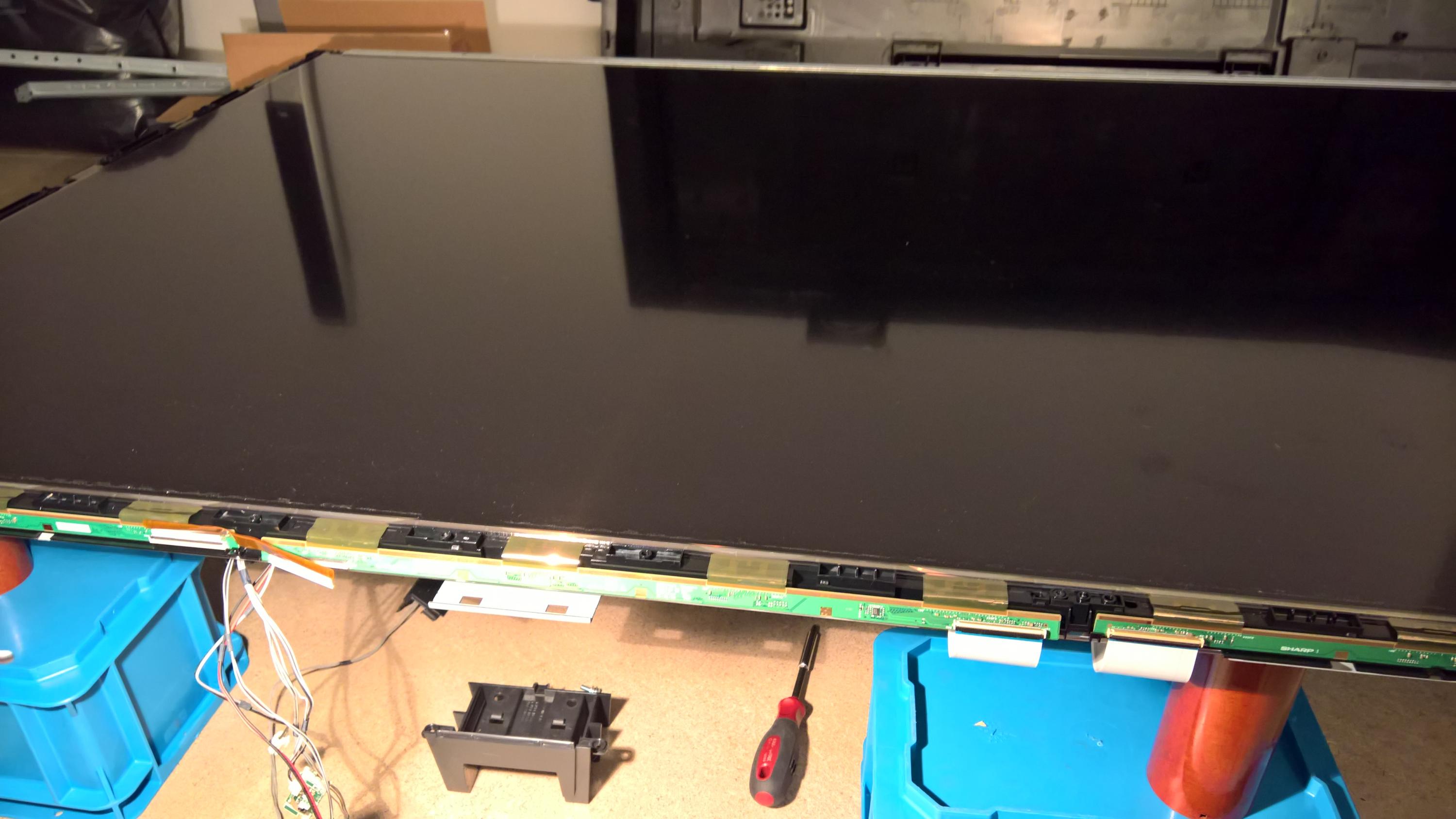

            I have news, I have picked up all the metall parts arround the LCD, now I could check all the taBs! ;-)
            all of them looks good!
            Problem is on the first PCB on the left side.... (see the first picture)
            you see on the right side of this PCB the white ribbon cable is connected at the middle of the TV! and on the left side the kapton ribbon cable is not connected, with this situation the TV does not work.... If I disconnect the white cable it works... so it has to be on this PCB..... right???
            Problem is this are the connectings for the vertical lines so it is not possible to release them without picture losses right?
            But perhaps I have good new.... after the TV shuts down a few seconds after startup a part of this small PCB is hot....
            It is a big small ceramic capacitor... (marked on second picture)
            this capacitor got veery hot very fast..... so easiest would be to change it....
            Does anybody has a Idea what value it has?? I can try to measure the one on the other pcb (which has about the same size) so I can get his capacity... but what is the voltage? 12V so something about 15+V ?
            I have no one here... do you think I can try it without this cap?? or is it better not to power up without it??

              Anyways, you appeared to have isolated the potential problem to the lower left side bottom board... if I understand correctly. :-( because it may not be recoverable as the bottom boards / functions are not removable. In terms of component, since you have similar boards / components across the bottom, as a first check, I would just do some basic resistance measurements on the various boards to compare the component in question. That may tell you something about your "guess".
              Someone here might know how to read the "legend" on the surface mount to determine what its value is.
              One thing about the tabs.... they may not look "bad" but could still be an issue... especially when viewed from the side that your picture shows. The "underside" may show a different story... and some times can be viewed by releasing the board "holder / clips" and any cabling to allow you to GENTLY tip the board over to view the backside of the tab cables looking for heating / burn issues. Further, one might also be able to feel the heat coming off a tab driver / cable with your finger tip.... comparing this test across various tabs.
              In your second picture, I am not so sure that the tab driver doesn't have an issue as maybe your picture shows some sort of markings on the right side of the driver.
              Further: do you have a similar picture of the panel corner where there should be some cabling similar to what you have shown in your picture... that perhaps connects any side boards to the bottom.... this is assuming there are side boards... :-(

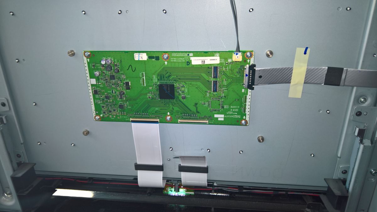

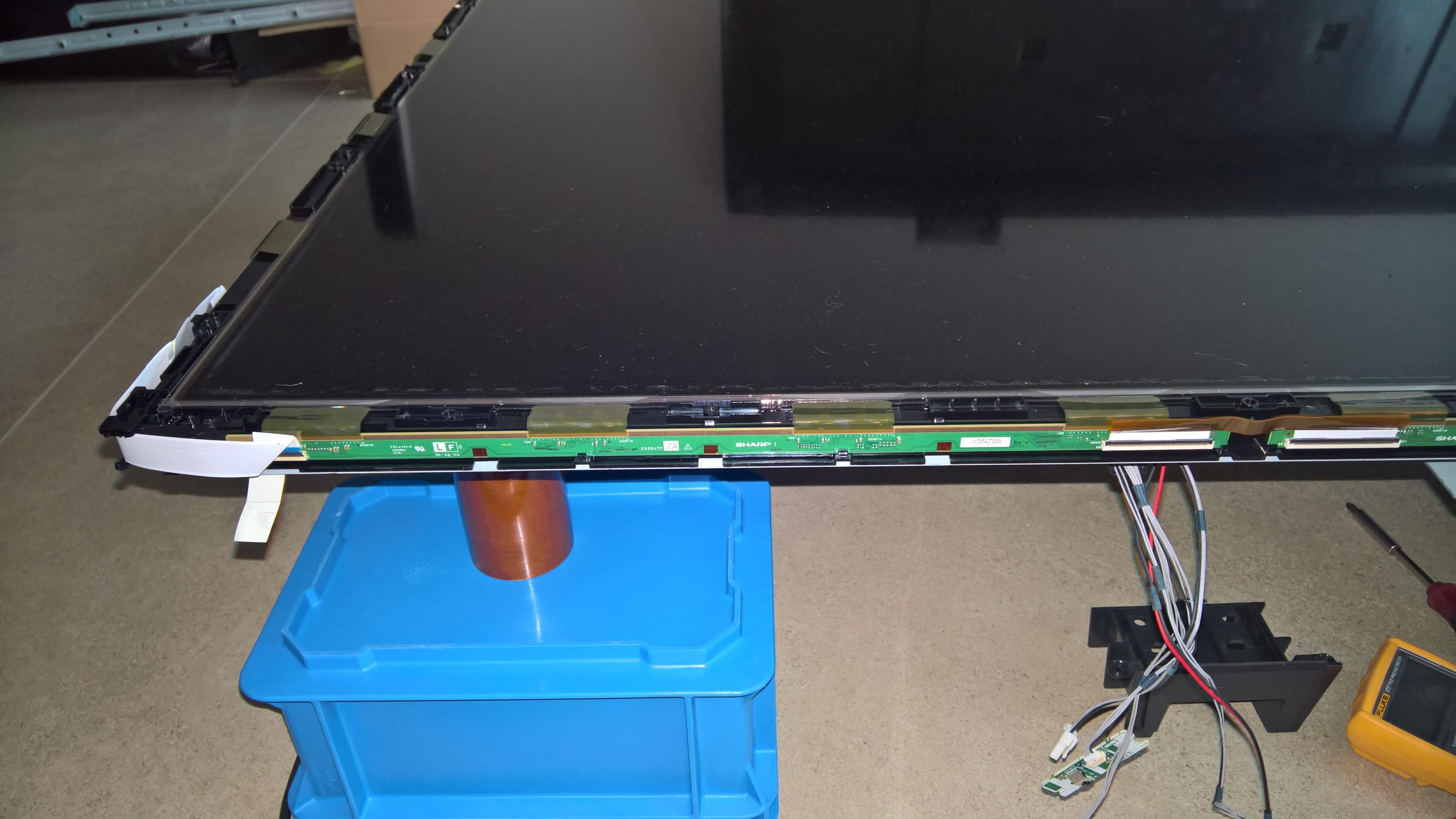

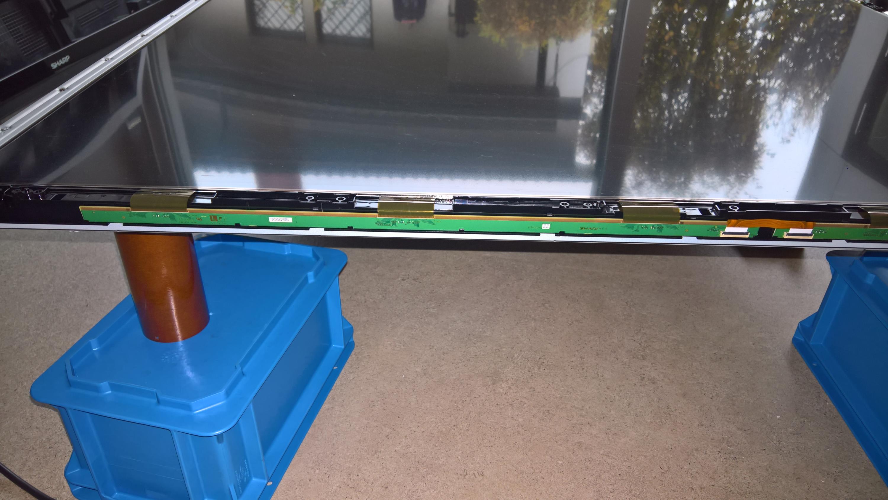

                        attached 4 pictures of the 4 pcbs from one side of the display....
                        the other side is absolutely the same....
                        T-CON has two ribbon cables one for the right side and one for the left side....
                        So I think everything is good connected?????
                        i can feel some heat on each display driver chip at the bottom of the display tabs.... at the side tabs I can feel no heat, left and right side.....

                            The connections budwich is referring to are in pics 2 and 3 from what I can see.

                              Anyways, as I suggested and was pointed out, in pictures 2 and 3, the cabling of interest is the "corner white cables" which interconnect the side to the bottom boards.
                              With your previous "test" that disconnected the "mid left side" bottom board, you got some form of display and NO error code. This is likely indicating an issue with the left "side" of things. So you only need to concentrate on that side.
                              If you disconnect the left side corner white cable (ie. disconnecting the left side boards from the bottom edge boards), are you able to get a display? :-( the bad news is you need to put back the component that you took out to ensure this test is only checking the side of the panel as with that component removed, I / you have no idea what it is impacting... :-( hopefully, once back... you will get an "expected result".... my fingers are crossed.
