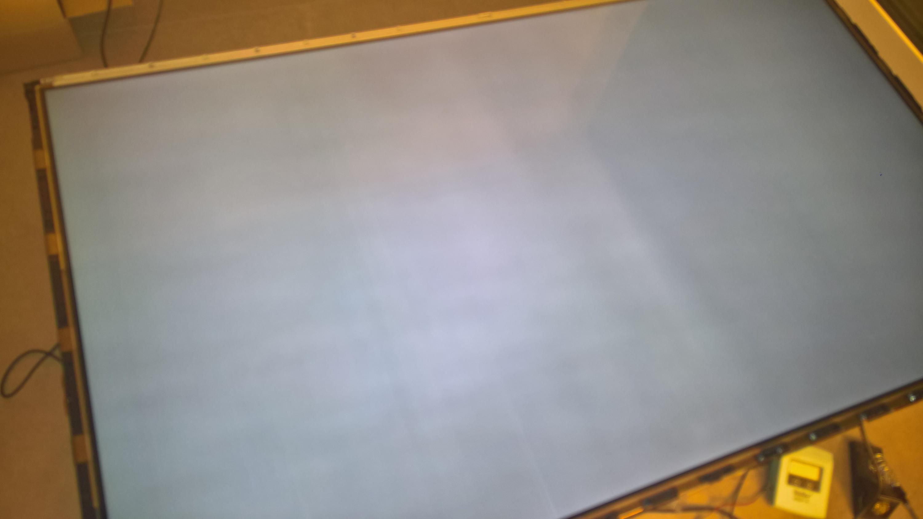

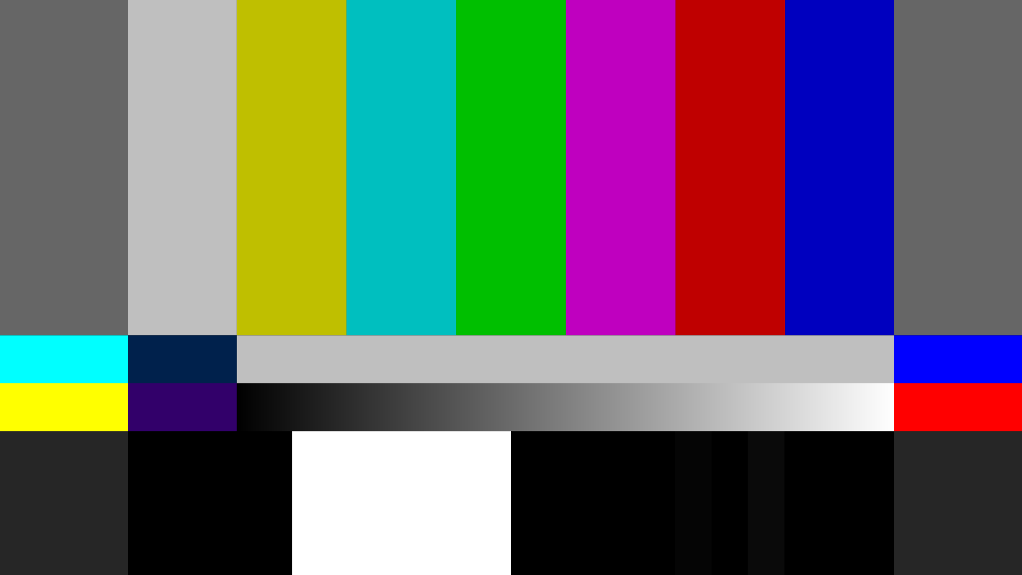

            here is the actual test picture!
            it looks very strange.......
            • budwich
              • Jul 2015
              • 3097
              Re: Sharp LC-80LE645E Flashing 2-5 :-(
              I assume the "control example" is the second one ... :-)
              hmmm... interesting. I can see from this that there are issues on the right side (which was the left side from the previous posted picture... ie. back side pictures).
              Is this picture (one), a picture with the component replaced?
                You are missing green, check the cable feeding the signal
                  yes I am missing green.... but some parts are dark white.... so there should be green in?!?
                  and all is darker so darkwhite parts or grey parts are black.....
                  it seems that complete picture has the same problem, not differents from right to the left.....
                  the cable between mainboard and T-Con looks fine and no change in picture if I touch it.....
                  hmmmm.....

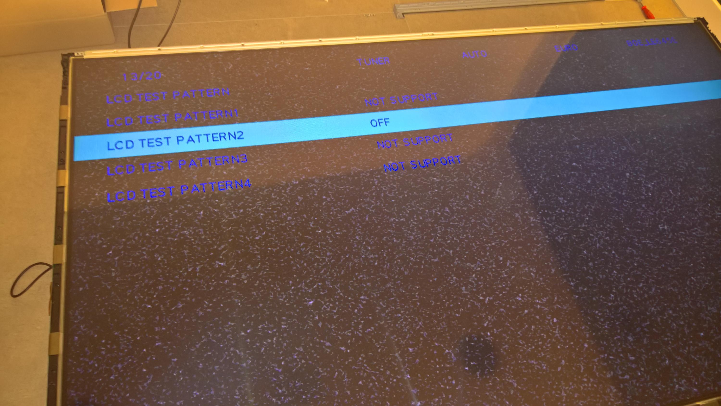

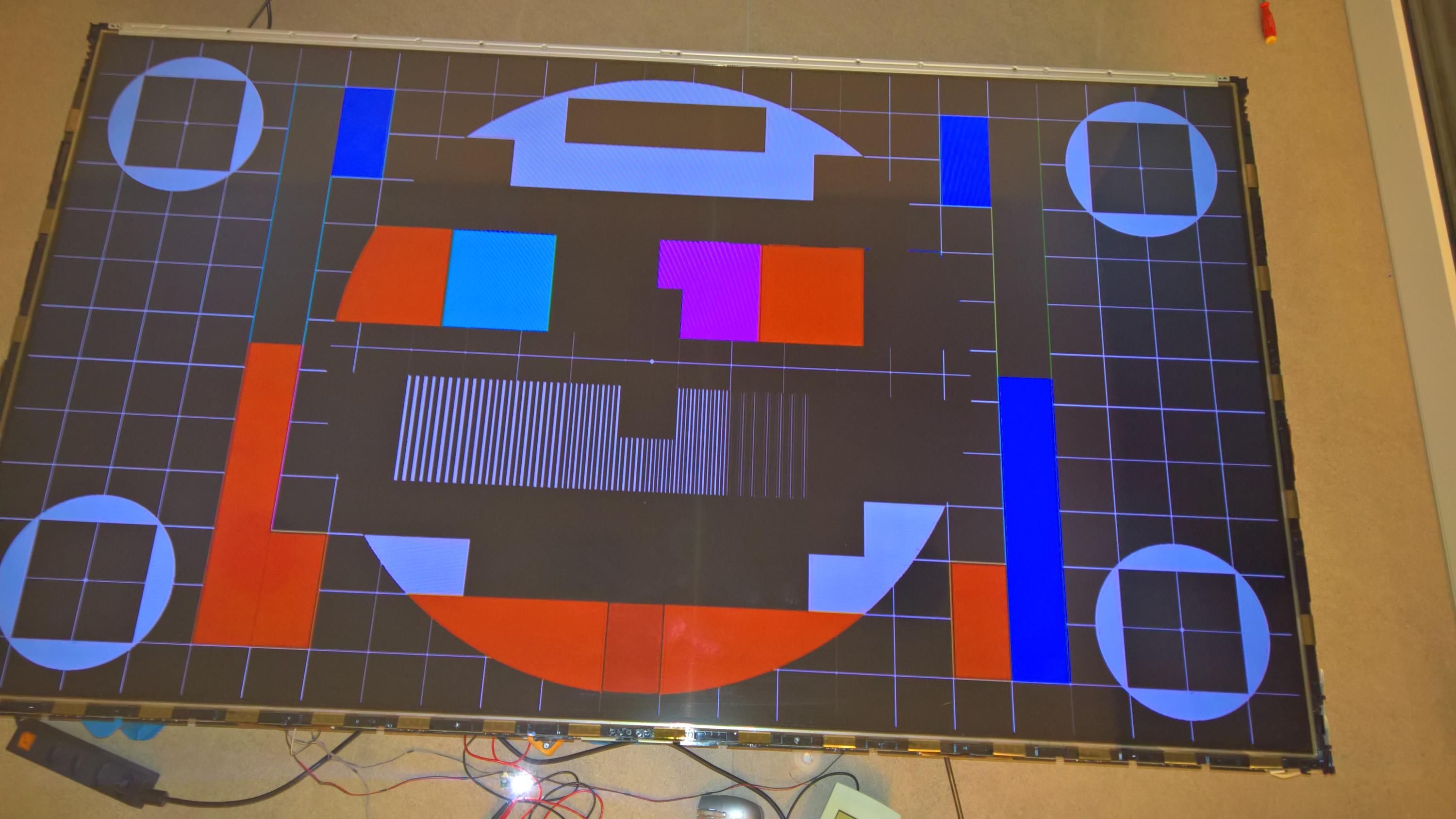

                      no change if I am removing the left or the right corner white cable.... only if I remove both of them, but this should be normal?!....
                      tomorrow I got the new capacitor (but I think this will not help....)
                      This testpicture comes from my notebook by HDMI....
                      But ATV and TV Menue looks the same....
                      only the picture of the SERVICE Menue looks perfect.....
                      here I can choose also some testpictures (complete screen in each color and so on) and also this test works fine!! here I have green and all other colors in very high brightness......
                        interesting... of course waiting on the pictures
                        BUT, if I understand correctly, then you have an issue with the inputs (main board) if the internal test screen looks correct (depending on the test that you are referring to).
                        Not sure I understand about the "new capacitor arrives tomorrow" statement... what are you using there now?... nothing ???? probably not going to help the circuits involved... :-)
                        OOPS... I re-read your post, even the internals look bad... :-( then it is unlikely an input issue.
                        double oops... further re-read indicates (I think ATV tv?) which are inputs via tuner are bad versus something totally internally generated (service menu) looks ok. maybe a main board issue.
                        However, dropping either corner cable does not impact the picture likely means those sides are OK (ie. not "loading" down the tabs drivers on the opposite side).

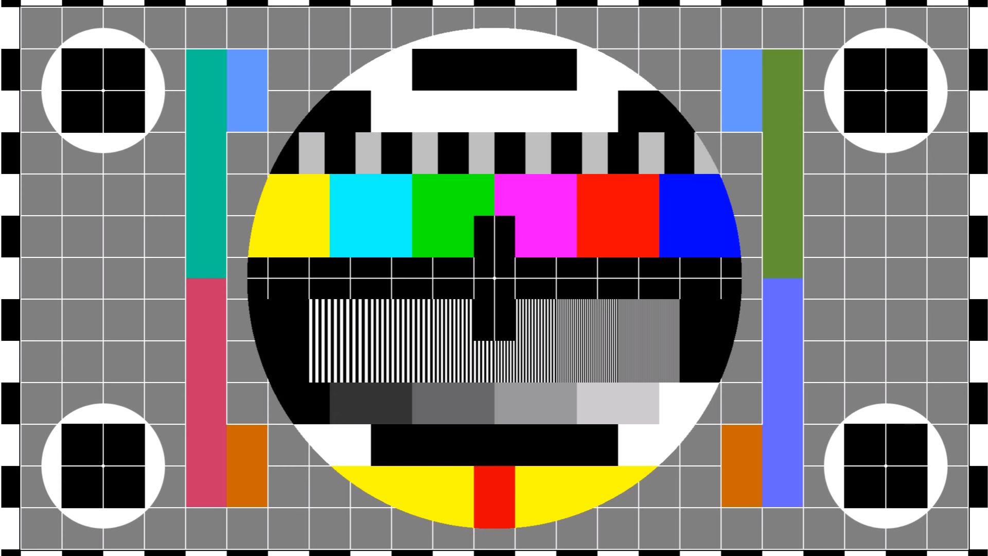

                        Can you feed a smpte color picture in .... this is the test pattern that has large color bars across the top half and "contrast" patterns along the bottom. If so, what does it looks like.
                        I am concerned about your "test picture" that shows what appear to be a darkened area on the right side.... that appears to be a driver issue.
                        Also there appears to be some "issues" (horizontal like "errors") in the center of the picture on some of the edges of some of the pattern.
                        Of course without a working component in the bottom edge board... not sure what to expect.
                          so, I got the new ceramic capacitor... but soldering it has no change of the bad picture....
                          soo, the Error 2-5 problem is repaired with changing this capacitor but I have still the bad picture......
                          Is it better to make a new theme here according this bad picture? so I think it has nothing to do with the tabs arround the LCD.....
                          @budwich
                          I have two mainboards here and both has the same problem.....
                          could it be a failure T-CON??!?
                          I make new more pictures.....

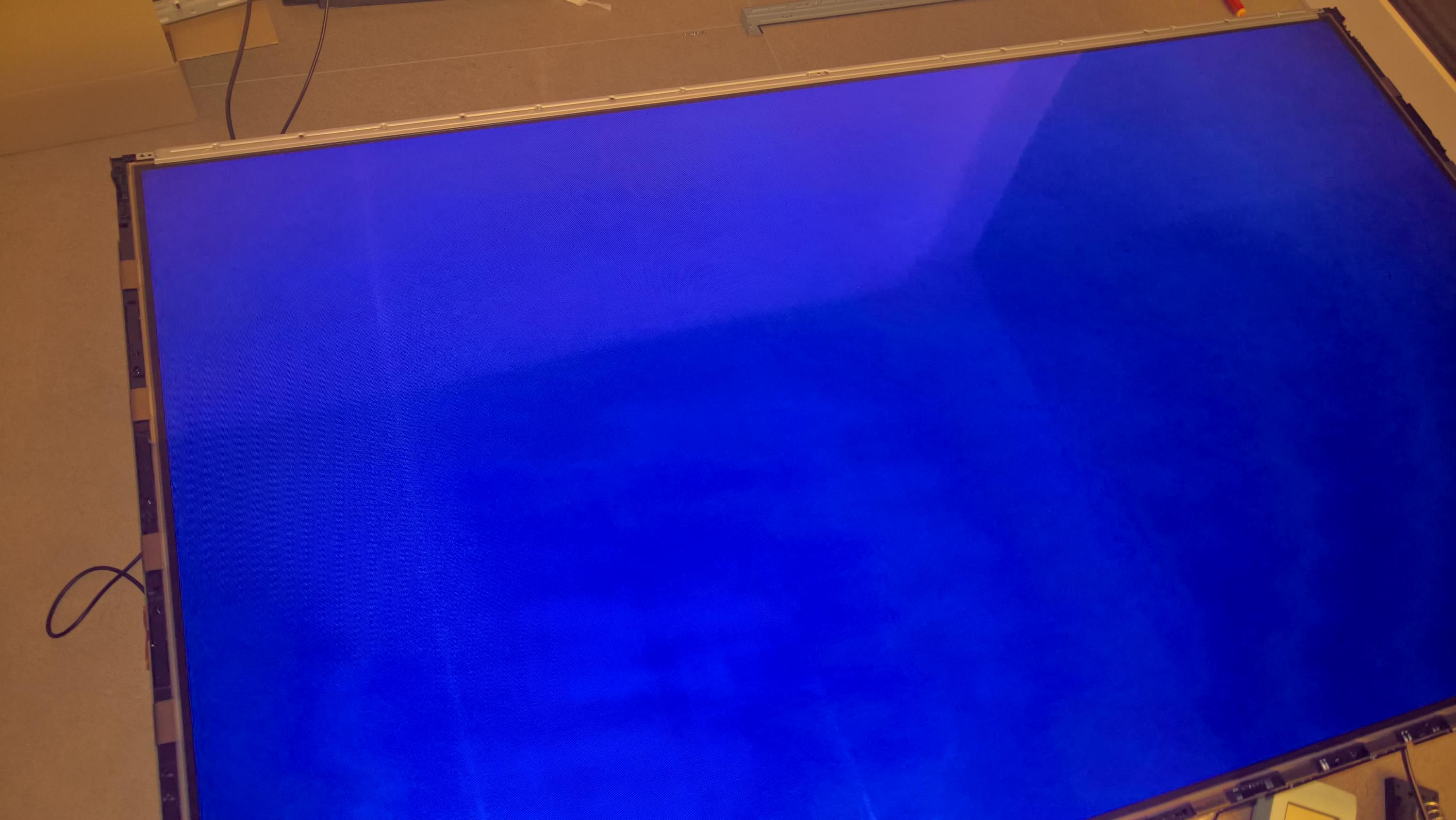

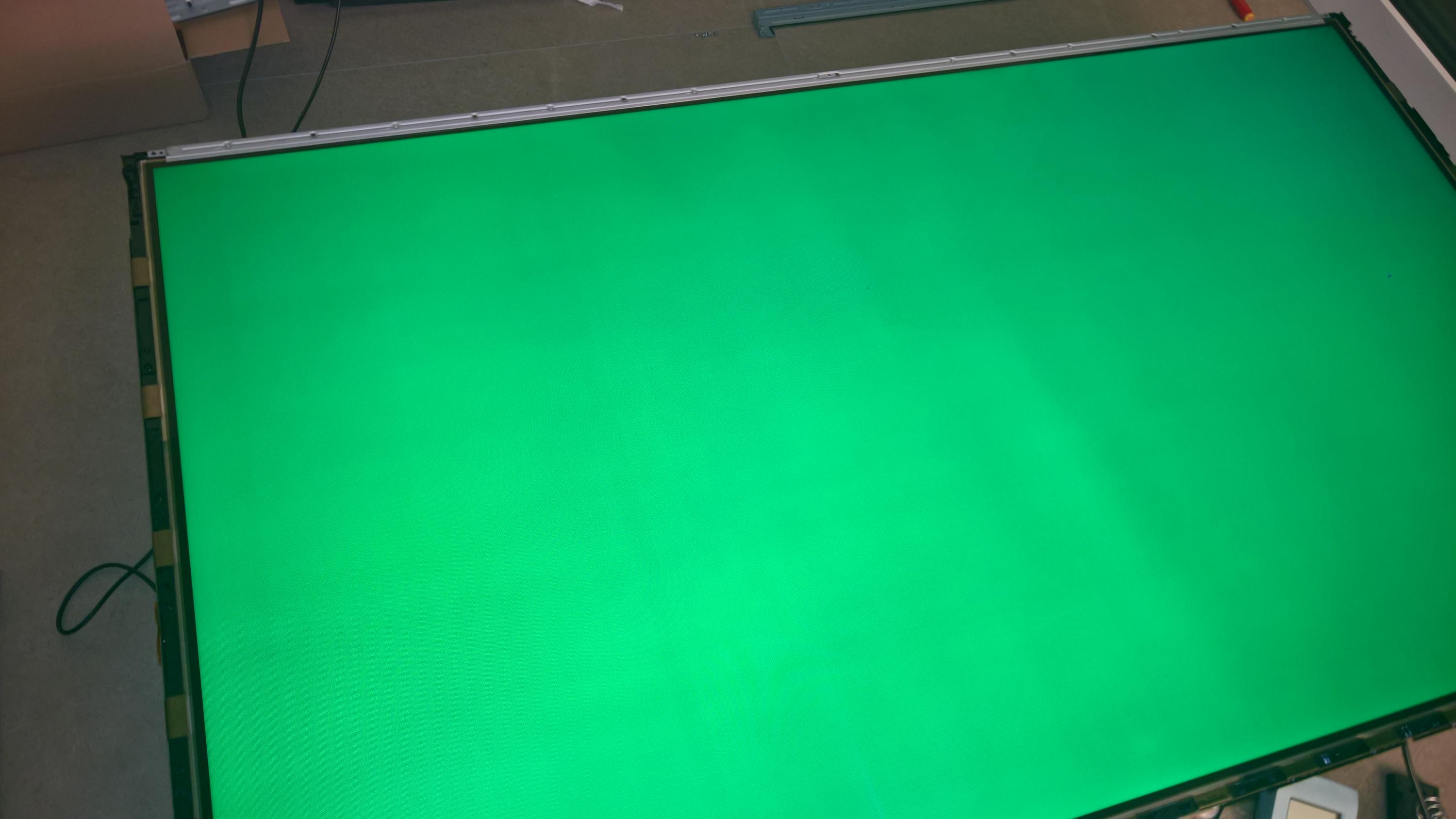

                            here again some testpictures:
                            see information in picture name!
                            the picture is bad in ATV, DTV, HDMI, TV menue
                            the picture looks good in service menue but here I can't feed in testpictures
                              hmmm... surely strange. I don't see any screen issues... I can see that the "dark side" that I saw in other pictures is just reflection from the surroundings.
                              Perhaps your "guess" that the tcon has a problem might be valid. Perhaps little to lose and much to gain with a second card if you can find one.
                              Have you verified all the voltages leaving the power card to the main and tcon?
                                The service menu test shows that the panel is getting all three colors, red, green & blue. thats how you get white, It looks like the main board may have an issue or maybe the lvds cable or t-con.
                                There is no green video being supplied so the picture looks the way it does, 60% of the brightness of the overall picture comes from green.
                                I'm not sure where the service test pattern is generated from but if it does come from the main board then that would sugest the lvds & t-con is fine and the fault is with the main board signal processing. If the service pattern is generated by the t-con the fault could be with the main, lvds cable or tcon
                                a missing voltage would affect all three colors not just one.
                                  There is NEARLY no green video being supplied.... so you see a Cyan part (green/blue) and there are also some white parts.... but main parts of green is missing, but not all, it is very currious.
