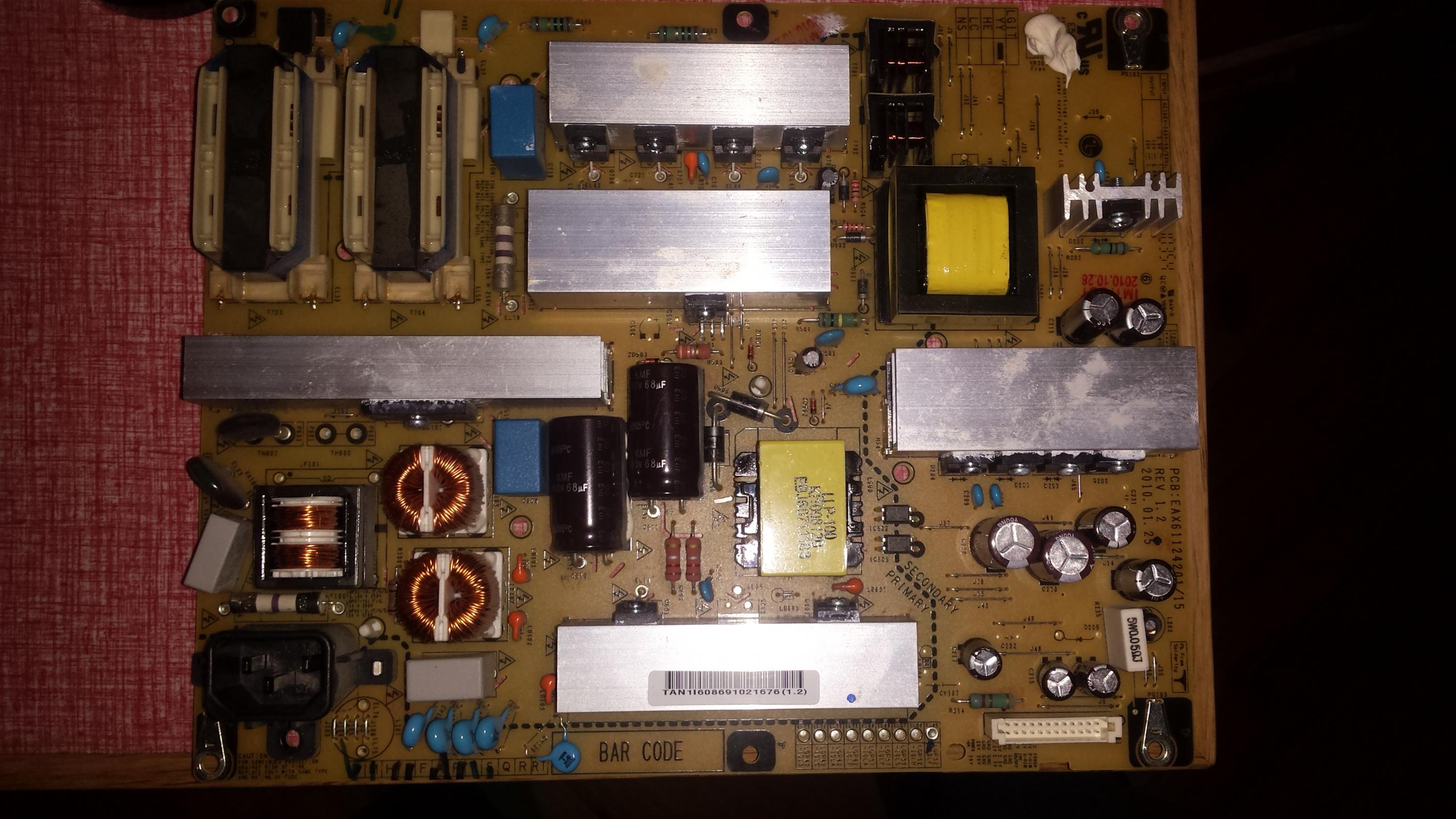

    my LG TV won't turn on and I'm struggling to find service manual for it's power board, can you please assist.
    PCB - EAX61124201-15 REV 1.2

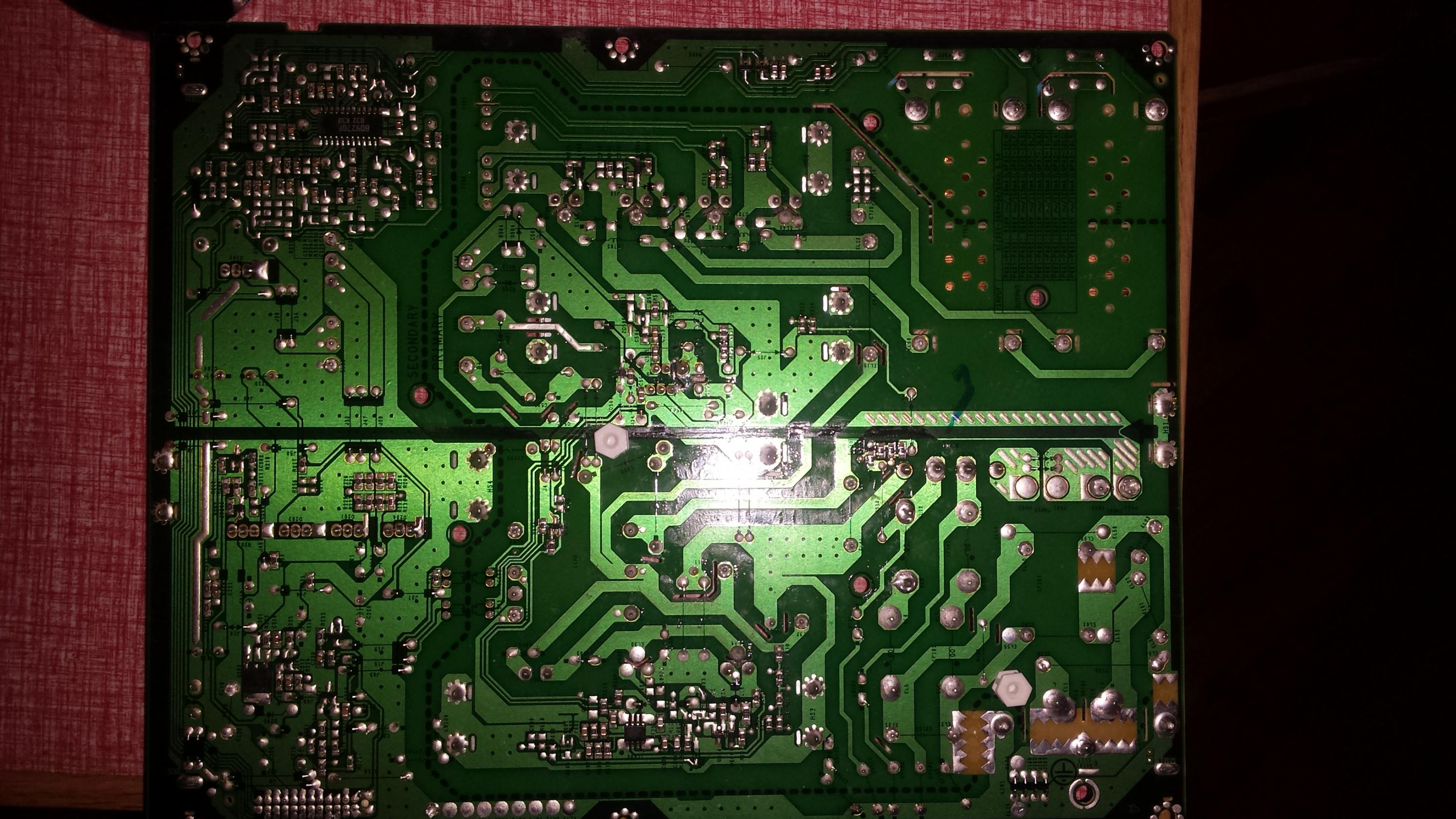

              Can I see good clear straight shot pictures of the whole top and bottom side of the board? Pictures must be clear enough for me to see the traces on the bottom side of the board.
                Re: LG TV - Help finding power board schematic
                Hi and thanks for your reply. I have uploaded the pictures.
                In the mean time I have checked the voltage output from the connector to the main PCB and all looks to be OK so I suspect the problem might not lie on the power unit...
