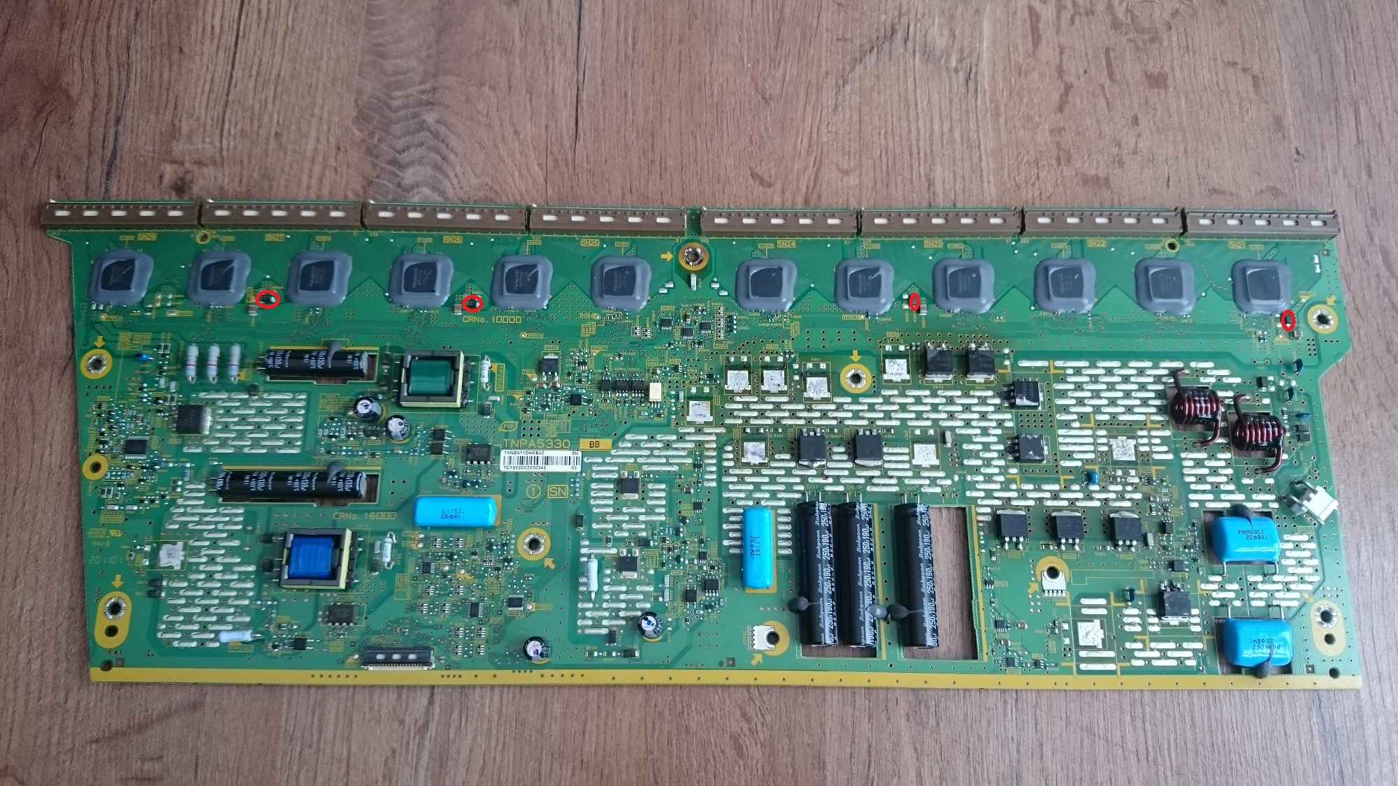

          I take it you've tested for short across C842. If present at least one of the buffer chips will be shorted. This I believe also can cause the demise of the trio of SMD diodes D430, D432 and D433. In my case thats exactly what I found buffer chip IC4806 blown and that Grey stuff that Panasonic put around the buffer chips is awful to remove!

              I found a solution for the exploding diodes on a TNPA5330 AB board.
              Common failure is that after replacing the 6 FETS ( Q401/402/403/421/422/423 ) the diodes D433/432/430 will explode. The 2 small resistors ( 40K Ohm ) will give a high value or will read short.
              The reason is fake parts! I replaced all fets with FGD4536 and replaced the diodes + resistors from a scrap board but it still blew up.
              I found out that both DG302 were also short. One is located on Q441 ( Under heatsink and will read short on both legs ) and the other is Q451 which will read short on 1 leg. Well atlas in my case.
              I replaced all parts including IC502 + Q531 with original parts and the board is back alive. Watch out that there are fake DG302 / RF1501 / 30F131 and RJP30H2A on ebay!! If the logo is almost gone using nail polish remover then you might have fake part.....
              Hope it helps someone.

                Re: Panasonic TX-P42ST30 with exploding diodes....
                Hi,anyone could help me to fix my tnpa5330 board .I have removed all the shorted Fets .
                I have shorted diode near the Buffer IC. See photo
                Is this would be normal ? I have measured out the board and are all Ok .
