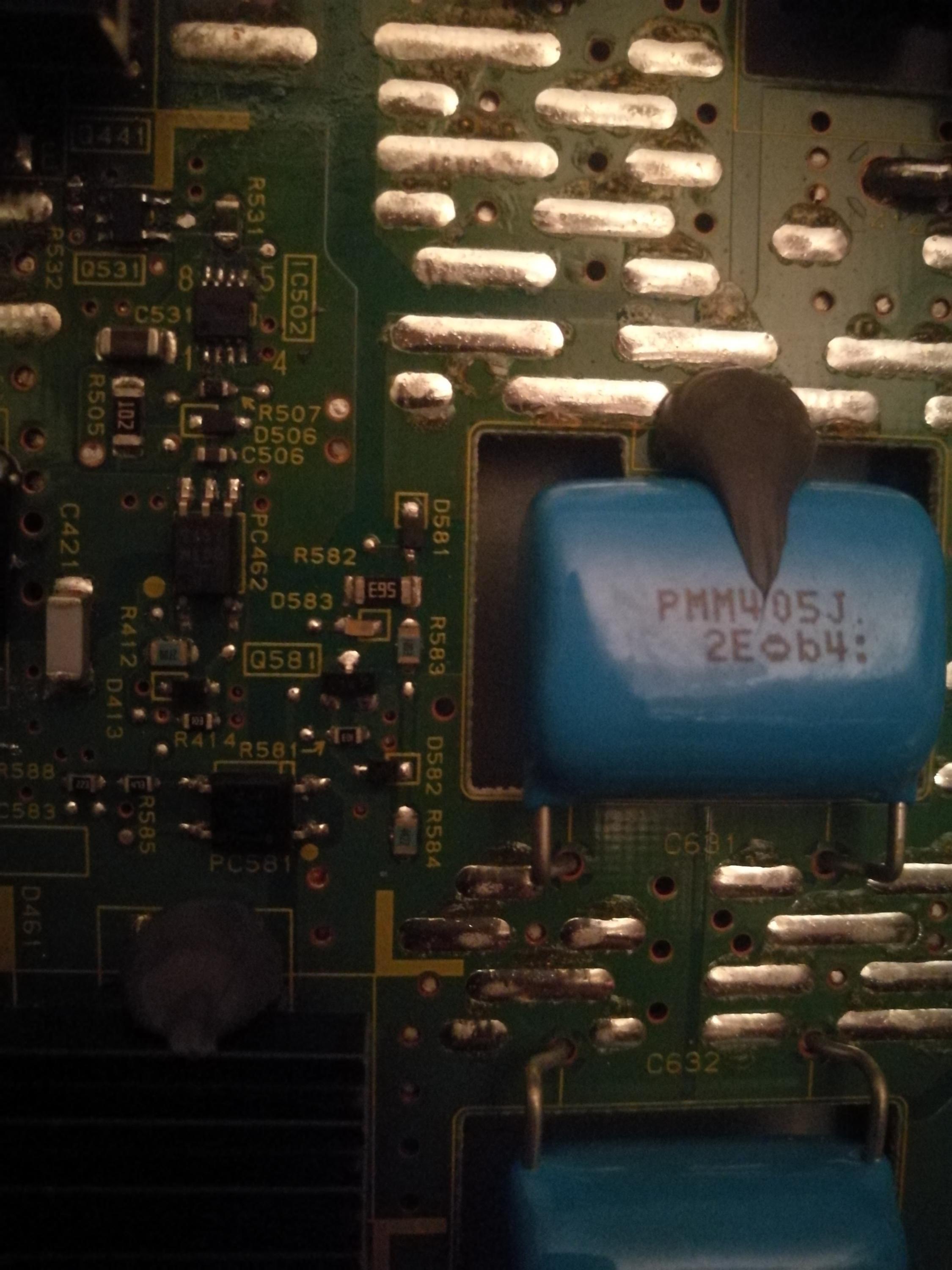

    Hey guys ,
    Im having some big troubles with a TNPA5330 AB board. It's a tv from a customer.
    It had the usual 7 blinks and the buffers are all ok! Replaced the 6 shorted fets , turned on the tv and i now got 6 blinks.
    I then replaced the 2 small ic's and i got some loud bangs above the white prong connector.
    I think that there are also FAKE FGD4536TM igbt's. I got a few from mouser and a few from china.
    The ones from mouser got a cut on both corners showing the copper , the ones from china dont have that.....
    Anyways to continue the story. The diodes 430 , 432 and 433 were shorted and even popped! Im not sure if this is caused by 1 fake igbt or does the board have a different problem?
    Both resistors are bad also!
    I replaced the resistors and diodes + shorted fets 3 times now and again the diodes explode.
    I even replaced the 4536TM for original rjp30h2a and still the diodes blow. The fets in the bank measure 90ohm after the bang....
    Also , when i measure the resistor on the good board it measures 45k. When i put the good resistor on the bad board it goes to 35K...so something is pulling the resistance down.
    Something in the energy recovery circuit is blowing up my board.... i got to watch out now as the traces are getting black/broken because of the bangs.
    Any idea's what is causing this?
    I got a board with a shorted buffer so i can replace parts.....
    Ps , repaired the same model for different customer and that went fine!!
    Thanks!

    Photo with the diodes that are still fine is from the board with the bad buffers.
    Other photo's are from the blown board.

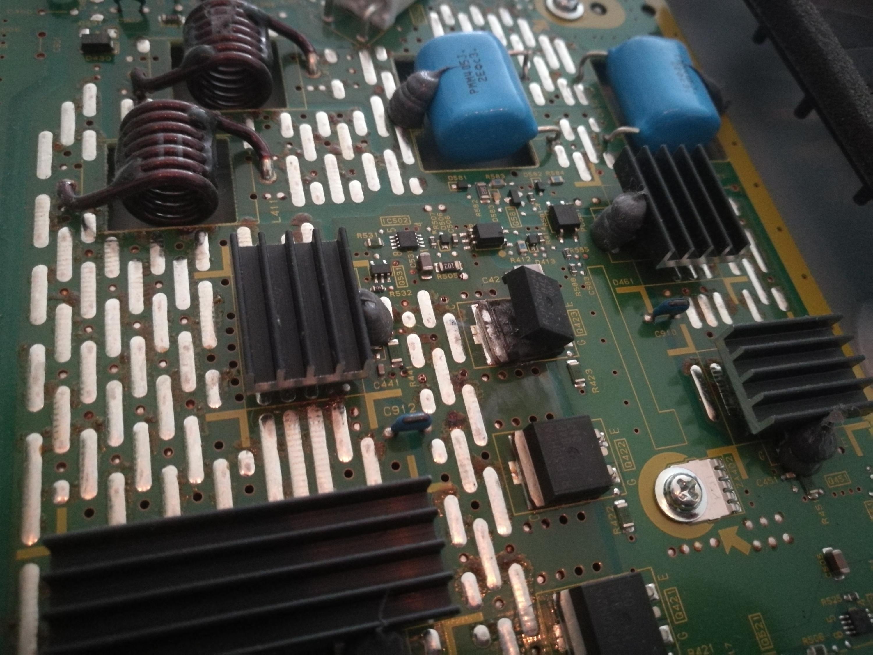

            Possible solution:
            Replace all parts in picture 2 + diodes 430 , 432 and 433 + resistors?

                Have you got a copy of the SC/SN fault finding for 2010 -2011 boards? The one that gives the diode check reading of the driver IC pins on the various models?

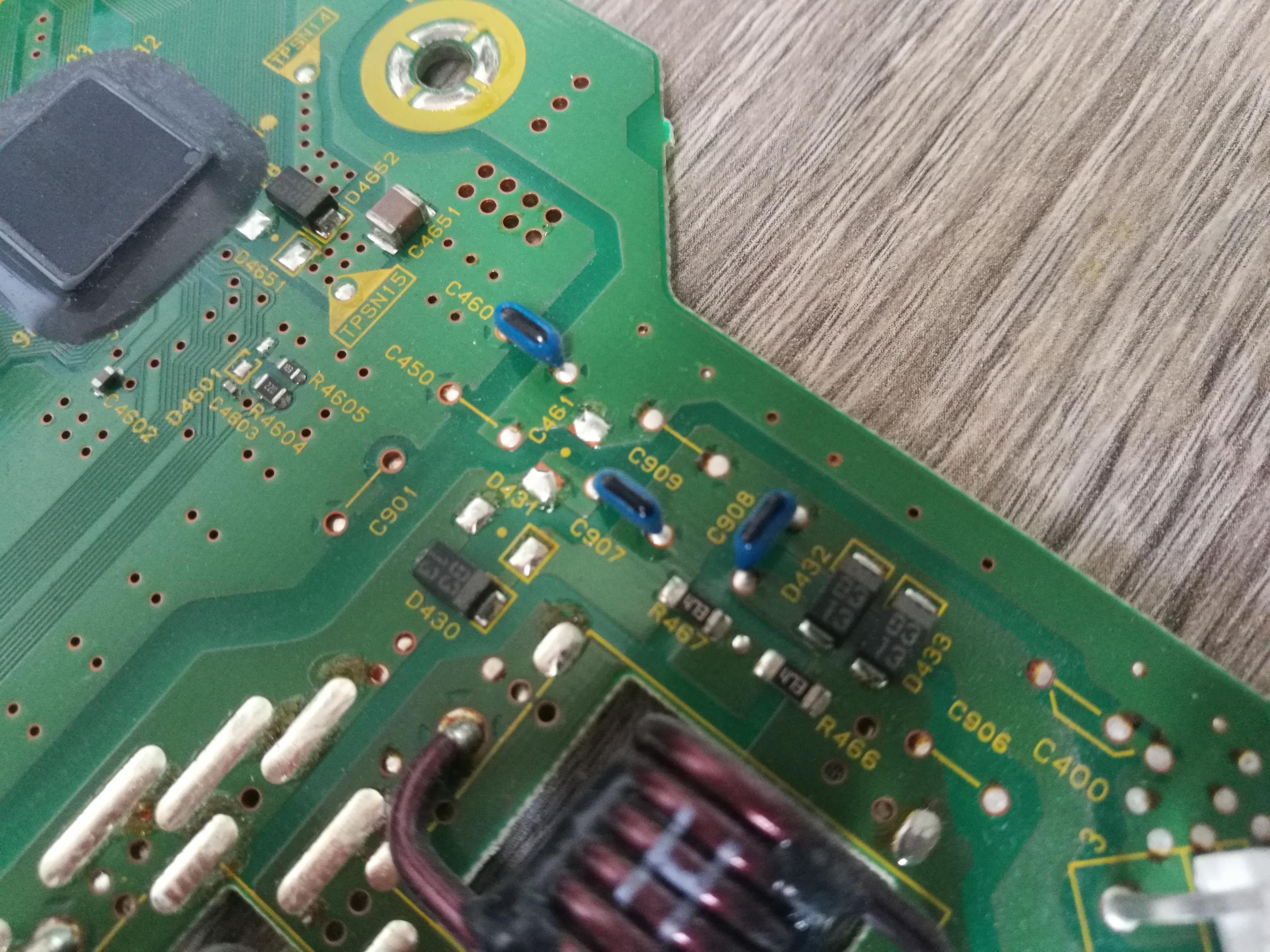

                What's the deal in picture 3 with the RJP30H2 blown apart? I see that and it's not sitting straight possibly not soldered. Is that you removing it and putting it back for a photo? The other 2 look original.
                Don't have any ideas except the basics being, remove all the obvious bad shorted parts, check everything else for short, check all driver resistors and if a driver IC has failed check the resistors associated with that and the 5 pin NPN/PNP.
                compare the optocoupler readings to the good board.
                Stick to the batch of parts that are known good just in case.

                  The RJP30H2A thats standing up straight was like that when i first opened the TV. What you see is a IGBT that is cut in half because of the explosion haha. The customer said that some loud pops came out of the TV.
                  I'll replace every part in that energy recovery circuit , see what happens!

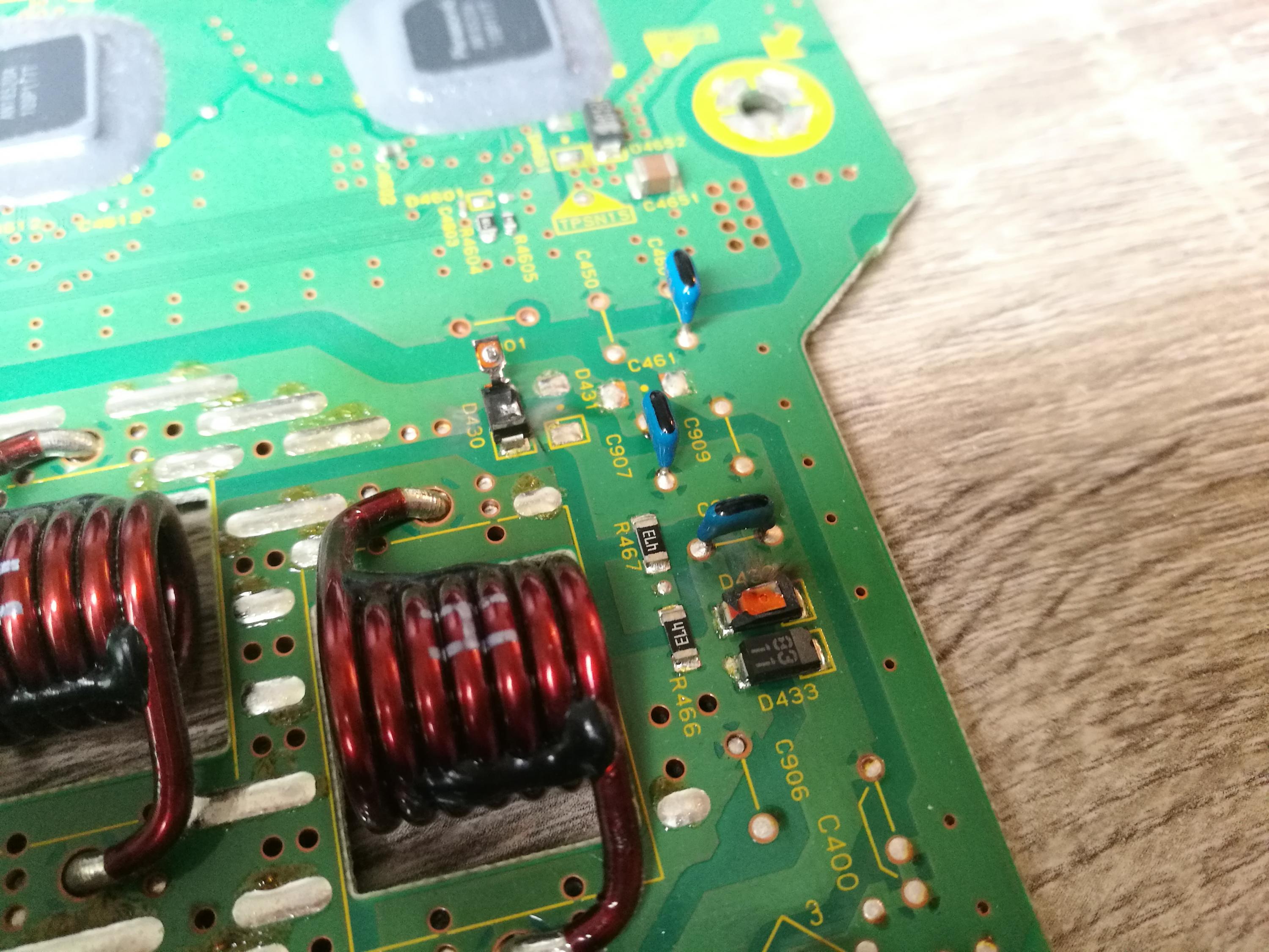

                                2 months on and I have exactly the same problem as you had with the same exploding diodes. Did you ever determine the cause?
                                In my case D430 and D432 both exploded their tops D433 seems to have survived though.

                                  This is common for these to blow the SMD diodes D430/D432+D433 when the IGBTs fail the original RF071L4S(marked 83), they can be a little hard to find now, I have always used the fairchild ES1G as a replacement as most of us would have these for Samsung/ LG Sus board repair anyway, but any 1A 400v super fast SMD rectifiers will sub for them

                                      I never found out what caused this issue but I'm still suspecting bad IGBT's. ( Fakes ).
                                      I received a lot of TNPA5330 boards with the same issue , blown diodes on the top side of the board.
                                      It's not only the diodes that are bad. All igbt's , diodes , resistors etc all need replacing , all resistors in that area are dead!! Also the D302 under the heatsink is shorted.
                                      You can't test a repaired board without applying power to the board. Just hope it won't blow up. You could measure for shorts on the white prong connector , beep is bad.
                                      I ordered the diodes that Flocko said. Im planning to replace all parts in that area because just replacing the diodes and resistors won't work.
