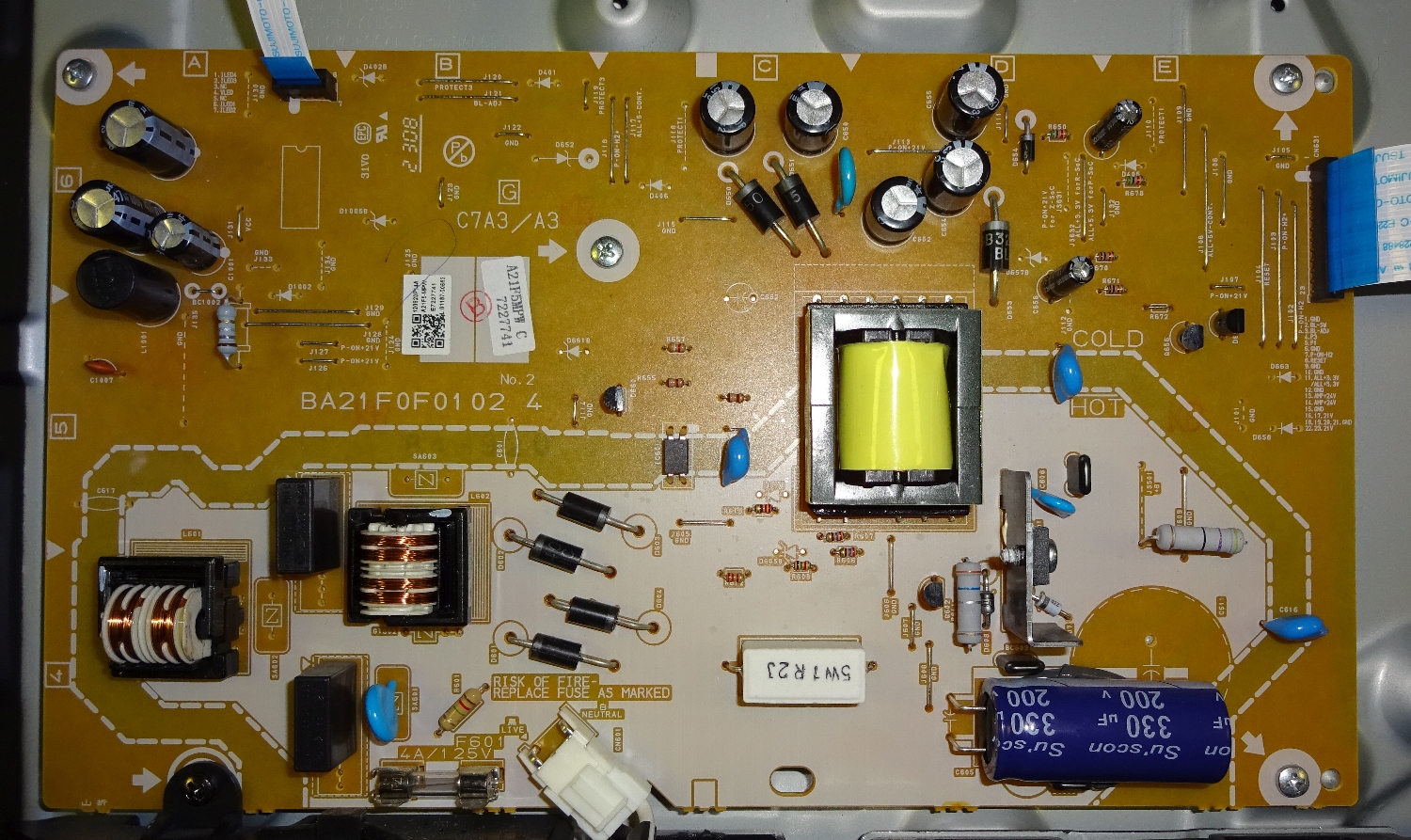

    phillips 32pfl4507/f7 squeal like a pig
    This philips came in dead and I found on the power board the fuse blown then checked and a mosfet was bad and a diod shorted etc... so I got a repair kit and replaced
    F601
    Q602
    Q601
    Q501
    Resistor R611
    Resistor R501
    Diode D608
    Diode D607
    Diodes D601,D602,D603,D604
    After reinstalling the board I plug it in and get a very loud squeal and still no power. If I unplug the cable to the main it goes away. That cable looked good on the contacts. Would I also have a bad main???

    Re: phillips 32pfl4507/f7 squeal like a pig
    No,still a short on the power board,but the mainboard turns on the power supply,hence why it only squeels then.
    In short bursts you should measure what voltage is missing when it squeels.Your short will be in the missing voltage section

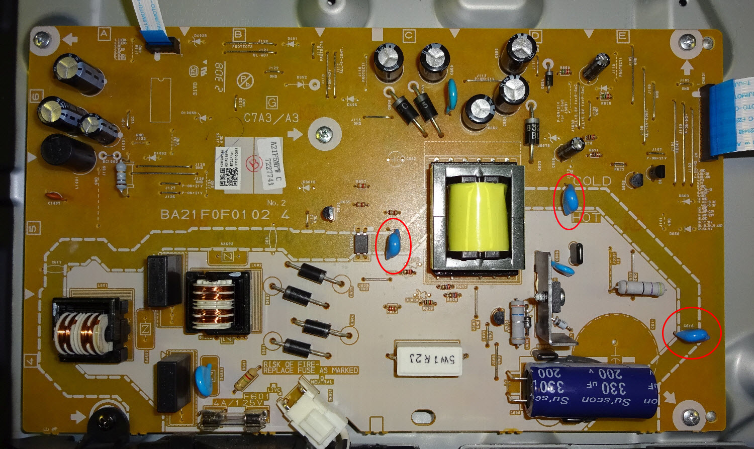

            its likely a shorted mlcc on one of the converters.
            looks like there are 3 on that board.common on funai sets.
            • CraigR
              • Dec 2013
              • 973
              Just to be clear you're talking about what I have circled in this picture. Correct? If so none are shorted.

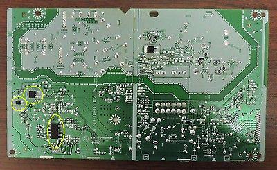

                are you getting any secondary voltages? Did you try disconnecting the cable going to the led backlights?
                There could be a problem with the backlight circuit on the back of the board.
                Did you check for shorts accross the secondar voltages, ie: accross c650, You could have a shorted component in the circuit that is supplied by one of the secondary voltages (backlight inverter ic or fet)
