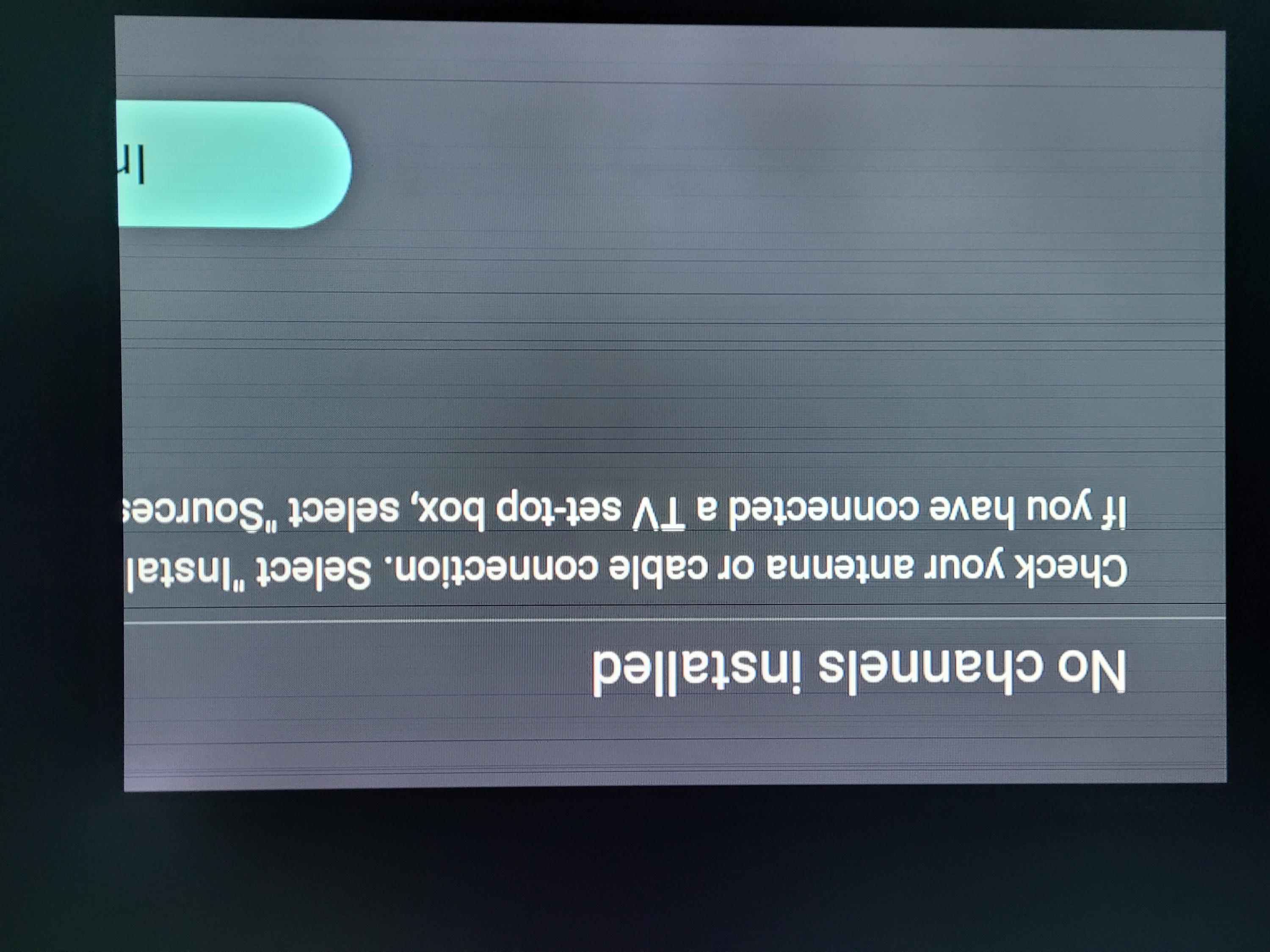

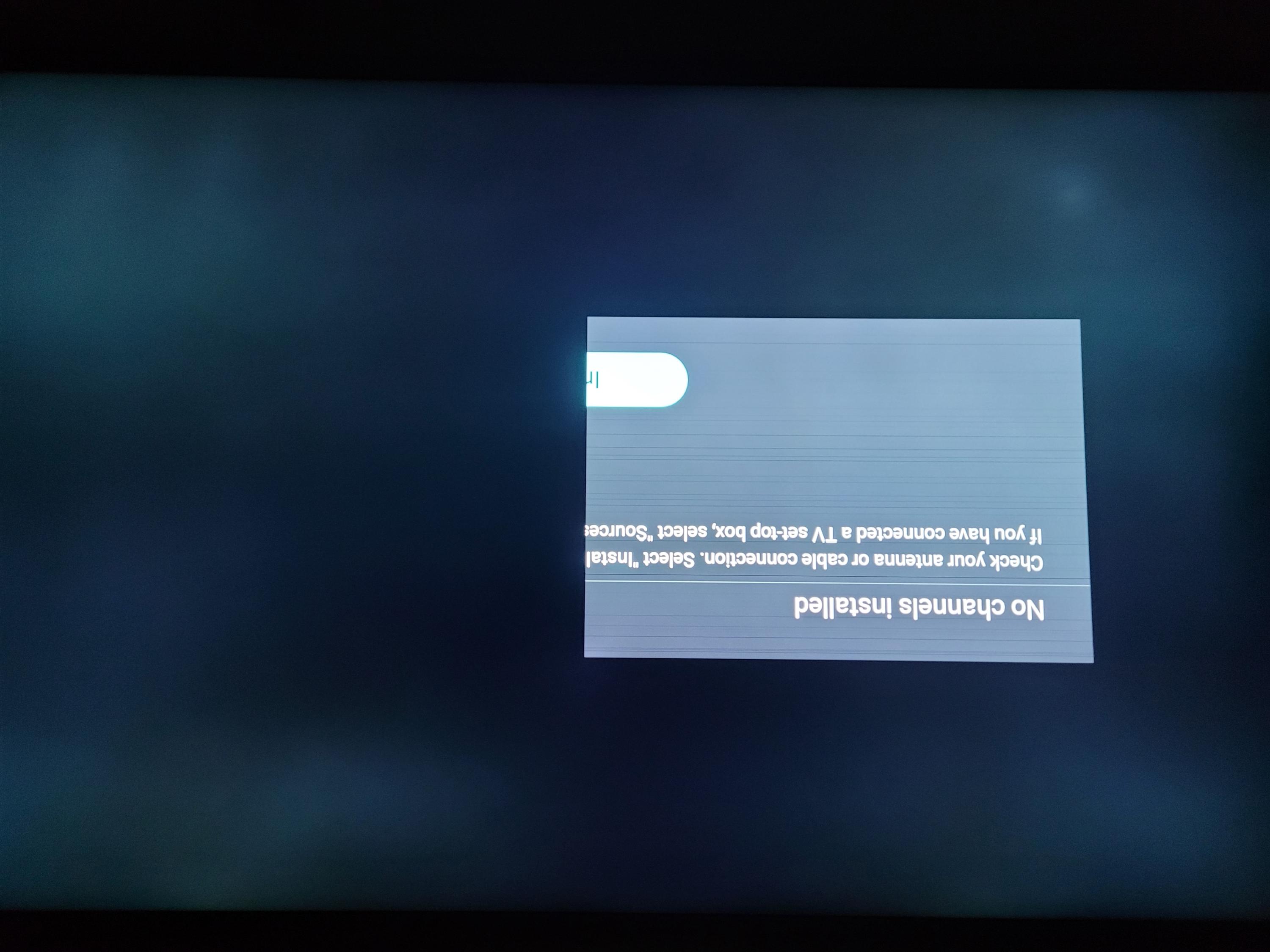

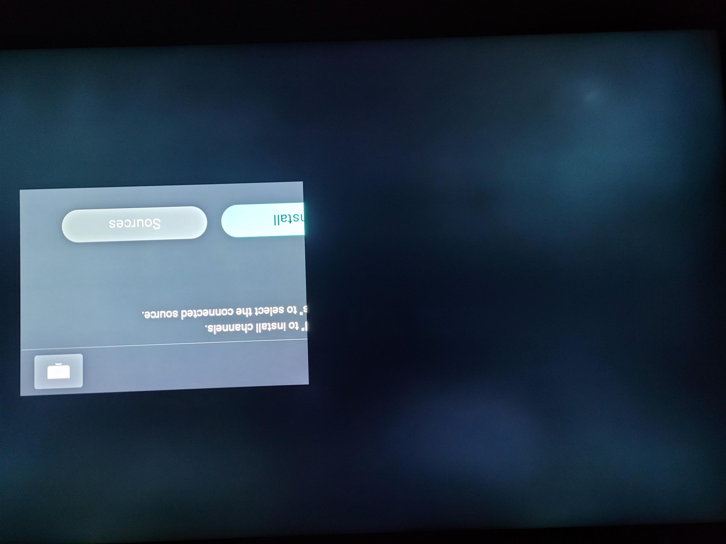

    Phillips 58PUS7805/12, was told it had sound no picture, sometimes picture would come back then go again?
    From what I have seen myself, its just blank illuminated screen. Tried unplugging each ribbon cable from Tcon in turn.
    When one is unplugged, I get half sceen, clear picture.
    With other unplugged, get half screen but with thin horizontal lines
    Any ideas? Or is it likely a bad panel?

    Re: Phillips 58PUS7805/12 No Picture
    Try the tape-cut off method.

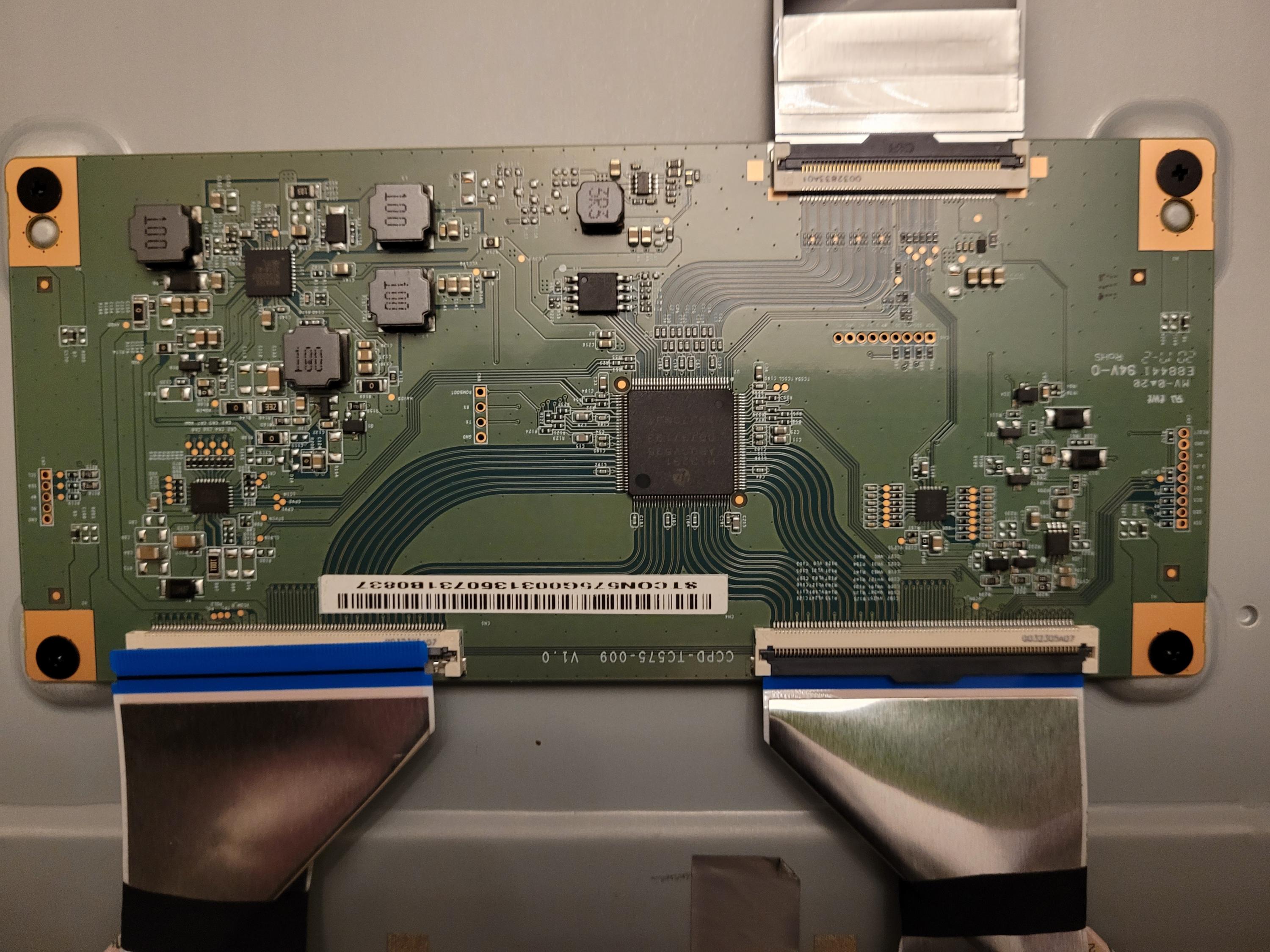

      Any idea which pins from and to please?
      Also would that be on the cable that gives the pic with lines when connected?
        Can be very tough to get it right, maybe start with 15 pins on one side of the cable of the bad side, then unblock one at a time and see if there's an improvement.
          Good video there but also I have seen where you need more than one line blocked, guess it just depends on the short: https://www.youtube.com/watch?v=pfrRhw7-ZII
            Can also check the little mlc caps on that bad side panel driver board for shorts or very low ohms.

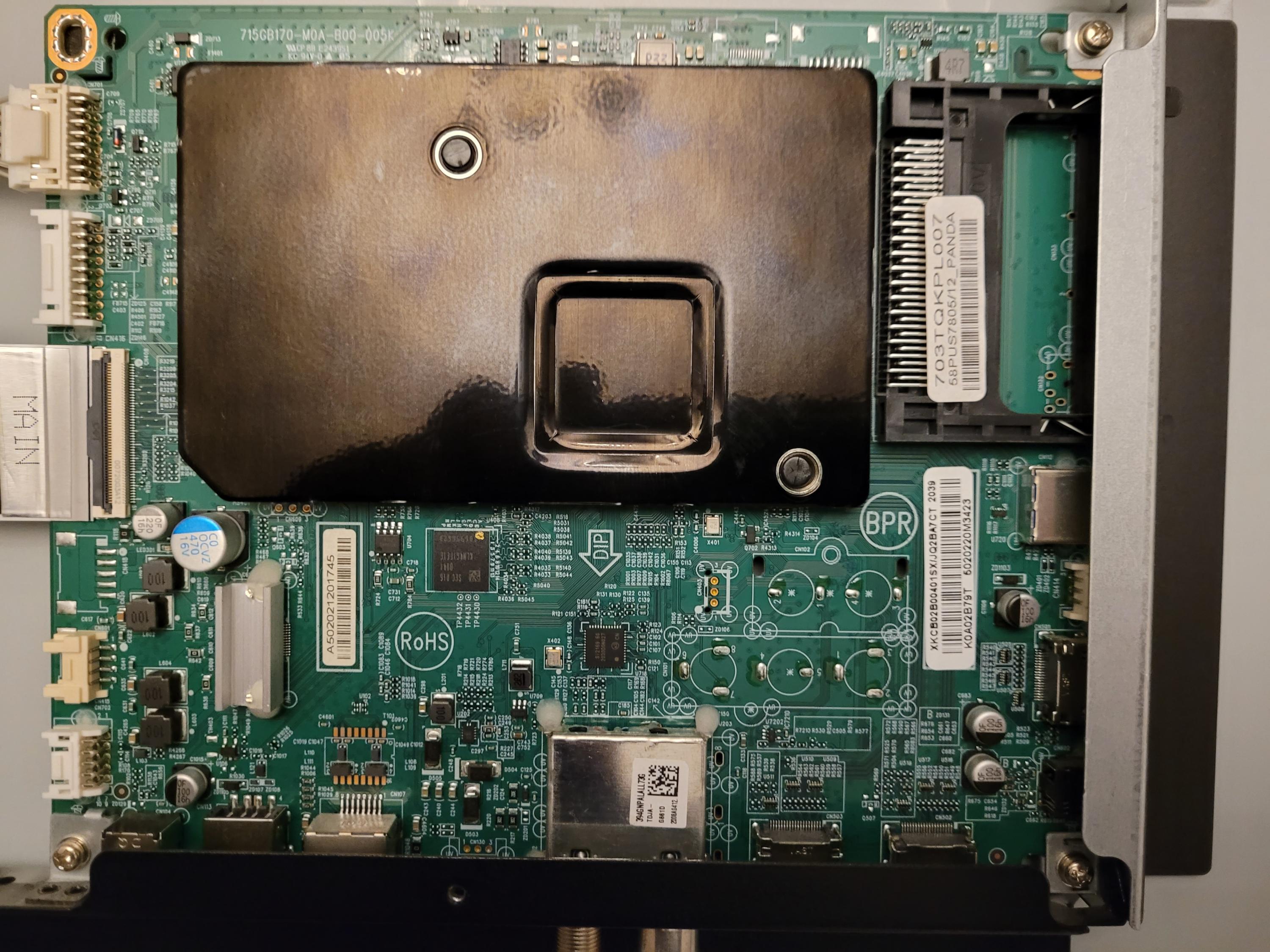

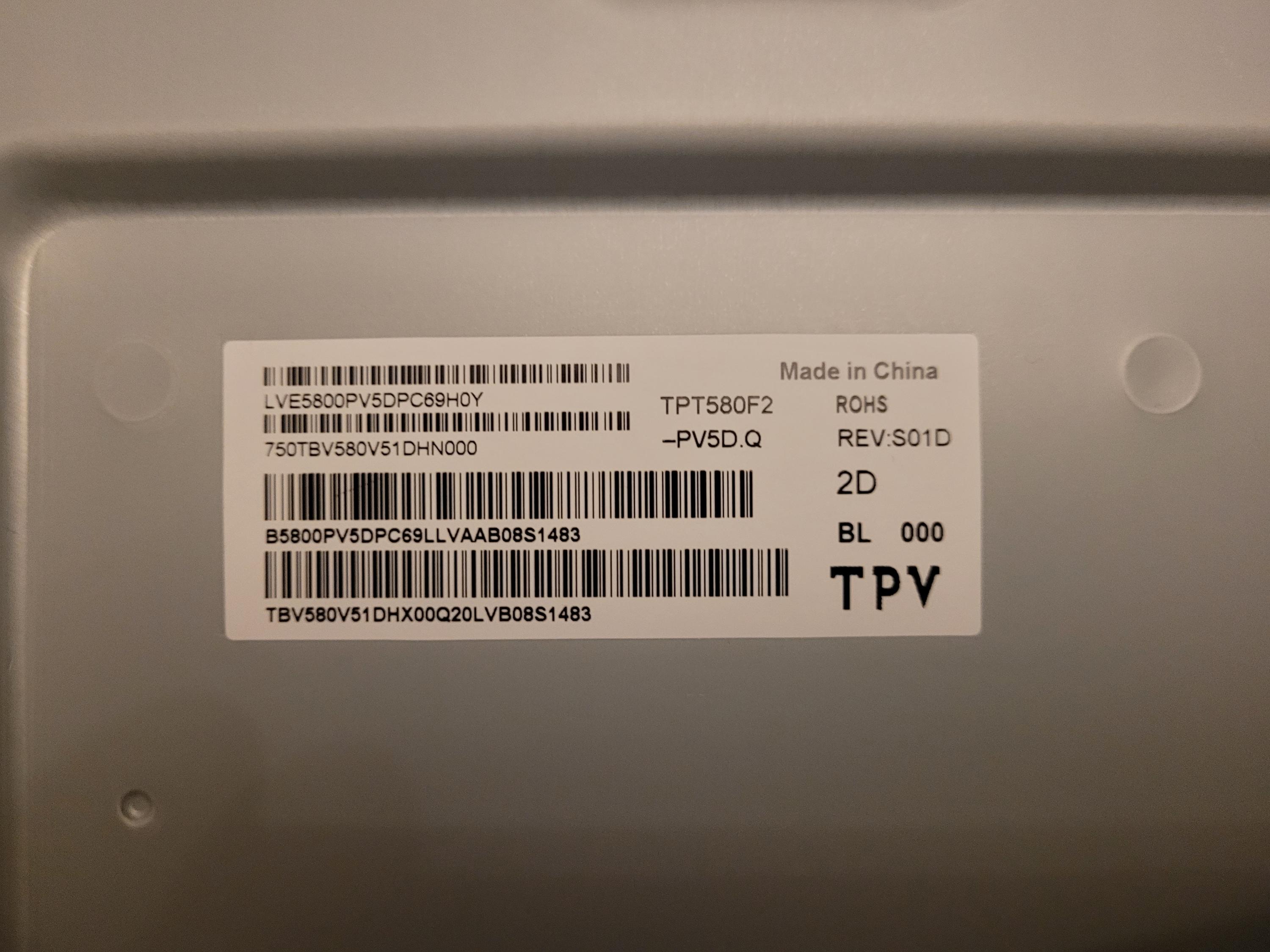

              Hello, this is my first post on this forum, and my first attempted to repair a TV.
              My Philips 58PUS7805/12 stopped working recently. It is not that old, about 5 years. We were on a trip for a few days and when we came back, it had stopped working out of a blue (Perhaps our house was hit by a lightning strike? Don't know.)
              Read from a guide that I should test if the screen shows picture with one of the T-Con cables disconnected. Did that, it showed perfect picture (first on left, later on right side).

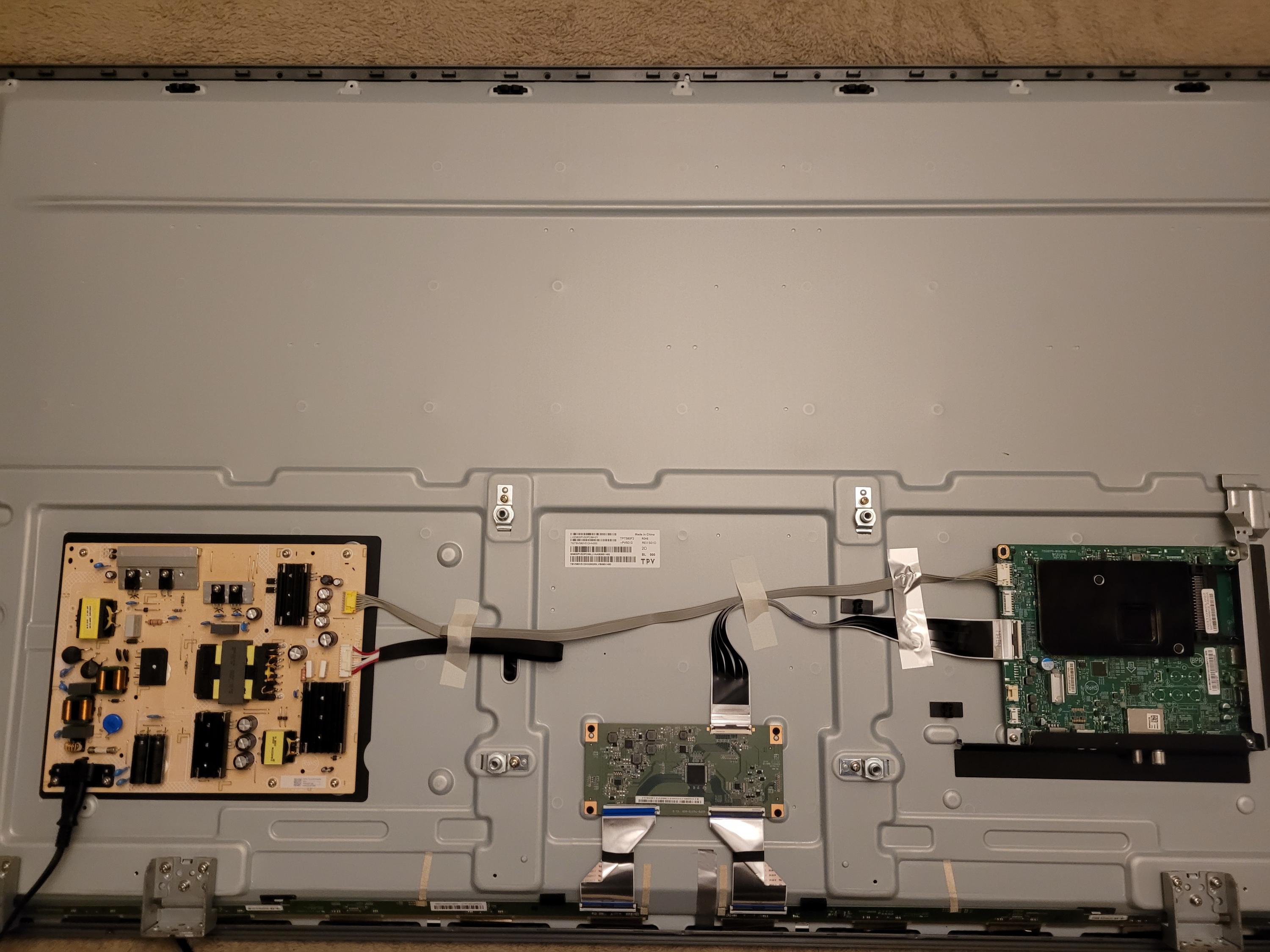

              VIZIO E70-E3 Half picture with half TCON
              by Fly_Among_Stars
              I have a VIZIO E70-E3.
              Symptoms: Black screen, no picture, but LED backlights are working.
              I probed the power board and voltages are as listed on the board.
              Main board appears fine, too.
              I believe the problem is either a bad T-CON board, or connection to LCD, or bad LCD.
              There are two separate ribbon cables feeding the LCD.
              If both are connected, the screen is black.
              If only the ribbon cable that feeds the right side of the screen (when viewed from the front) is disconnected, the left side of the screen shows picture and...
              04-24-2023, 08:20 PM
