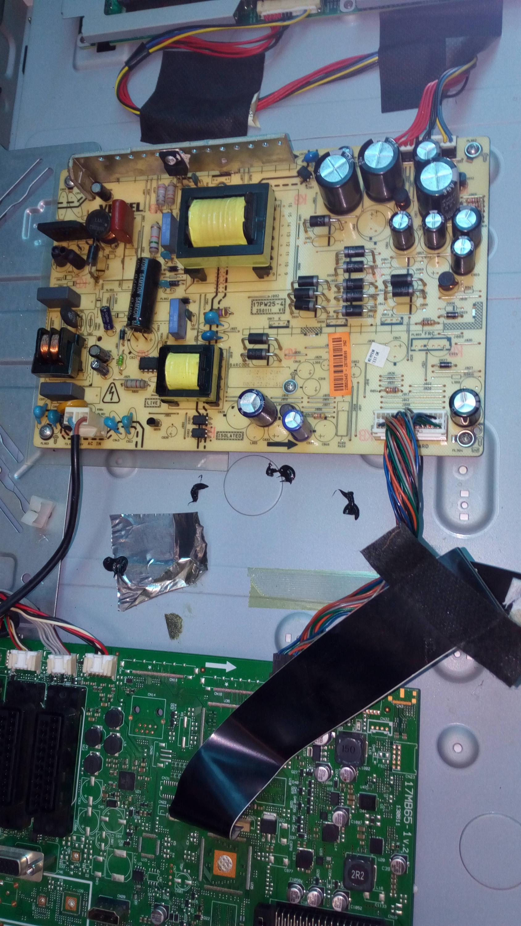

    Hello
    How is it going. I have a problem with one of this vestel crappy psu and though am not really that good tech of a guy but i really need solution to this.
    My tv keeps flashing blue led light and will not start. Sometimes when you up plug it and plug back in 2 or 3 times, the blue led will now steady (standby mod) and it will now power on. This have been going on for about 3 months and it pisses me off to sit and wait for your tv to take like 20 - 30 mins to com on.
    However, for about three days now, the set is not coming on again no matter how long a wait and plug and unplug, it doesn't just come on. Have taken it to two repair shops, one said is the main board (picture board) the other said it is the power board. Don't which to follow as both are costly to repay.
    I opened and check the power board and found out it is 17pw25-4 and i have read a lot of negative threads on that board. Their is nothing like blown diodes or capacitors or resistors their and am puzzled.
    What should i do? I have attached the picture of it to this post.

      Re: Vestel 17PW25-4 Alternative Board
      Disconnect the Mb, do you get 12v, 24v and 5v on the second side of the diodes on the Psu ? If so Psu is fine and Mb issue. You need to diagnose it before chucking boards at it. If the mainboard is a 17MB60 etc probably corrupt firmware. Also most times you can use a 17PW26 which is more reliable however it might need you to move some wires over on the connector.

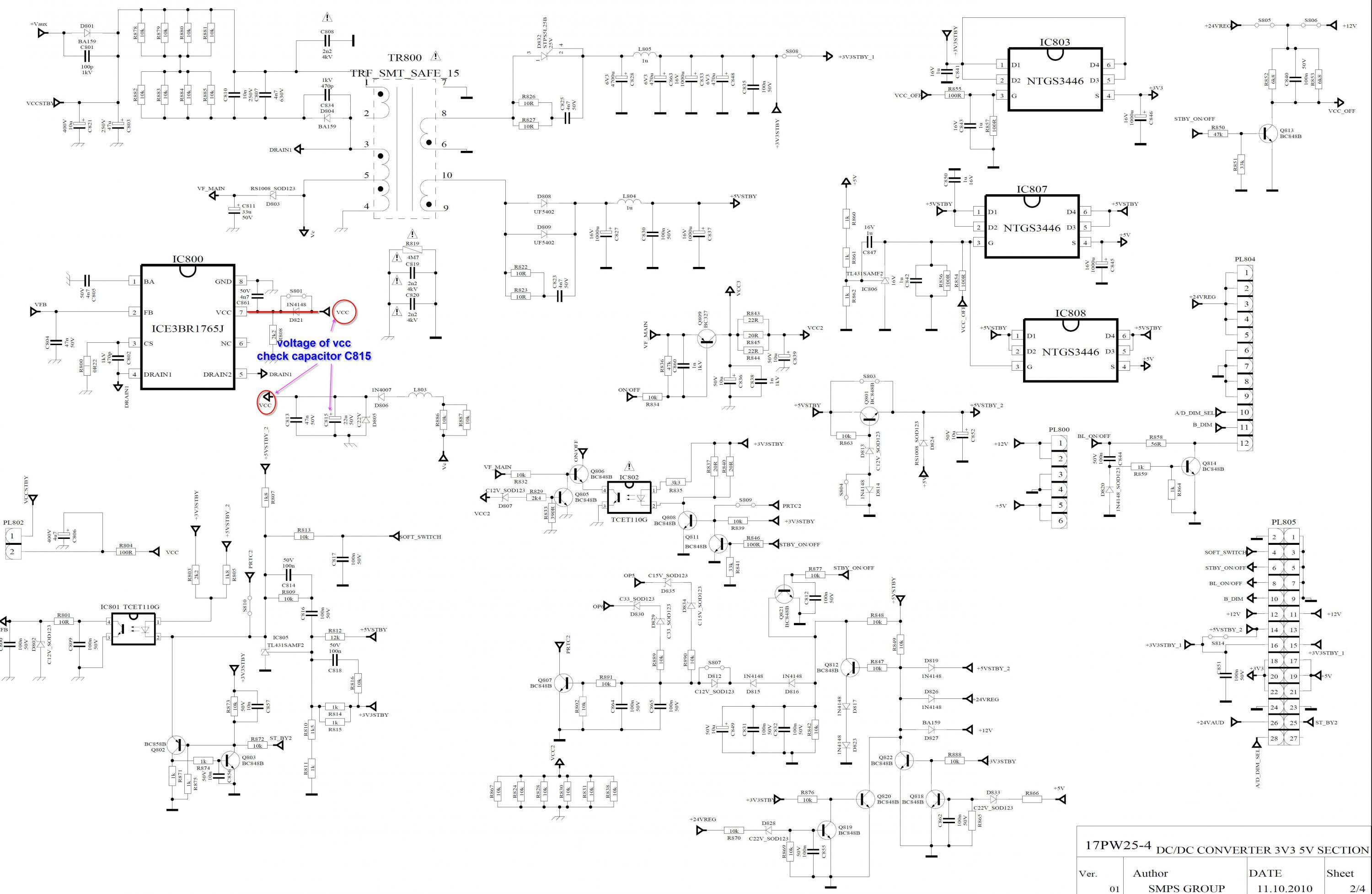

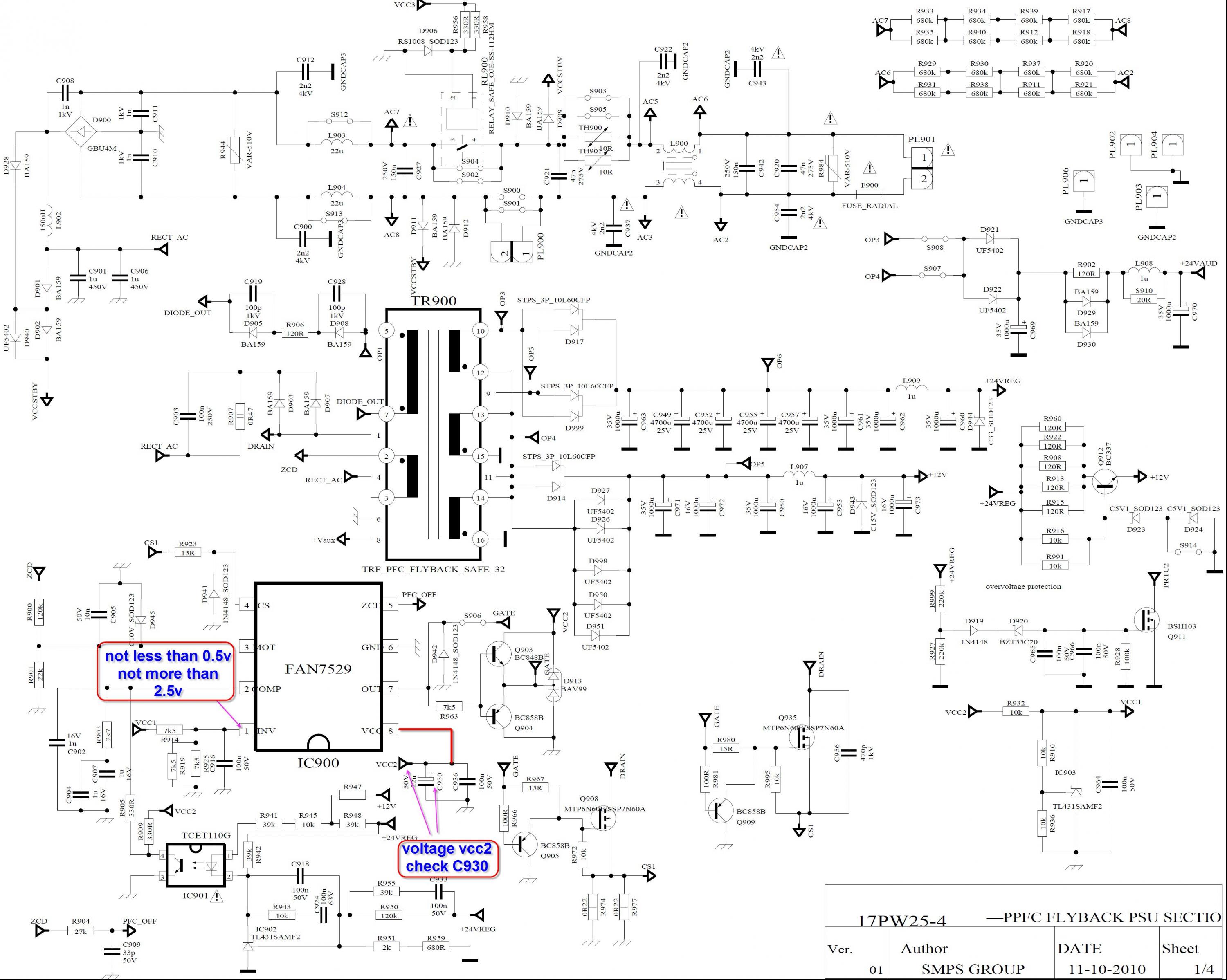

              HI
              I think if we look at pic we can find answers for the psu .
              vestel power supply has its own special treatment in dezine .
              I think schematic is good .
              thanks
                Hi, thanks for your quick reply, after disconnecting the mother board, the volts on the psu are fine and are at 12v, 24v, and 5v.
                The mb is 17mb65-1 v.2
                is it a firmware problem? cuz i can't even see anything shorted or blown. And are u suggesting i get a psu 17pw26 and do some modifications before use??

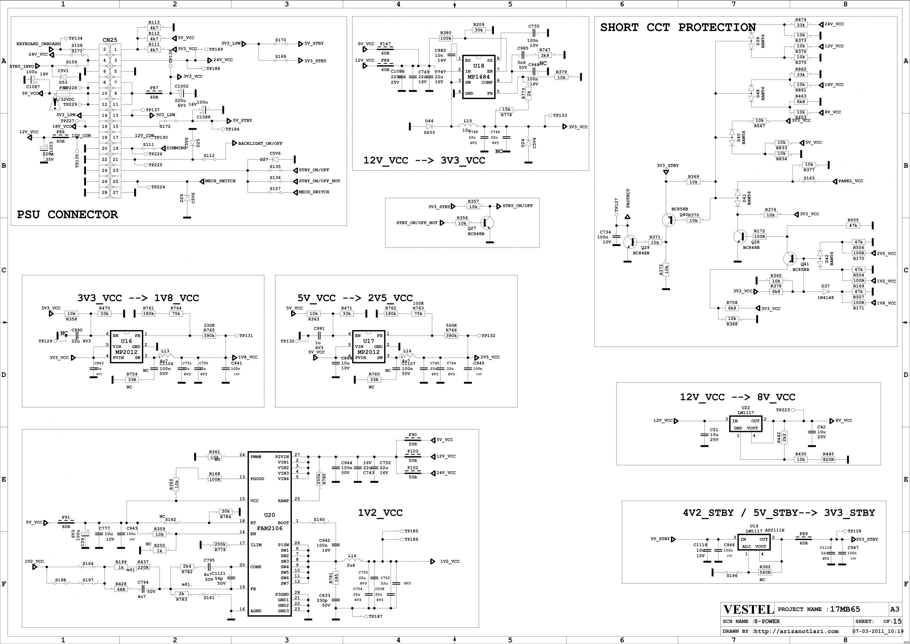

                          hi
                          this is the power supply for main board 17mb65 for vestel tv .
                          thanks
