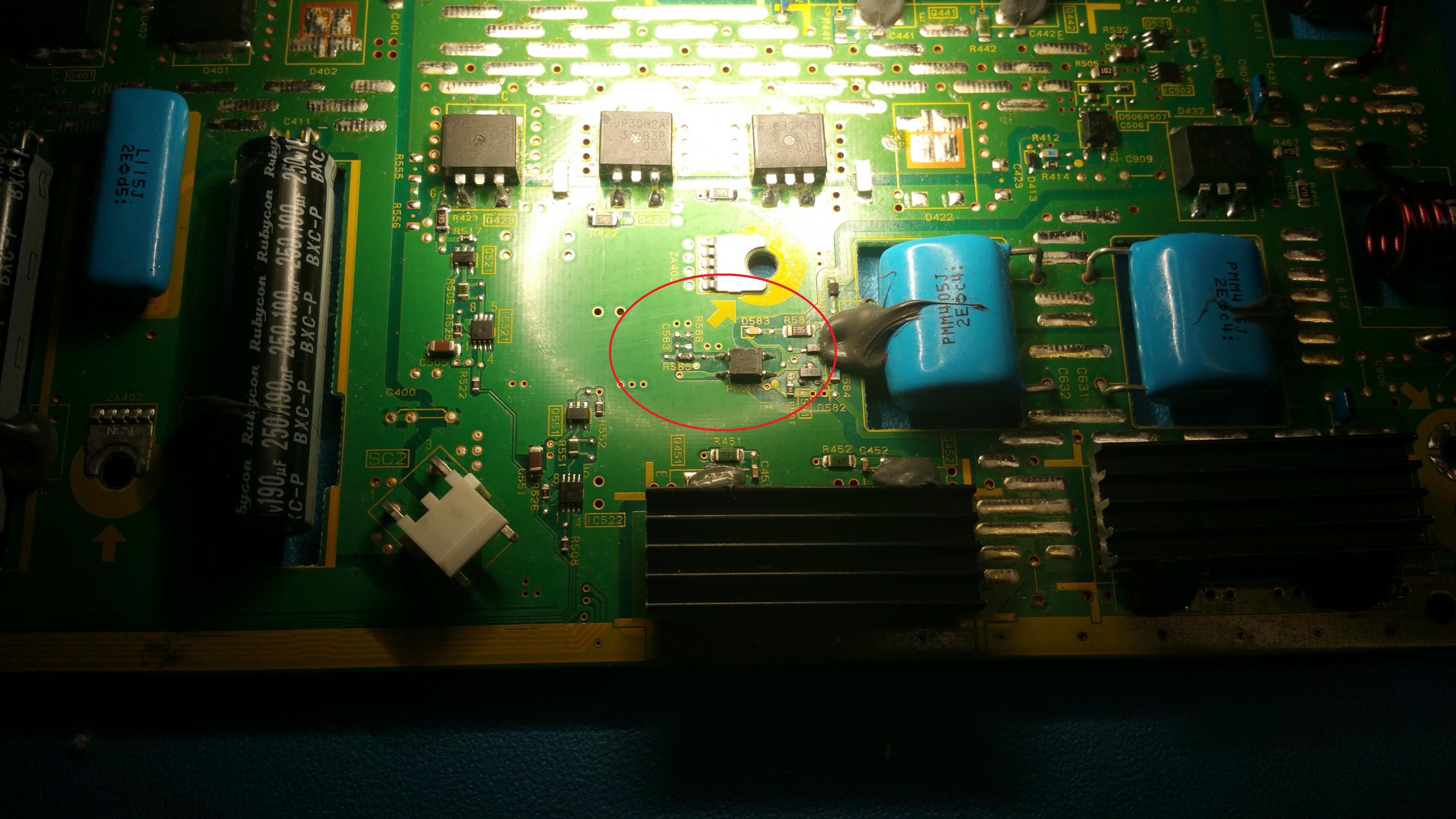

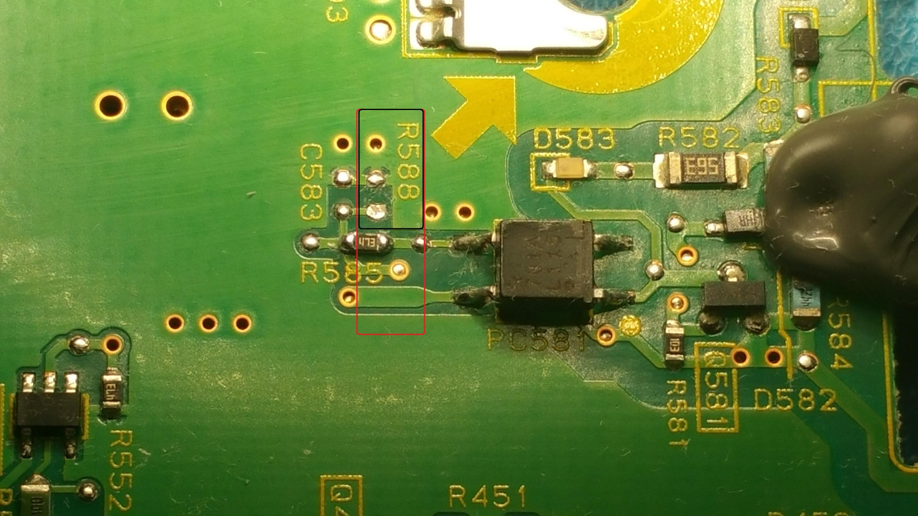

    Rookie mistake - I know.. I'm hoping one of you Gurus can help me out.. I was working on the SC board (TNPA5335 SC) of a Panasonic TC-P50GT30, and the soldering iron slipped and I accidentally knocked 2 small resistors off the board.. I found one, but I can't find the other one. I would be grateful if some one can tell me the value of Resistors R588??? or just read off the numbers?

    Re: Panasonic TC-P50GT30 - Resistor Value on SC board
    what were you doing poking around there?

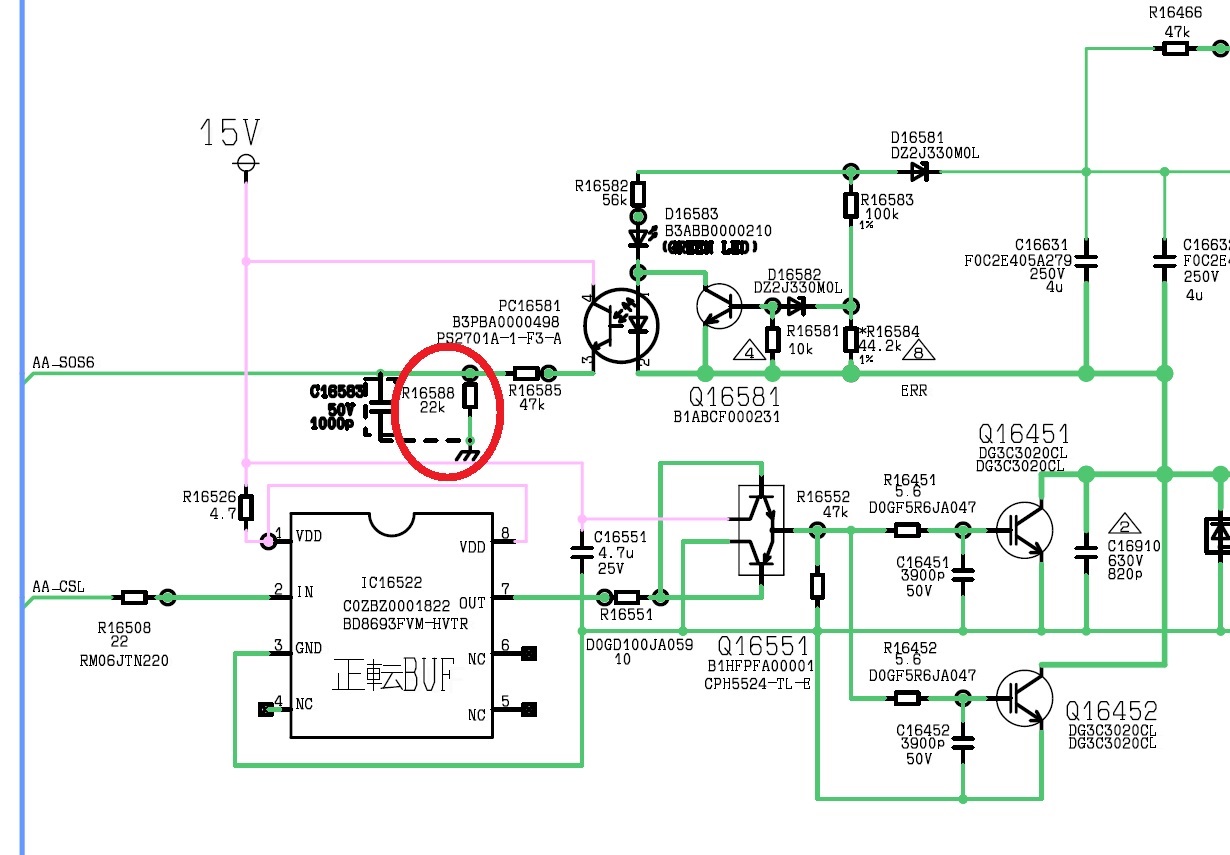

    22K ohms
    Of course if you simply went to the service manual and located it in the spare parts list that too would tell you.
    R16588 D0GB223JA065 M 22KOHM,J,1/10W
      Thank you so much tw2005. I couldn't find the service manual / schematic for that board. I was replacing the Transistors above that area and one was stubborn and I pushed it with the soldering iron a bit too much and knocked off these resistors.. Thank you again
