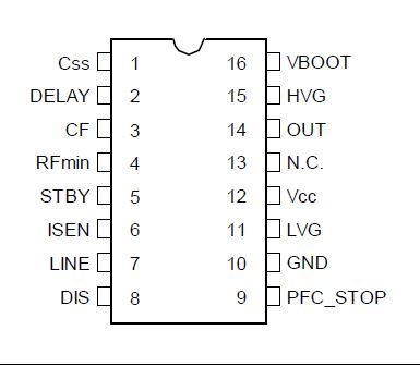

                      Test the voltage on the VCC pin of the L6559 very carefully.
                      The DC voltage between Pin12 (VCC) and ground (negative leg of large capacitor) should be 10 -11.5V at turn on with a maximum voltage of 16V

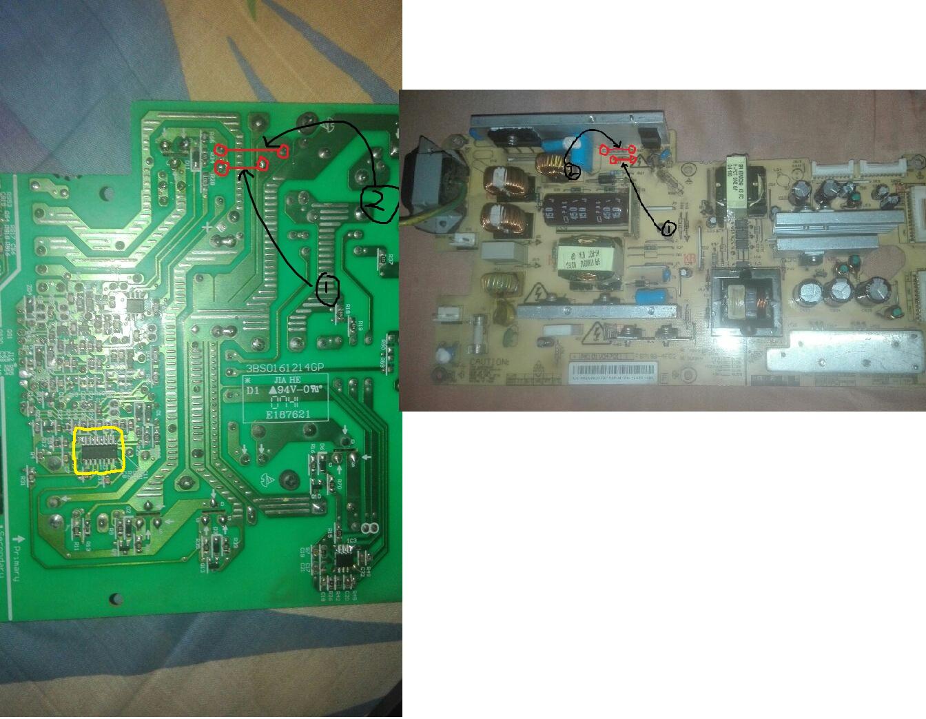

                                  Re: LCD TV won't turn on. LED keeps blinking
                                  i checked the ic
                                  VCC and the GND are connected (both are GND) :o
                                  there are some issues i checked the board
                                  a diode and transistor connected to GND line. (both sides)
                                  i cant find, where is the short or the bad component.
                                      im not sure what your checking you need to test the ic by putting negitive multi meter lead onto negitive side of the large capacitor and then the red multimeter lead onto pin 12 of the ic and take the voltage reading be carfull not too let the probe slip as can short out small pins easily ive marked the ic you should be checking with a yellow outline

                                        #59
                                        is it okay, VCC and the GND in the IC..... are both connected to common ground line?
