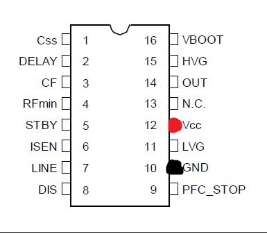

    red lead for the 12th pin its ok. and black pin for? i didn't get it
    like this?

      Re: LCD TV won't turn on. LED keeps blinking
      the large capacitor you have been testing 325 v on use the negitive side of that capacitor for your black multimeter test lead,
        0.85v in vcc and the - cap
        board is not connected to the tv. but powered and switched on
          ok thanks now we need to trace back and see why the voltage is so low bear with us as im still leaning myself so maybe dick or budm can advise what too check next as i cant seem to fnd a schematic/service manual for your set
                with the tv turned off and unplugged what RESITANCE do you get between the vcc pin and ground pins like you marked in your picture .
                  310 k ohms

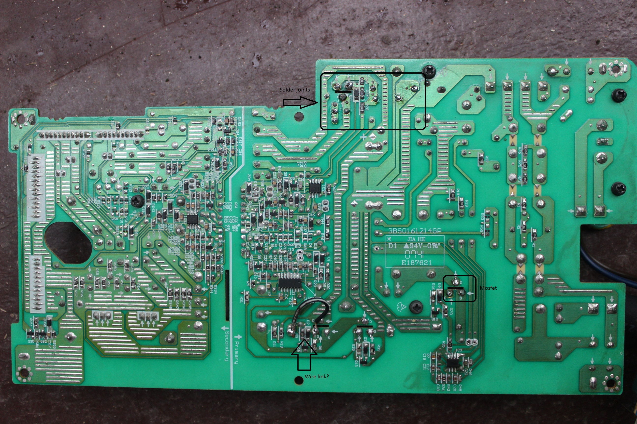

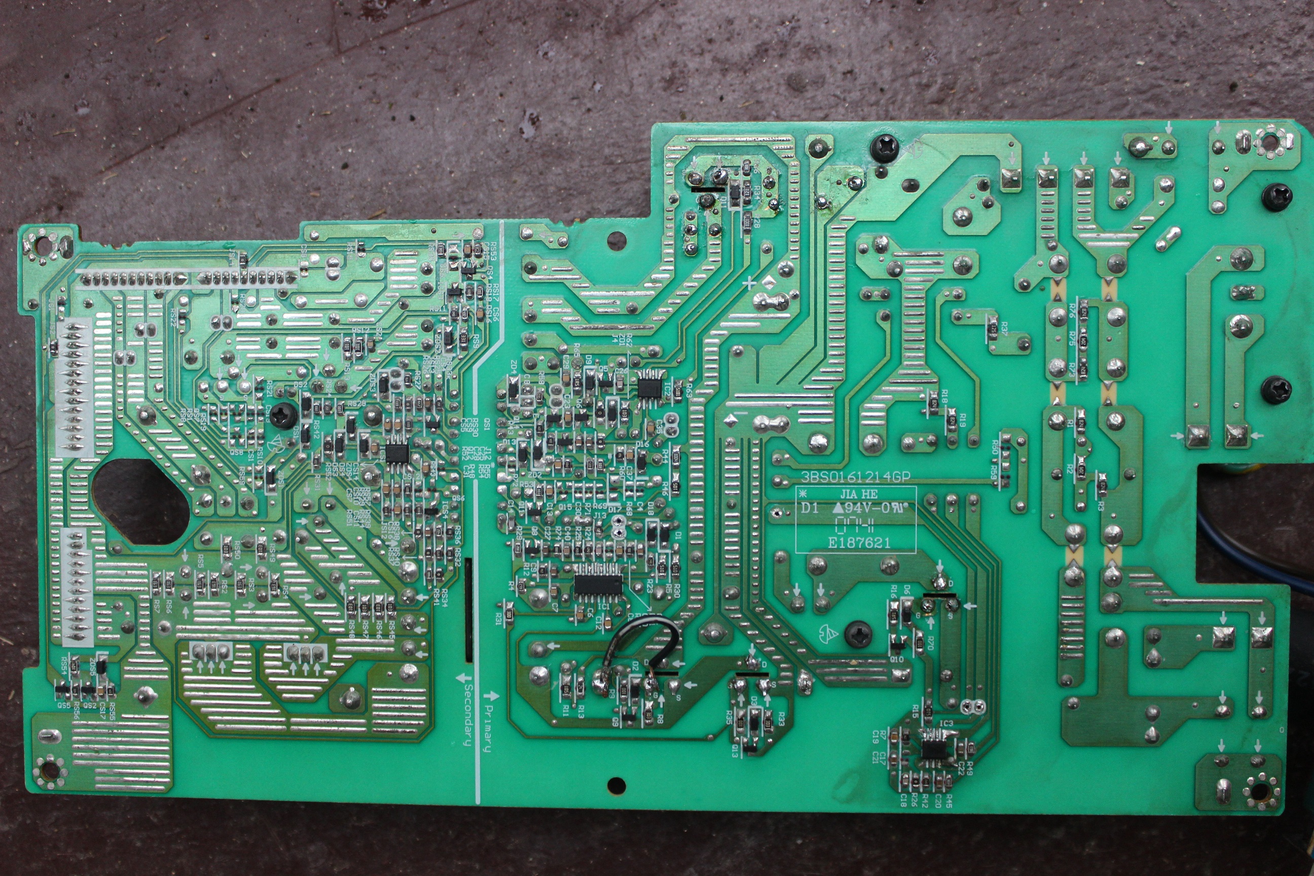

                    Can you post clear bright pictures of the top and bottom of the power supply board. Take it out into the sunlight and take the photo's. It's difficult to identify anything on the boards.

                          #72
                          Why is there a piece of wire connected from R9 to G of mosfet?
                          There are quite a few solder joints that do not look very good.
                          I see that some of the mosfets have been taken out. Have they been checked using your ohm meter
                          Have you also tested D8, ZD3, D12, Q4, ZD3 and D4 using your ohm meter?
                          I think it would be best to order a replacement power supply.

                            #73
                            solder joints are now ok. i checked them.
                            i replaced all components .
                            the wire is now not on the board. it soldered by me.
                            i soldered the wire because Q1 is not connected to the GND i thought the path is missing. but the wire did not solve the issue
