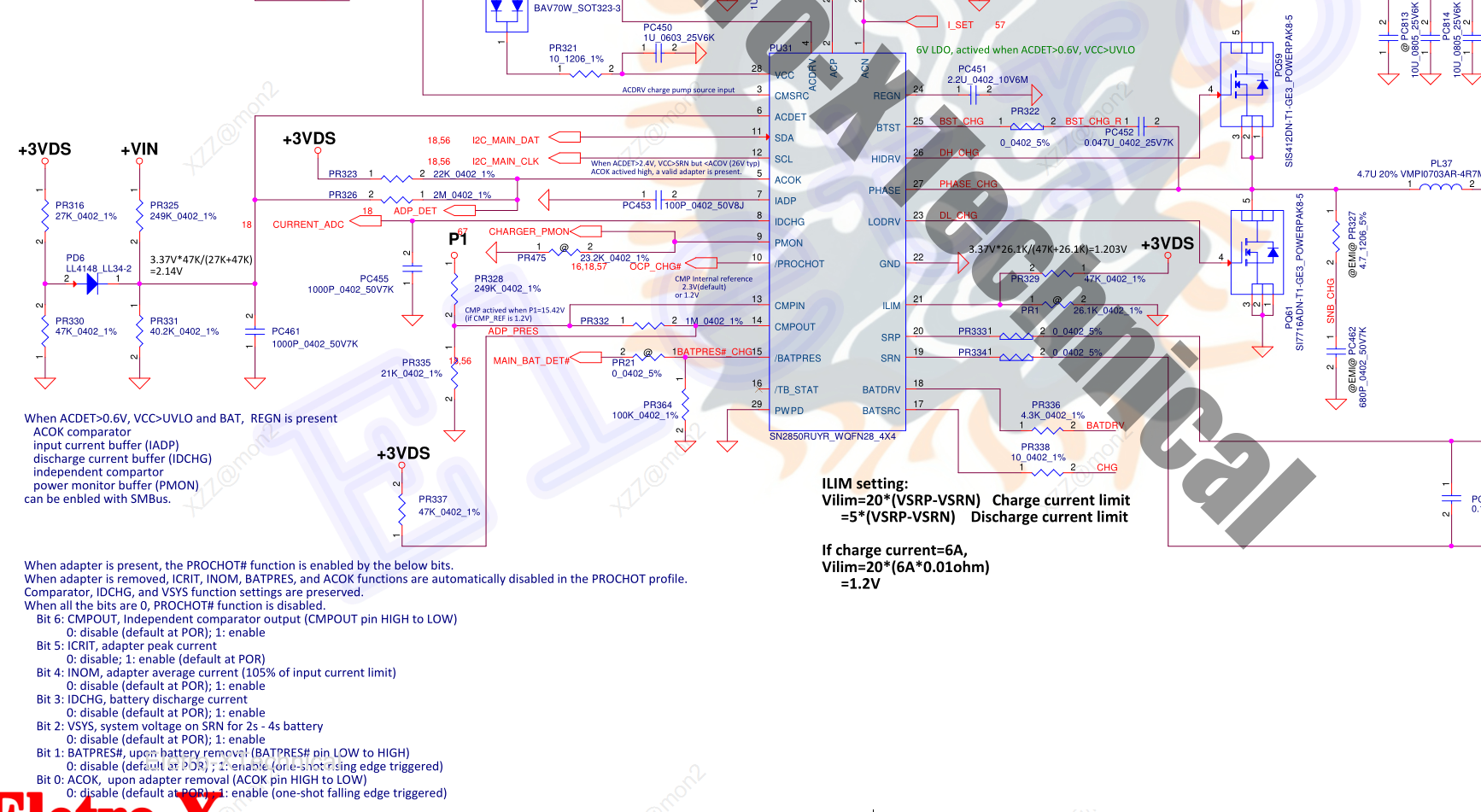

    Hello
    I was looking for a schematic or board view but unfortunately I didn't find anything.
    By connecting the drain and source of pq58, the device turns on and works perfectly, but the battery doesn't charge, and I don't know the path of the circuit to the MOSFET.
    Is the problem with the adapter? Or is there a problem with the MOSFET activation circuit?
    Please guide me.
    Thank you.​

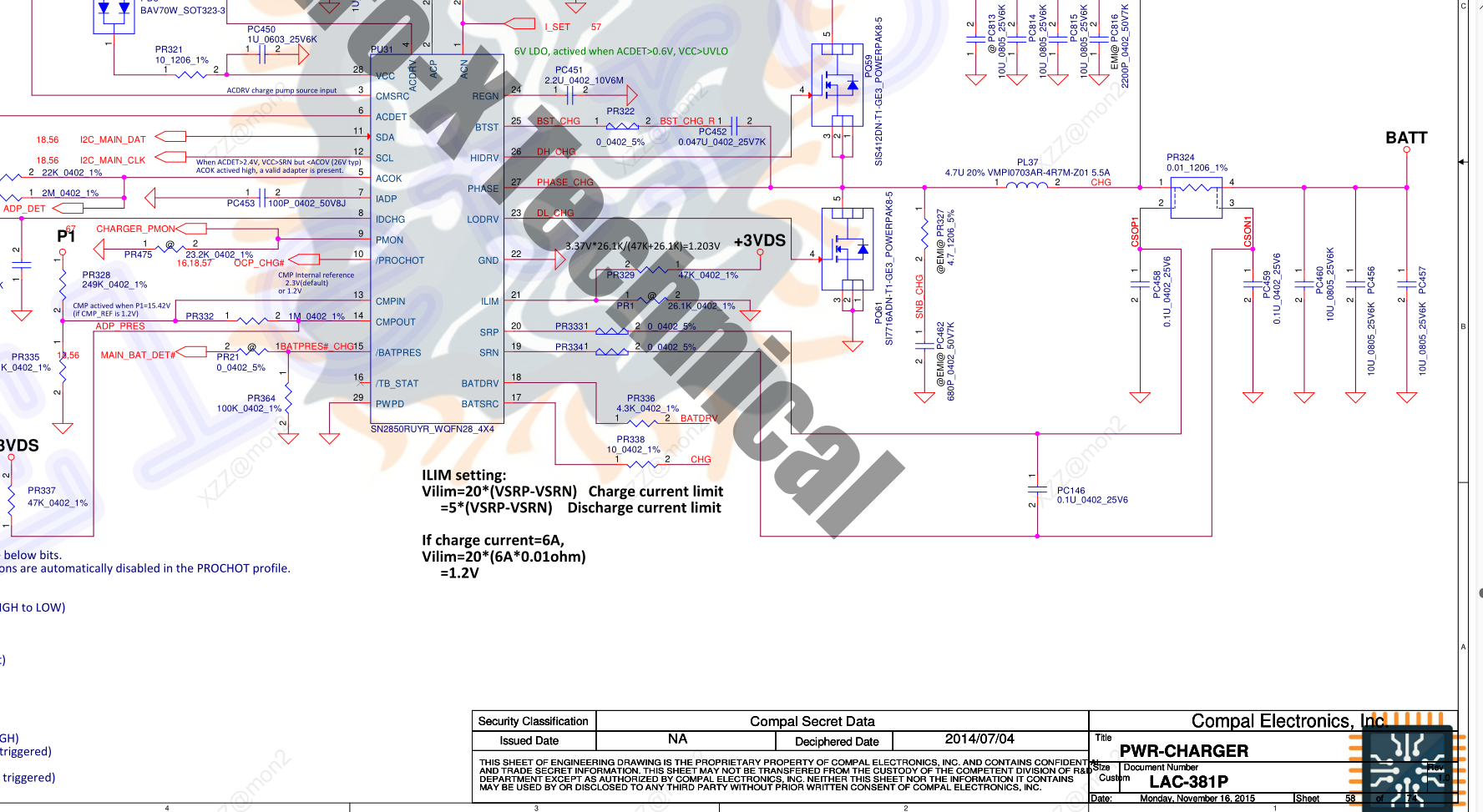

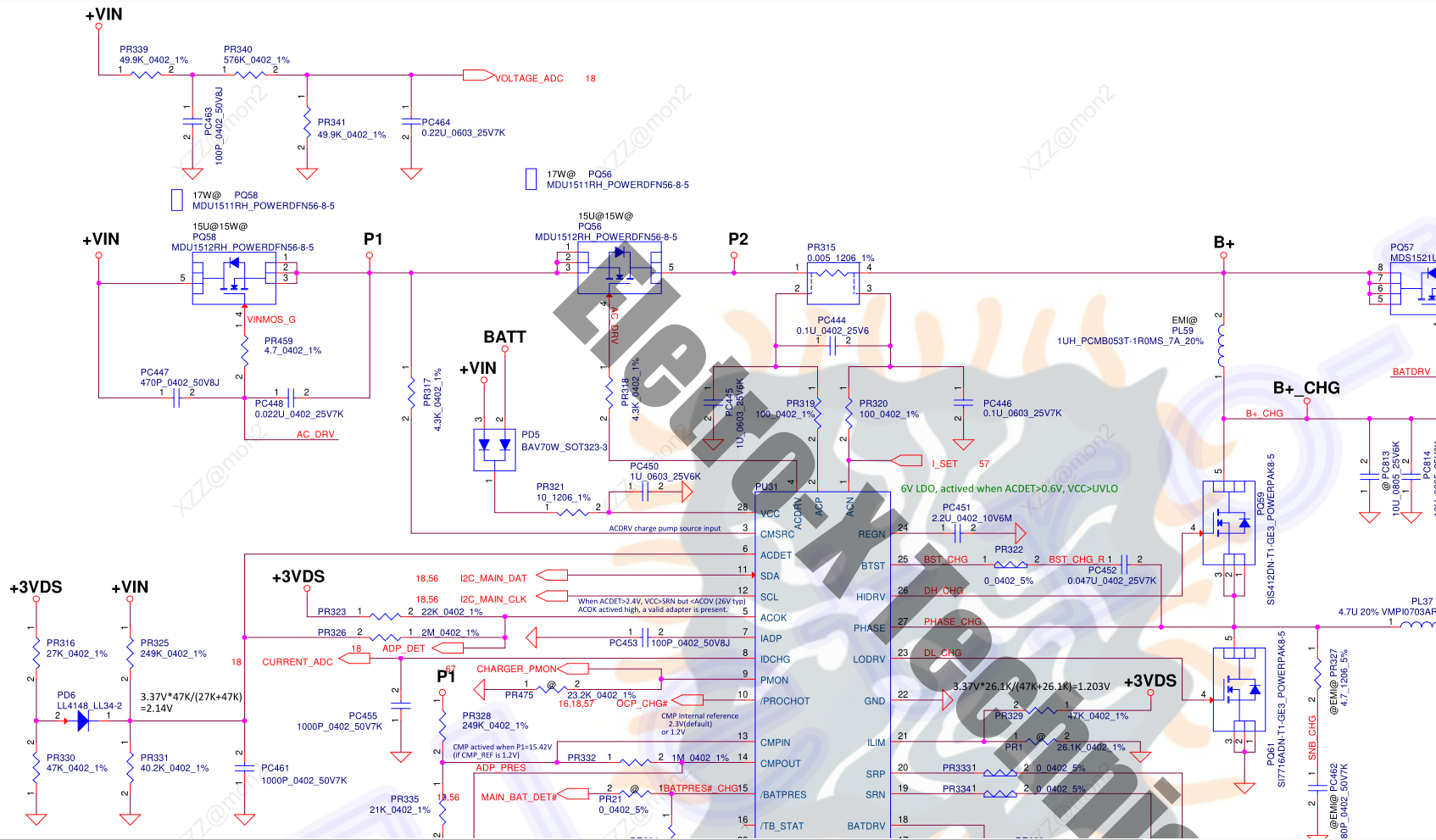

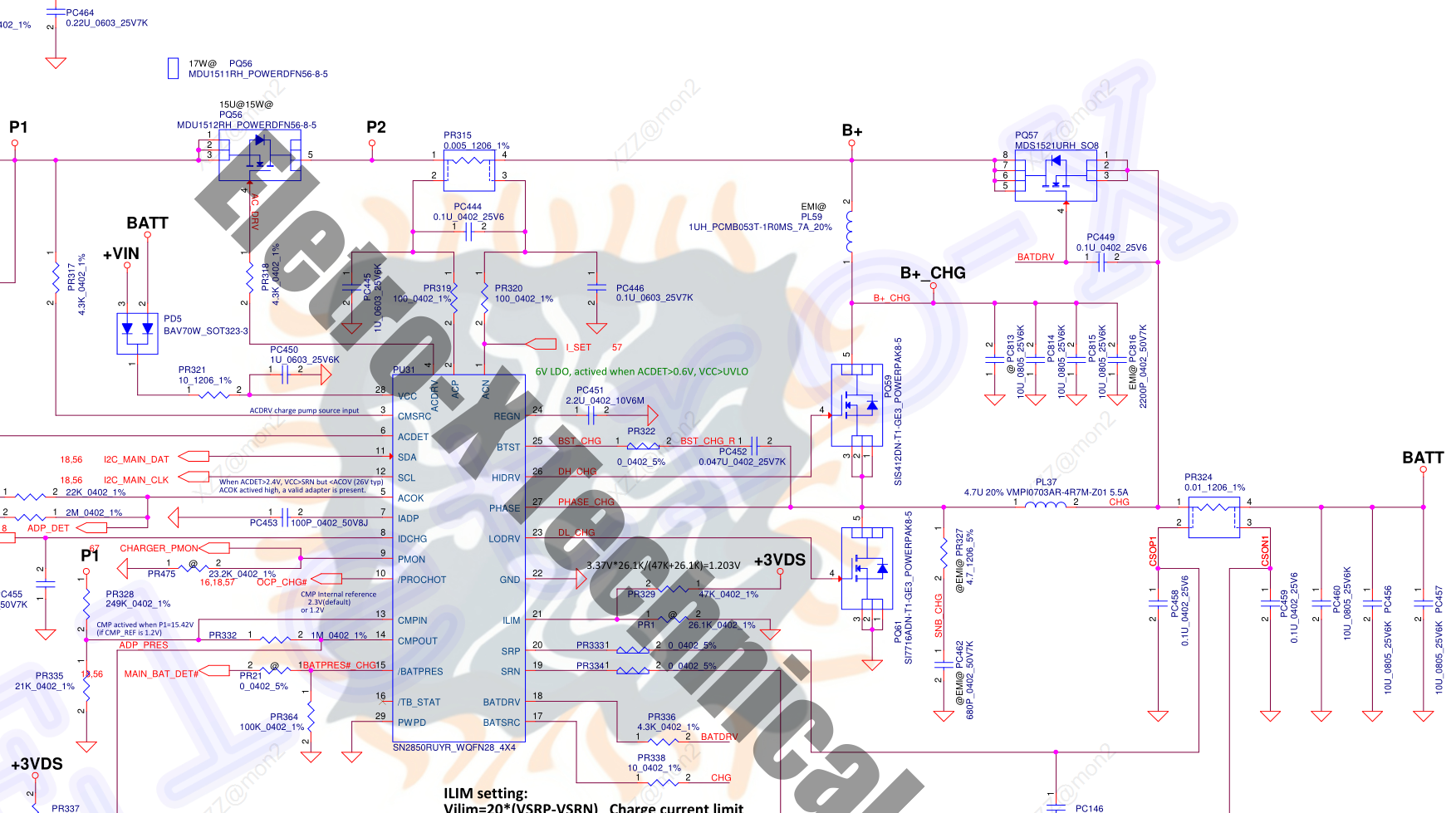

    From zbook 15 G3 schematic
    Click image for larger version  Name:	zbook1.png Views:	0 Size:	657.8 KB ID:	3527010

      I reached the BQ24780s
      ​ IC by following the path of the pq58 ( TPCA8057-H
      ) pins.

        The above schematic is the same as for your board.
        Remove all power. Meter in resistance mode. Measure the resistance across the mosfet pins to check if they are leaking.
        source (1-2-3) & drain (5-6-7-8)
        source (1-2-3) & gate (4)
        gate (4) & drain (5-6-7-8)
        Each measurement must be hundreds of k ohms or higher. Otherwise the part may be leaking and needs to be replaced. If found, flux and remove the part and allow it to cool. Then measure in the same way while the part is on your work table. Suspecting that the 1st DCin mosfet is defective.
        Carefully, measure the following voltage to ground for the following pins of interest with the adapter:
        ACDET ; pin 6
        REGN ; pin 24
        VCC ; pin 28
        ACDRV ; pin 4
