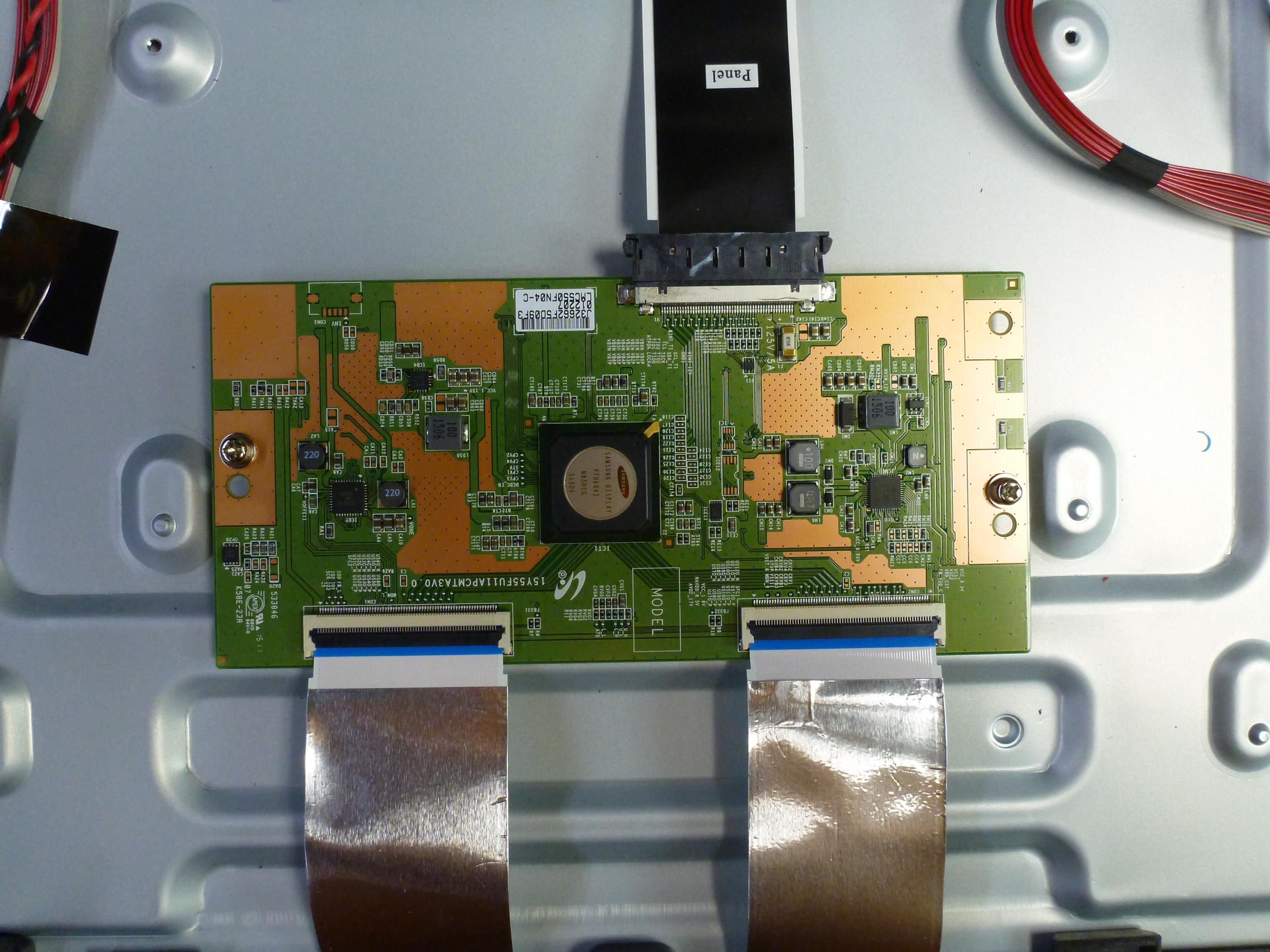

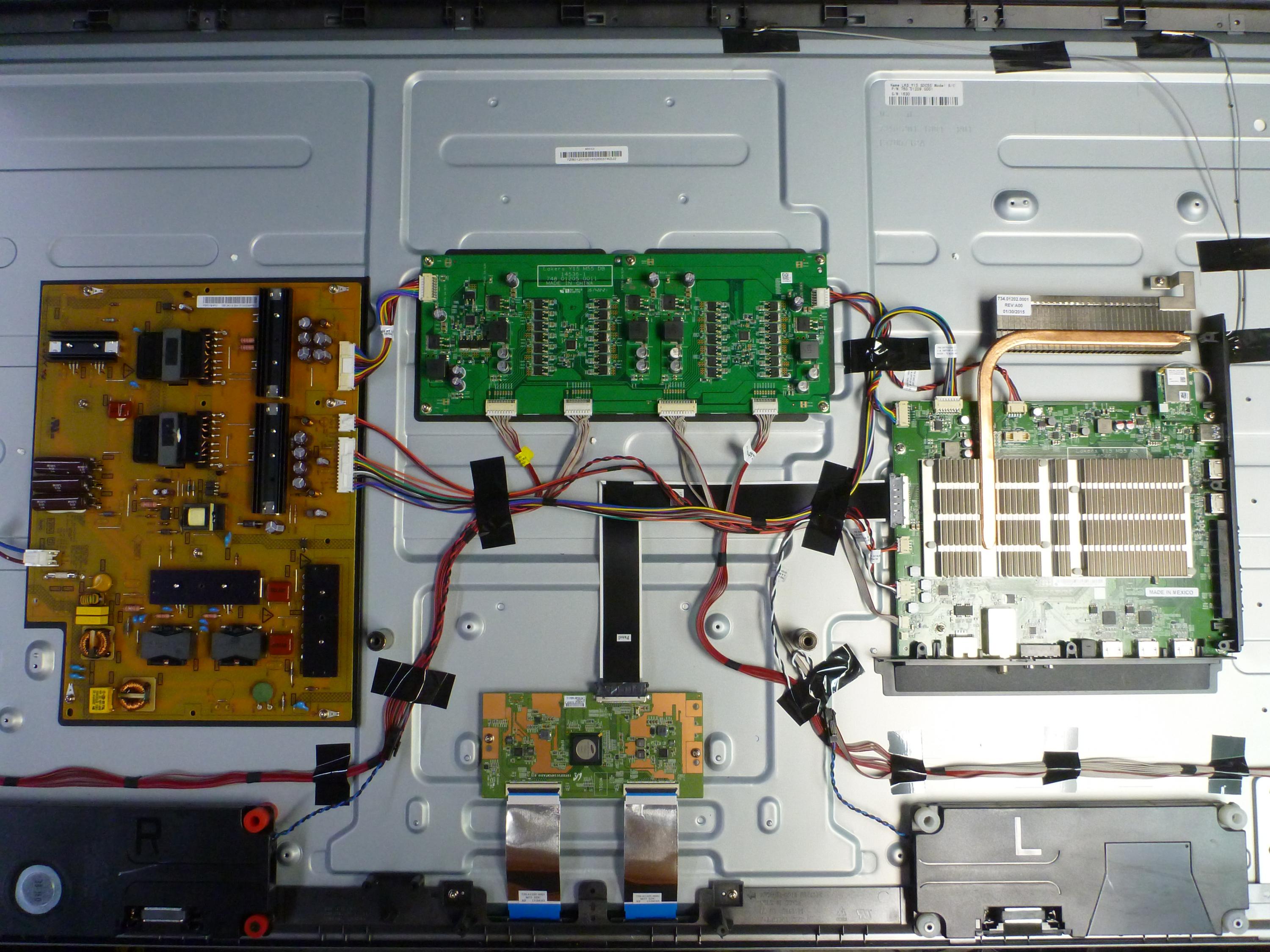

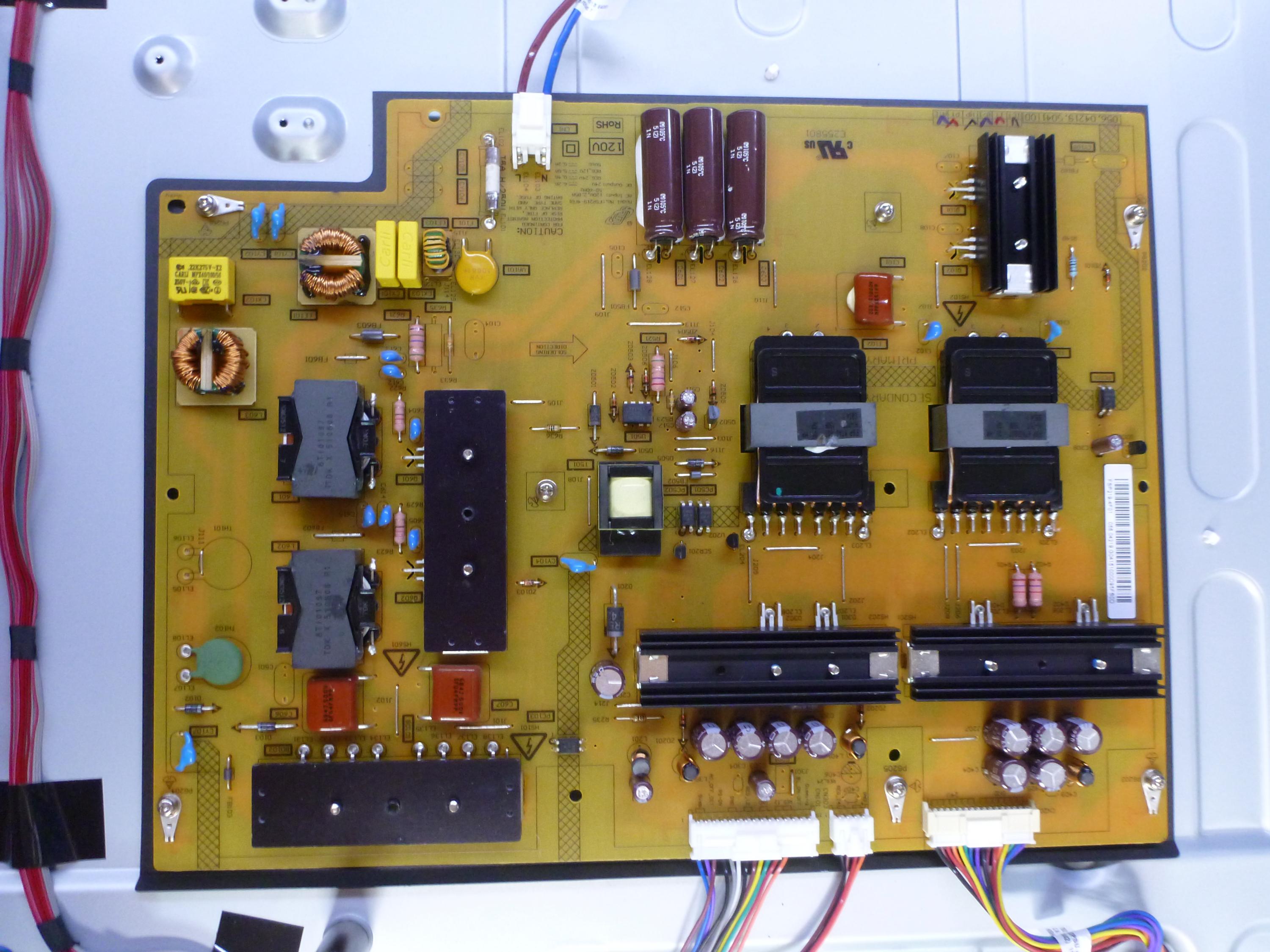

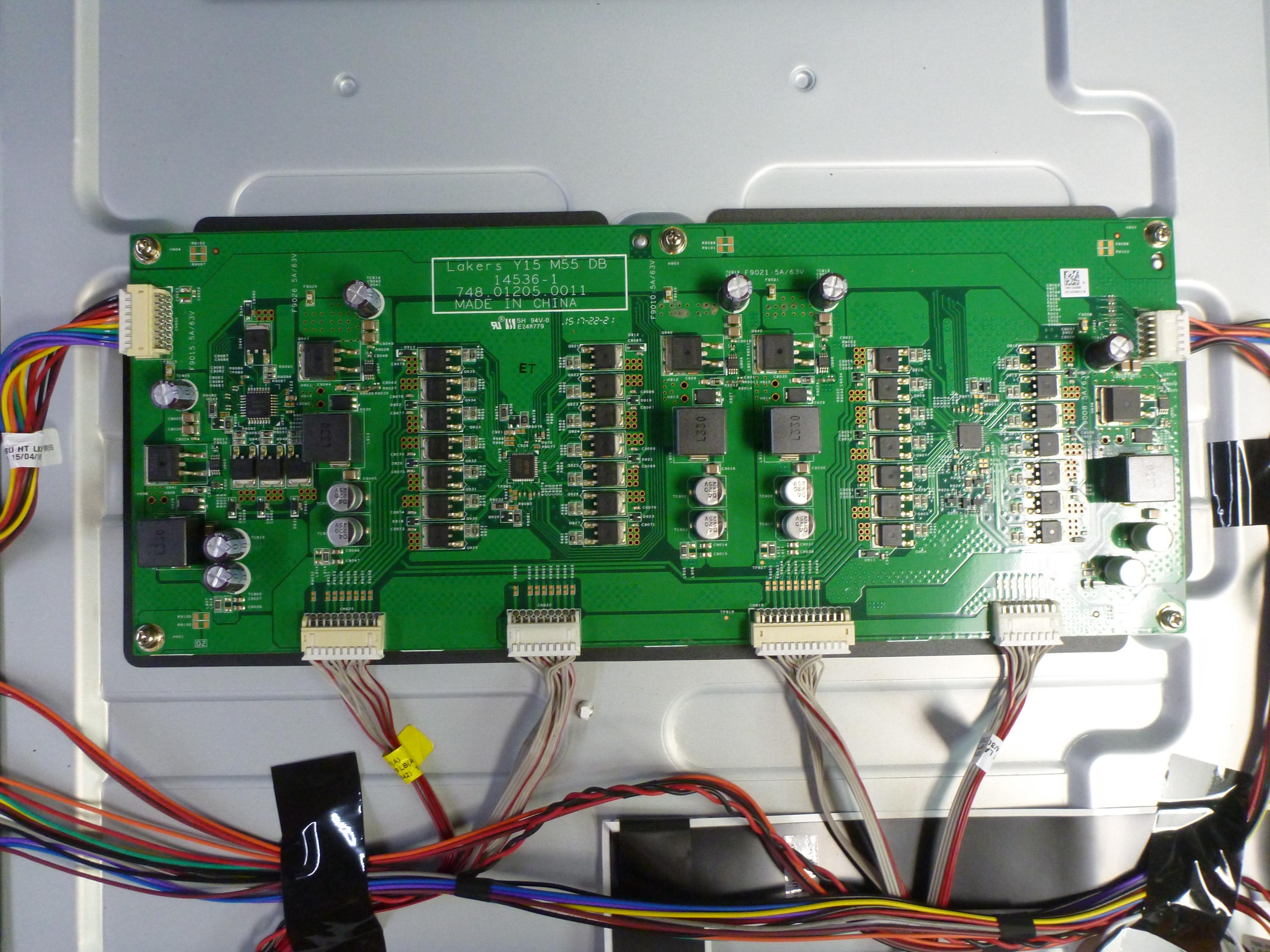

    Hello this is my 1st post to this forum so bear with me.
    I have a Vizio M55-C2 that I originally received as dead. It had received a surge thru the HDMI port.

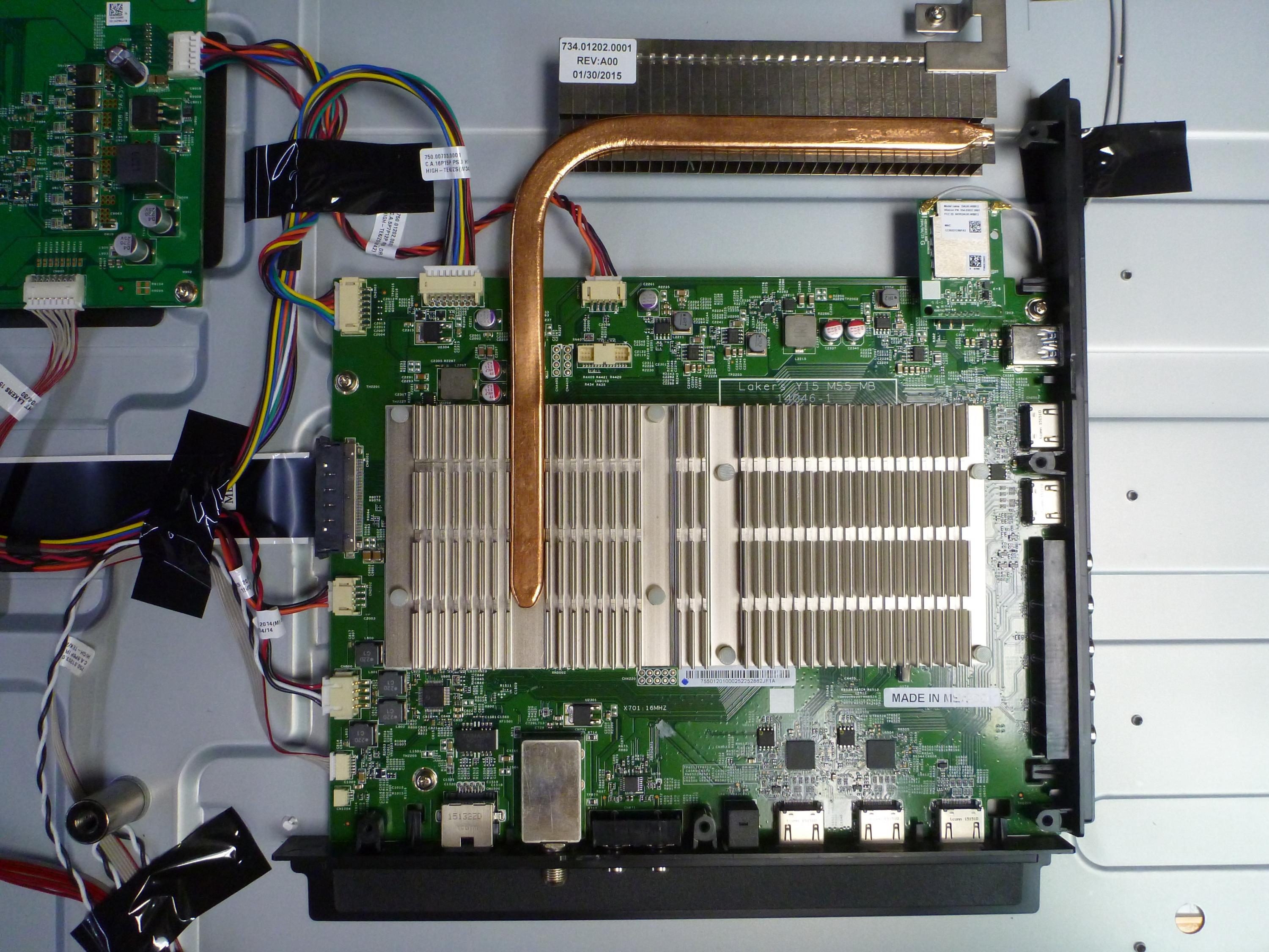

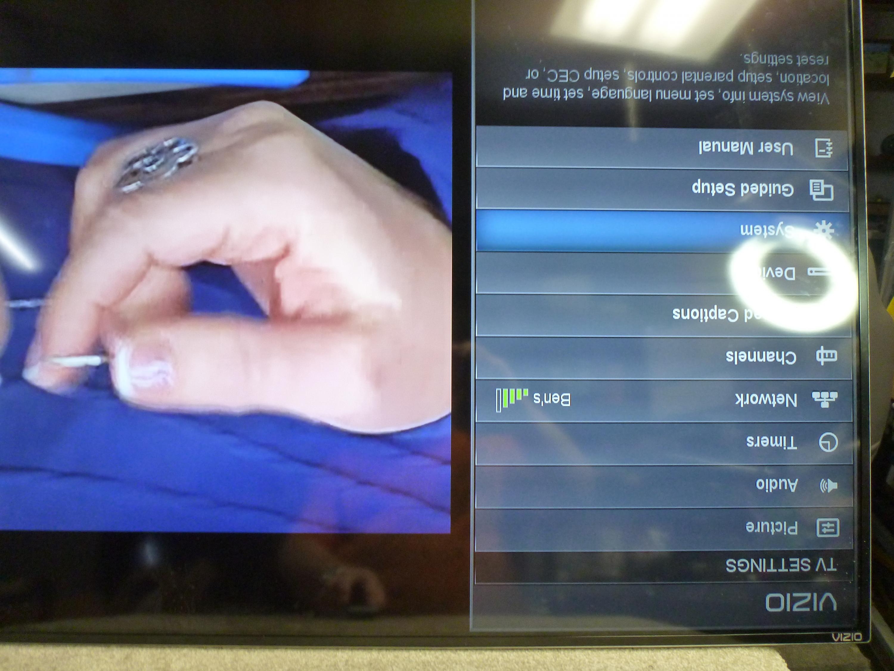

    I replaced the Digital main BD and set worked great but the picture and menu's are upside down.
    I originally thought setting in the service menu but none of the procedures for entering the service menu posted on this forum will work on this set.
    I have never experienced this before but other post suggested T-con board so I gave this a try. Still upside down.
    I returned my digital board suspecting corrupted eeprom and order new one and new board also has inverted picture and menus.
    I am back to square one trying to enter service menu. Does anyone have any experience with this model set?

    Re: M55-C2 Inverted picture.
    Reload correct firmware for the tv should fix the issue
                  Problem was never fixed.
                  Could never find out how to enter service menu.
                  Customer just took it home an mounted it back on the wall upside down and was very happy.
                      you may have the wrong main board install, did you order by the exact part number?
