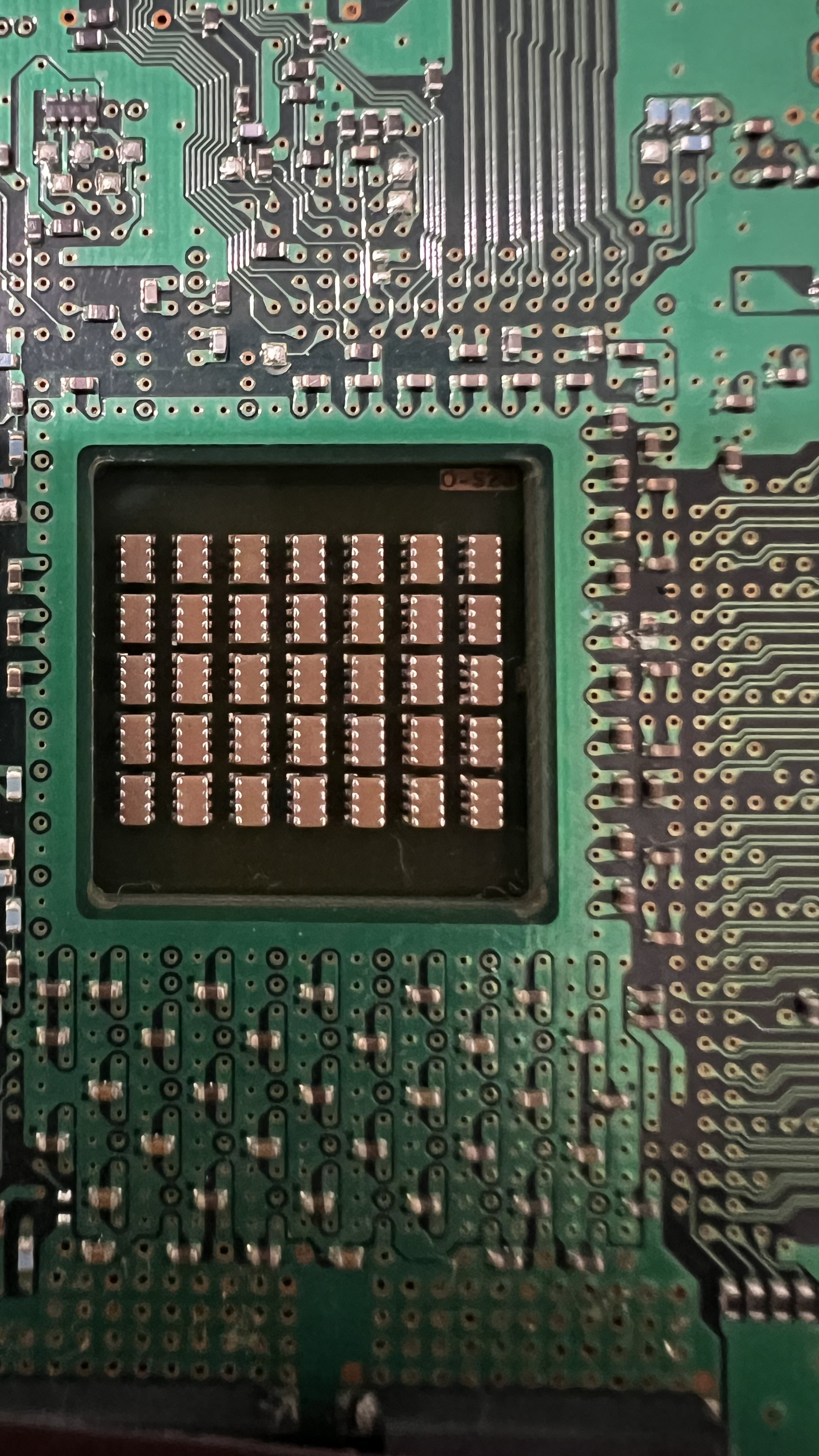

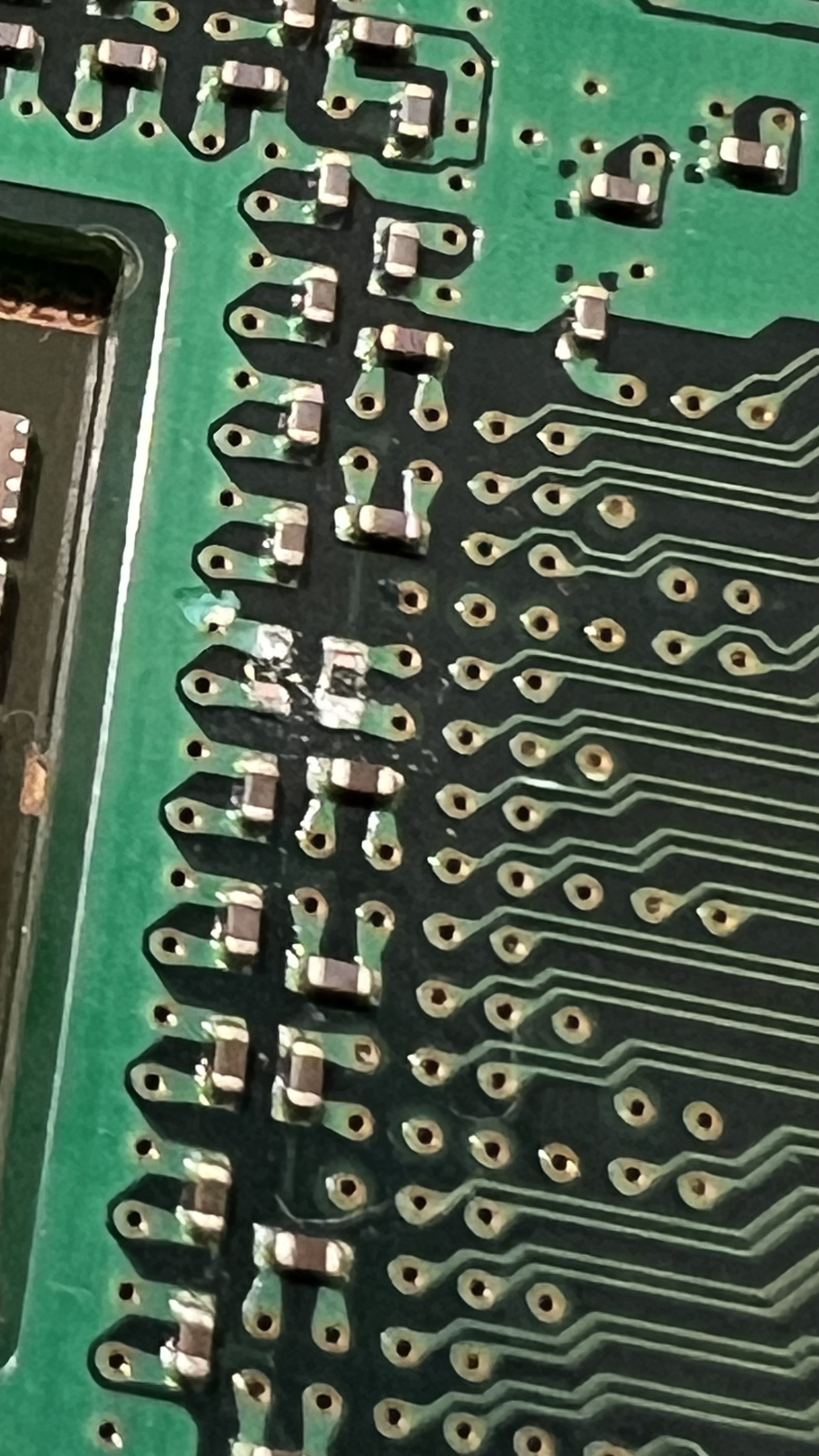

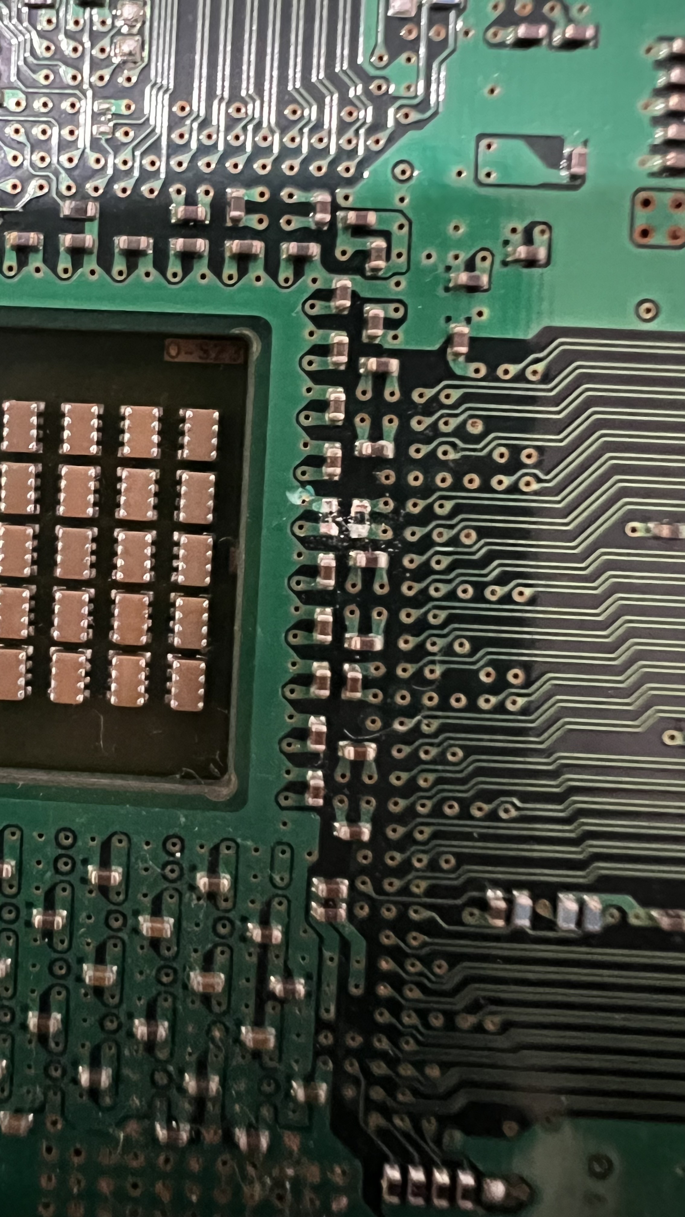

I have since added this extra information from last nights crack at it:
To add to this, I tried to get internal access again but still received the message of ‘scopen response invalid' and ‘AUTH invalid'. I tried reconnecting the Diag and TX but no luck. I've since desoldered them so I'll try soldering them again later. I have replaced the thermal paste and assembled enough to test. I get fan spin then it immediately turns off and I'm left with a red blinking light. It seems to be about 3 seconds before the yellow light flashes and the beeps appear. I'm stuck at this point on what to check next. I have followed @RIP-Felix guide and had success up until trying internal access.
Based on what I could find about 2110, I could do with the schematics to locate the 5V_MISC and other components mentioned plus some guidance. If there's something else you can think would be worth checking then I'm all ears. Thanks in advance. I can provide photos and videos if required.
