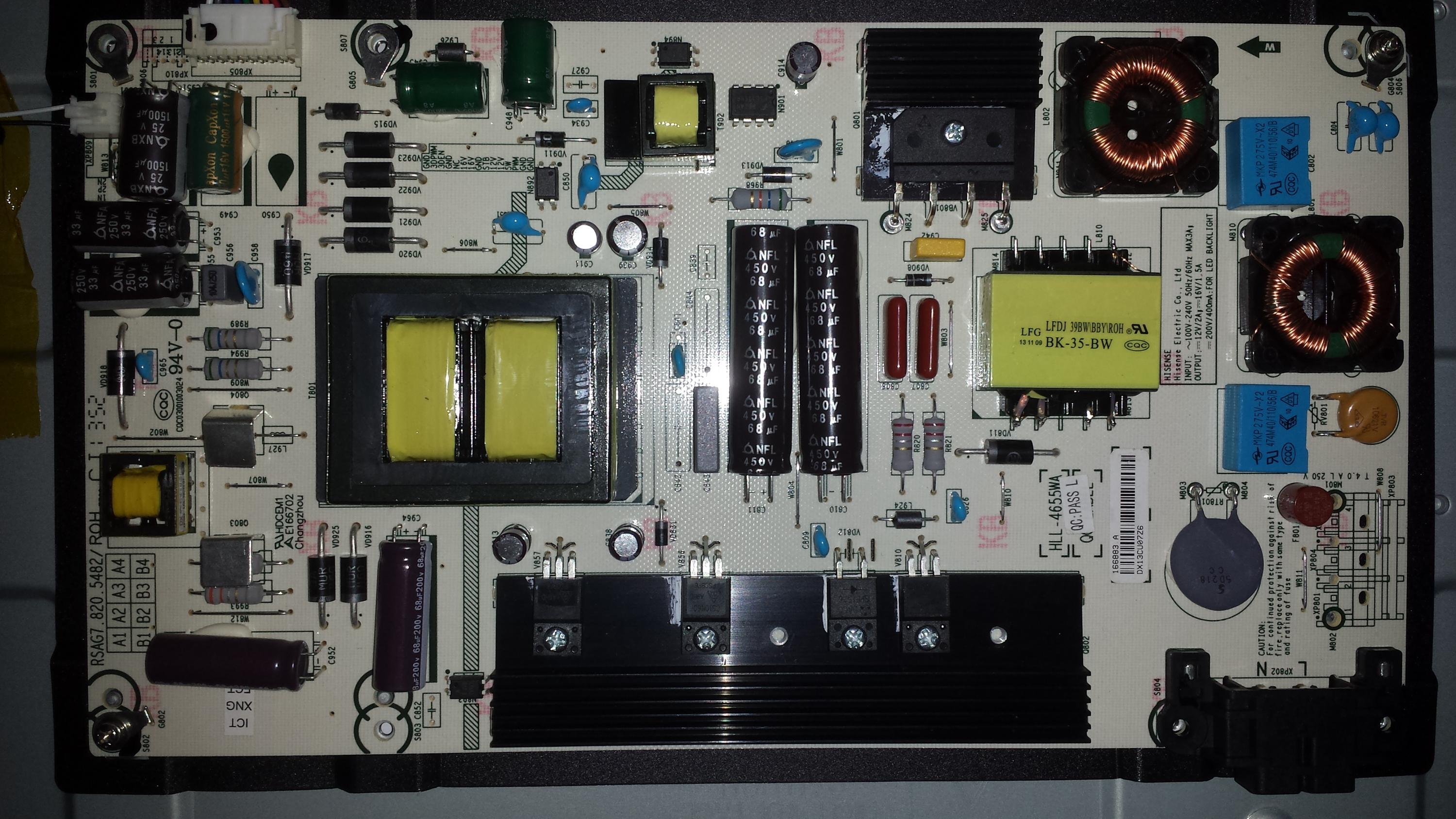

    Hello all, taking a break from the Vizio I've been working on to try and save this Insignia I picked up from the scrapper.
    Panel is good from a visual inspection, no apparent cracks.
    Plugging in the TV gives me a solid red light on the indicator panel.
    Pressing power, nothing changes.

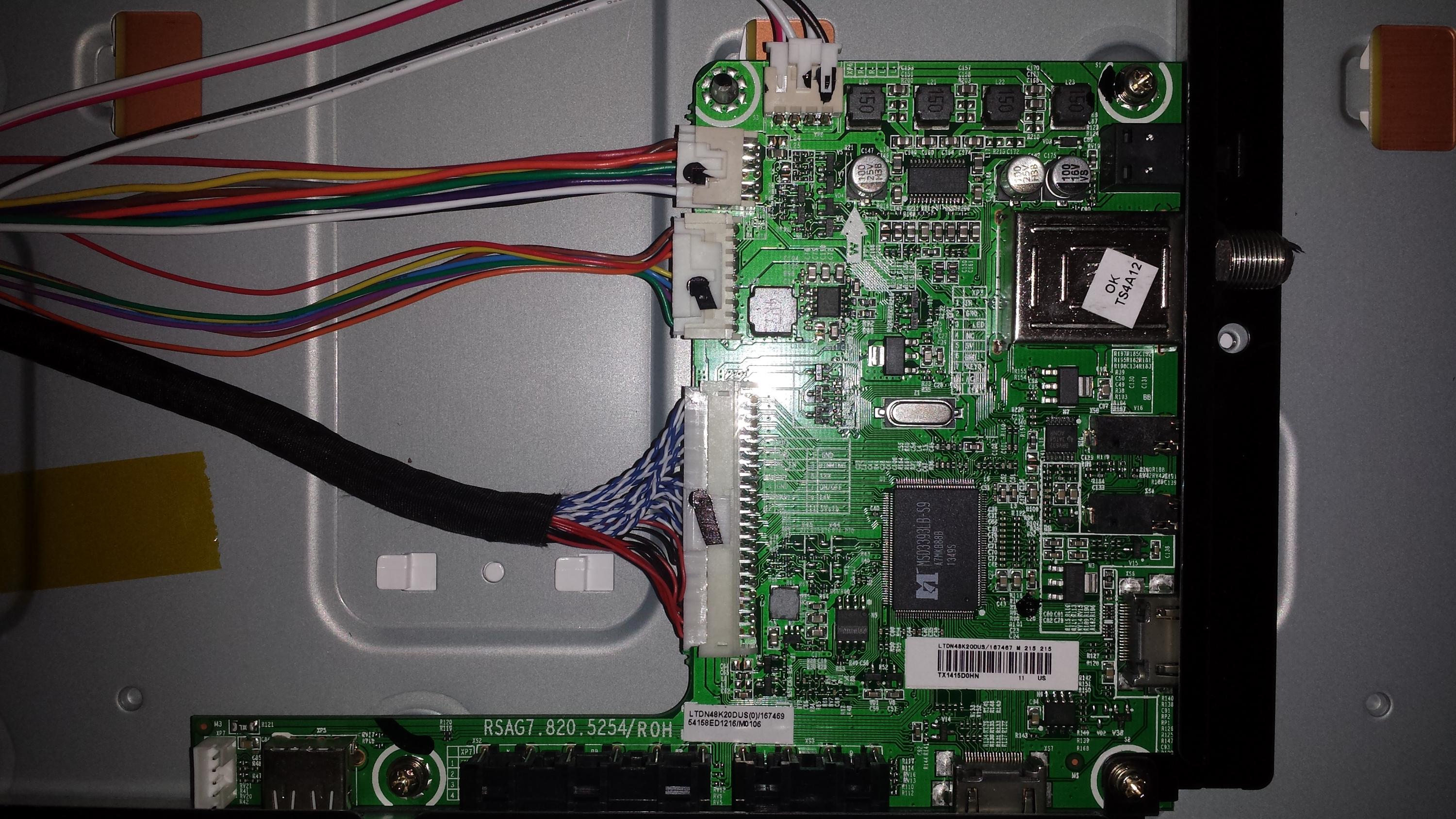

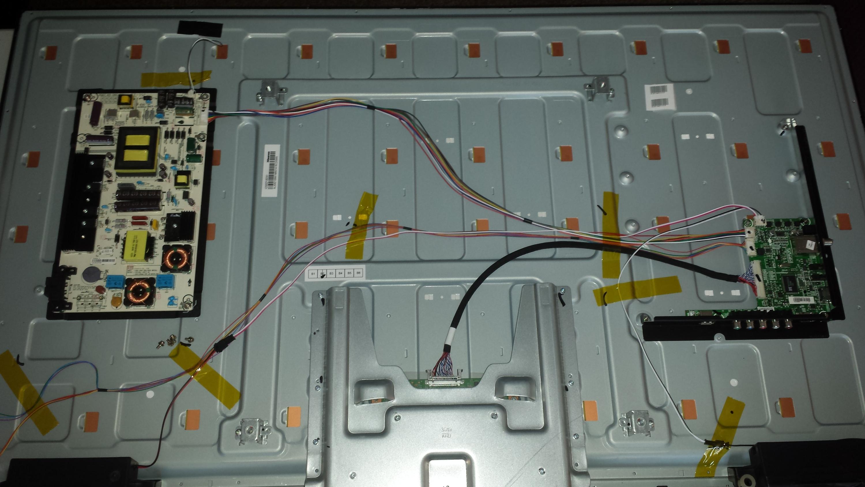

    I opened the unit up and found a very simple design. Power board, main board, T-Con, speakers, and a button board.
    Power supply has ~17V on the two 16V pins, 3.4V for the STB pin, 12.8V for the 12V pins, all as they should be. But the set won't power on.
    So, a main board issue? Anyone care to advise me further on what to look for first, on what board?
    Pictures attached.
    Thanks in advance.

    Re: Insignia NS-48D510NA15 Won't Power Up
    Does the backlight come on when you power on with the mainboard disconnected.
      Post the pin out names with the voltages measured. So we can see what's going on.

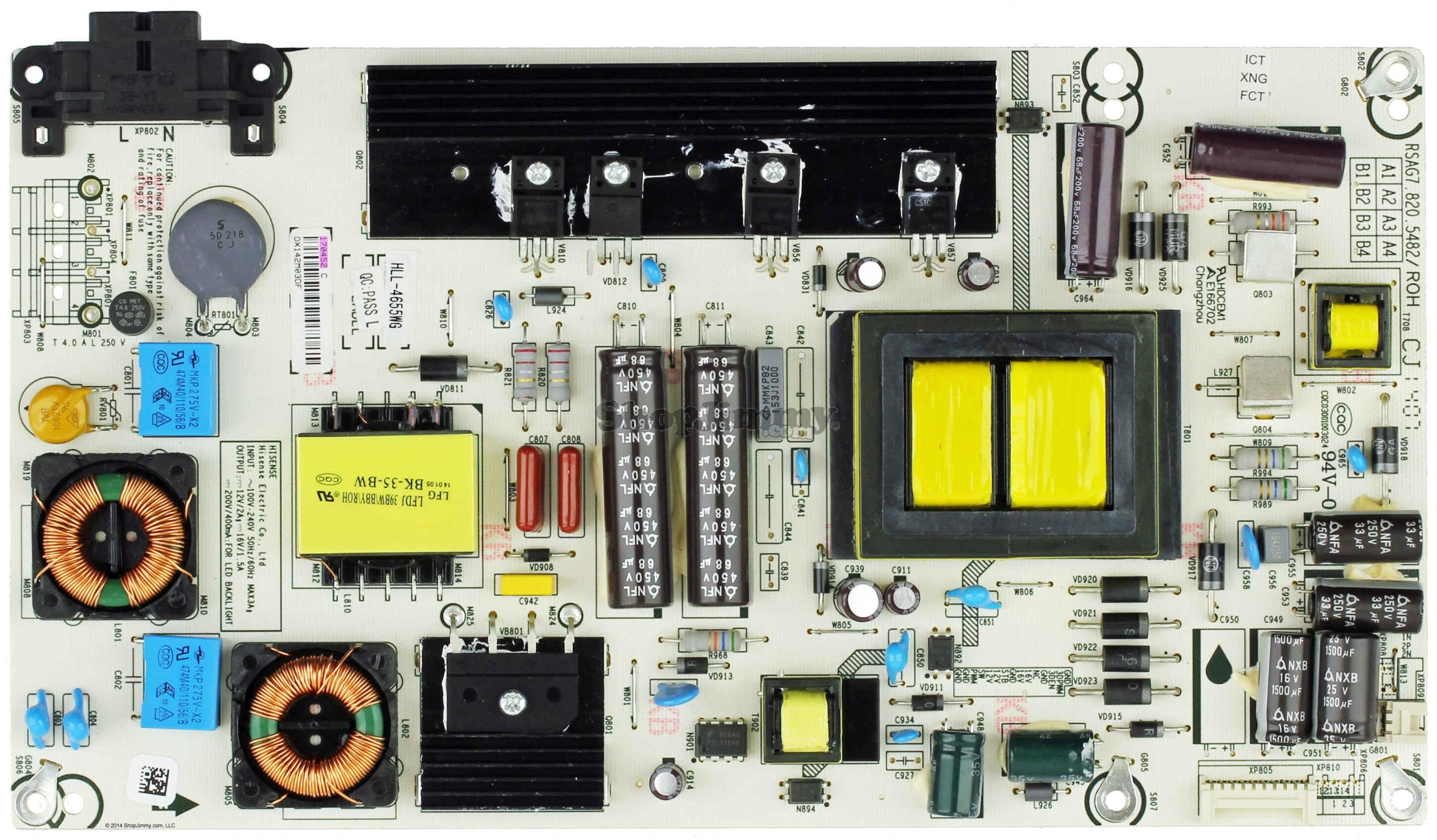

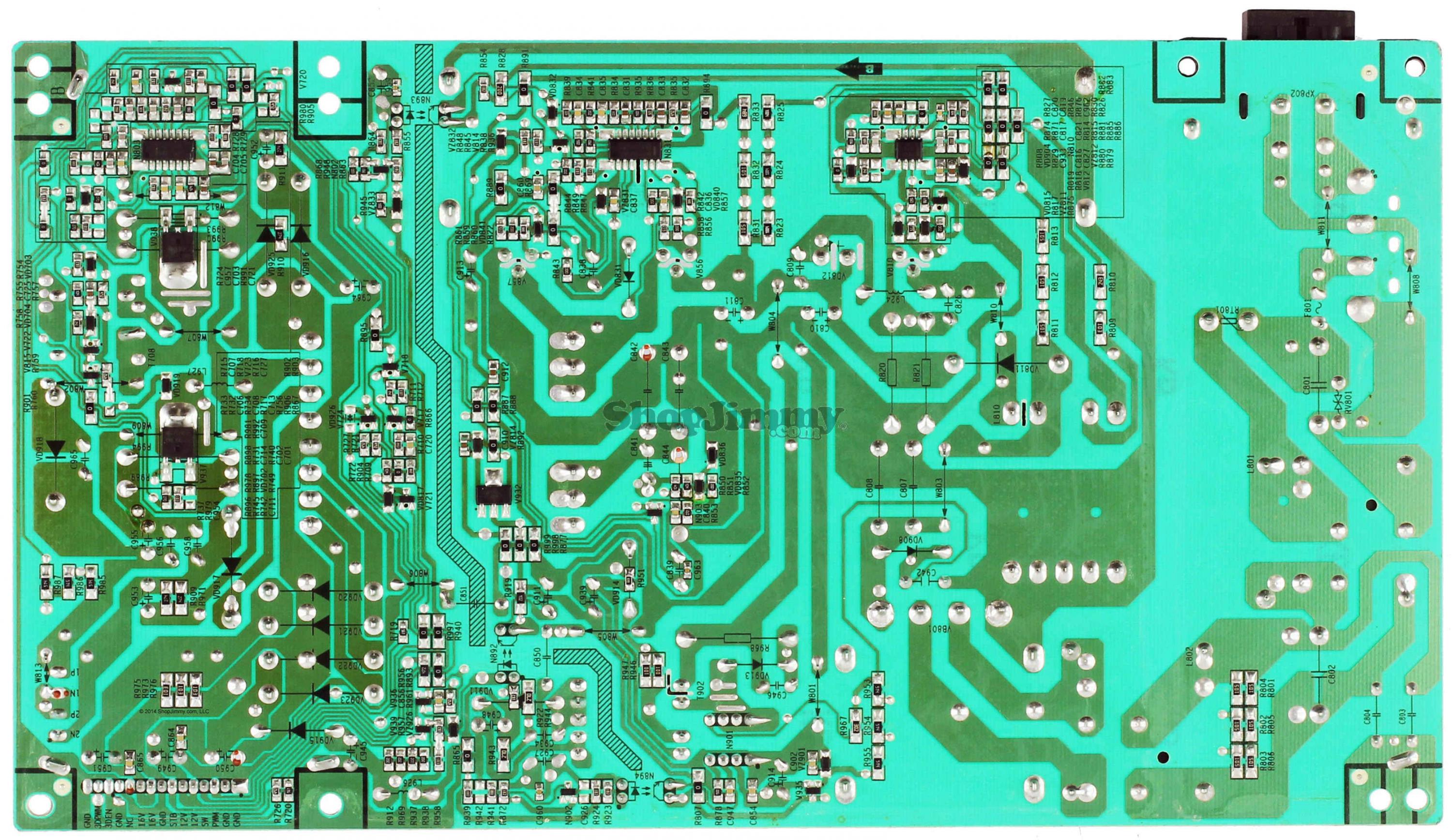

          Look at the bottom side of the power supply board, the pins for the connector that goes to the main board are labeled, so the the reading of each pin then report the readings with pin names for each pin so we will know what are missing.
          Some of the power supply boards may have built-in pull-up resistors to allow self test of the power supply board without having the main board connected, when AC power is applied the power supply board then the switched power supply sections will come on, and the backlights will also come on.
          http://www.shopjimmy.com/hisense-170...pply-unit.htm#
          Hisense/Insignia 170452 Power Supply
          Pictures provided by shopjimmy.
            Sorry for the lack of updates or replies. I ordered a main board for $30, threw it in, and works just fine.
