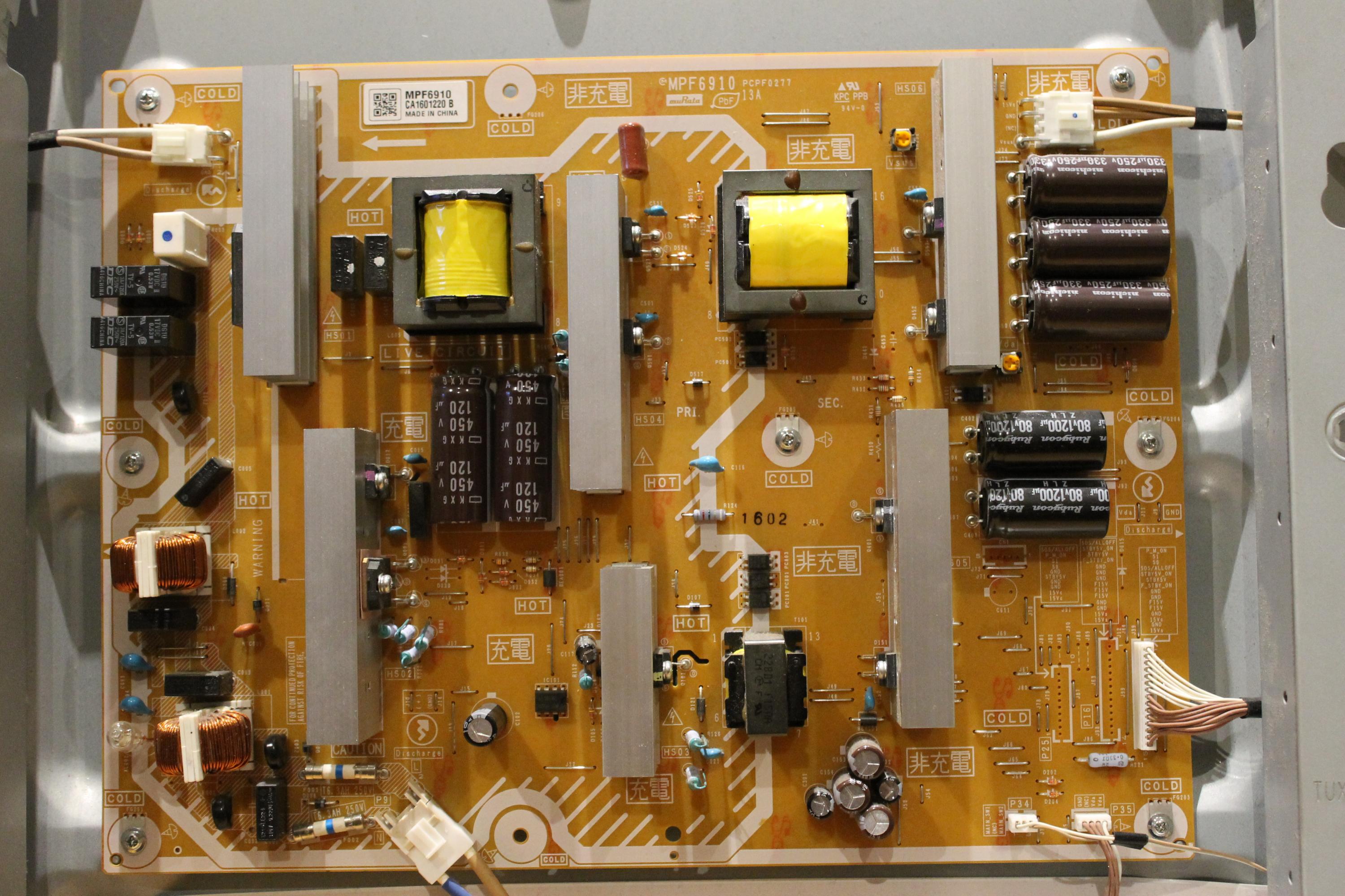

    hi guys, this pana has an orange stand by light when plugged in and no response when it gets it's on signal from the remote.
    i have 4.88v on the standby pin (pin 6 of p6), and .5v on pin 7 (f stby on) but no other voltages are present on any other pins.
    i do have 15v present at at d003 and d004 (just above the relays)
    also at pc401, pc502 and pc 501 (opto's)
    the main filter cap gets up to 320v and slowly drifts off till a relay clicks and the voltage is temporarily brought back. during the loss of voltage, the relay squeaks lightly like a rusty spring compressing.
    i get no on signal, so no pfc.
    i only get 40v ac at the bridge rectifier.
    on d006 and d011 (next to the upper coil), i get 330v
    with ps out (mpf6910), i have 240v up to the relays, but that is as far as i seen to get to at this point.
    any help would be greatly appreciated.

            The US ST30 looks equivalent board wise. The training guide give some info on the sequence of the startup but relay clicking every 30secs, I wonder if it's a mainboard issue?

                              These models can give weird faults. I repaired the same model this week with the same boards.
                              These "cheaper" models suffer from mainboard problems because of bad cooling. They usually come with "14 blinkers".
                              If you only measure 5V on P6 and no other voltages ( 15V etc ) then the mainboard does not turn on the tv.
                              Do you have voltages on P34 ( I believe ). You must measure 5v there.
                              These sets also give almost instant green blink when they turn on. Thats a SC board failure.
                              My guess is that you have a bad mainboard. BGA solder failed.
