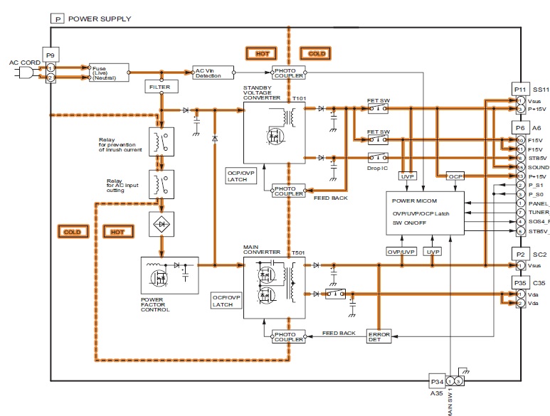

                Pin 4 DCDCCTL or DCDCEN(enable). Reading it that switches on a number of the regs 3.3v. 1.1v P5v, etc.
                Then it suggests once the sub voltages are confirmed more commands are sent for the 15V, Vda Vsus to come on, it's in that guide.
                As futile as this may be have you tried disconnecting sc2,ss11,p35, 3 white ribbons at the A board and tried if that turns on?
                Does the F15v come up and hold for a while? I'm thinking if you're seeing those stb voltages it must because I think it's the F15V they are derived from.

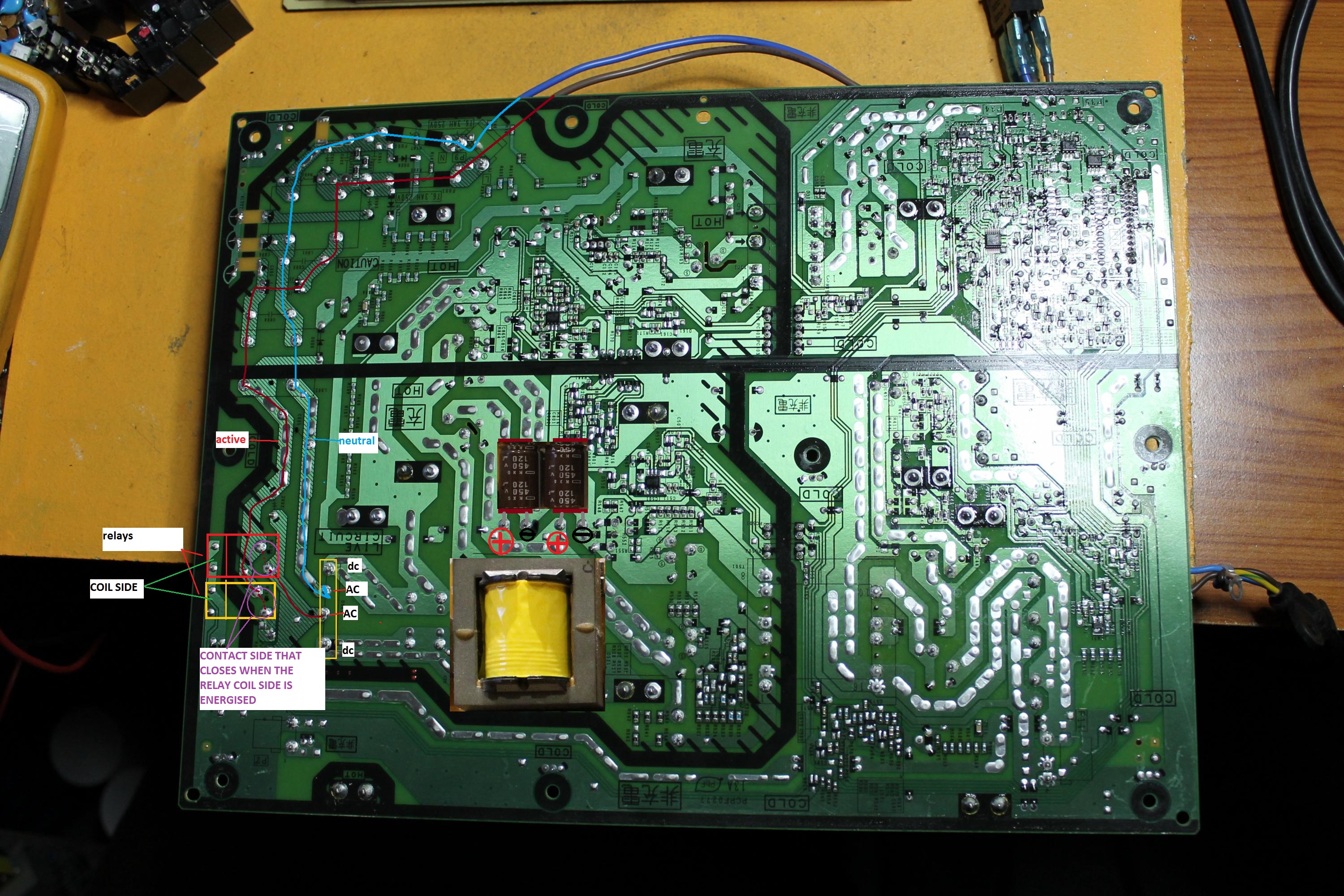

                                If you don't follow it's too late for my brain and eyes but the 2 relays next to the thermal resistor and in front of the main bridge.
                                there's the low volatge coil side that becomes an electro magnet and closes the contact side. The contact side will be switch the 240vac to the main bridge, one may do neutral and the other live but I'm not 100%.
                                So if the contact sides are closed with links meaning connected full time there should be 240v on the bridge and F15V should be on to.
                                If in doubt , leave it otherwise you may end up with a real blow up. Should be able to trace and work it out on the underside but I'm parking it for the night.

                                      No I'm not talking about any diodes, I'm simply referring to the contact side of the relays and bridging those.
                                      Trusting I've got this right I've painted your image. You should be able to simply bell thee paths out to confirm them.
                                      As you can see if the relays are closed 240vac will be across the main bridge, not sure about the second relay where it's going but the block diagram suggests these are in series.
                                      Done my best, I get a bit nervous fooling around on the HOT side so take care around there.
                                      I am thinking though the F15V needs to be present at plugin, if you can manually prove that works then that would mean the A board is not doing it's job.
                                      EDIT: I see what you're on about with the diode, both relays close but in sequence . This is not my knowledge area but it mentions one is for "Relay for prevention of inrush current", one is "Relay for AC input cutting"

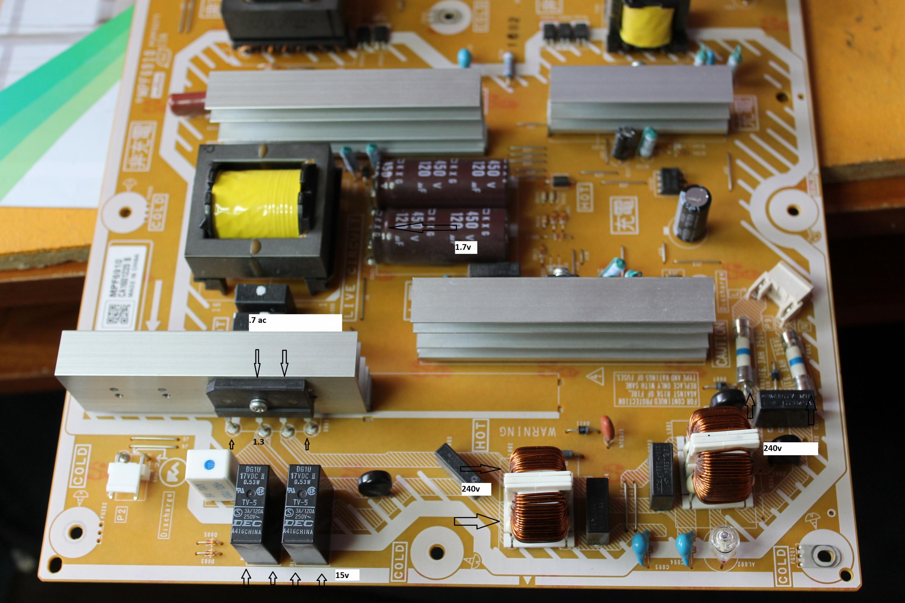

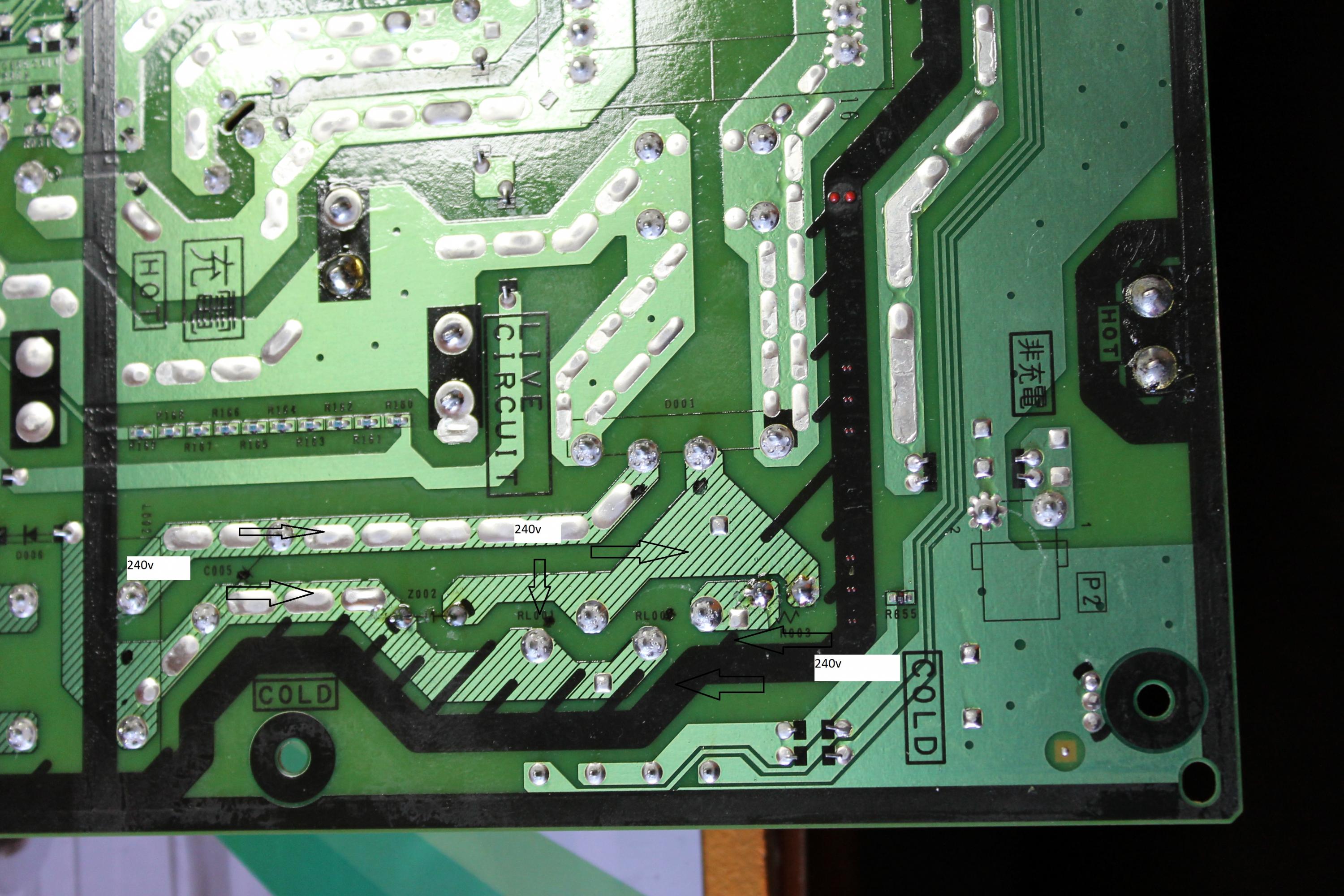

                                        • attainteddragon
                                          • Apr 2013
                                          • 764
                                          • australia
                                          #40
                                          Re: panasonic th-50u30a no blink code
                                          i have 15v at D151 (shottky), but i have not traced it further yet.
                                          so no 15v output anywhere.
                                          no vs or va since it doesnt turn the ps on.
                                          i may be looking on another tangent, but my head keeps looking at why i dont have unboosted voltage on the main caps.
                                          these tests are done with the ps out of the set, so it should have standby voltages and i would think about 320v on the main caps.
                                          i think that the bridge is breaking down under load, though tests fine.
                                          i have tried to show why i think that in the pics.
                                          apologies if im going the wrong way about this.
