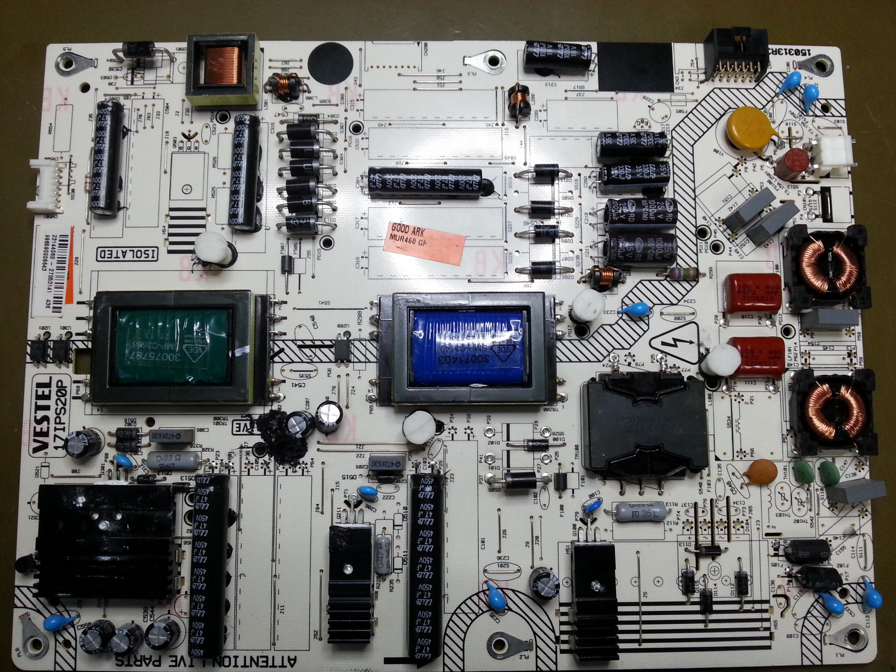

    Greetings folks. I recently fixed this Vestel 17IPS20P power board inside a Philips TV (shorted output diodes that weren't even all the same >_>) and it's working fine now, except it's making this pretty loud and obnoxious hissing sound. It seems to be coming from that PFC coil (on the right next to the two red caps), though I might be wrong, since the noise is high pitched and hard to pinpoint. Usually such noises point to bad caps (the irony) causing lack of filtering, but without an ESR meter I can't go around changing EVERY cap on the board hoping the hiss would die down. I've already changed two of the 4 output caps, since they were rated at 16v and I put in 25v ones (the brown ones towards the right which are different from the 2 black ones next to them), but it didn't change anything. The noise starts when the TV is switched on and stops when it's switched off (DUUH). Its pitch doesn't change with the picture or backlight intensity. Has anyone experienced this ? Is it a cap issue at all ? Is it really that particular coil hissing, or is it the transformer next to it ? I'm perfectly aware it could be due to bad quality components, since these Vestel PSUs are absolute pieces of junk and it may be an inherent issue that you can't do anything about....

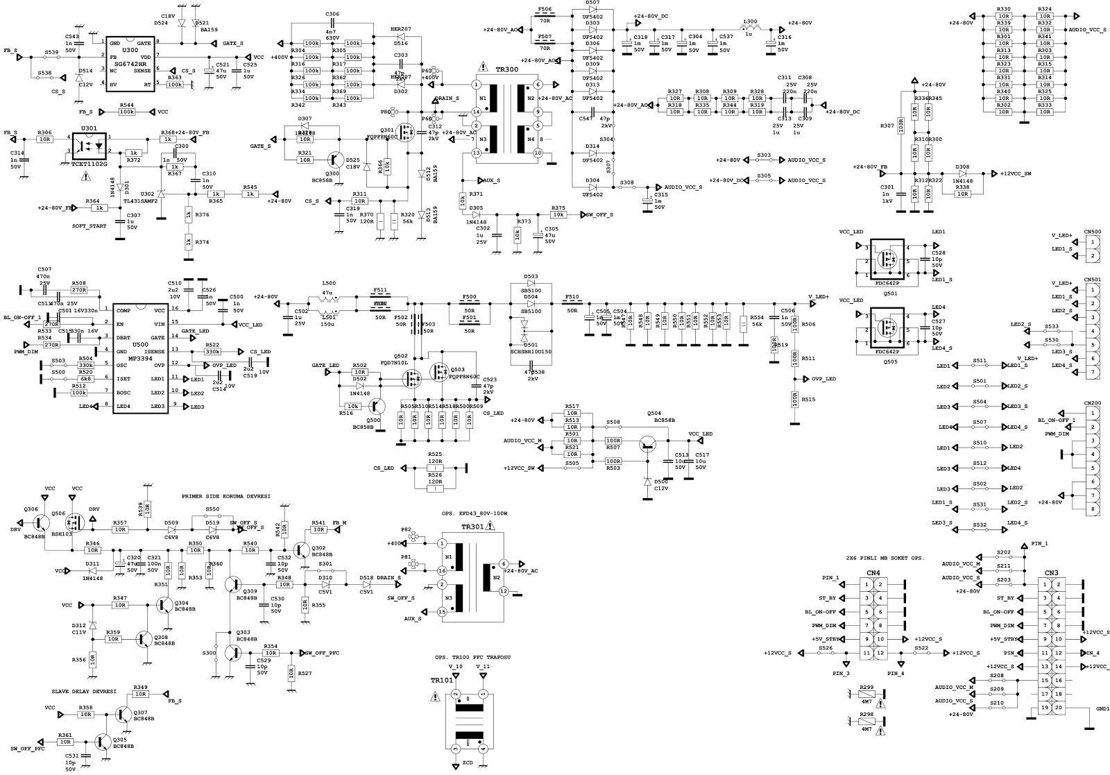

    not sure if you have a circuit diagram but this may help
    https://electronicshelponline.blogsp...d-circuit.html

            Re: Philips TV with badly hissing Vestel 17IPS20P supply, any solution ?
            https://www.badcaps.net/forum/attach...6&d=1474467079
            The two inductors to the right of the two read caps are the LINE filter, the PFC inductor is the TR100.
            So when TV is in standby do you hear the noise?

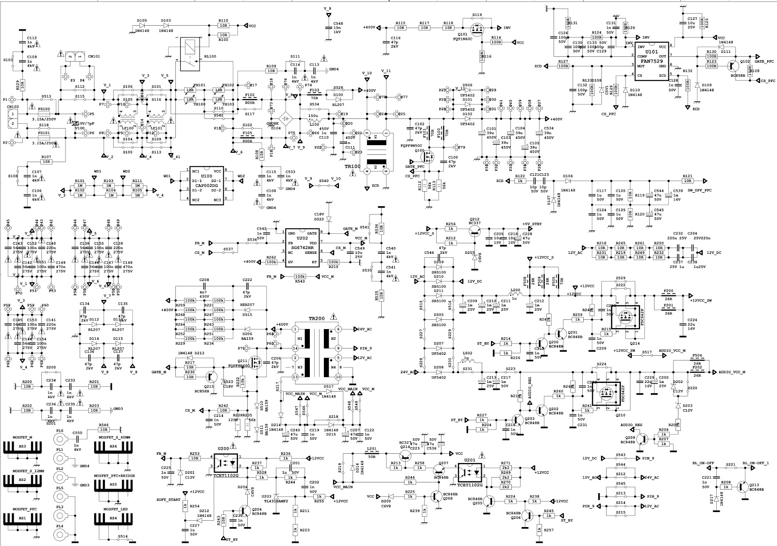

                              There is feedback circuit that control what the Boosted Voltage output will be. If it is not low then that is not the problem.

                                    I was just going by the diagram Budm provided and it has d207 and d208 (for the +24volts) as uf5402 which are ultrafast switching types
                                    Did you change those or only the ones for the +12 volts (d209,d210,d205 & d505)

                                      The ones I replaced are the 4 ones above and the the right the blue transformer in my picture, so those would be d208, d209, d210 and d211.

                                        So all 4 are connected in parallel and only for one voltage? ( the diagram is a bit misleading)
                                        The UF5402 are rated with a trr speed of 50ns
                                        The SB5100 are rated with a trr speed of 500ns
                                        since those are the diodes you replaced and that seems to be where the problem is its posible the diodes are not switchng fast enough causing the transformer to make the noise it is.
