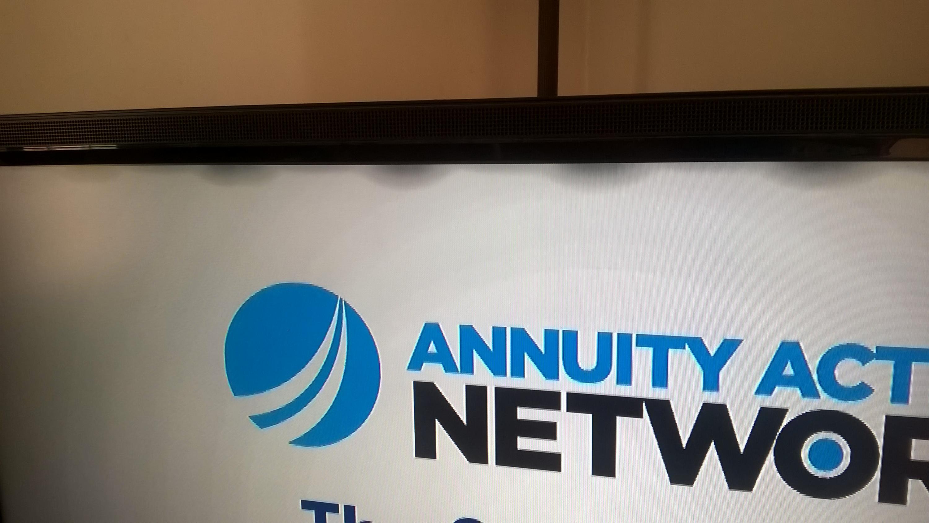

        can you upload pictures of the black dots your seeing on the screen

          Re: Vizio VO47L caps
          Will do when I get home. I'll pause on something bright so you can see it well.
            Here it is, no matter which input I use
              I've seen this defect before on two different Vizio's that I had repaired.
              I think it is a unfixable panel defect but I will await other opinions. I could not get the problem to go away by flexing the panel so I don't think it is a tab bond issue.
              I would also like to know what it is?
                Could it be pressure points on the diffusers?

                            #33
                            I have seen the same screen defect on a 47" Philips lcd. I told my brother to watch everything in letterbox format.
