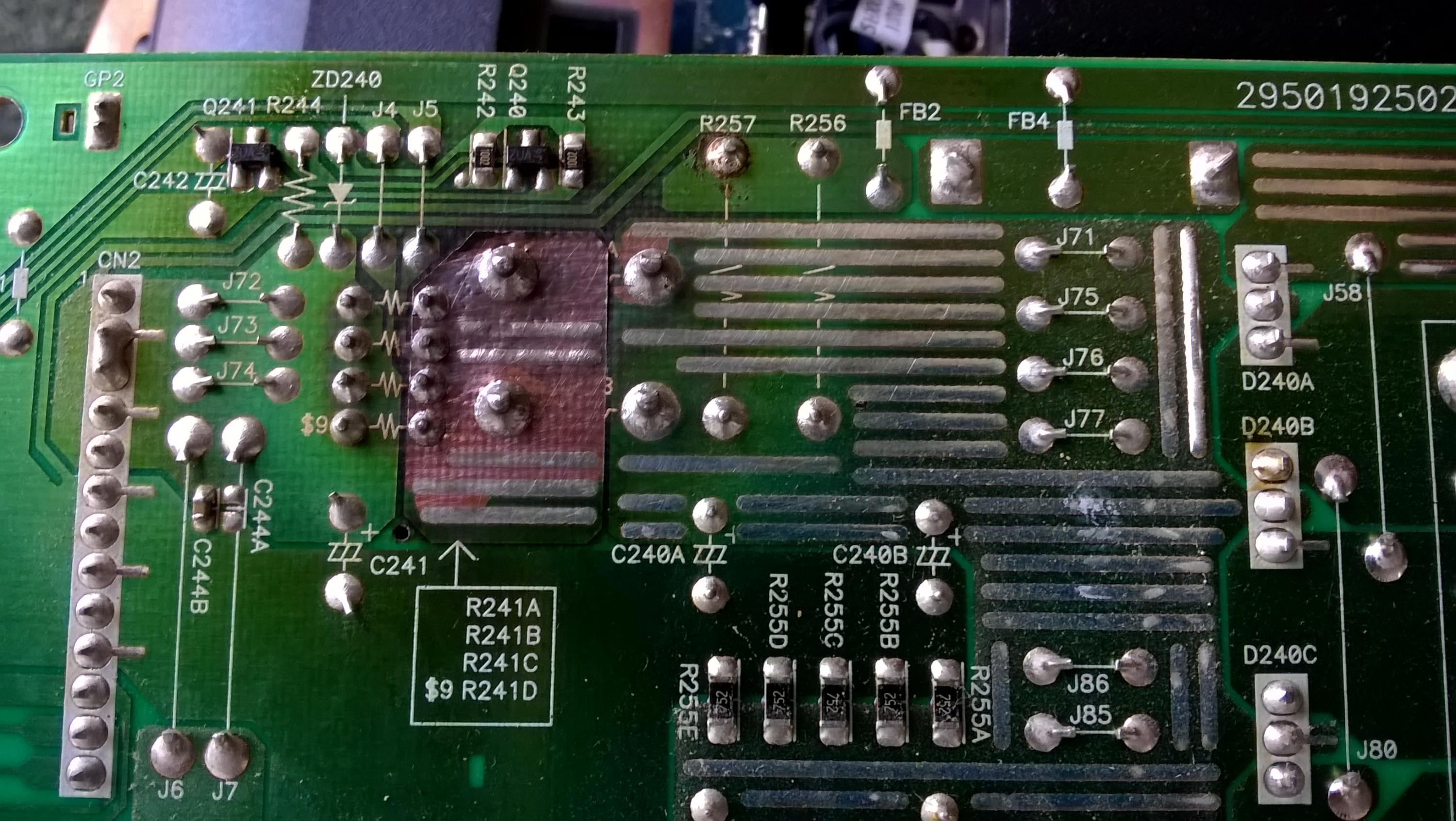

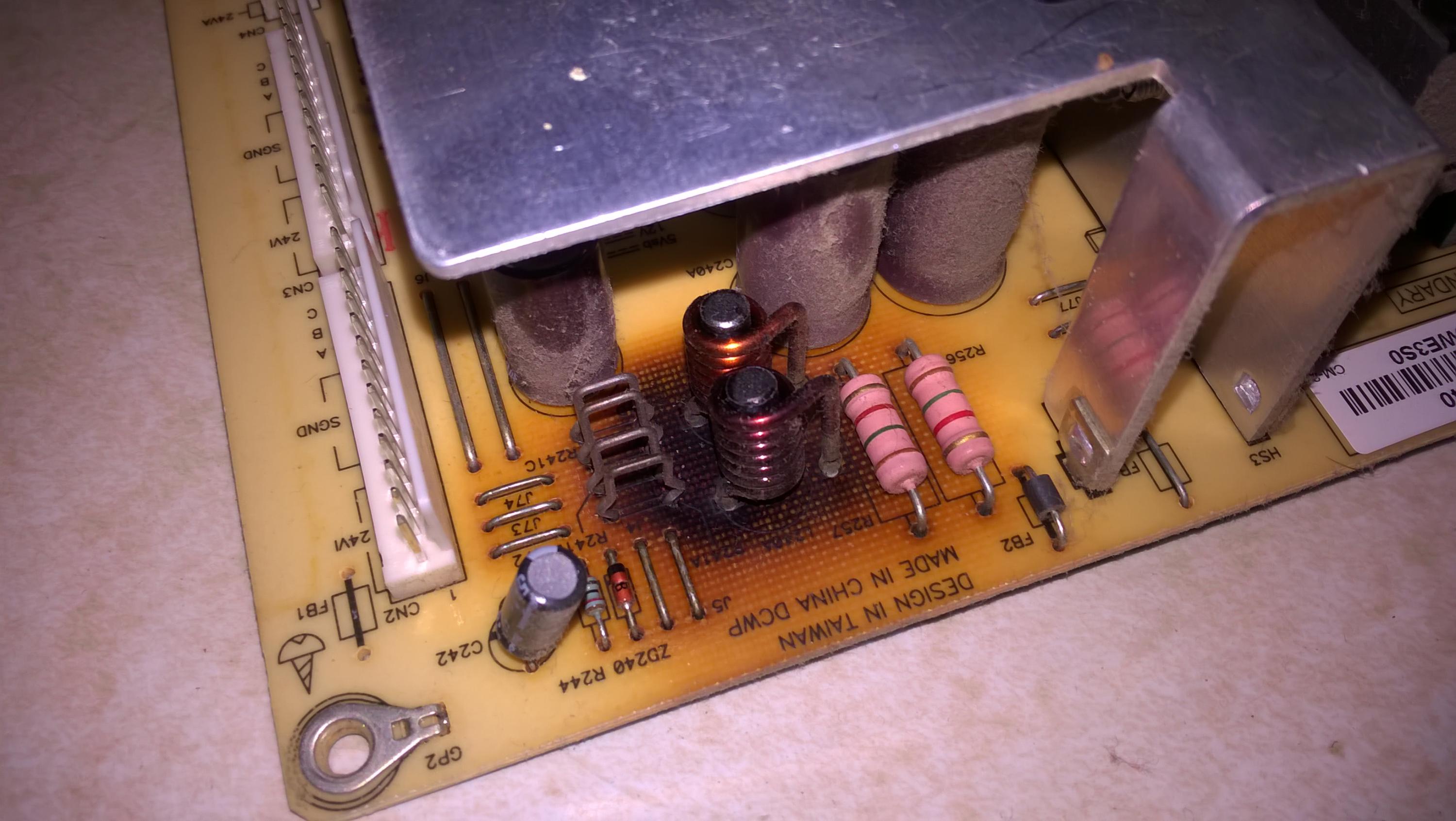

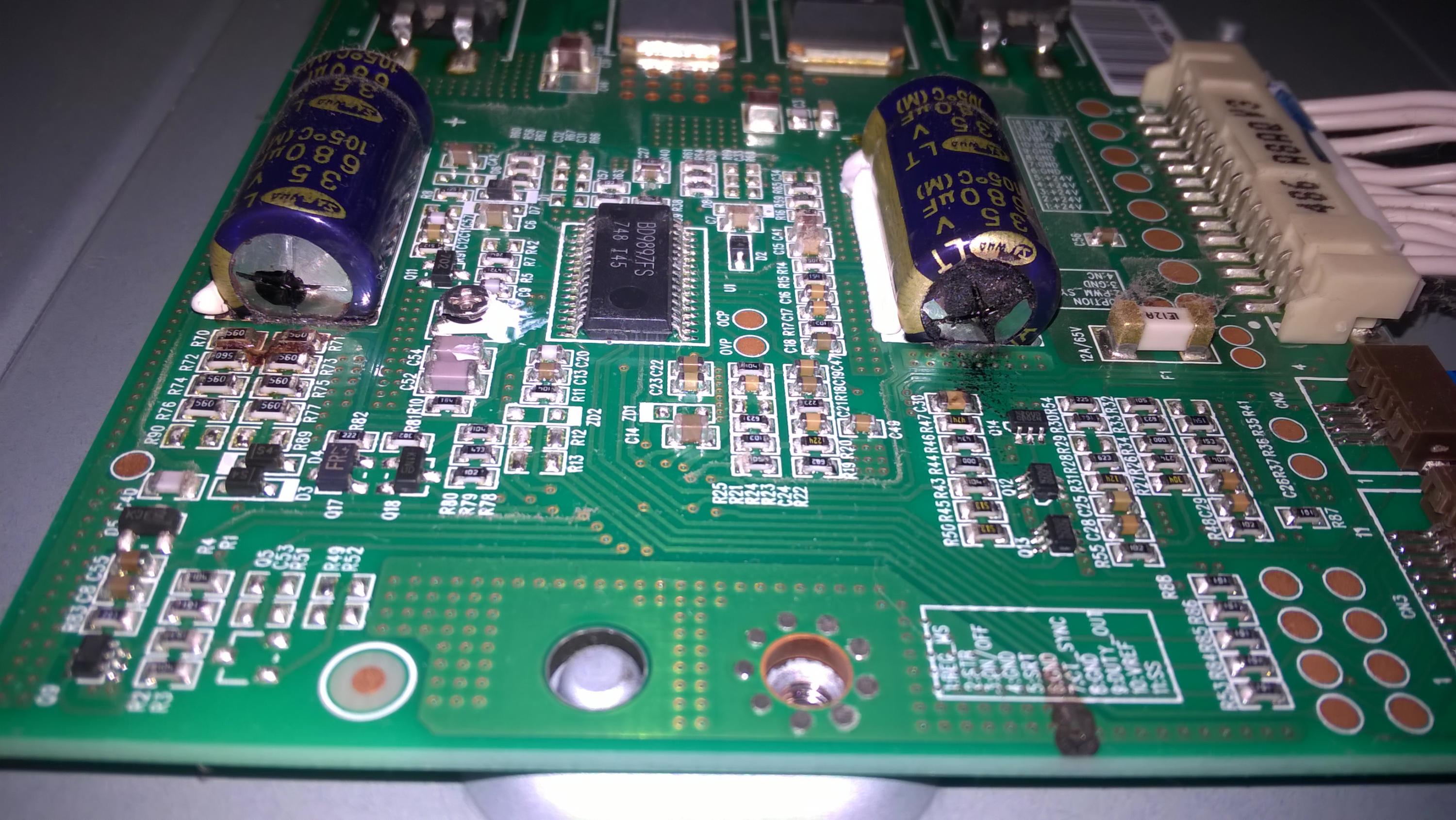

    Hi All,
    I got this TV free off CL. I was told the power supply was a problem but it ran for 6 hours without a problem. The Power board has the same bad cap as others have described and a fairly good burn on the board. Also I read about the caps on the inverters and, surprise, they are bad too so I'm going to replace them. Does anyone have a really good close up of the back of the Power board under the induction coils? I don't have a problem hand wiring a repair but I'd like to know what it started like.
    I ordered these caps from digikey.
    (1) Panasonic EEU-EB1V471 (PS)
    (4) Panasonic EEU-FR1V681 (Inverters)
    How am I doing so far? I don't see any other problems but are there any other problem spots to check out?

    We cannot tell much sine there is no model number or pictures of the board. It is best to replace the whole set of caps except the large main filter cap in the primary side which rarely goes bad.
    470uF 35VdcEB series is NOT low ESR type which is required for SMPS power supply.
    http://www.mouser.com/ProductDetail/...9rygpOOw%3D%3D
    https://cdn.badcaps-static.com/pdfs/...6f0b579b29.pdf

      Re: Vizio VO47L caps
      Do these pics help?
            The two inductors (coils) look as they have been producing enough heat to carbonise the circuit board and carbon is a good conductor of electricity. It may well be due to the inductors requiring resoldering and I'd scrape as much of the carbon off as possible around the inductors.
                Not all caps are LOW ESR, you have General purpose cap and then you have low ESR cap for SMPS.
                              I put in the inverter caps and will wait for the PS cap to show up. I'm going to put that in and run it, and pick up the other caps in the PS when I get a chance. Do you think they are Low ESR as well? No rush as it worked before I took it apart.
                              Thanks to everyone for your help and suggestions. I knew nothing of Low ESR Caps.

                                They are all LOW ESR.
                                BTW, those inductors got very hot were due to high frequency AC (inductor will block AC so more Vdrops are appear on the indcutors) because of bad filter caps, so I will not be surprised that the caps C240A, C240B in the input side of the pi filer are not doing their jobs to filter out the AC.

                                  C240C and C240D aren't involved here? they appear the bridge the same gap electrically.
                                    I use DIGIKEY most of the time.
                                    I do not see C240C/D in your pictures.
                                    https://www.badcaps.net/forum/attach...7&d=1474050378
                                      Sorry, I wanted a close-up to get good detail. The solder points at the bottom of the pic are for those 2 caps. I'll get 4 and replace them all. Right now I have it up and running on the non-low-esr C241 and it seems to be running a LOT cooler than it did when I first tested it!!! Will leaving he back cover off until I get all the caps I need screw up the cooling?
