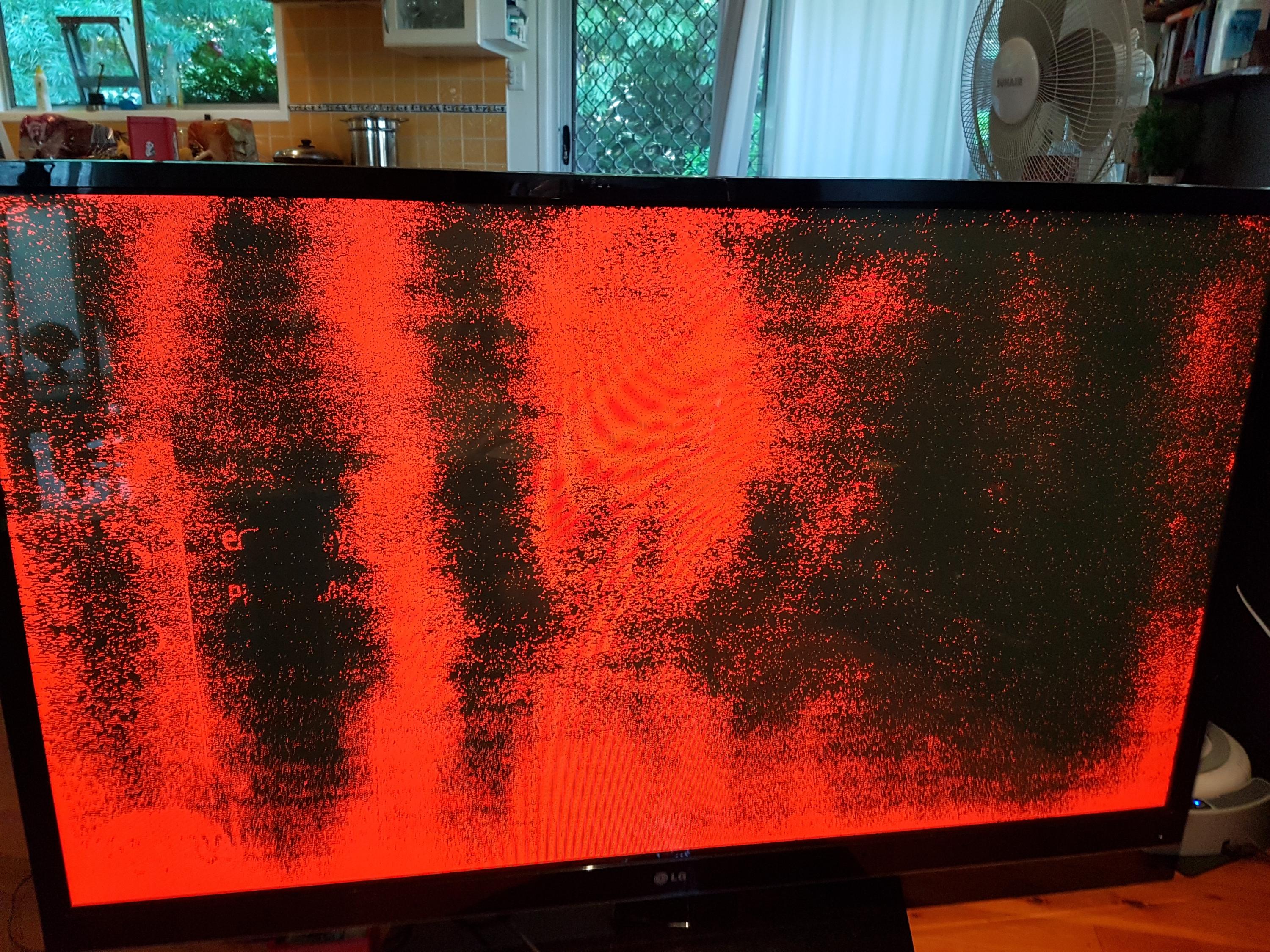

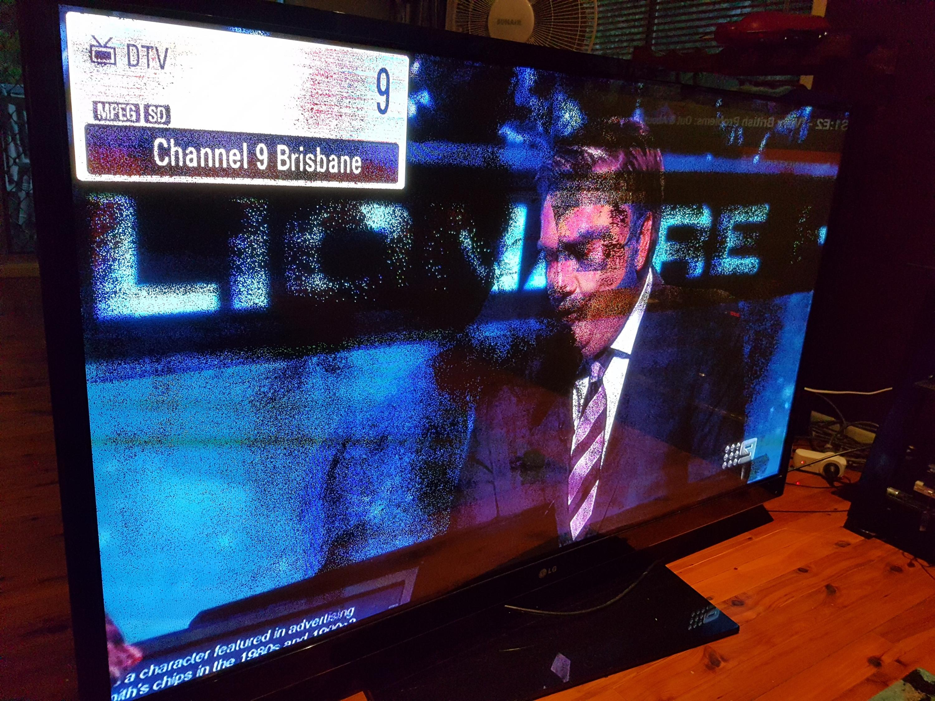

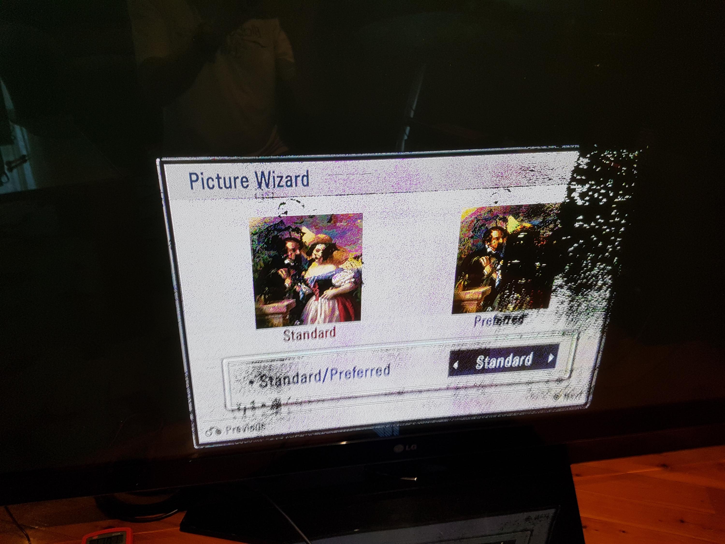

    Had this one a while now. Great tv. Had usual bad inductor solder joints on Z board repaired with new fets and caps etc. Ran perfectly fine for another year! Then this new picture problem emerged. Checked all voltages and usual problems all good yet pic is still trash.
    Have a look at the photos.
    I cant figure out the reason for the black splotchy patches.
    It would be ok then appear when the tv warmed up.
    I have not mucked about with the Y board or buffers too much because the voltages all seem ok and the picture is mostly there.
    Does anyone have any clues what's going on?
    Cheers.

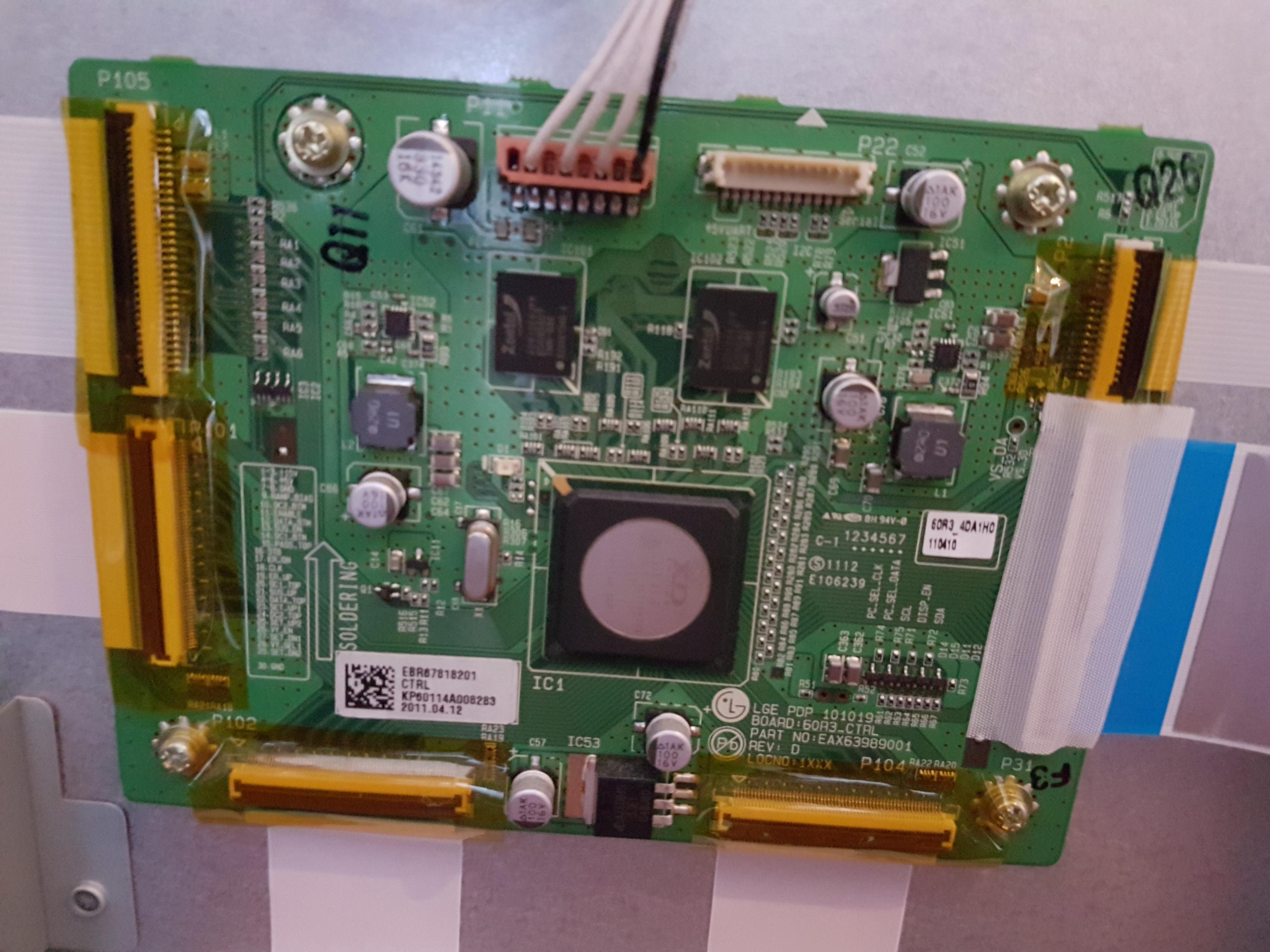

    Not that I think it's the mainboard but run the test patterns.
      Re: Another 60PV250 pic fault but different this time. Help greatly appreciated

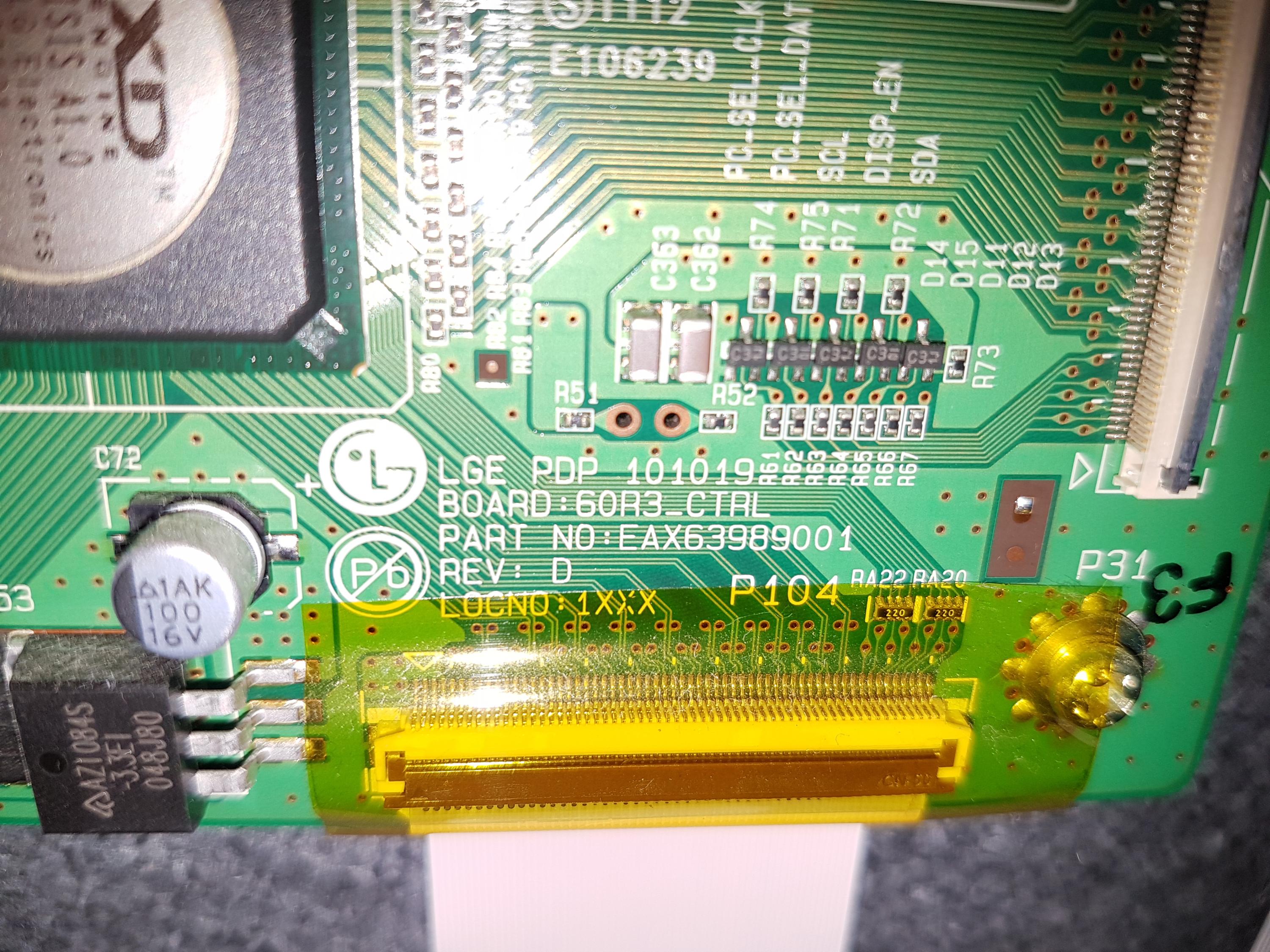

      How do you put this one into test pattern?
      I cant see the 4 pins?
      Photo attached

              Hmm so it seems the Sus voltages are fine theres a chance the ERC could be low but unlikely as normally if that area fails you would get no image, try running the test patterns as MM said this is done by bridging the Auto exgen pads on the controller and removing the Lvds cable.

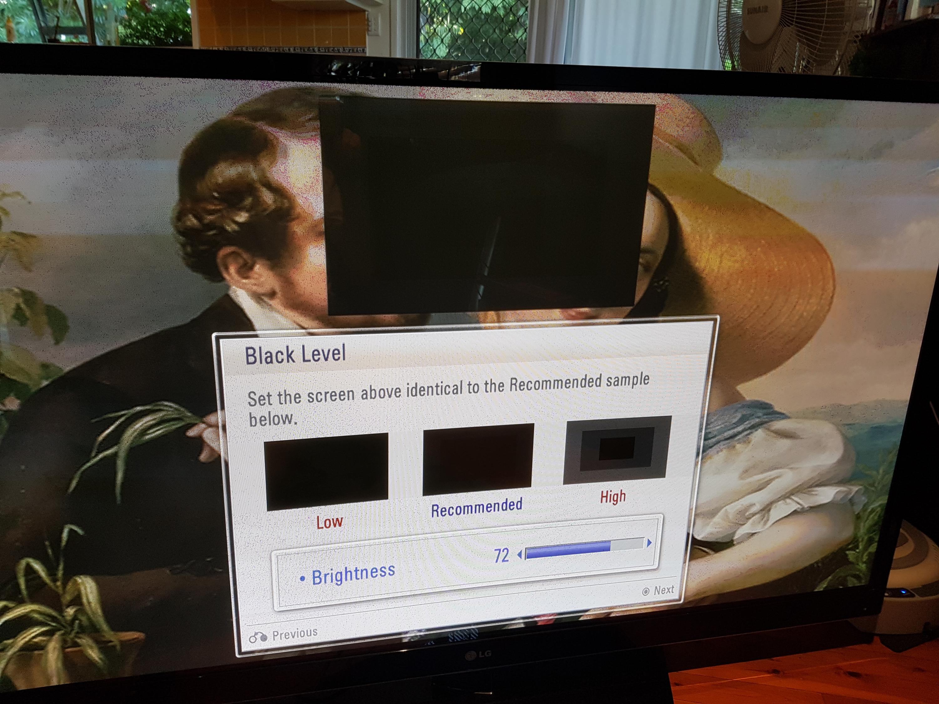

                So I've played with the TV picture settings in the menu and found it is greatly improved if i turn up the contrast to maximum.
                Ive repaired the zbias before and its running in spec which is why i don't think it is a z bias problem this time.

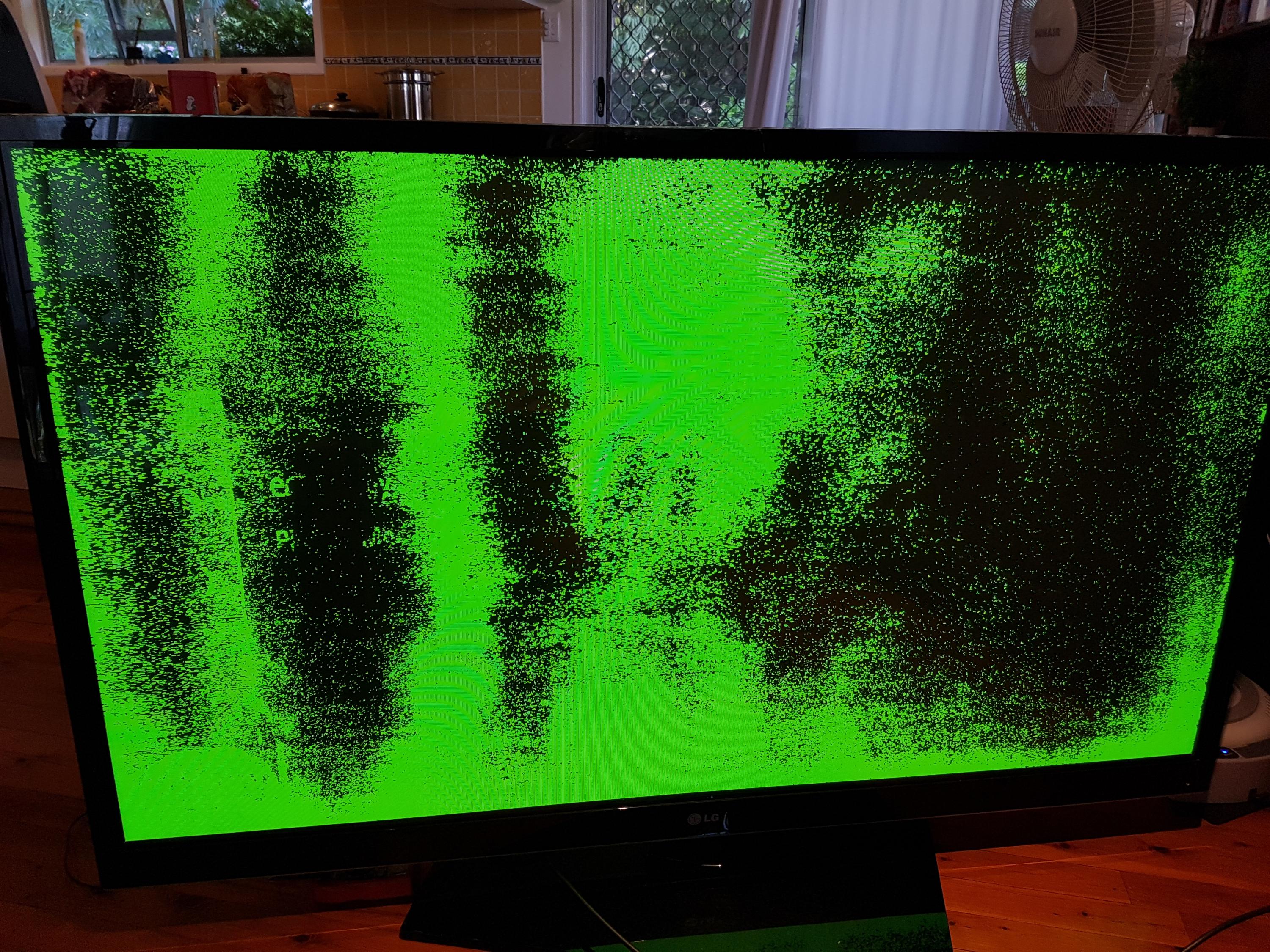

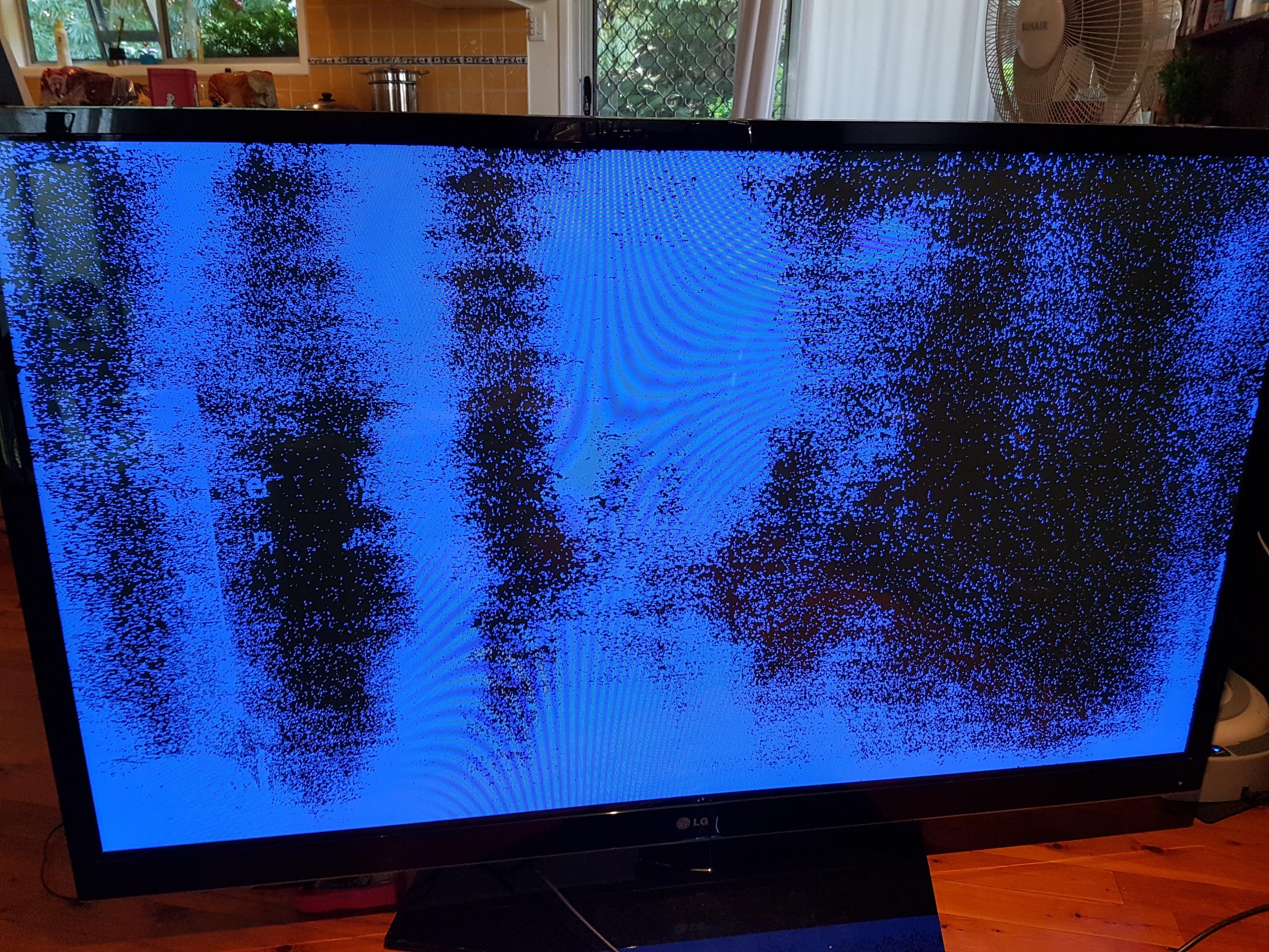

                      Bridge the copper pads between R51 & R52 with Lvds removed to get test patterns.

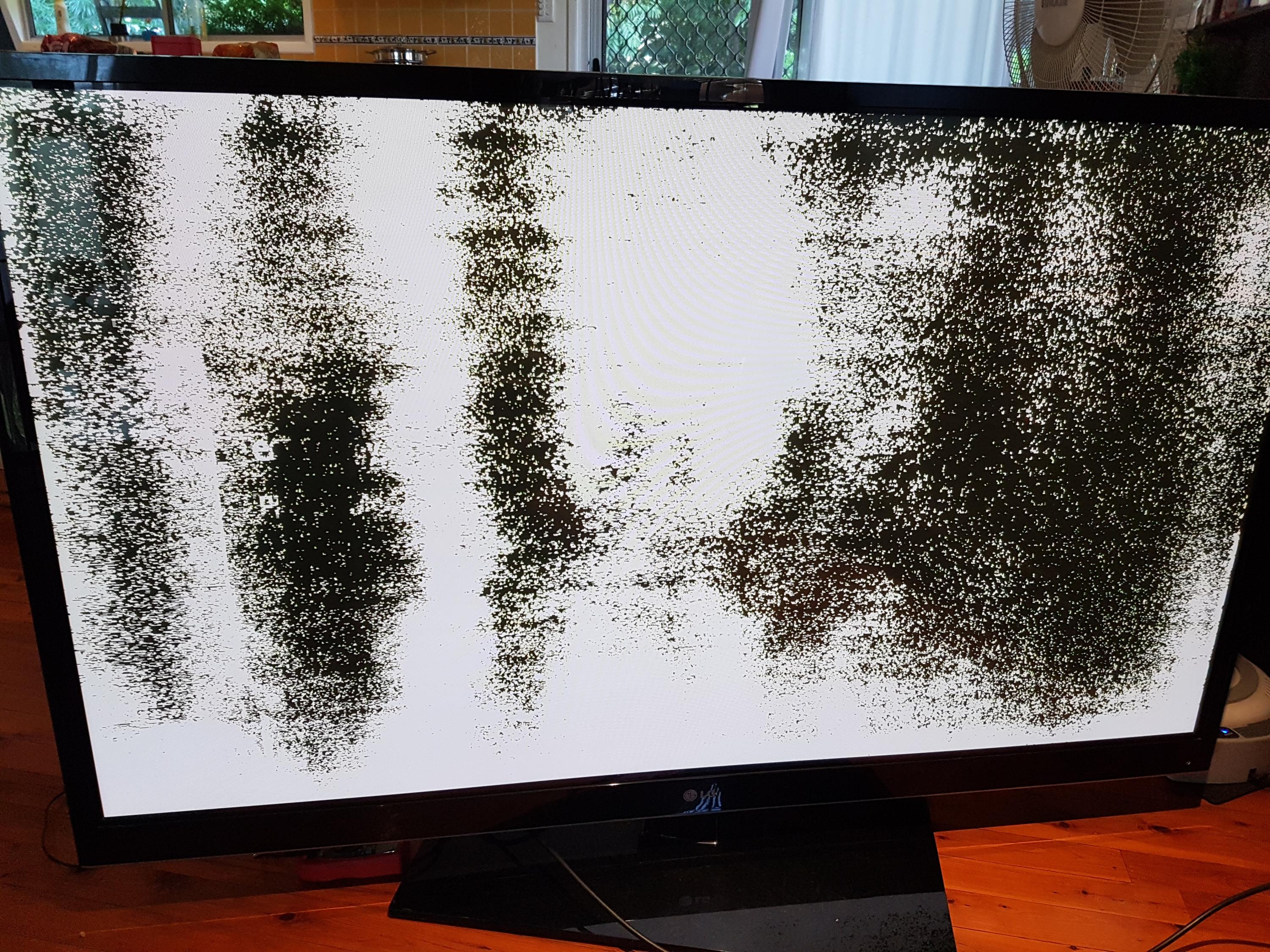

                        Test pattern images attatched
                          That's got to be a zsus problem.

                            Ive noticed the image is not good in normal mode viewing tv. Then if I go through the menu its still no good....untill that is when I get to the image wizard adjustment section where it goes to change the contrast. Two pics attatched. First one before and second pic after it suddenly switches to a vastly improved but not perfect picture.
                            Then upon exiting the picture wizard it goes back to extrememly poor picture and heaps of ghosting.
                            And I watched the vzb voltage through this. It didnt change.
