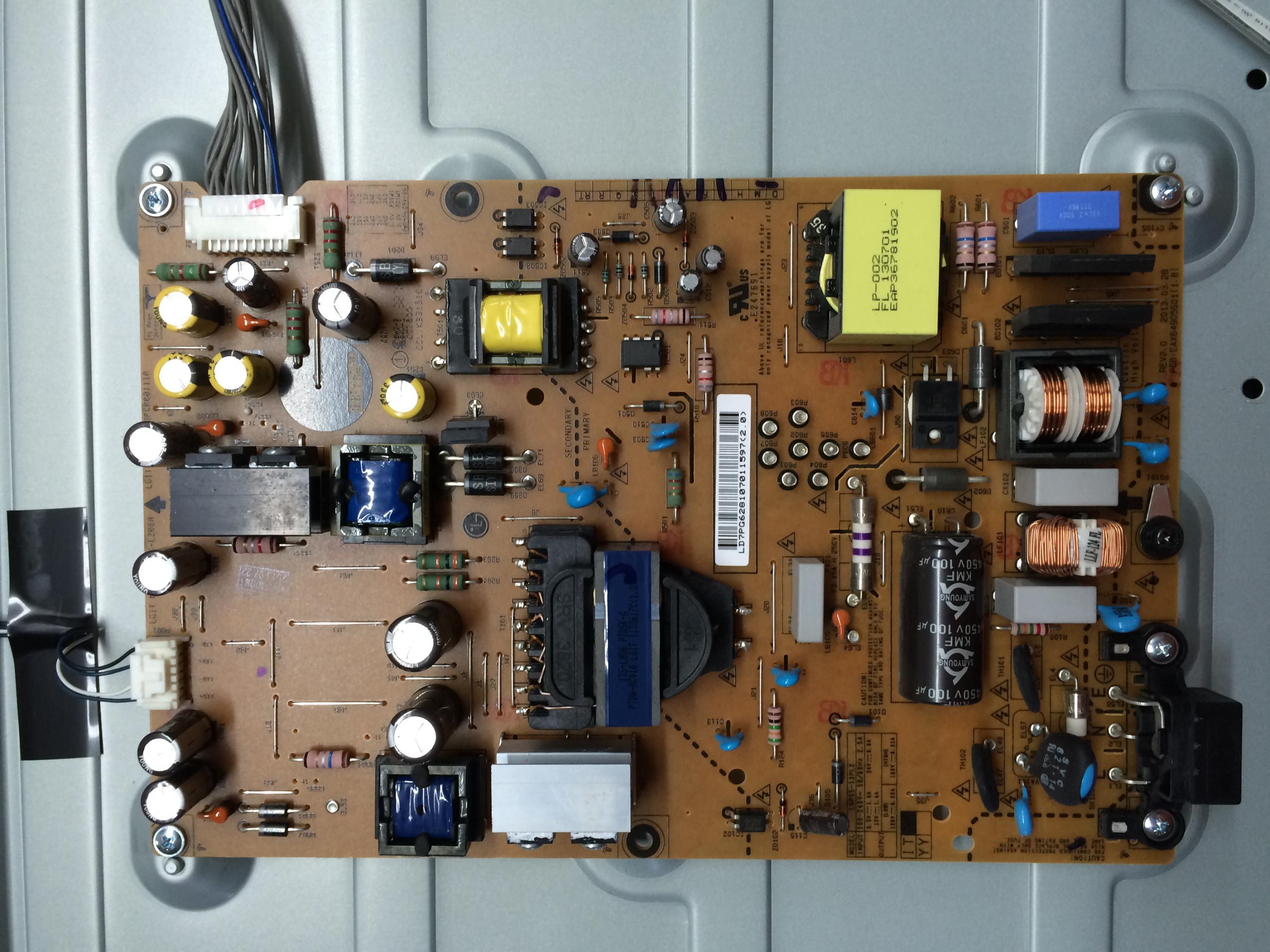

    Hey everyone, have another set that is acting a bit finicky.
    It's a LG 55ln5100 that has random backlights issues and a problem syncing with HDMI (I think).
    First the random backlight issue is sometime the set will work with no problem and then it will loose the picture but still have audio. I verified with a flashlight that there was still video. Also it seems to do it if you turn it off and right back on. If you let it sit for a bit it will work again. Now I first went and resoldered the caps on the power supply board and did not see any bulging caps. I have not checked voltages yet because the problem is random. I did however went and ordered a power supply/led driver repair kit from Shop Jimmy.
    Now the HDMI sync issue is strange. When I use a blu ray player it syncs right up. But if I use my directv box it sits for awhile or it gets snowy and then it will display. Sometimes I have to turn off the box and back on for it to show up. Now I have not switched the HDMI cable yet.
    Just trying to get a jump on troubleshooting it here first before I take it apart.
    Thank you

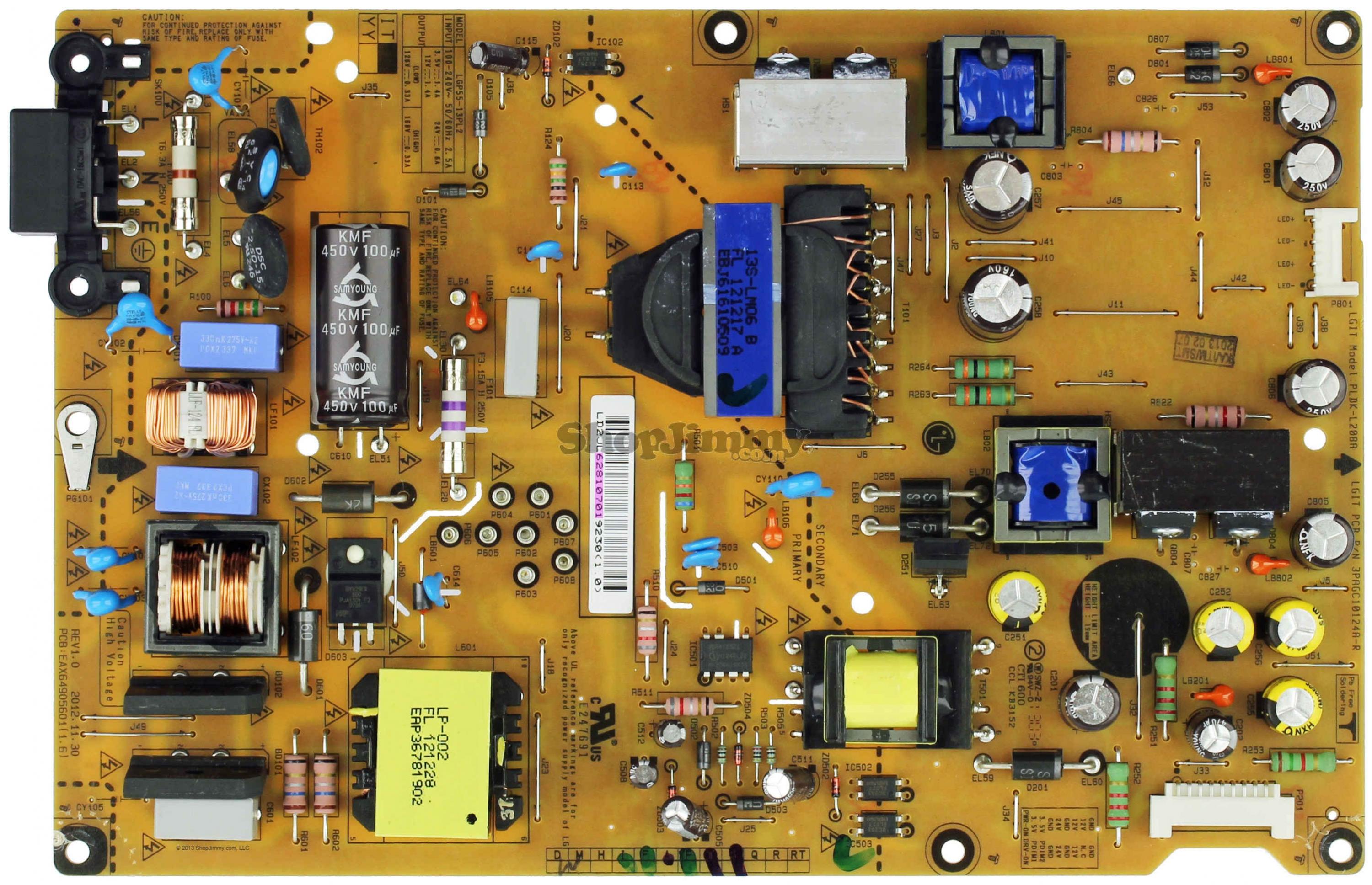

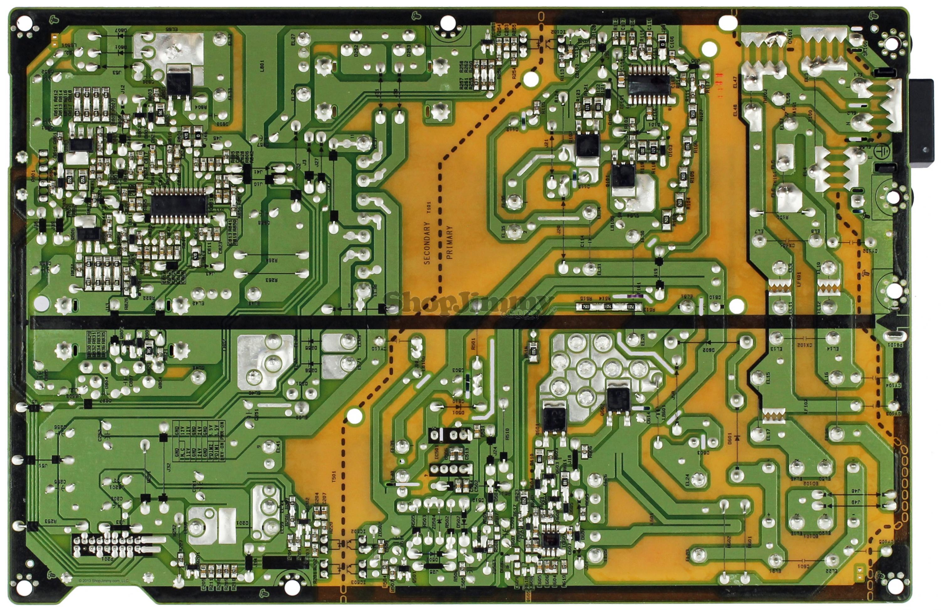

        Power supply board. If you look at one of the leg of the big main filter cap you will see through hole rivet that the leg of the cap is soldered to, same for the transformer leg and also other semiconductor devices as well. When I work in these TV I always touch up the solder joints on those components. SAMSUNG boards have the same problem with poor solder joints.
        Pictures provided by shopjimmy.
        http://www.shopjimmy.com/lg-eay62810...pply-unit.htm#
        LG EAY62810701 (3PAGC10124A-R) Power Supply / LED Board
        http://www.shopjimmy.com/catalogsear...?q=Lg+55ln5100

          Ok got it, thanks for the pic. I did go over the power supply board the other day but will check it again. I will post an update in a few days.

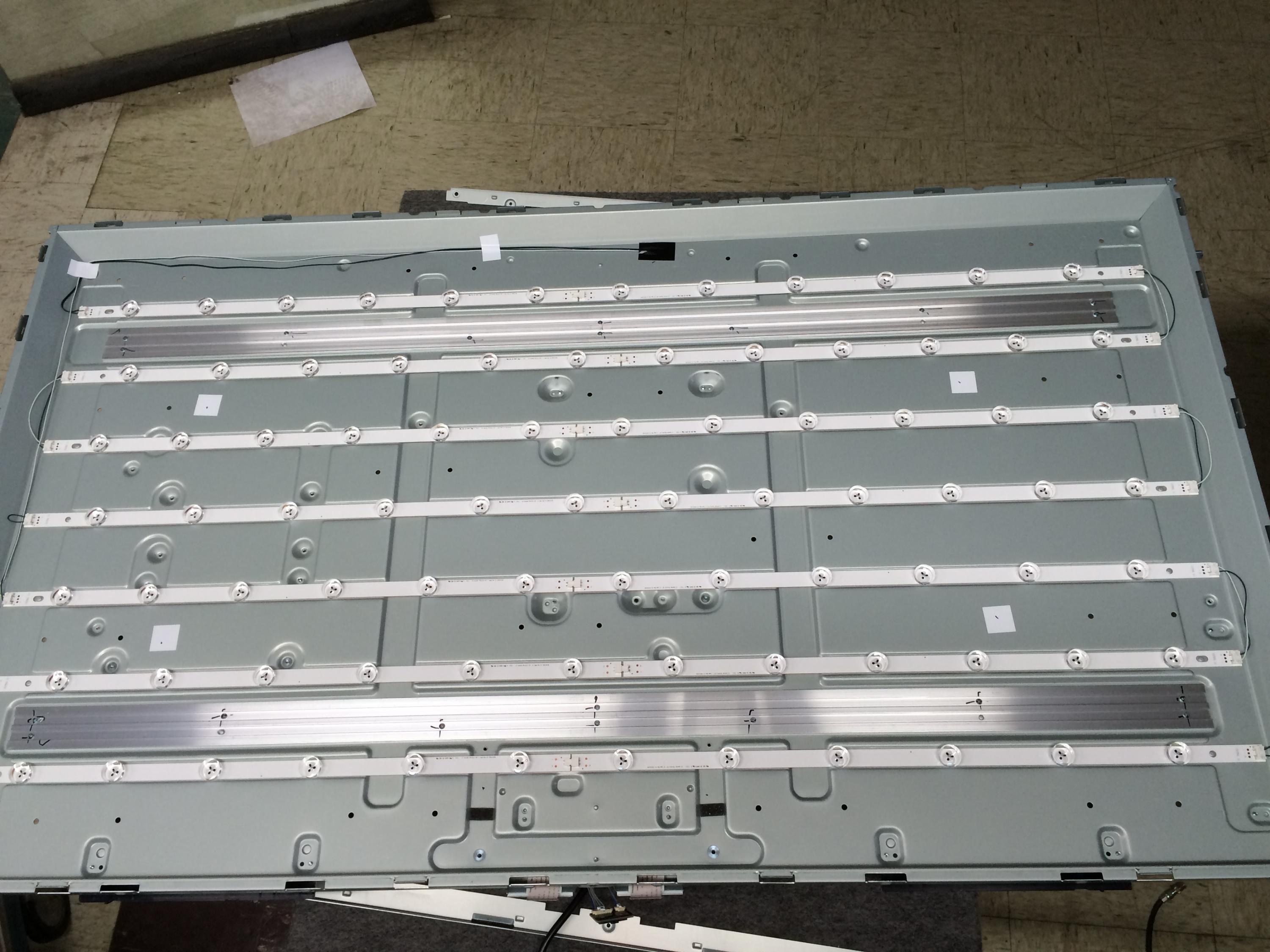

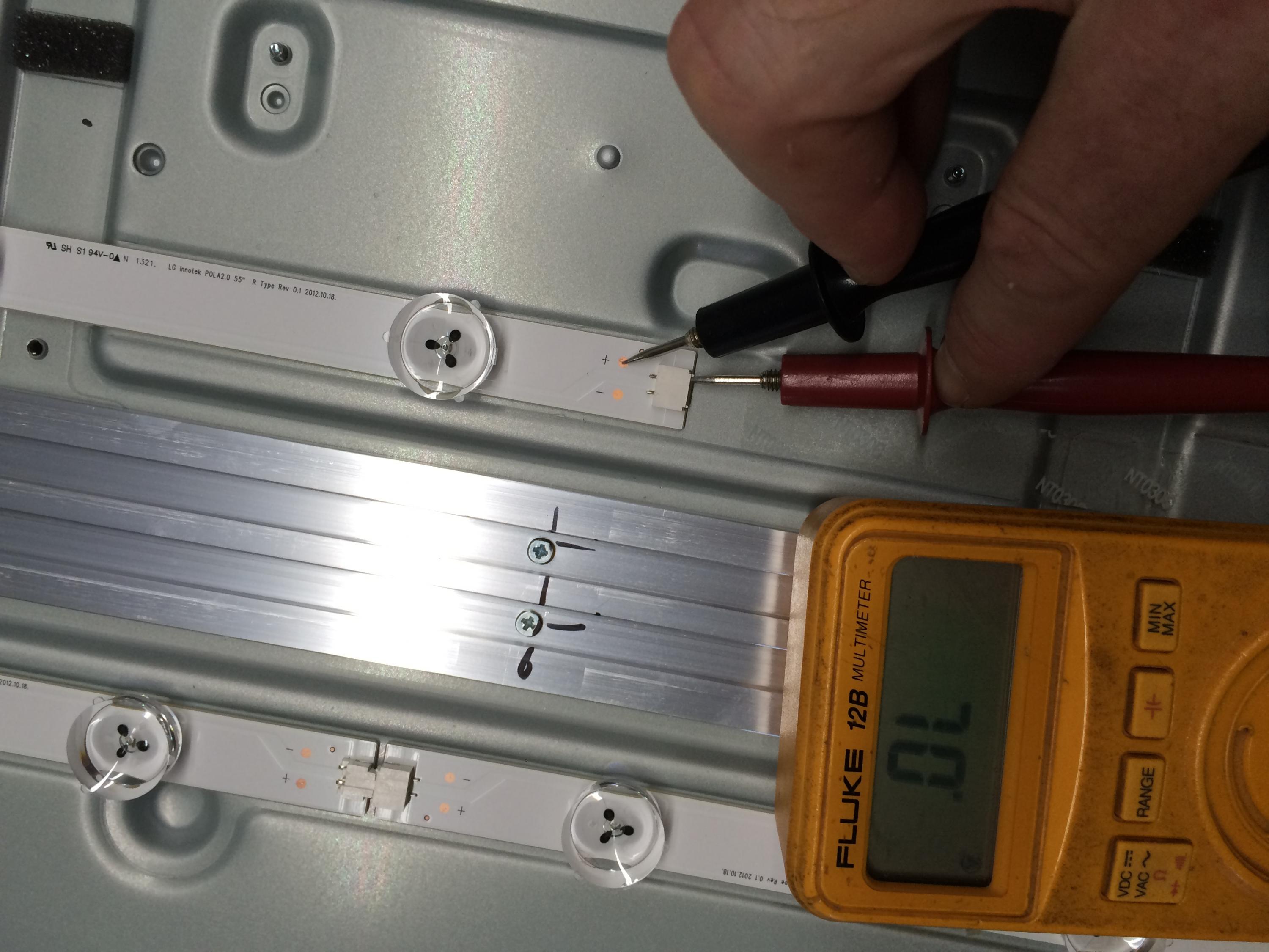

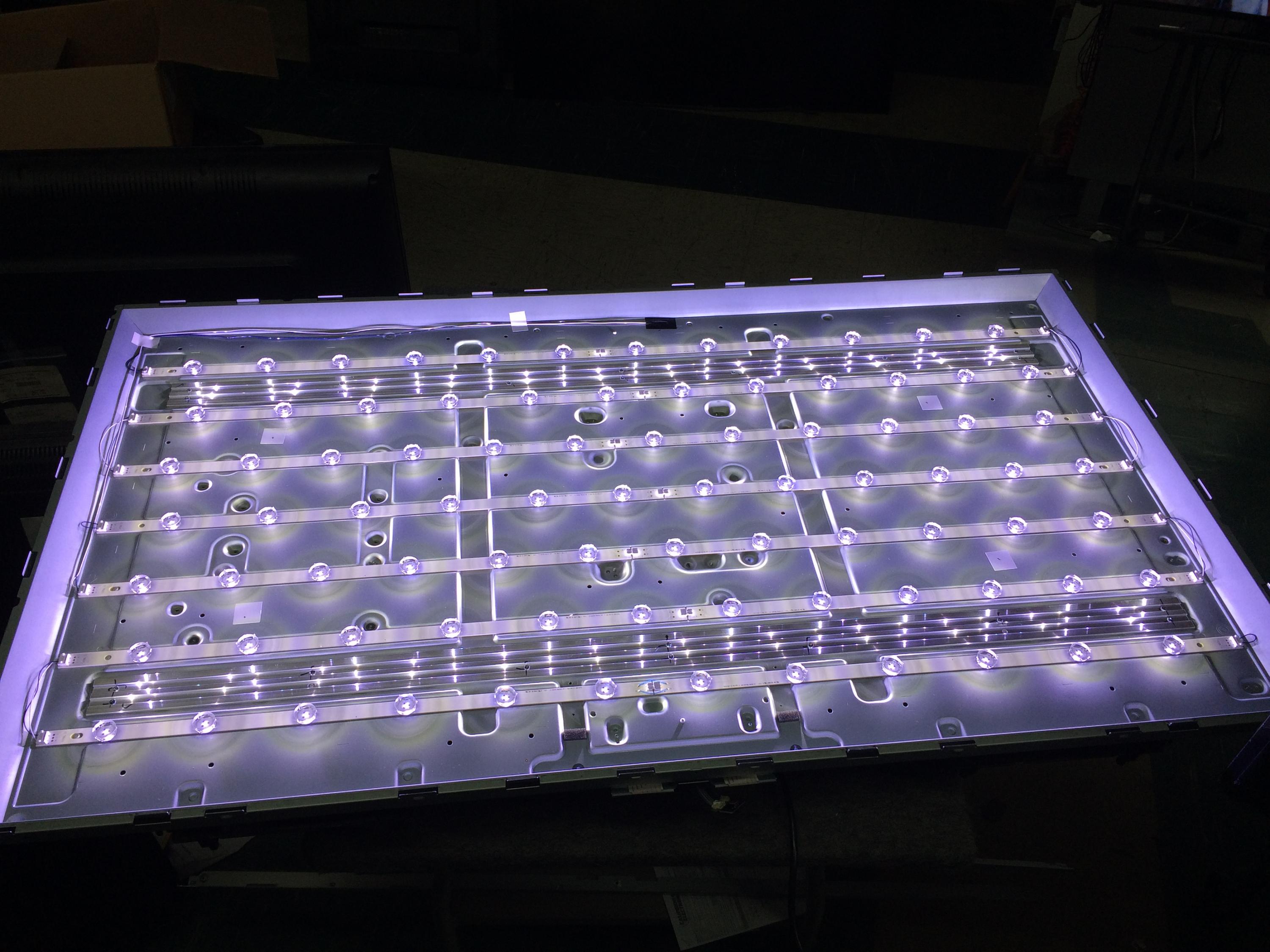

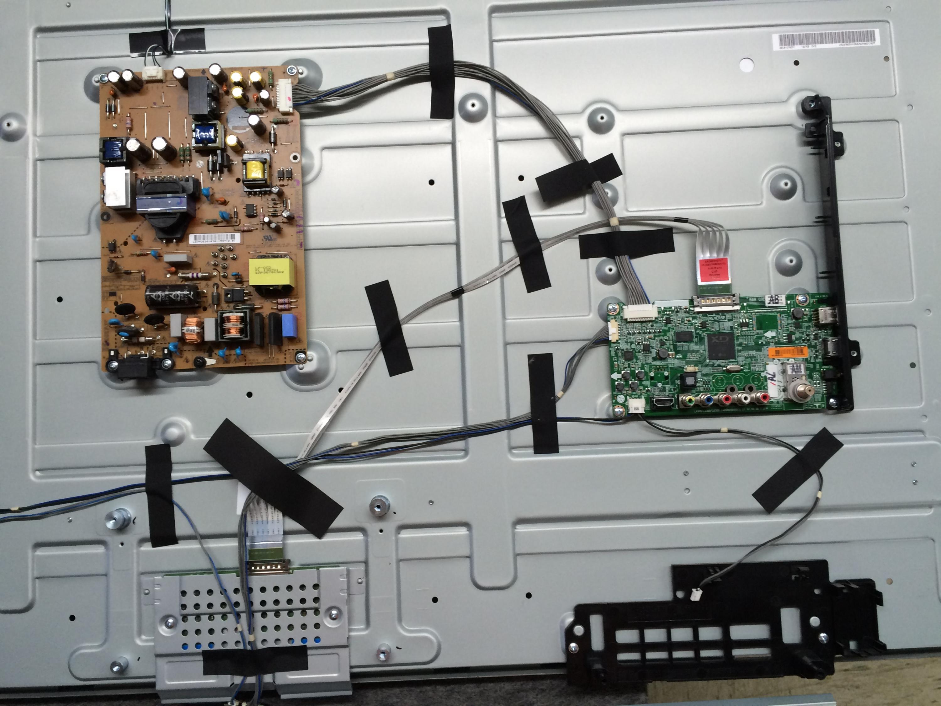

                    I have similar model. 55ln5200. Backlights flash at power on. Video and sound still good. Just no backlights. Took tv apart and tested the leds. Ran 18v across each led strip. They all lite perfectly.
                    Does anyone know what voltage is supposed to be developed by the LED Driver? This set runs two lines of leds.
                    I checked the upper set from chassis ground to LED+ and get 148v.
                    Lower set from chassis to LED+ is 171v. Seems odd since the upper set has more strips than the lower set.
                    Should I be measuring from LED- to LED+ ? Tried: Get 87.6v top set and 94.8v on lower set at moment of flash then 0v.
                      Re: Lg 55ln5100 backlight issue

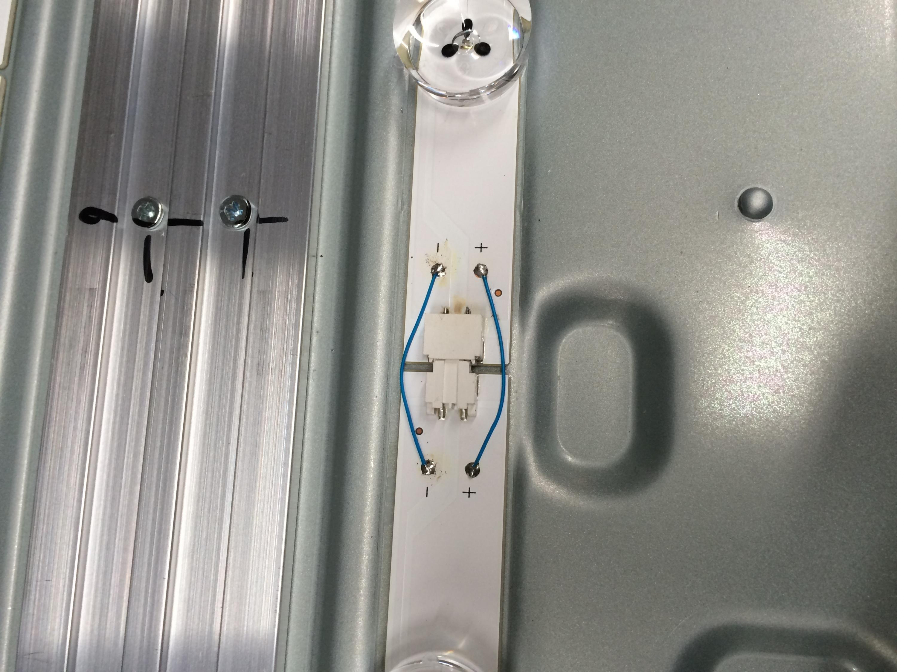

                      SOLVED: Found bad connection linking the bottom two strips together. Resoldered connector and added jumper across strips.

                        When I do the repair on these LED strips, I always resolder those connectors too.
