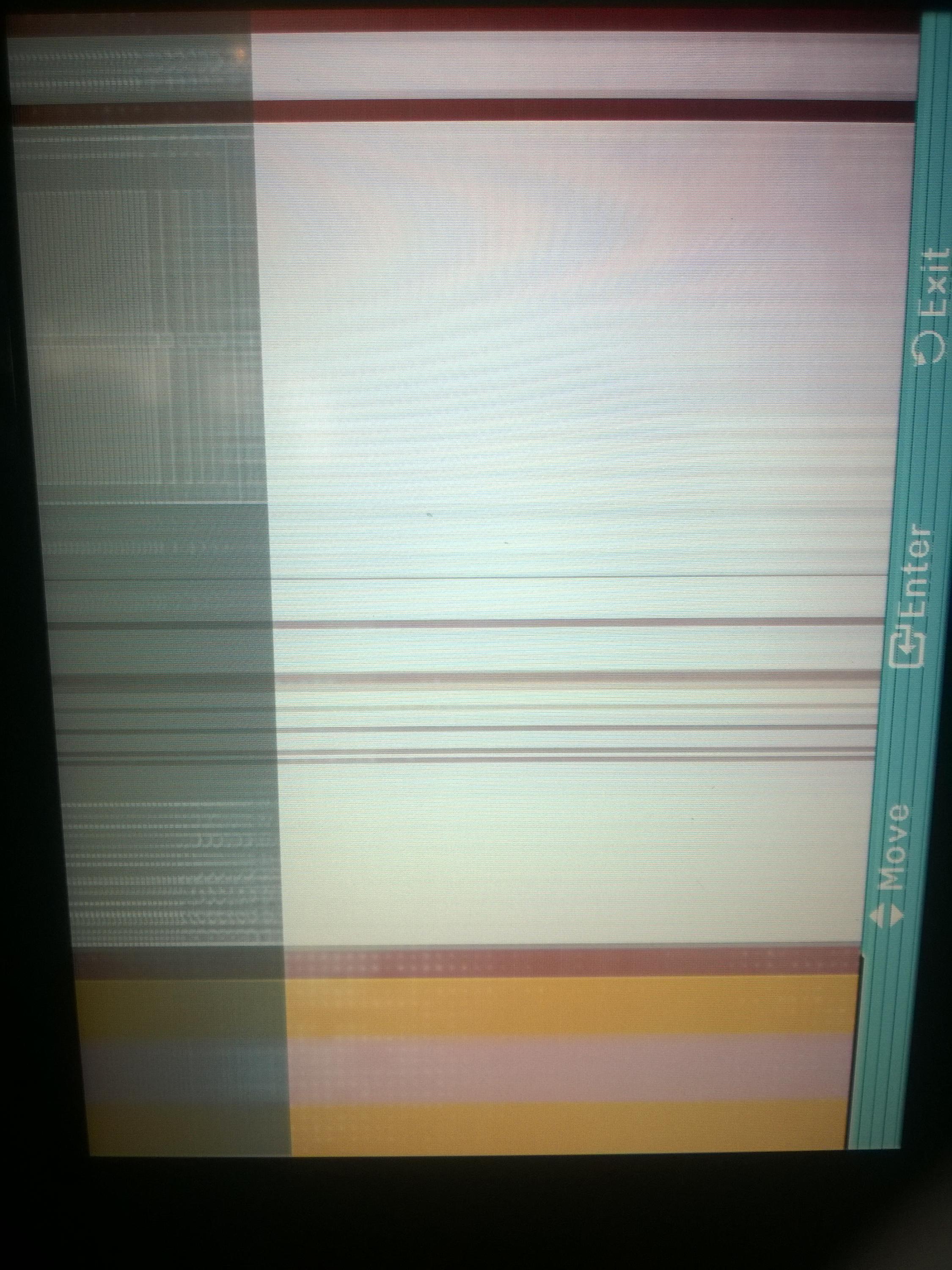

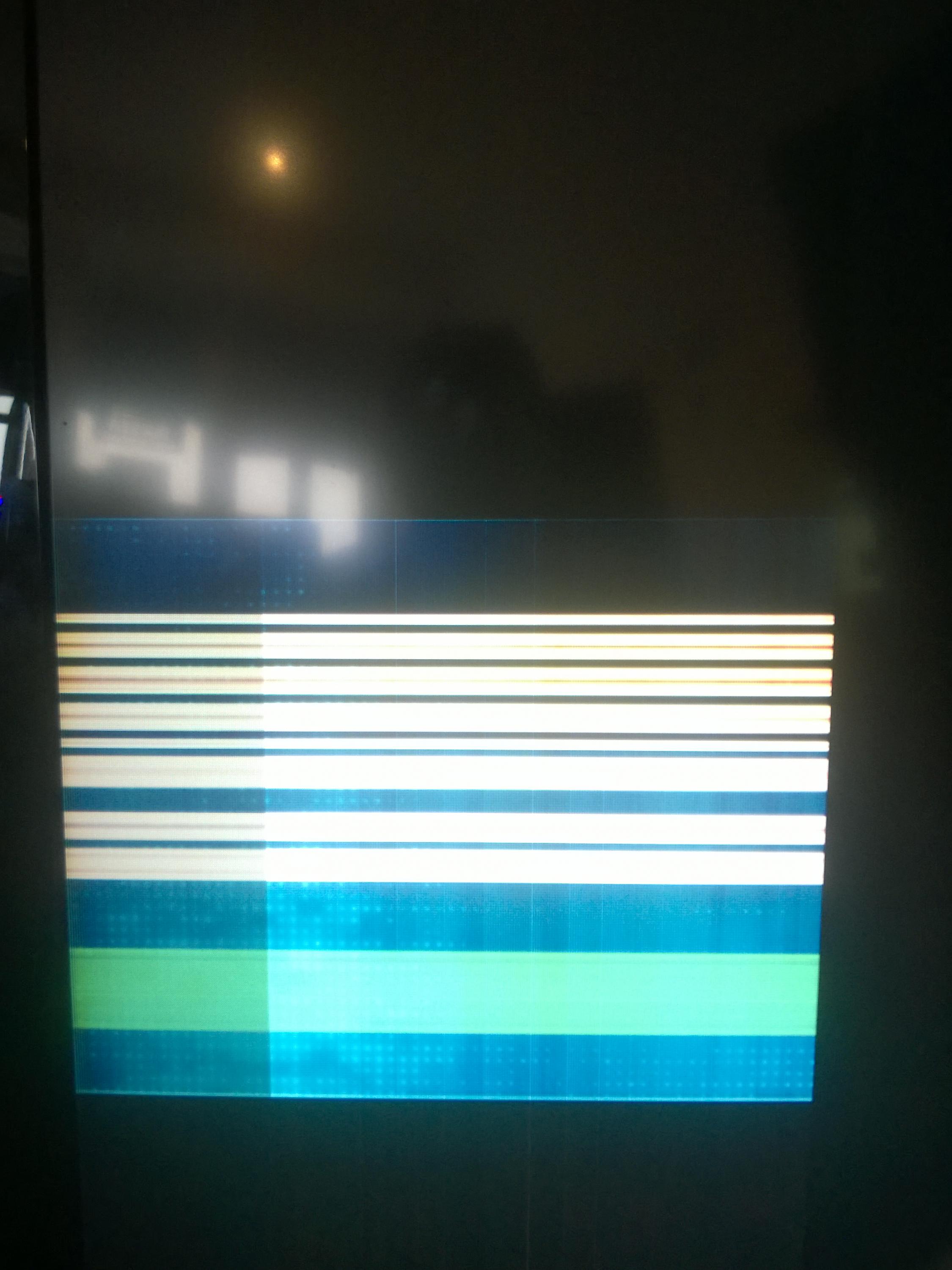

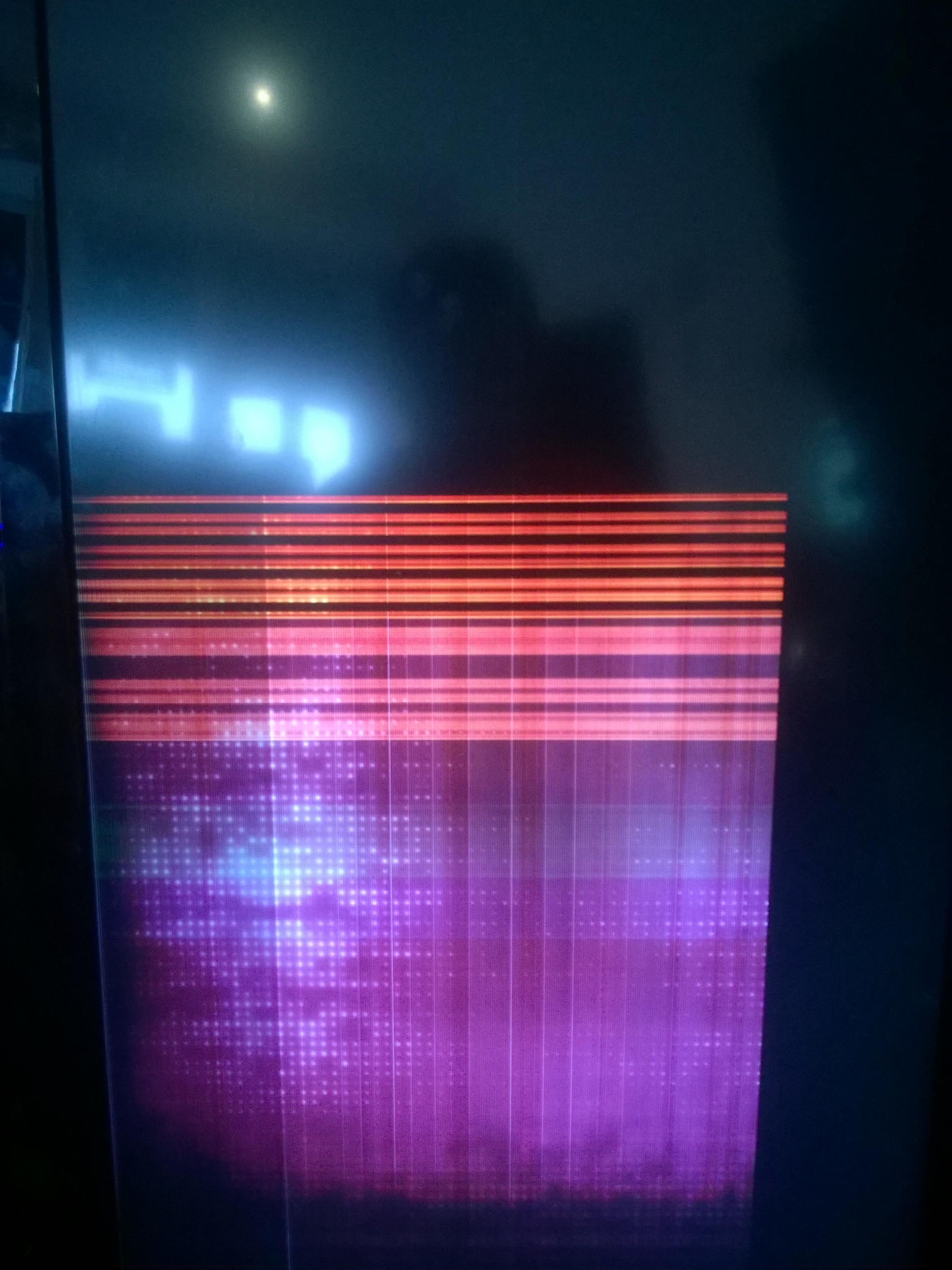

    Hello Badcapers,
    This LCD TV turns on without fail but shows coloured lines on screen, see images below.
    I have tested voltages from PSU to mainboard and PSU to Inverter, all seem ok.
    No bulging caps or other obvious damage.
    Reseated all cables and ensured PCB's were secure.
    Do Samsung LCD's have a test pattern generator like Plamsmas do? I read that most don't.
    If the TV is left alone for a while it settles down and majority of the lines disappear other than a rectangle in center of screen. As soon as I hit menu or source the screen lights up multicoloured like its christams. Actually quite relaxing to look at.
    I haven't looked at the control board yet as it's fairly difficult to get at.
    Any suggestions?

        I done the opposite and gave the boards a gentle heating with a heatgun. No difference to image after mainboard PCB and Tcon were heated
        TCon and Mainboards for this TV are cheap as chips, any way to definitively tell if the panel is bad?

          Tried freezing some areas of PCB, no difference. The largest IC is under a EM shield so I will have to remove that to ensure it gets cold properly.

            Re: Samsung - LE32A457C1D - screen artifacts
            tab bond issue maybe?
              unplug one side of the tcon, while the other is connected, then vise versa. See what happens to the screen.
                  Both ways the panel lights but black screen.
                      Took of the frame to get access to the tabs, they all look fine and no change to image on screen when I apply pressure.
                        Can we see a high res, straight shot picture of your tcon board?
                            aah! That's why the panel went black. It doesn't have 2 ribbon cables that go to the LCD, it only has one.
                            Check Q1 if it is shorted or not.

                              If Q1 has been shorted would it be an indicator of a bad panel? I watched a video recently where if a specific TCon transistor was blown it was 75% chance the panel was bad and a new board would go the same way as the old one.
                                you got it. Personally I'd risk a $20 tcon board.
                                  Looks like Tcon to me, if I remember Budm had the same chassis which the Tcon had a shorted diode package.

                                    I've checked the transistor, on my board its marked QT1, I am seeing resistance measurements in the mega ohms between most leads. A couple of readings were in 100's of K
                                    If Q1 was shorted I would see no resistance or very low resistance between two of the leads?
                                    When testing it was exhibiting some strange characteristics, resistance readings not staying steady (possibly due to self ranging DMM) and also same two legs tested twice gave a wildly different reading.
                                    How do these differ from IGBT's, are they just used for switching in lower power circuits? What is the purpose of this transistor on the Tcon board please excuse the newb questions
