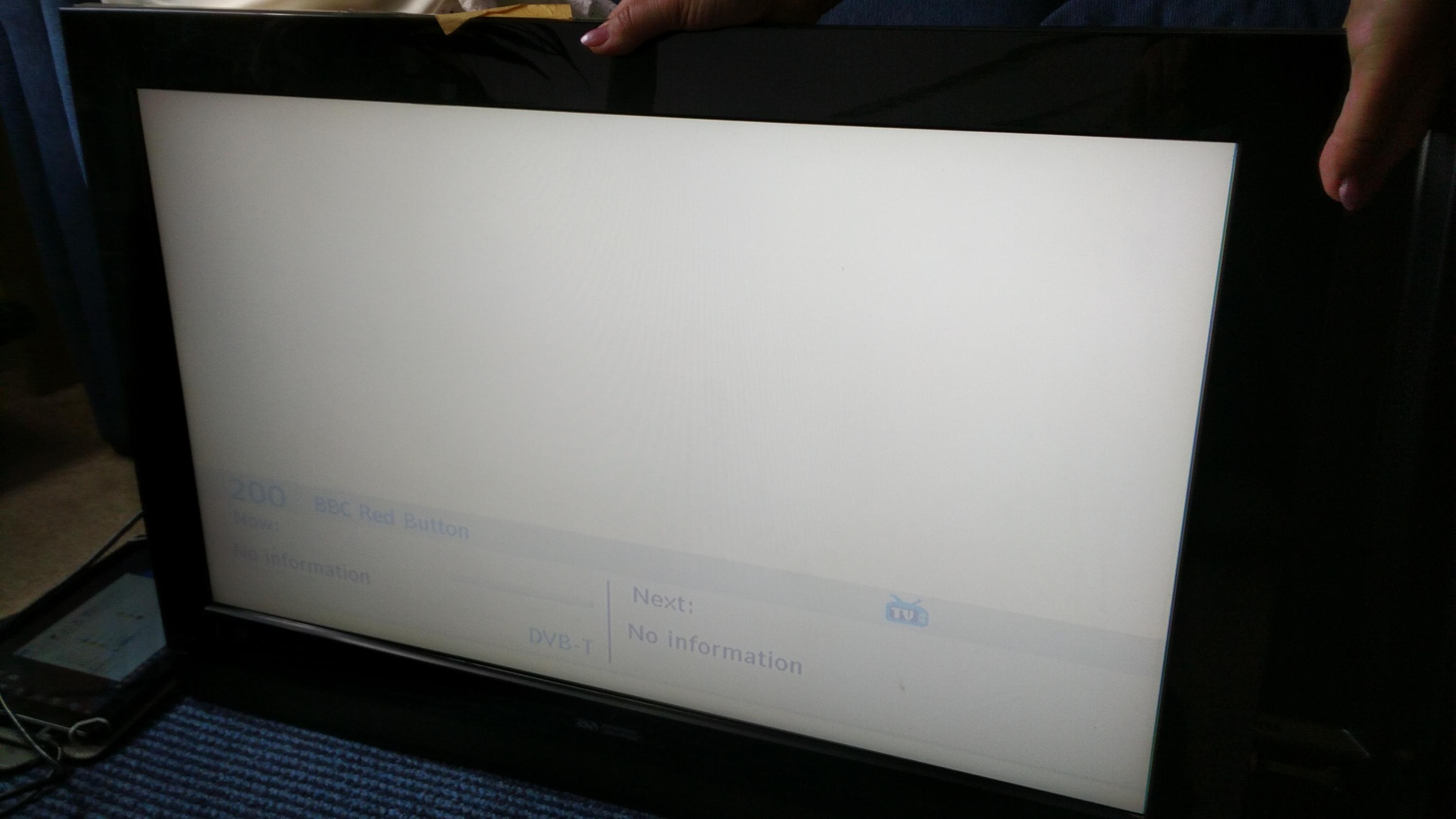

      Re: Samsung - LE32A457C1D - screen artifacts
      TV name is Acoustic Solutions (don't know the model) Sn: 6464686 900044I. I suspect that T-con is bad? T-con Nr: 320AA05C2LV0.0
      Any help, guys?
        Couple of those voltages look low

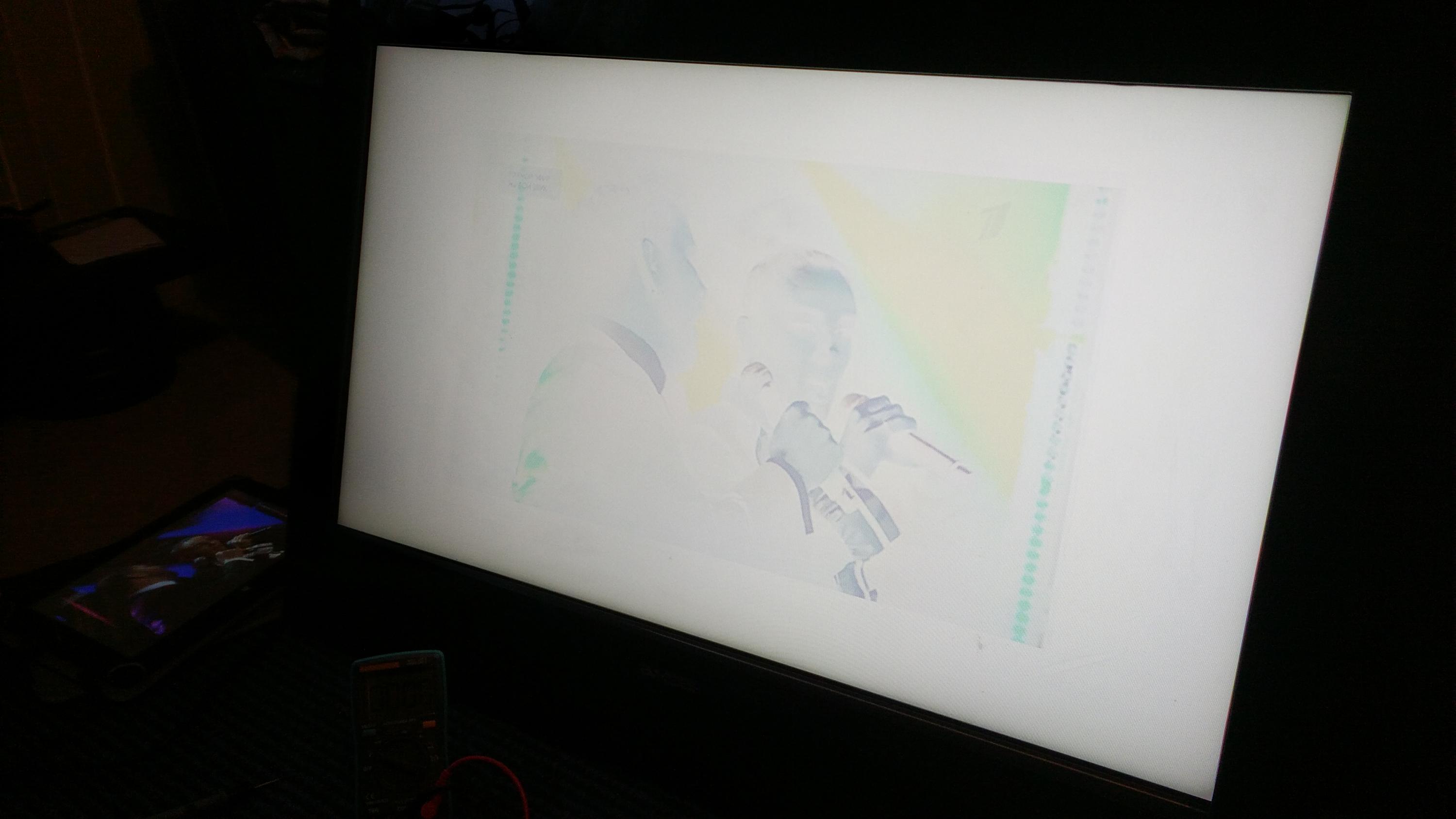

          What voltage should be? What points I have to check?
          Ps.: Here is another picture what I got after connecting a Tablet to the HDMI port. Here could be T-con problem or not?
            T-con voltages (typical)
            1. Vin (Vcc): 12Vdc or 5Vdc
            2. Vlogic,LCM, Vddd,VCC): 3.3Vdc
            3. Vda (Vs, Vsource,VDD, Vdda,Avdd): 14Vdc~20Vdc
            4. Vgh (Vgon,VGHR, Von, Vddg): 20Vdc~30Vdc
            5. Vgl (Vgoff,VST,VGHF,VGHEVEN, Voff,Veeg): -5Vdc~-7Vdc
            6. HVDD about 8v
            7. DVDD,VDDC 3.3v, 1.2v
            8. VCOM about 5~10vdc

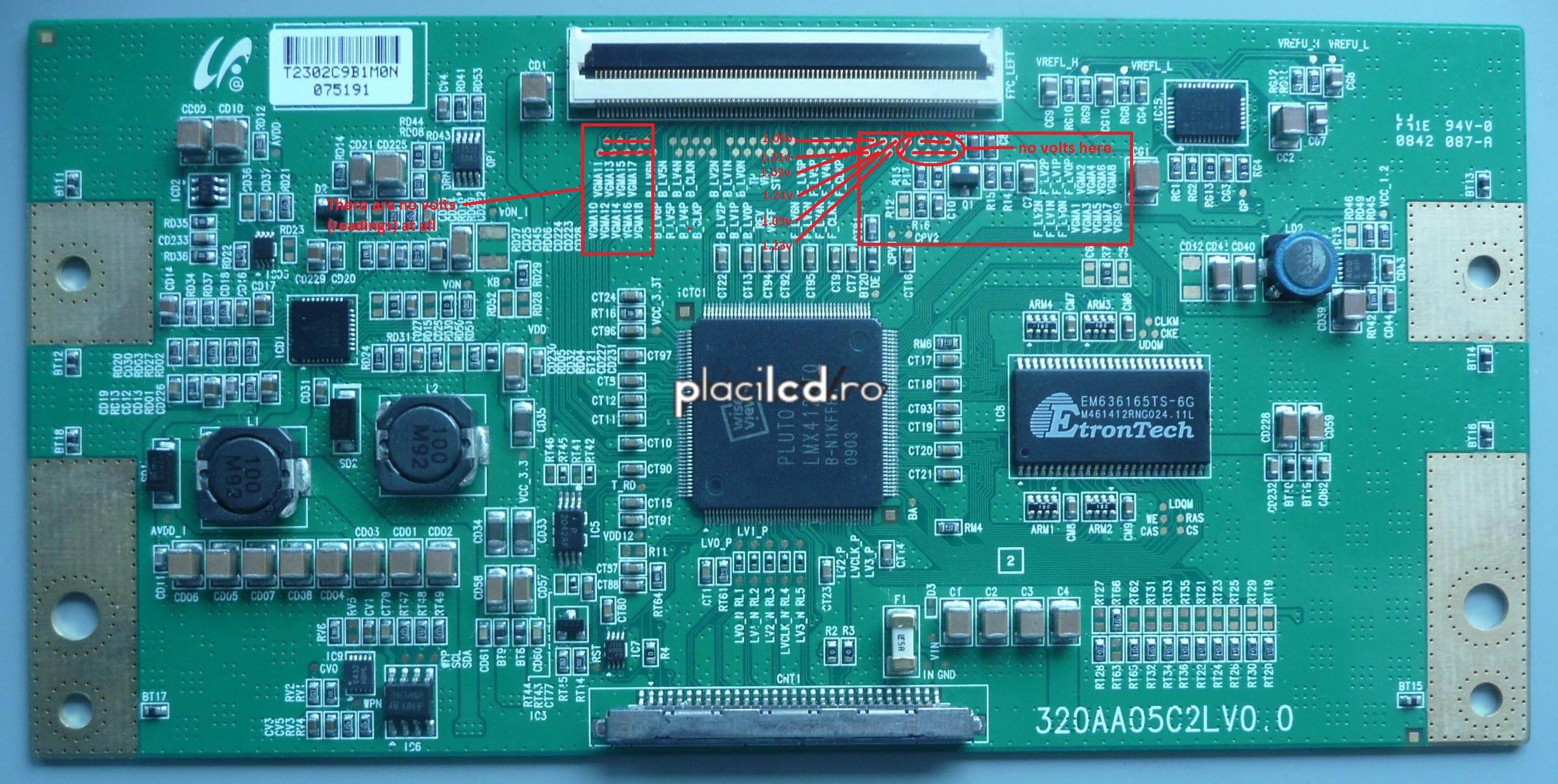

            Would also check gamma voltages. Need picture of t-con

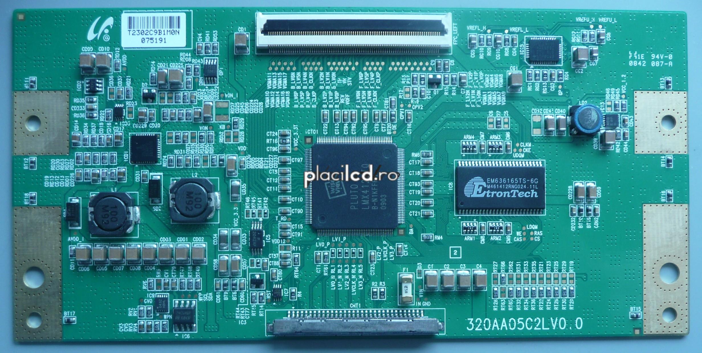

            • antas
              • Jul 2014
              • 148
              • Ireland
              Attached
              • dskall
                • Oct 2016
                • 2905
                • usa
                You could post vgma1-18 voltages in order
                  vgma1-18 voltages
                  Point me, please where they are...

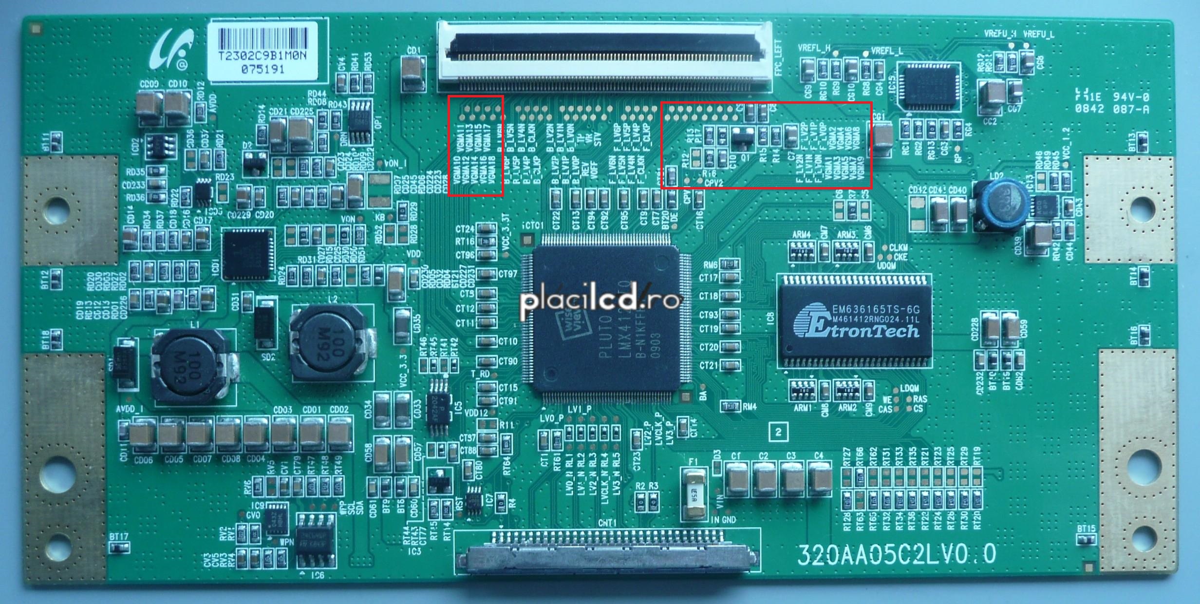

                    #29
                    There's a tcon that looks the same on ebay for £3.25 delivered.
                    I'm pretty sure the gamma voltages will be off.
                    What's the markings on the component top right ?

                      #30
                      Thank you for your quick reply. It's:
                      MAXIM
                      MAX9590
                      ETU905
                      NTP60CB
                      It is the chip IC15

                        #31
                        Thanks, as suspected that is the gamma IC. However if a tcon is £3.25 delivered, there's not much point replacing the IC.
                        I've marked the points that show where the gamma voltage test points are.
                          You were right, my friend. There are no volts at all. Is that mean if there are no volts on these points, the gamma IC is broken and resoldering this IC will fix T-con board (in this case)? Or it is not worth to do soldering jobs when this model of T-con cost a few pounds only?
                            This The washed out image certainly looks the same as when the more common AS15 gamma ICs Fail. Those tcons can cost over £15 and commonly over £30 so replacing a 50p part that takes 5 minutes to replace is worth doing.
                            In your case it looks like the tcon at £3.25 delivered is cheaper than the IC that has to come from China.
                            I would have expected some volts on those pins, but I still think it's worth just replacing the tcon.
