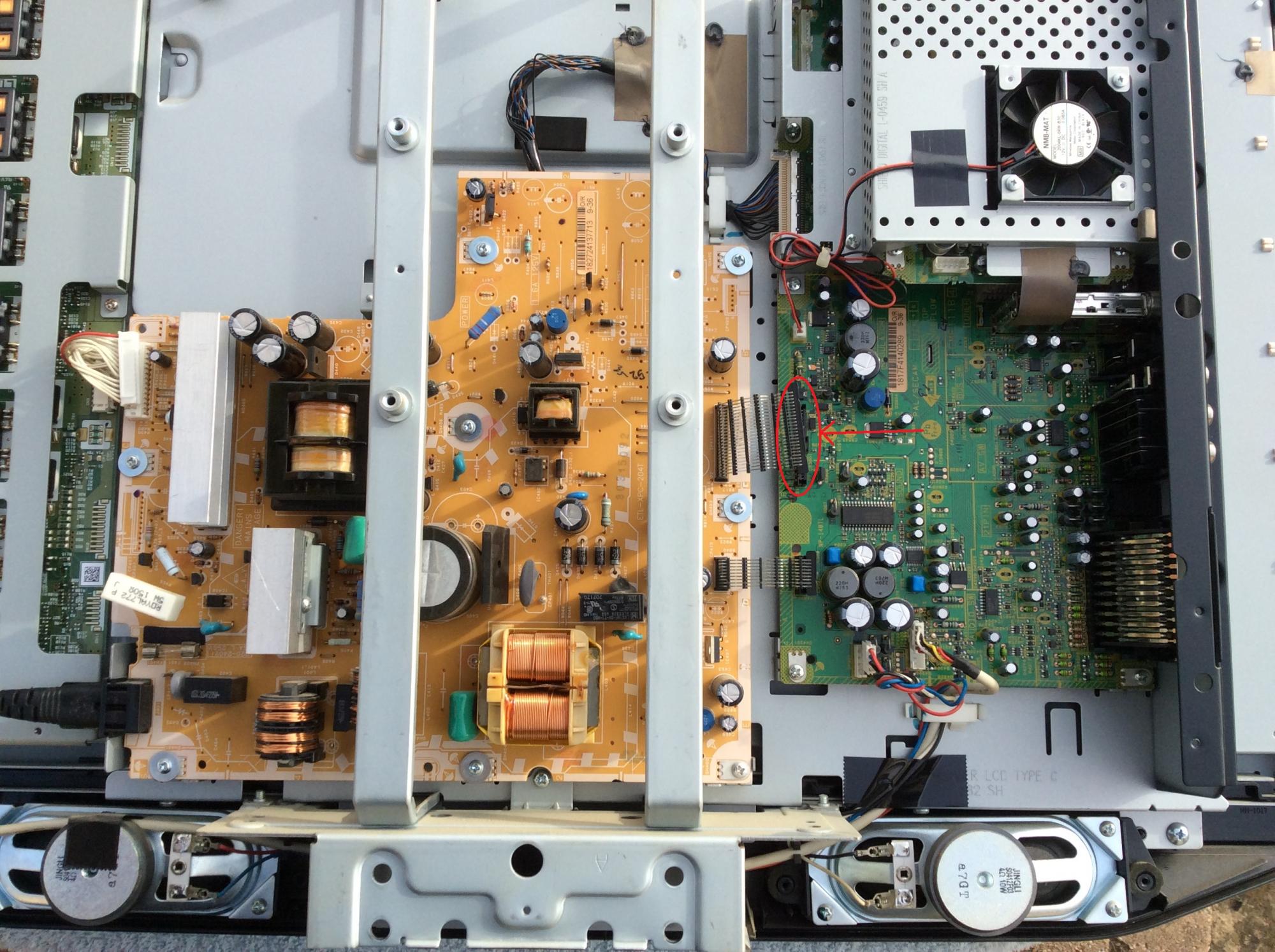

    Hello guys,
    Got here a Sharp LCD with this wierd sympton, once i connect the power plug, the tv turns ON (green led on front, and the relay on psu clicks), but the display stays black and impossible to turn OFF with remote or manually.
    I have disconnected a connector (photo above) that goes from psu to the input pcb and now it doesn't turn on once connected.
    Can anyone help me please ?

    Re: Sharp LC-26AD5E Always On once connected
    Disconnect the other cable lower down and see if the backlights come on when you power on.
      Even if the led is Green, there no reaction at all of the tv, and the only way to turn it OFF is by removing the power cable.
      Is this problem psu related or is the scaler/input pcb the culprit ?
      If you are talking about the connector lower the one i disconnect, there is no change.
      thanks

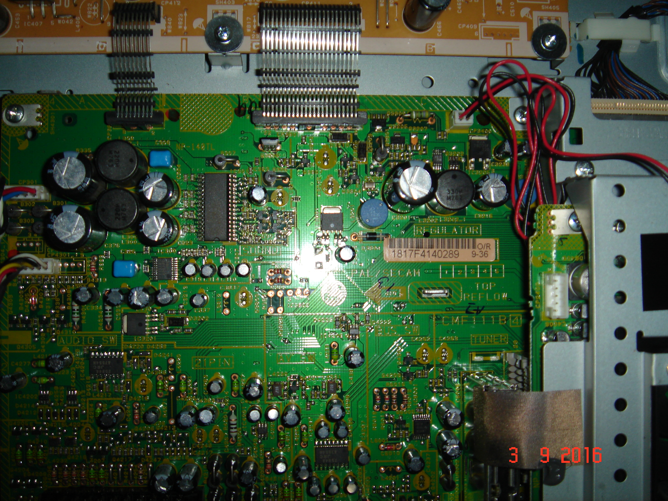

        Maybe a eeprom/spi flash chip issue whats the mainboard number?

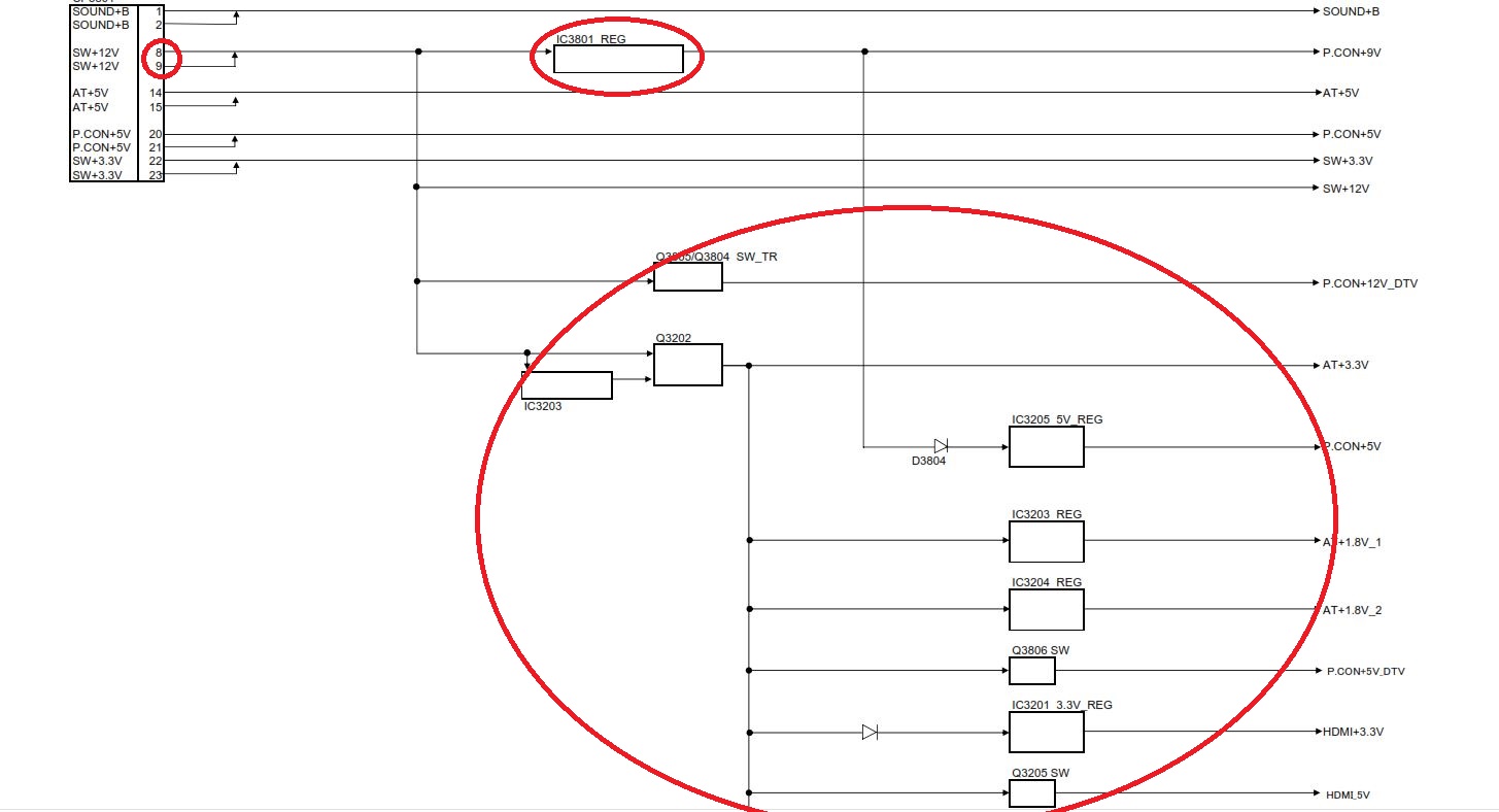

          What dc voltages do you have or not have at the connectors going to the main board?
              1817F4140289 (Photo below)
                  main boards are cheap if that is the issue test the psu voltages first though
                    On CP3801 Connector i'm missing the 12 Volts on Pin 8 and 9, the rest is OK.
                    Instead of 12V i'm Getting 1,59V
                      From the schematic, the Regulator for the 12V is the Q422, it's 3 Leg Transistor, the reference is KTB1151.
                      And indeed on the bottom side of the pcb, on this ic location the epoxy is a little burned.
                      The 100 bucks question, where to find this KTB1151
                        maybe something is pulling the 12 volts down? i wonder if you can jump the psu with resistors too test the psu outputs
                          Or maybe i should measure with the connector disconnected from the main board ?
                          No, it won't work, cause the psu will not turn on .... shutt
                            The 12V Lines are linked with many reg's on the mainboard, this is gonna be a pain in the mikta ...
                              I have replaced Q422 and non Change, i still have 1,58V instead of 12V.
                              I also removed IC3801 and Q3802 but still no change.
                              Can anyone give a tip ?
                                I would check the resistance between GND and PIN 8/9 first, then take the reading between GND and output of the Regulator IC3801, Q3804/3805, 3202 output side.
                                Q3802: do you mean Q3202?
                                Report the readings.
                                BTW, what DCV do you have at the BASE of Q422 and GND?
                                  BTW, if something is loading down that Regulator circuit that bad I would expect the fuse F404 1.6A to blow first.
