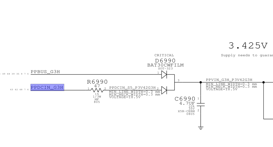

          D6990
          with charger only
          pin 2: 16.70
          pin 3: 16.41
          with bat only
          pin 2: 0.010
          pin 3: 2.952
          • mon2
            • Dec 2019
            • 14588
            Re: 820-2915-A Wont power on with battery connected
            D6990 is with 3 pins.
            Please also post the voltage of pin #1 of D6990 for each case.
            Is the battery charged? What is the voltage on the battery being tested ?
                  What is the voltage on both sides of R6990 ? Measure with the battery connected.
                  Post the voltage of PP3V42_G3H with only the battery.

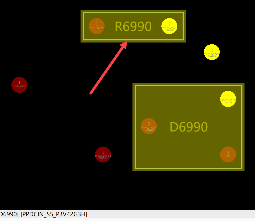

                    R6990
                    Bat only
                    0.010 both sides
                    bat & dc
                    16.62 left side pin 2
                    16.79 right side pin 1
                    • mon2
                      • Dec 2019
                      • 14588
                      Remove all power.
                      Multimeter in DIODE mode.
                      Check & post the readings of:
                      Red meter probe on pin # 1 & black meter probe on pin # 3.
                      Red meter probe on pin # 2 & black meter probe on pin # 3.
                      Red meter probe on pin # 3 & black meter probe on pin # 1.
                      Red meter probe on pin # 3 & black meter probe on pin # 2.
                      We want to confirm that D6990 is not damaged.
                      • beogeek
                        • Apr 2018
                        • 100
                        • Serbia
                        Red meter probe on pin # 1 & black meter probe on pin # 3. 1.094
                        Red meter probe on pin # 2 & black meter probe on pin # 3. 0.253
                        Red meter probe on pin # 3 & black meter probe on pin # 1. OL
                        Red meter probe on pin # 3 & black meter probe on pin # 2. OL
                        • mon2
                          • Dec 2019
                          • 14588
                          Remove D6990 off the logic board.
                          Then measure again the voltage on both sides of R6990 with the battery only.
                          Post the readings.
                          • beogeek
                            • Apr 2018
                            • 100
                            • Serbia
                            R6690 0.001v on both sides with bat only

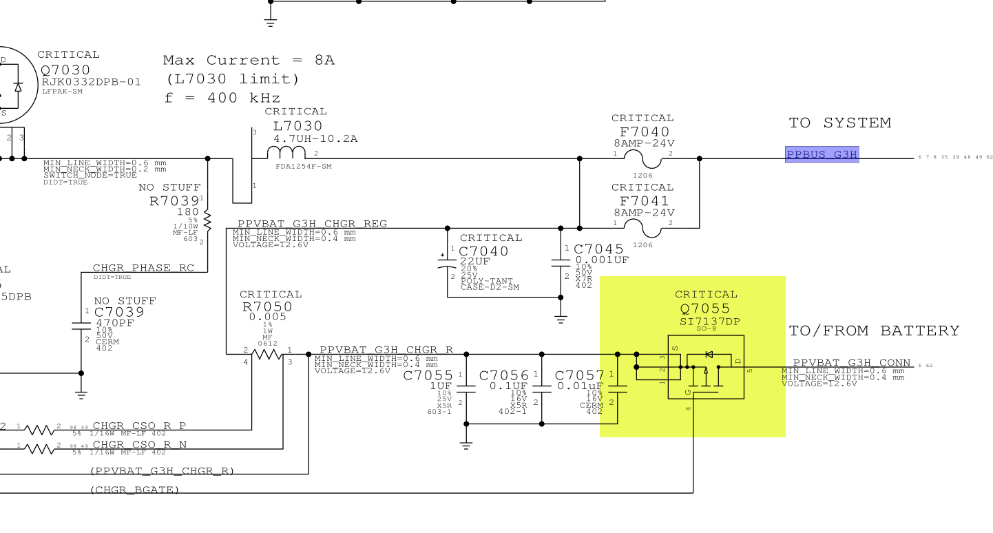

                              Post the voltage readings on Q7055 mosfet with only the battery.
                              Voltage readings of:
                              pins 1-2-3 (Source)
                              pin 4 (gate)
                              pins 5-6-7-8 (Drain)
                              Please confirm that you are measuring the voltage of resistor R6990 (I had a typo in the earlier post - now corrected).
                                  1) Post the voltage readings on Q7055 mosfet (with only the battery).
                                  2) Then, remove all power. Meter in resistance mode (2k scale).
                                  Measure & post the readings of the same Q7055 battery mosfet for:
                                  source (1-2-3) & drain (5-6-7-8)
                                  source (1-2-3) & gate (4)
                                  gate (4) & drain (5-6-7-8)
                                  Checking for any low resistance readings which will likely be due to the mosfet being defective.
                                  • beogeek
                                    • Apr 2018
                                    • 100
                                    • Serbia
                                    Q7055
                                    source (1-2-3) & drain (5-6-7-8) 0.4Ω red probe on source, black on drain
                                    source (1-2-3) & gate (4) 171.3Ω red probe on source, black on gate
                                    gate (4) & drain (5-6-7-8) 165.7Ω red probe on gate, black on drain
                                    • mon2
                                      • Dec 2019
                                      • 14588
                                      Q7055 is defective and needs to be replaced.
                                      You can remove off the logic board and check the resistance again to confirm the readings. The resistance is too low for this mosfet.
                                      If possible, replace with the same part but many parts can work as a replacement, if needed. Maybe you have a donor board ?
