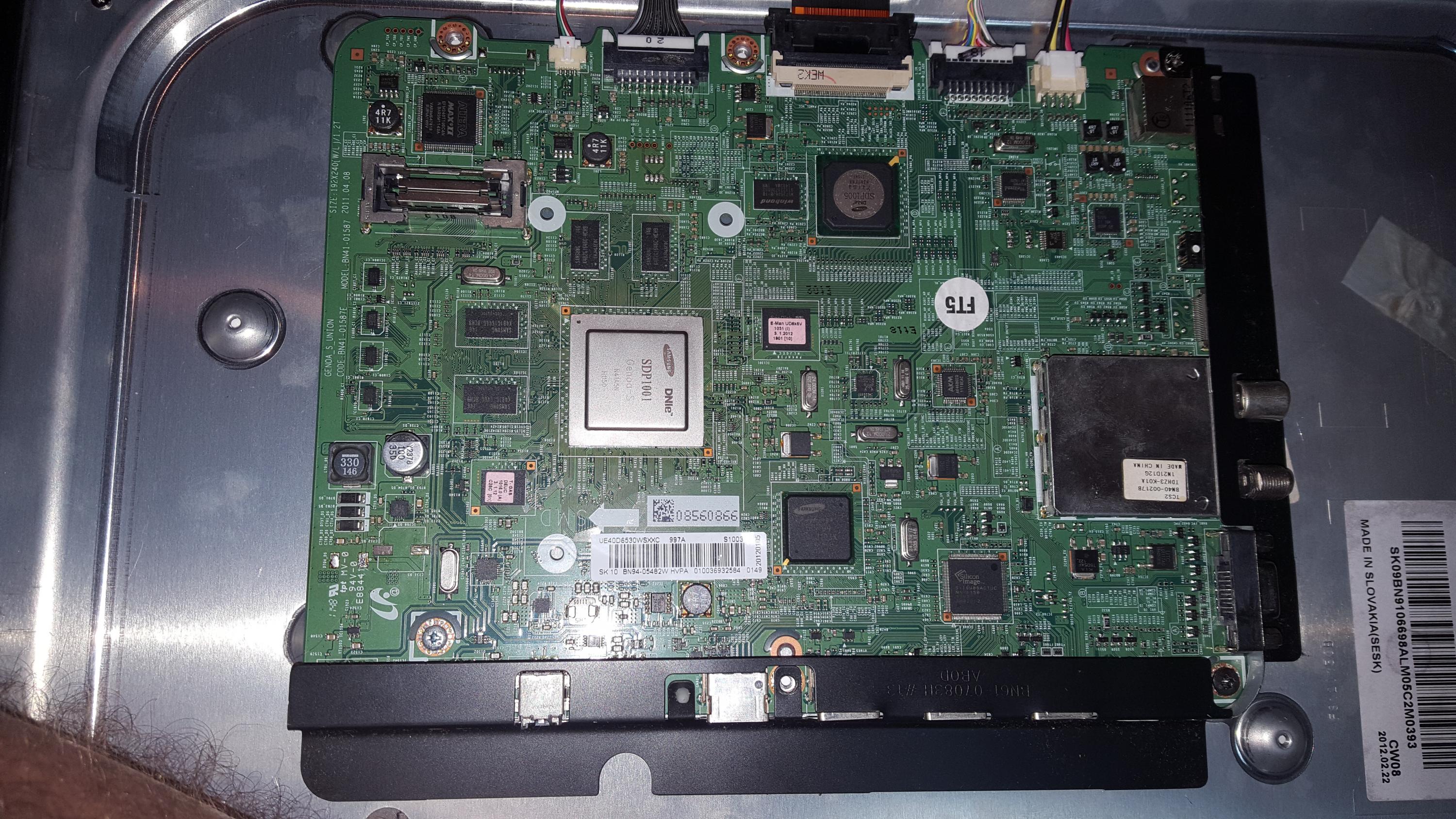

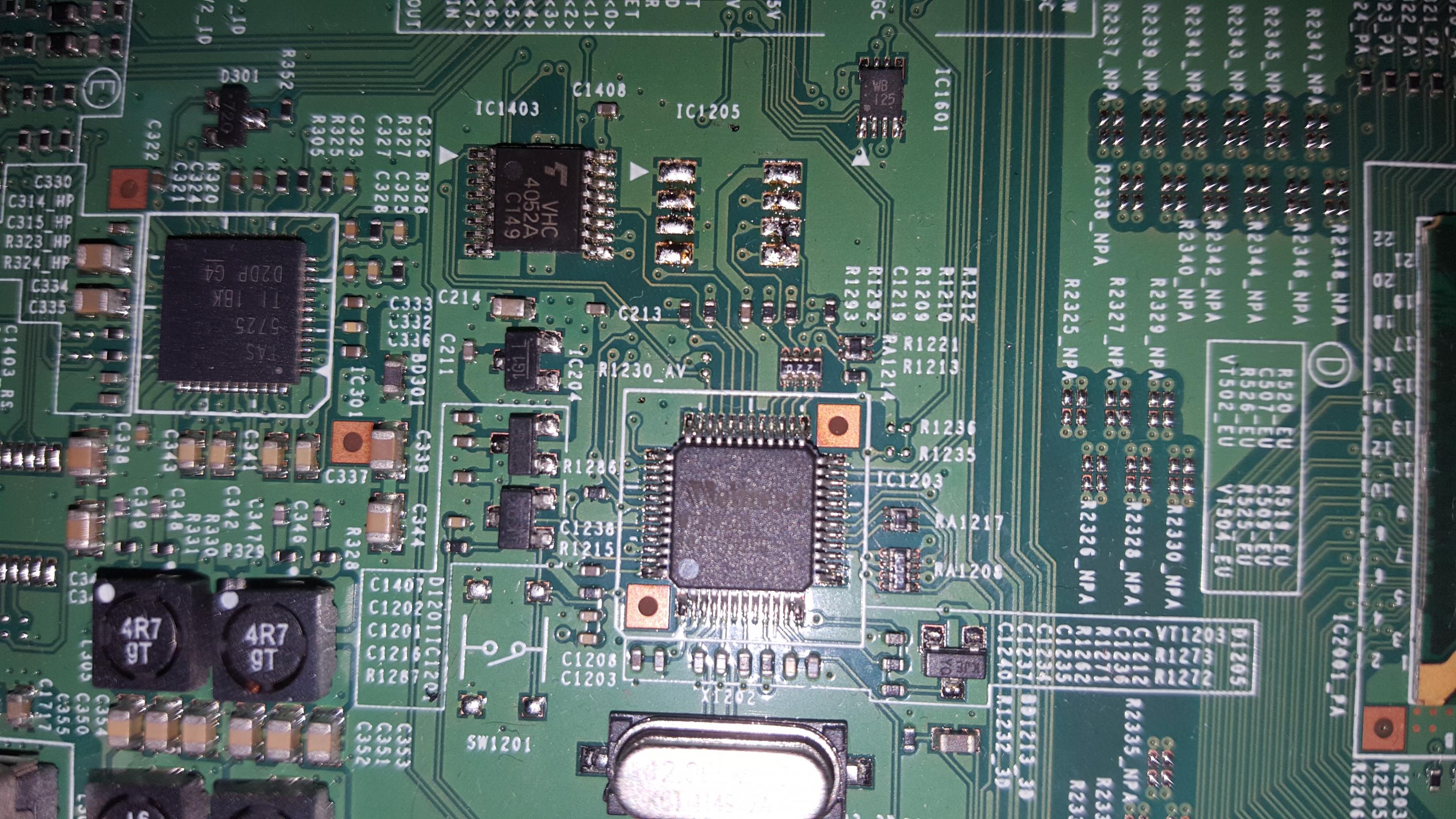

    I have a Samsung UE46D6500 that "doesn't boot"(?)..
    First of all, when I unplug main board from power board, back light lights up. Not sure, but I think this eliminates power issues..
    With all connected TV powers on and off and LED blinks pressing sound channel menu etc, either by dashboard or remote.. But it's always black screen (backlights won't turn on) and i ear no sound...

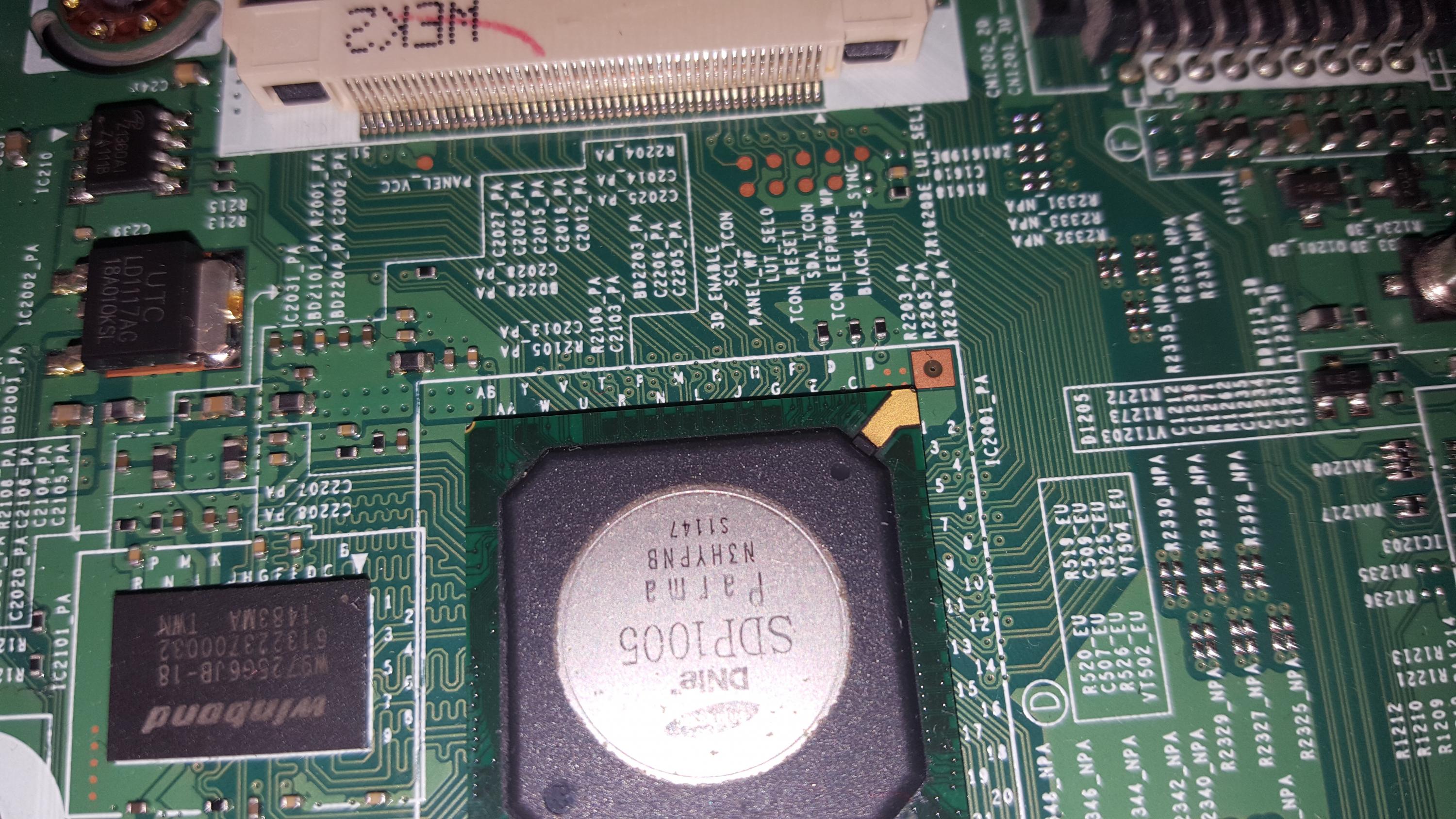

    I took a look over the boards and all I see is heating marks on the board near the DNie CPU.
    Can you help please? Also, if someone has schematics or service manual I'd appreciate it.
    Thanks.

    Pictures of the board? What DCV testing did you do so far as far as the Voltages and the Command signal Voltages?
    We need more details and pictures.

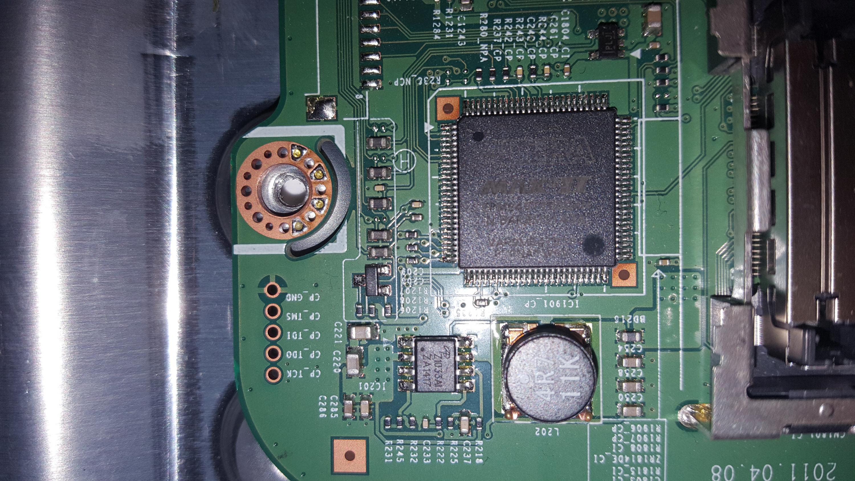

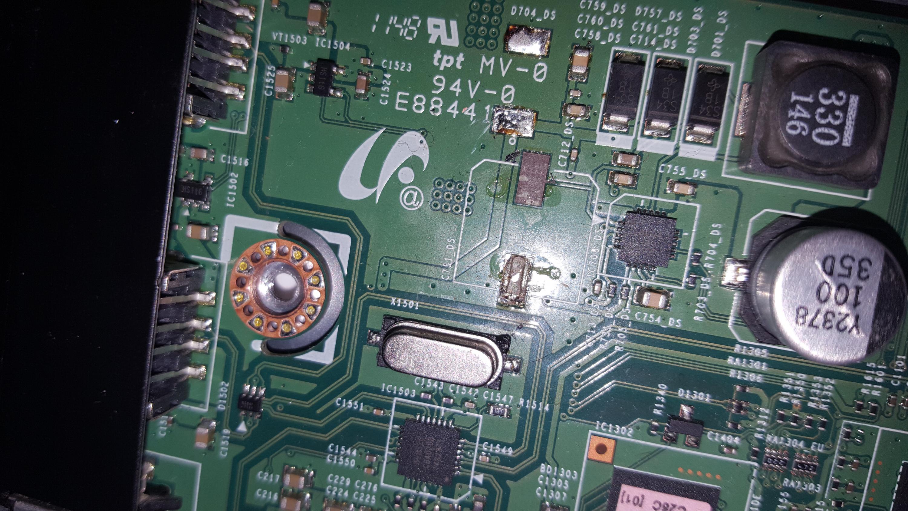

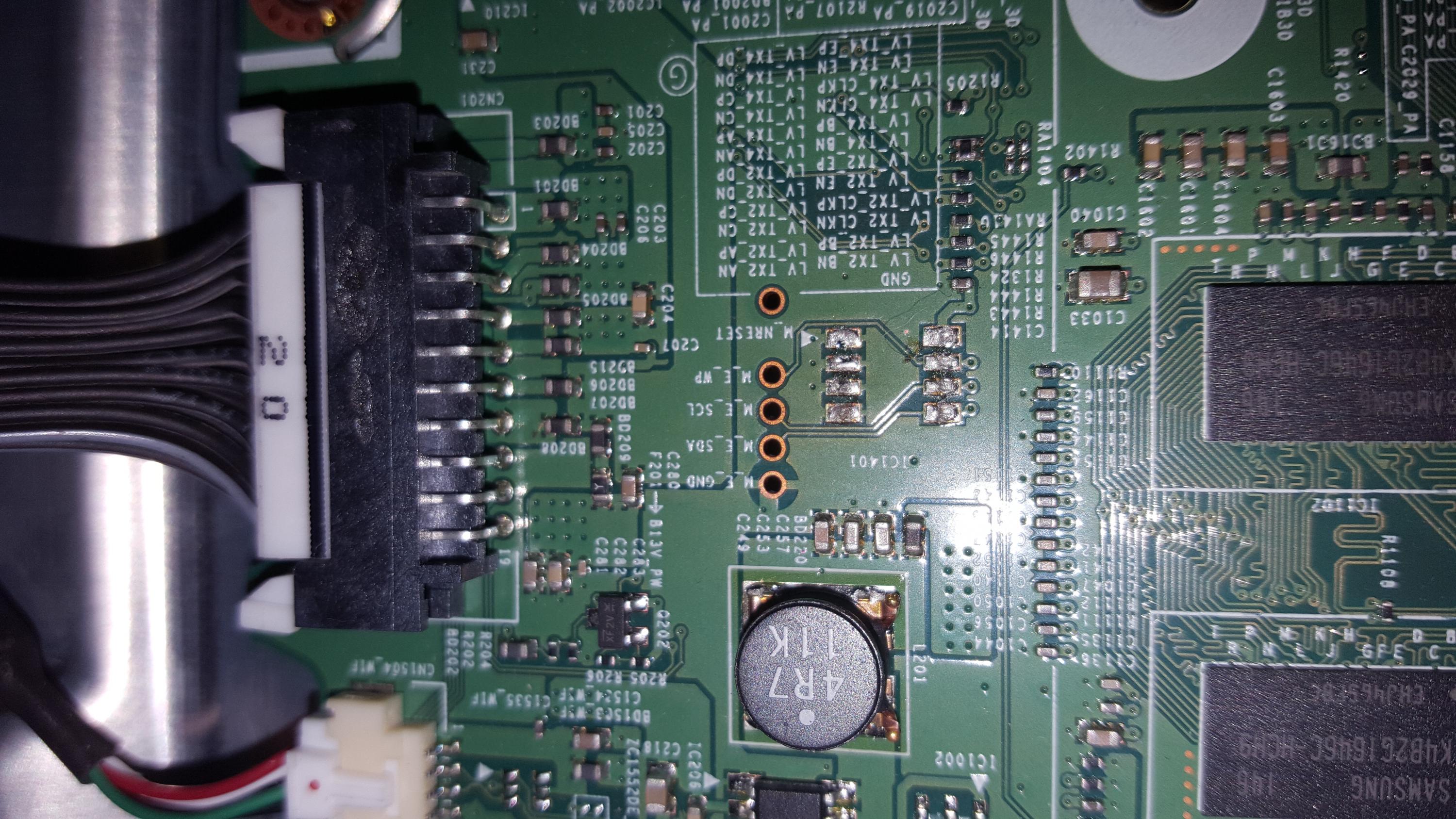

      Here are some pics of the board. While taking pics I noticed some components might have been removed from main board. This wasn't noticeable at first glance I took, sorry. Tampered solder also in fotos.
      I didn't took voltages because I didn't find any voltage test points on main board, only on power.
      IC1401, IC1205, C751_DS and D704_DS seem to be missing..
      Thanks.

        Re: Samsung UE46D6500 black screen no sound.
        https://www.badcaps.net/forum/attach...5&d=1472832422

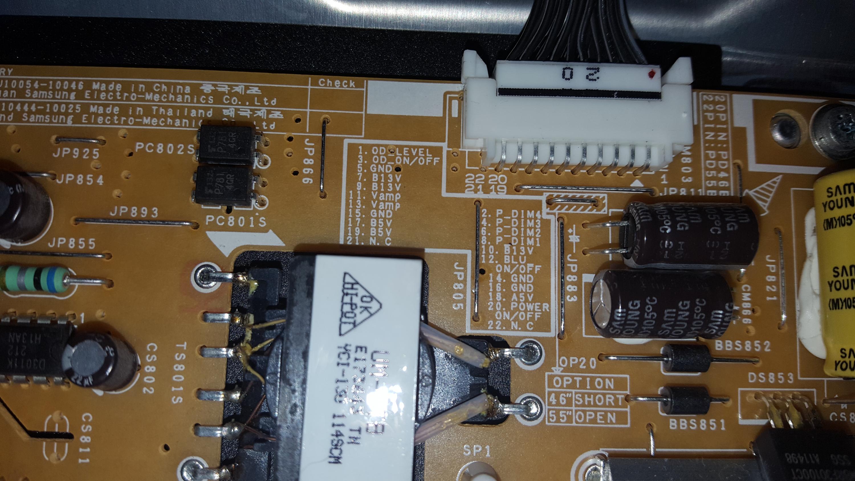

        What is the board P/N? BN44-??????
        What DCV do you get on pin 12 (BLU ON/OFF), pin 20 (POWER ON/OFF)?
        So someone try to fix this TV before you?
          I assume you bought this tv with this defect?
          There are parts missing on the mainboard so it had a failure BEFORE someone removed the parts. Probably BGA chip failure and he heated the board.
          Wanna fix the tv? Buy a new mainboard and add extra cooling/heatsink plaster and it should be good to go.
            Yep, get the new board.
            https://www.badcaps.net/forum/attach...2&d=1472832422
            So the EEPROM IC1401 is removed, plus other parts.
              Originally posted by budm
              [url]So someone try to fix this TV before you?
              Apparently yes, I bought it to learn, try to fix it and get a "new" TV.
              I might need to buy another main board, right?
              pin12- 0.24
              pin20-5.35
                Yep, new main board needed.
                'pin12- 0.24' No backlights on signal.
                        Originally posted by Learn2Day
                        It's the exact same part number! Bn41-01587e, you can check my first pic
                        Bn41-01587e is the blank PCB as printed with white silk screen, blank board is REV E in this case.
                        The PCBA as printed on the barcode sticker is BN94-05482W.
                        Blank PCB can be stuffed hundreds ways to make a bunch of PCBAs for certain model of TVs required.
                        https://www.badcaps.net/forum/attach...9&d=1472832422
                        I hope that who ever worked on this TV before you did not put the board from other model that uses the same PCB into this chassis.
