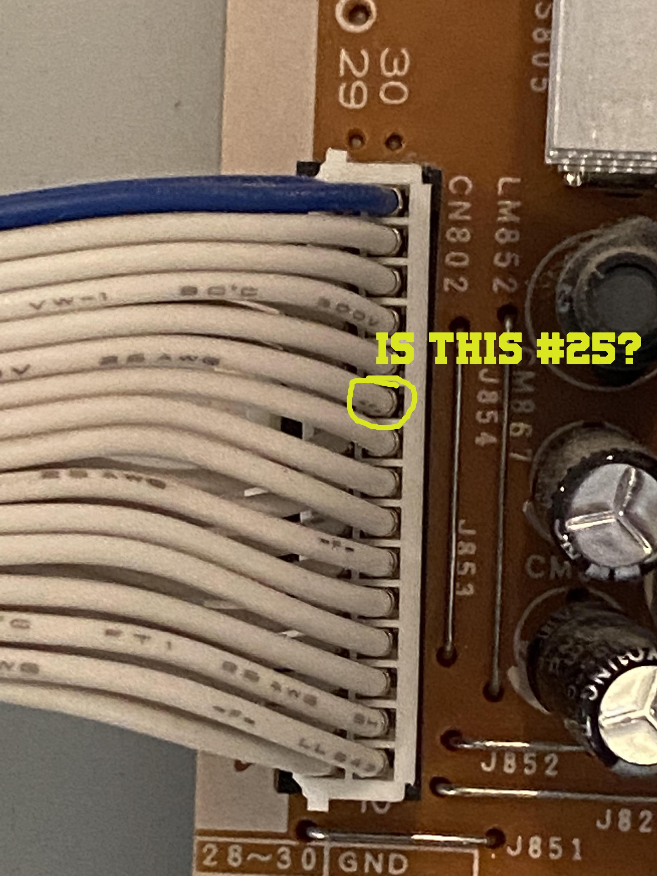

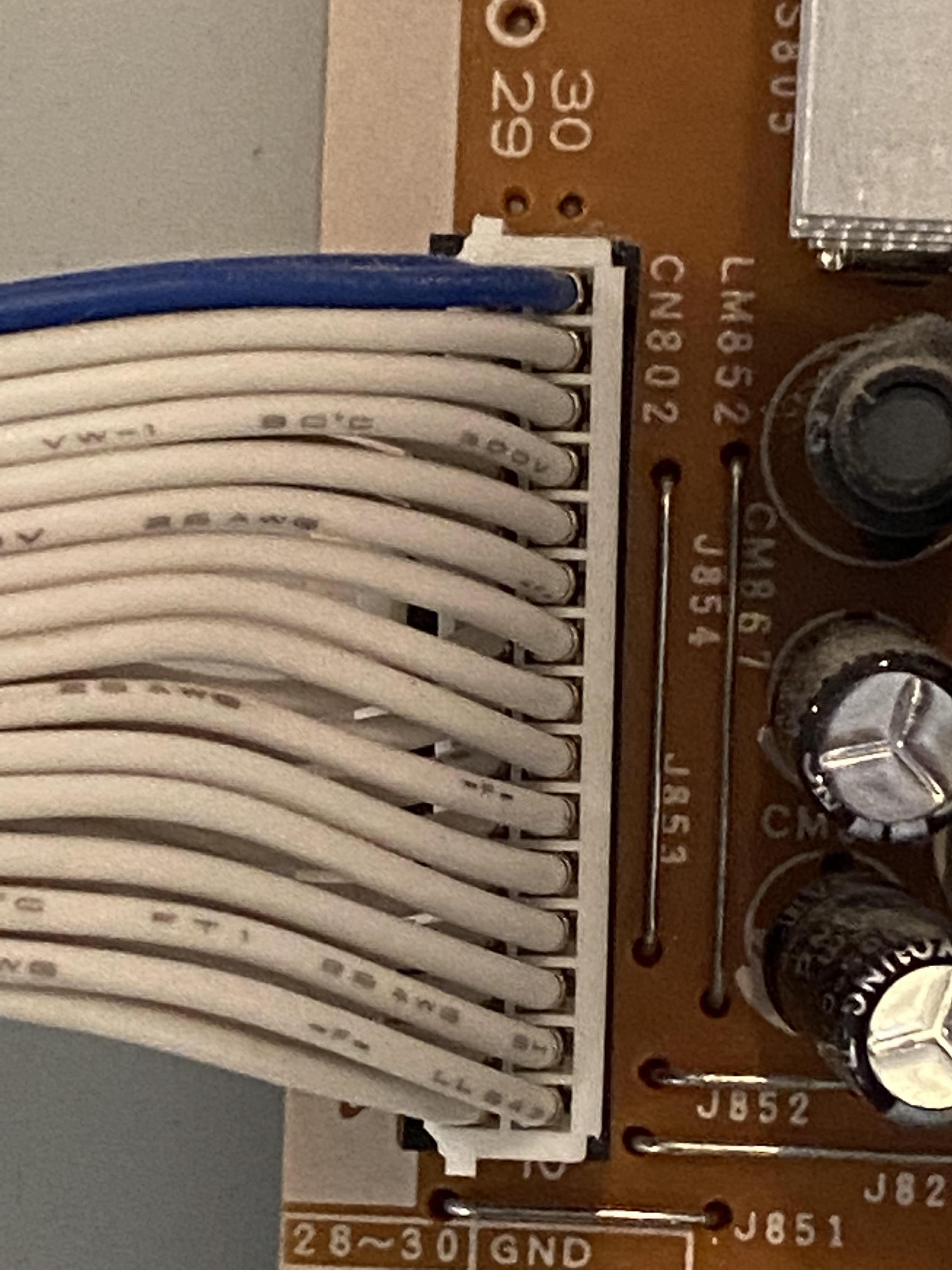

                            • TomLeogrande
                              • Dec 2020
                              • 7
                              #34
                              Re: Samsung LN52B750U1FXZA - Standby Light - No Other Power
                              For more information and for potential clarity for other newbies like myself trying to repair their TV. Here is what I have done... good bad or indifferent.
                              Original Problem.
                              Perfectly working TV one day, the next the power button stops working.
                              TV has power, which is noted by the constant red light near the bottom right of the TV and the flashing bright white light in the middle bottom of the TV when the Power button is pushed.
                              Watched a bunch of online videos and broke into this thing thinking I could do it. I used to build computers for a living in the 90s so I am new but not a complete moron when it comes to circuit boards etc..
                              When I disconnect the main board the backlight comes on and stays on.
                              When I reconnect the main board the original problem comes right back.
                              I ordered a new main board as several online videos pointed out that this is most likely the culprit when the symptoms above come up.
                              Replaced the main board with the new main board and the problem remains.
                              Today
                              1. I see this forum and this information
                              2. Looks like my solution might be here.. and could be along these lines..
                              1. Disconnect the E-PWM wire
                              2. Use the Mute 1 8 2 Power reset menu.
                              As mentioned above here are my current questions
                              Is the pin circled in my attached photos actually Pin #25?
                              Any other steps?
                              Do I need to reattach Pin 25 if it appears to work?
                              Will this work long term?
                              Can someone please tell me which wire is the E-PWM?
                              I believe it is Pin 25 on this connection. I believe the Triangle signifies Pin 1 Does it go 1-15 down the same side then go to the next row and go 16-30. Making the two far end pins 15 & 30?
                              • RDC55
                                • Dec 2017
                                • 180
                                #35
                                That is pin 20 that you have circled - pin 25 is on the outer row. Start from pin 1,3,5,7....or go back from 29, 27, 25.
                                The point of disconnecting E-PWM is to see if the backlights get brighter, if they do as with fuzzyrunner then you confirmed the P/S is working and you may have an issue with the main board. Of course this is assuming when you said you had the exact same problem as fuzzyrunner you were referring to this issue, and not his initial post??
                                Once the P/S was confirmed working as the backlights got brighter with E-PWM disconnected, budm suggested the factory reset using the mute 1 8 2 power. At this point pin 25 wire would be reinstalled as it was removed earlier for test purposes and that process was completed.
