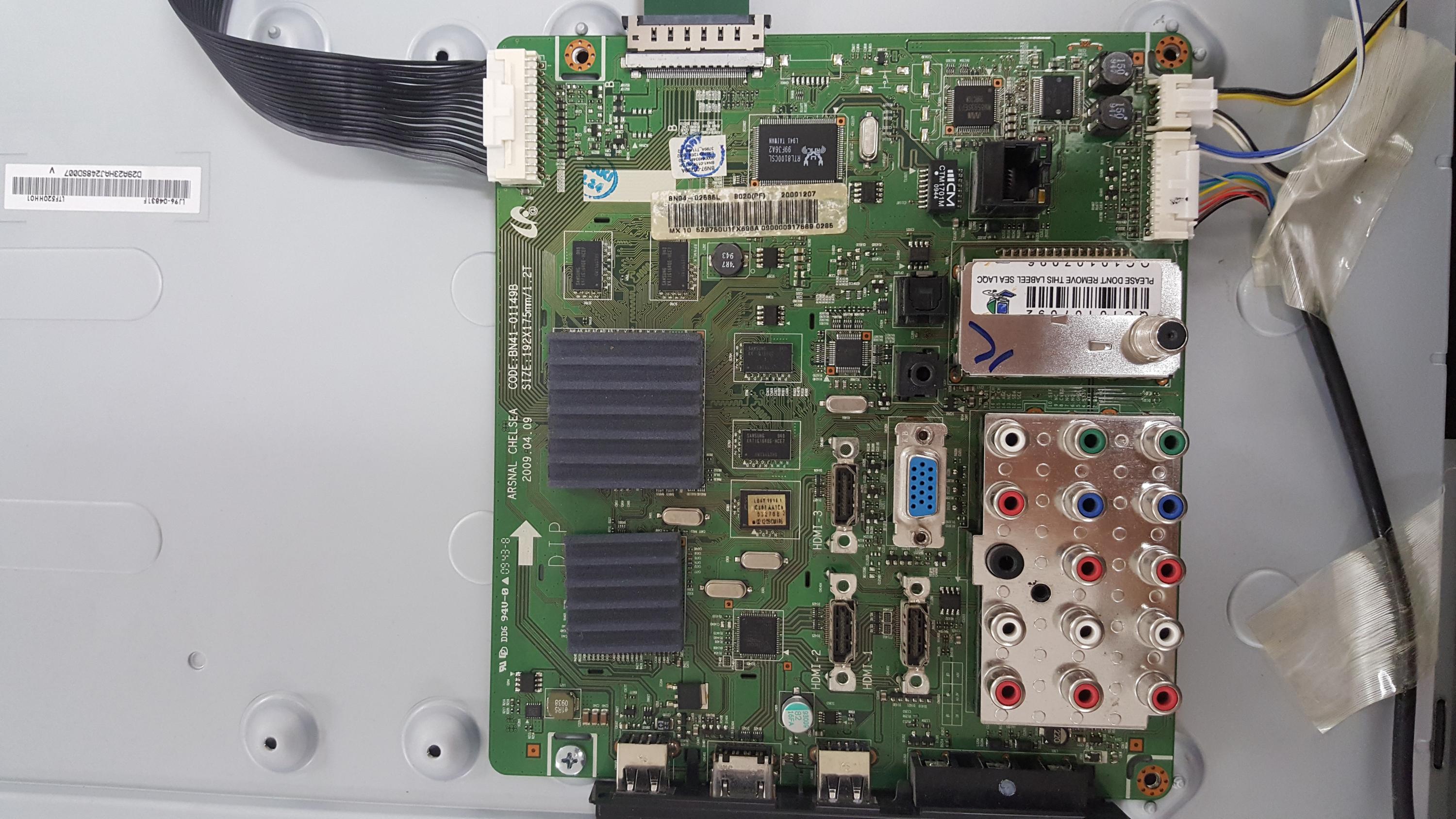

    My mainboard: BN94-02585L (barcoded sticker) or BN41-01149B (printed on the board itself)

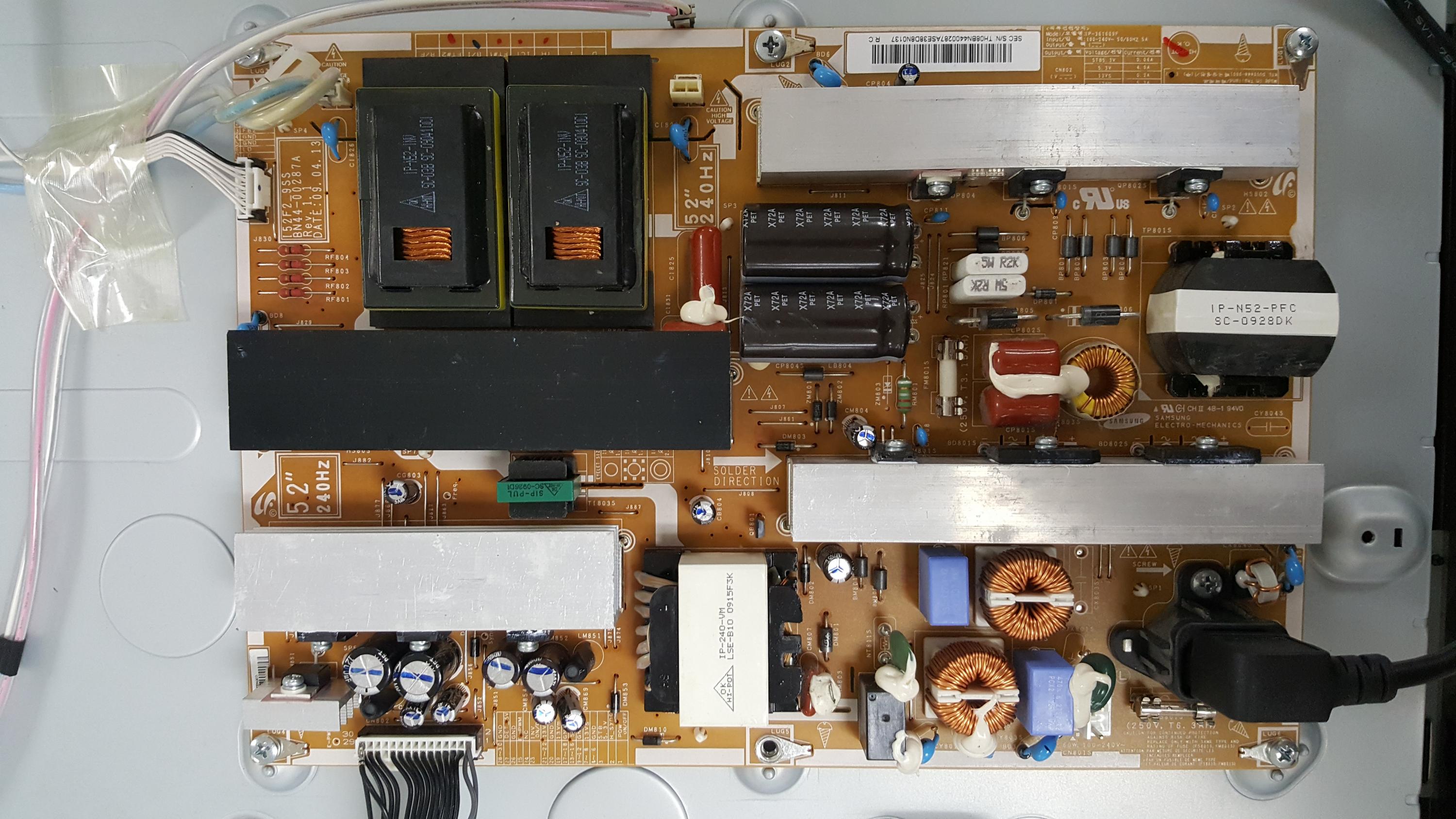

    Power supply board: BN44-00287A

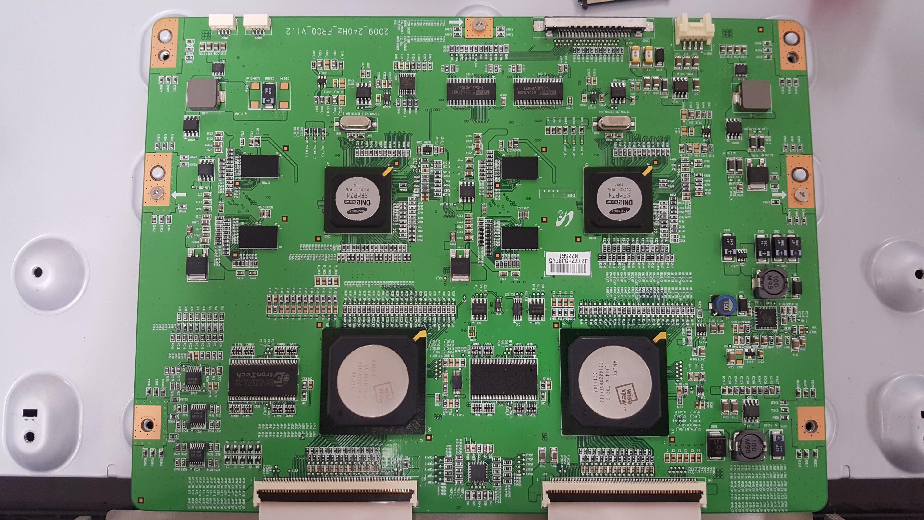

          Try unplugging the tcon with everything else plugged in and see if it does anything.

            Yea I tried that but nothing changed.

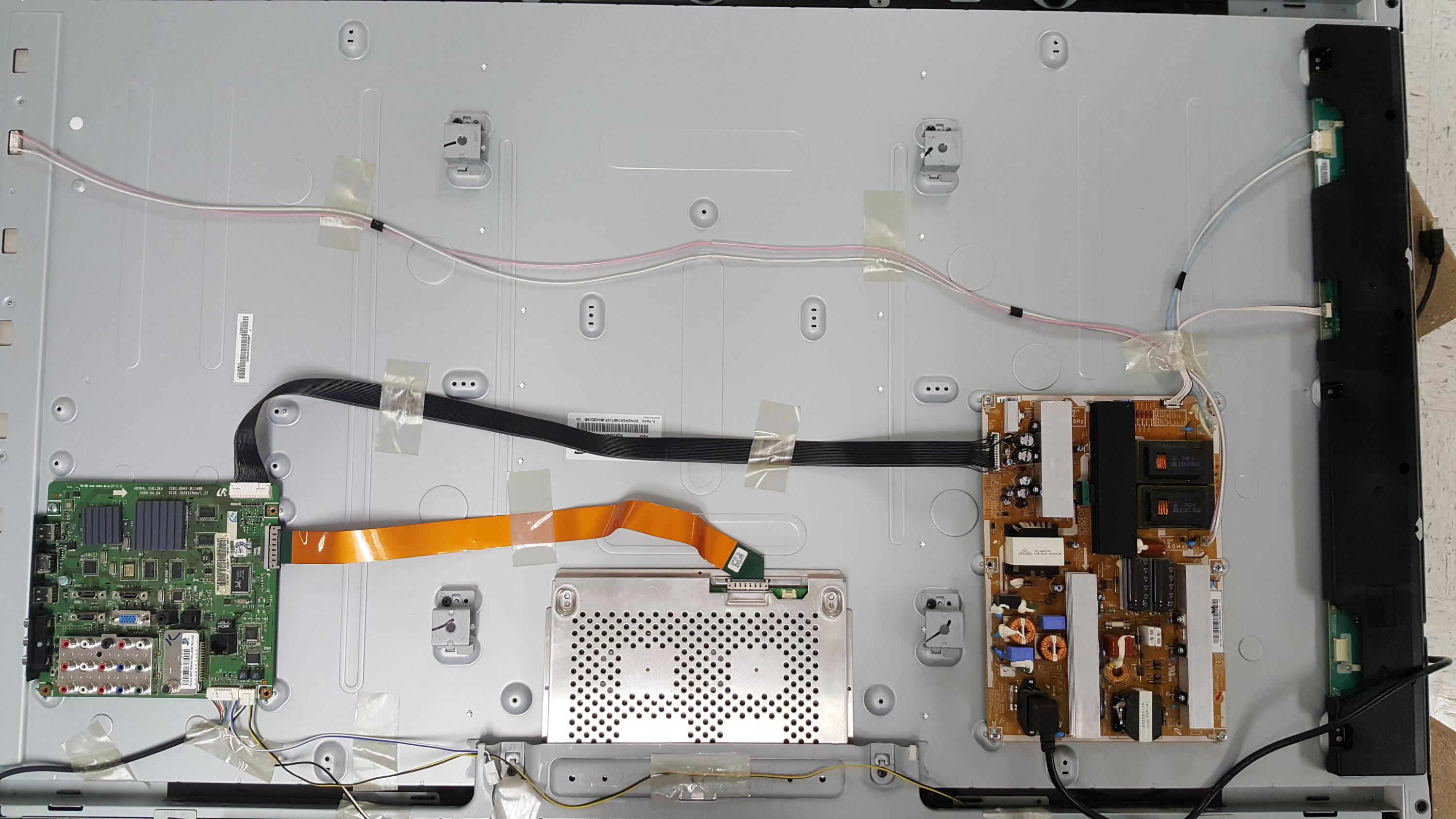

                        Also up load good clear pictures of the whole backside of the TV showing all the boards.

                          Attached the pictures
                            Re: Samsung LN52B750U1FXZA - Standby Light - No Other Power
                            Very good pictures! What did you use for the lights source?
