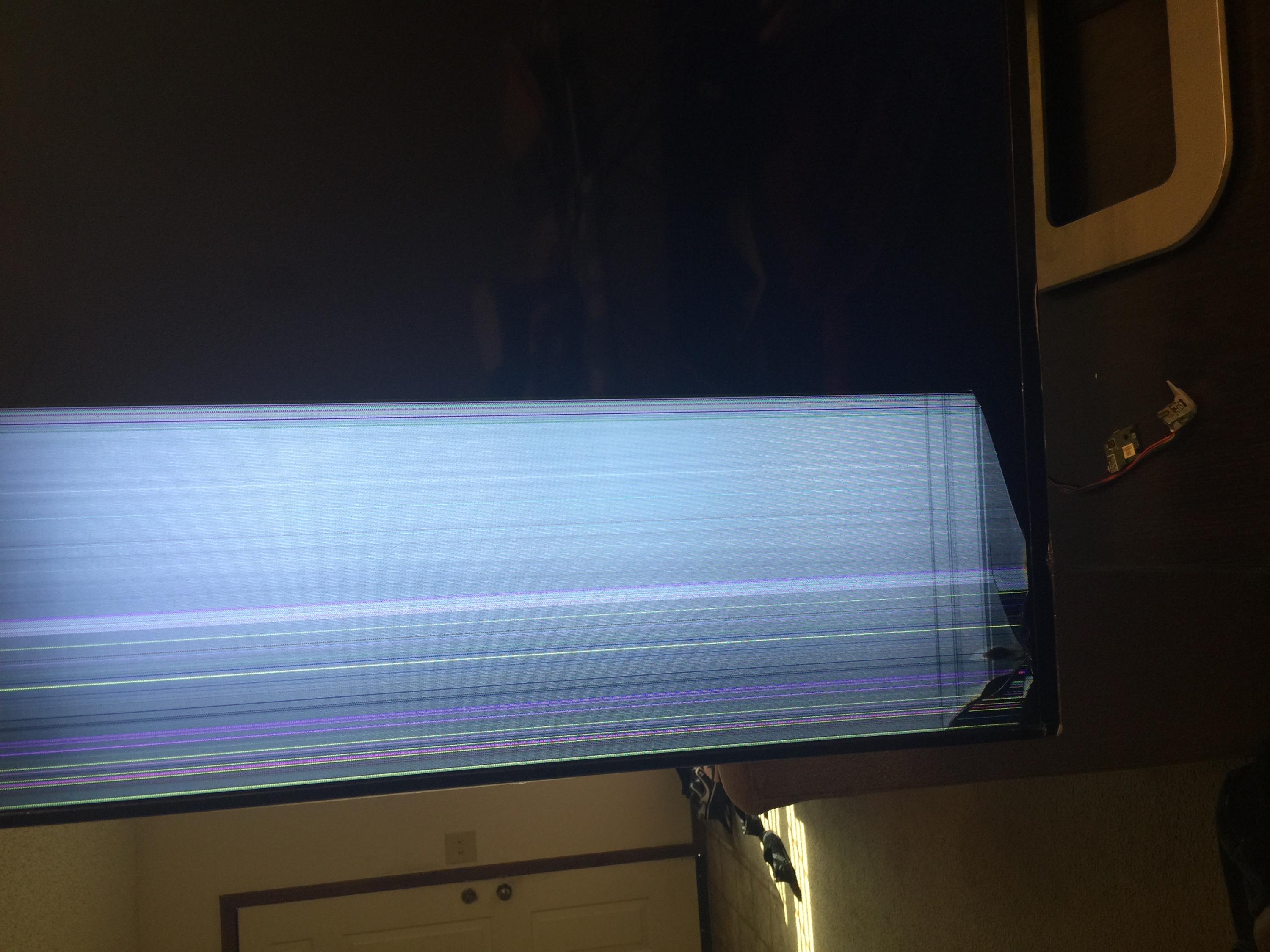

                                        #39
                                        Re: Vizio M492i-B2 Won't Turn On
                                        Update!
                                        The good new is, I ordered a main board and it just came in. I installed the new board and now the TV turns on! Finally!
                                        Bad news....looks like the display is cracked
                                          #40
                                          Oh man! you just cannot win on this one.
