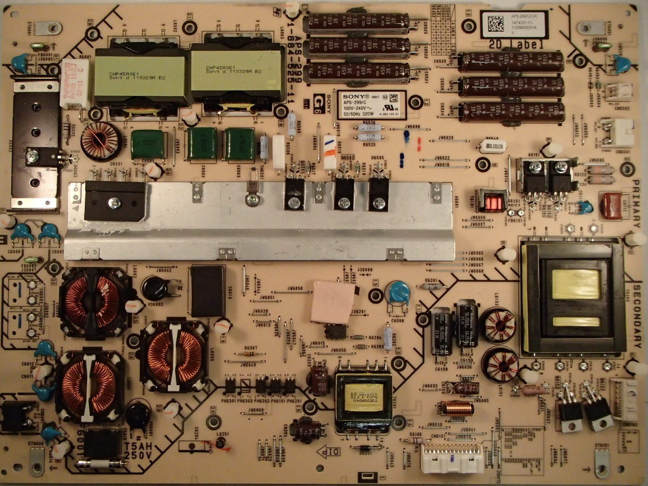

            Re: Sony KDL-60ex720 3 blinks
            Here is the pic of the supply.

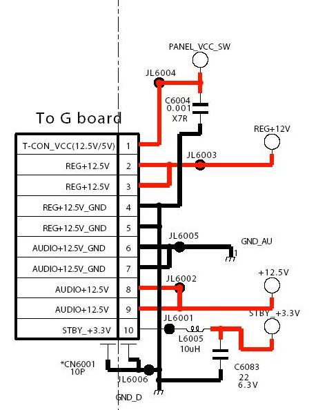

              Originally posted by Diah
              and more better when you listed all V measurements after you power on the TV on this socket at PWB
              My board has a 28 pin connector see attached schematic.
              Has 3.3v and 3.3v at power_on when i press the power button, no 12v on any 12v outputs.
                same manual i have.. LOL
                BATV board
                  i know 3 blinks says its the batv board but why doesn't the 12v come up when the power on input is high on the power supply? i don't want to replace the batv board to find out its the power supply.
                  • Diah
                    • Feb 2013
                    • 6395
                    you still can tested the power board when all sockets disconnected from it and jumper 1KR between standby and power on you will find the 12 volts or not
