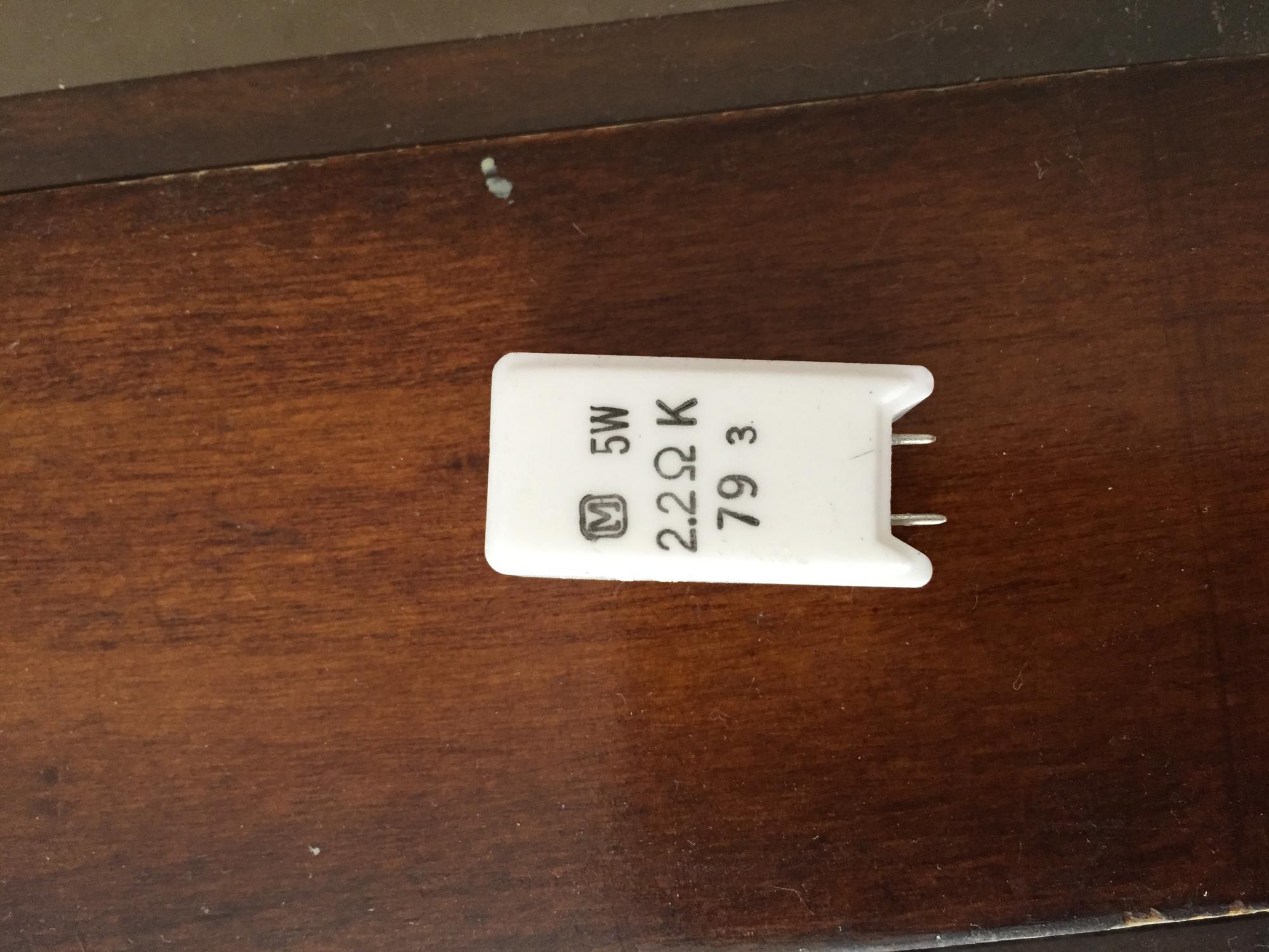

    Identify this component from a tnpa4250
    I accidentally knocked off this component from a shorted tnpa4250.
    Is it a ceramic capacitor?

    Re: Identify this component from a tnpa4250
    no its a 2.2 ohm or 2.2K ohm 5W resistor.
      its a ceramic cement resistor if its tests ok just refit it
        It's a 2.2 ohm 10% 5 watt fusible. If it check ok reuse it
          Thanks. Even if it's good the leads broke right at the board. I don't have enough play to solder it back on. Plus the board has 6 shorted transistors.
          Not sure if I'm going to bother with it.
                  Isn't it better to just keep the boards as they are and buy the defective parts? Trust me , in a few weeks you are going to need this board for a tv and you will regret you used this board for parts.
                  Ps it's basic theory. The small logo is "Ohm" logo which is resistor. 2200 Ohm/5 Watss resistor. They die on a few LG powerboards.
