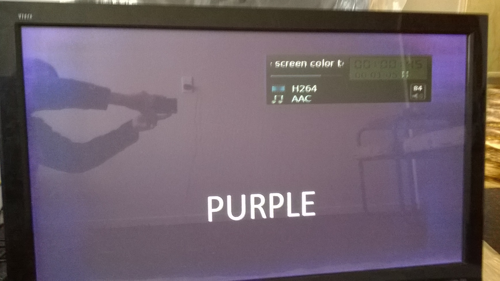

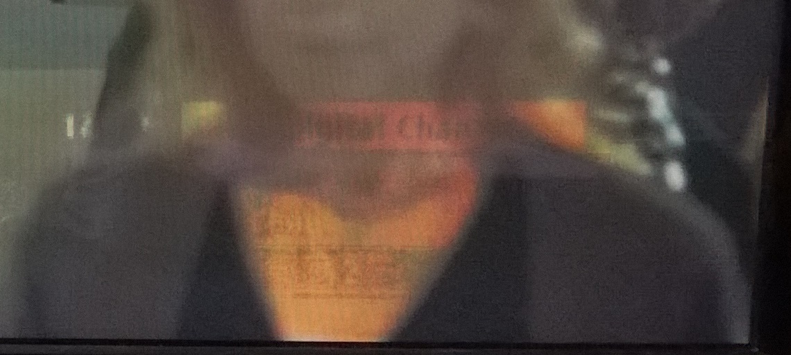

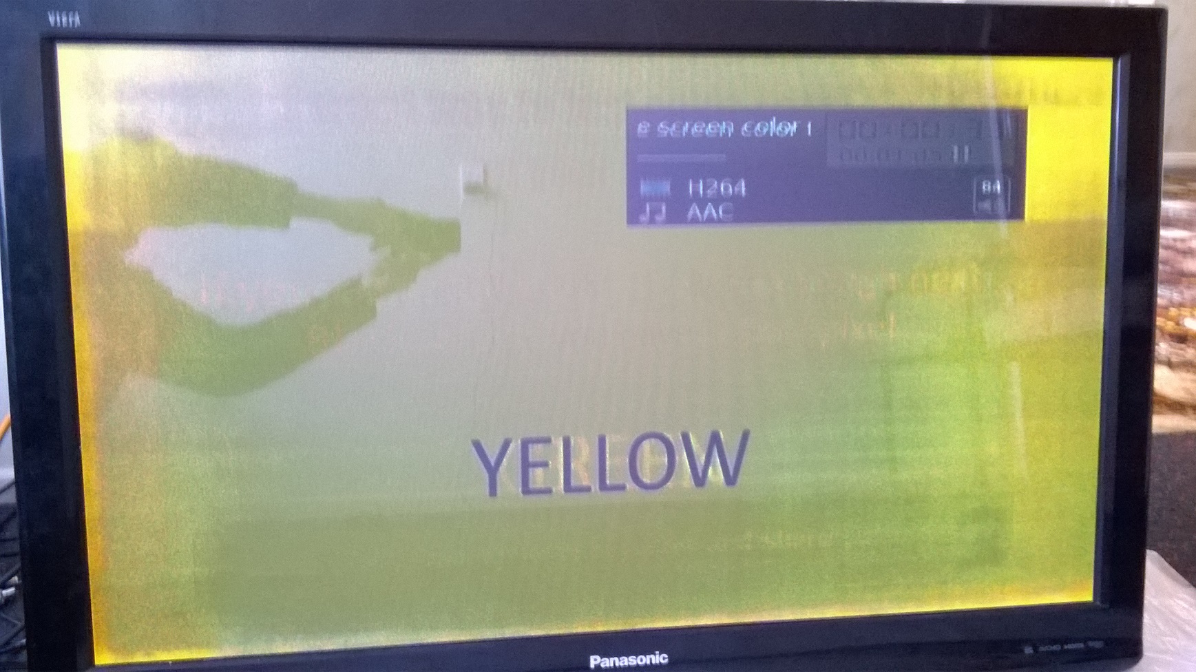

              Hi lambchopsnz & tw2005
              I have this same model Plasma, but with a different fault. Not sure if you are still working on yours lambchopsnz, but am open to taking measurements or sending you a board to help diagnose if this helps. Mine doesn't have a flashing LED code, but does have a display issue. The image doesn't seem to get overwritten/reset completely and previous parts of images show through dependent on the images/colours at the time.
              Hopefully this partial screen shot gives a bit of an idea of the issue.
              Not sure if this would rule it out from trying to help.
              Kind regards
              Russell
              ps I am new to plasmas and also don't have a remote for the TV.

                Hi nzlamont yes I'm still working on this tv I have tried all boards now except the C boards which I'm waiting on now. This is the first plasma I have tried to fix also,tw2005 has been an awesome help he may be able to give you some more advice on your tv problem. I can give you the number of a guy on trademe if you need boards. Awesome guy to deal with he has let me try boards and send them back again when ruled out but I suggest you wait for tw2005 or some of these others advice on weather they think it's a screen problem or board fault...send me an email if you want some test point info or that guys number. Just waiting on my boards and I will keep you updated.
                Cheers Nick

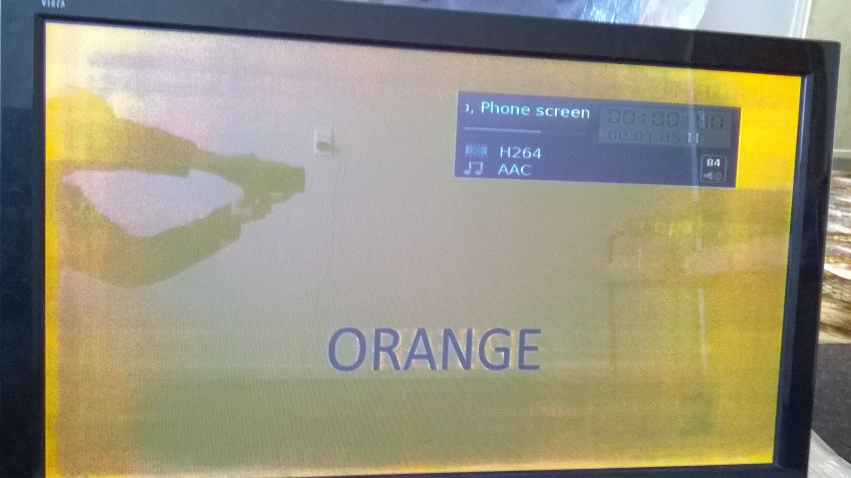

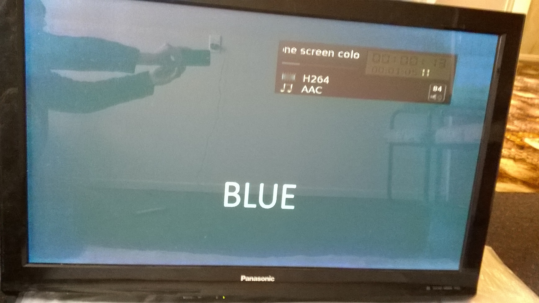

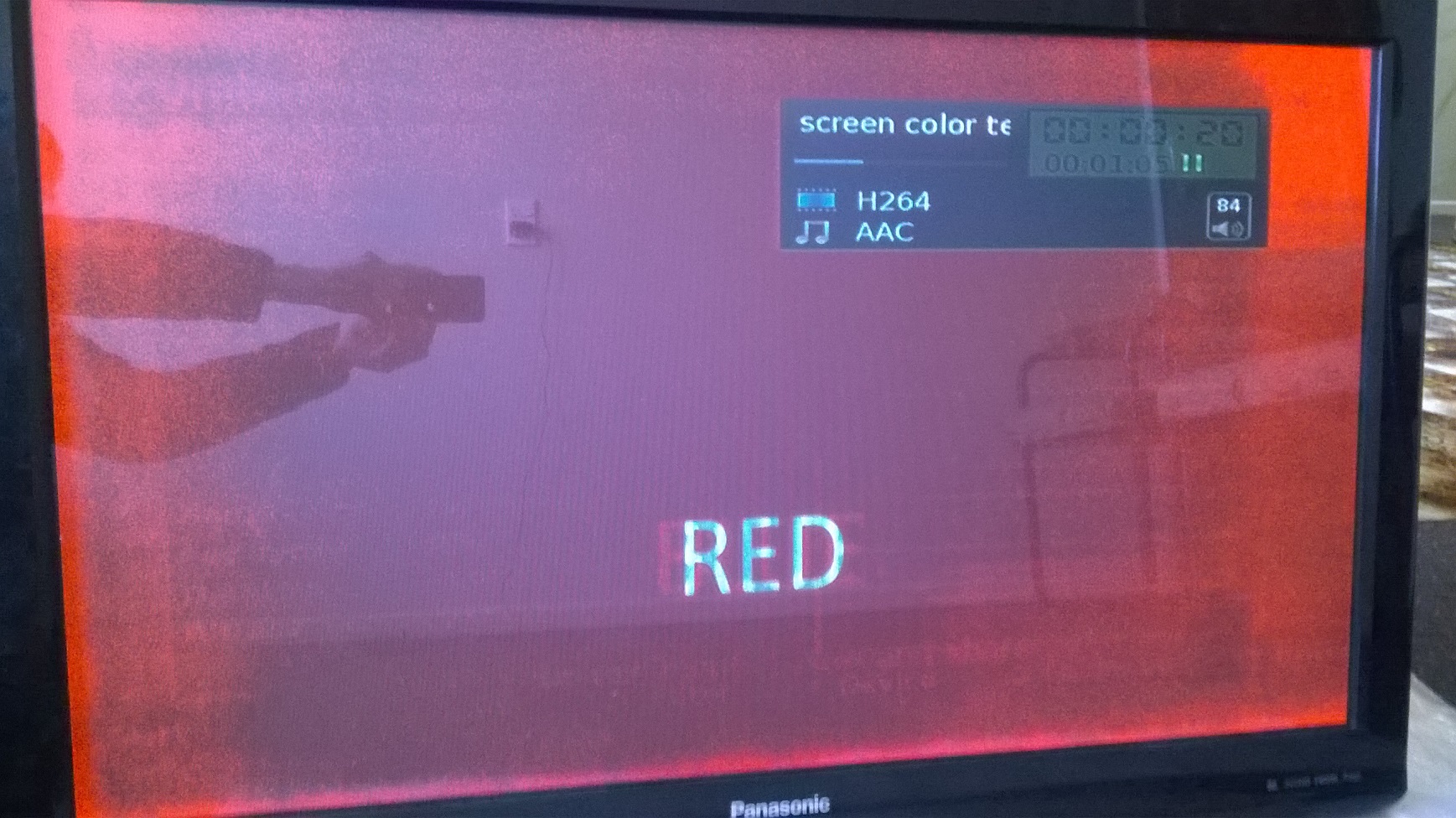

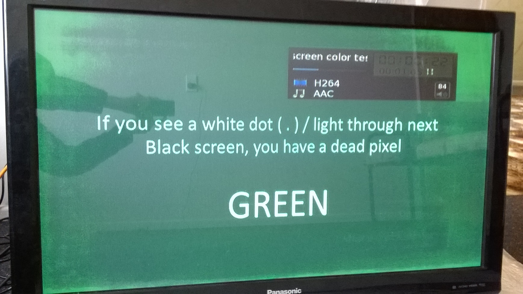

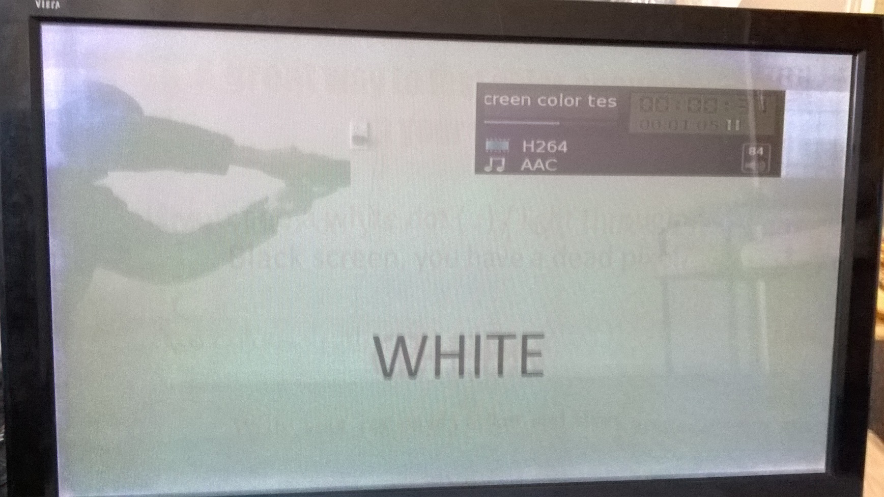

                  Thanks for the info and offer. Is it Platinum-TV on Trademe that you have been dealing with?
                  I've found this thread really useful (thanks tw2005), downloaded the service manual attachments and taken a number of measurements previously recommended.
                  I've used the composite video input to try out various colour screens. Generally the borders seem to have close to correct colouring and the middle incorrect.
                  https://www.badcaps.net/forum/attach...1&d=1473480491
                  Kind regards Russell
                  Premium supporters get full download access and other benefits.

                      I'm thinking SS board

                        • nzlamont
                          • Sep 2016
                          • 6
                          • New Zealand
                          #52
                          Re: Panasonic th-p42x10z
                          Thanks for both your inputs.
                          Just in case it has some further relevance, the panel Vsus is labeled at 187V & Ve 125V. I measure 188v for Vsus but when the sound and picture kick in it drops to 169V. I don't have a scope to see what the waveform is like. The others (Ve, Vset, Vad, Vscn) don't change significantly, but Vda drops from 60.2V to 56.2V. These were measured with a Freeview HD signal running, rather than white screen.
                          Am happy to get the SS board and give it a try it is TNPA4774AE and also there looks to be a small board SS2 Sustain out (Lower).
                          Kind regards
                          Russell

                              I'd be surprised if there is anything on ss2 board. You'd think if Vsus dropped 20v the tv would trigger a sos. Is it a good meter?
