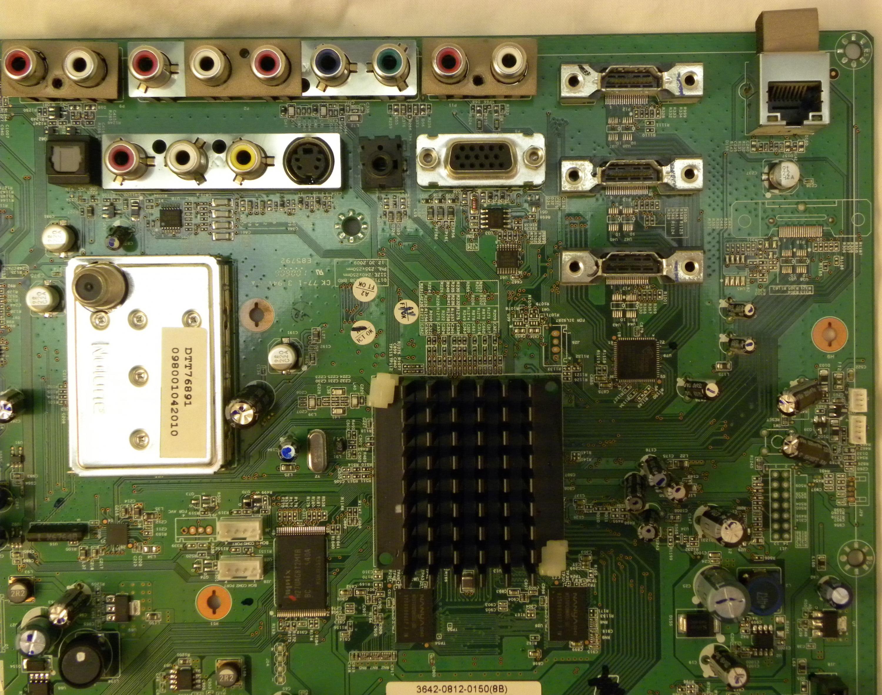

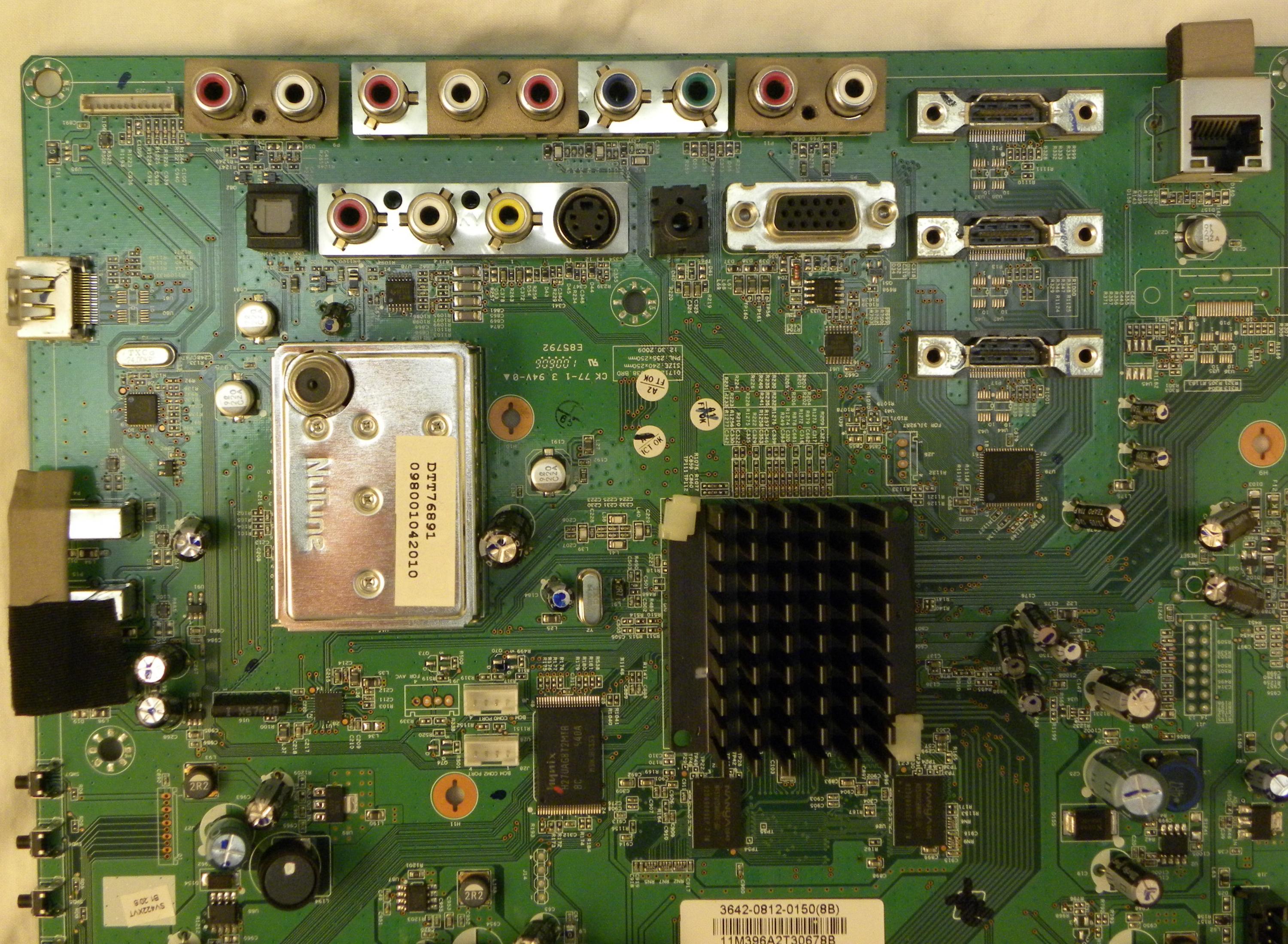

    My problem started about 1 1/2 months ago, the tv failed to come on, had the orange standby light but when the power button on the remote was pressed the Vizio standby orange changed to white and blinked orange/white 24 times and then changed to steady orange. I checked fuses, looked for the obvious.... bad caps, burn marks, exploded components, bad solder joints and found nothing on the power board. Checked for voltage at connector CN201 which goes to the main board and found 5vdc only. No PS-ON, no 12V, no 18V, No BKLT-ON. I concluded the problem might be on the Main Board since 5V was reaching the Main. I tested all the fuses and found they were good, check all the caps for ESR and all were good, checked 4 voltage regulators and found U7 to be questionable,
    U7
    L362
    G1117
    Pin 1 (adj) = 1.259
    Pin 2 (out) = 2.506
    Pin 3 (in) = 5.128
    I changed the regulator with a used one from a scrap PC board I had laying around. The replacement regulator is identified only as LD1117 and after installation I got the following readings,
    U7
    LD1117
    Pin 1 (adj) = 2.24
    Pin 2 (out) = 4.17
    Pin 3 (in) = 5.09
    The tv lit up and I got the V logo and the menu on the screen. Woo Hoo! I hooked up a coaxial antennae cable and got a beautiful HD picture and sound. Did the happy dance! I leaped to the conclusion the problem was solved especially since Vizio has a reputation for bad LDO Voltage Regulators, buttoned it up and put it back on the stand.
    It has been 5 weeks working perfect, and then I tried to turn it on and got the original problem back. No image, no sound and blinking orange/white standby on the front of the tv. Heart break !
    Drop back 10 yards and punt, I thought maybe the "used" LDO failed but it is getting almost exactly the same readings as immediately after install. So...now what? I retested 4 Voltage Regulators, 4 fuses, all the diodes and continuity between the power board connector and the main board connector, tested all the resistors associated with the regulators,

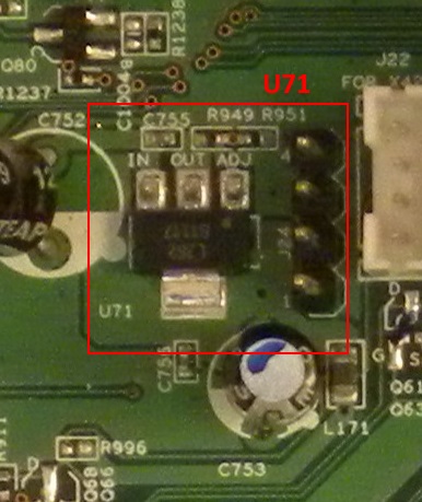

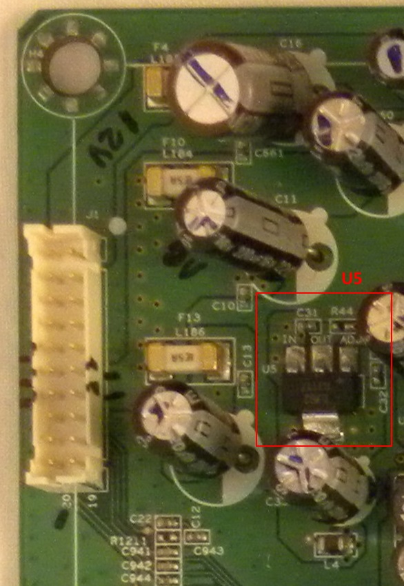

    U5 U7 U71 U89
    L362 LD1117 L362 L362
    G1117 G1117 G1117
    Pin 1 = 2.095 Pin 1 = 2.258 Pin 1 = 0.001 Pin 1 = 0.001
    Pin 2 = 3.337 Pin 2 = 4.198 Pin 2 = 0.001 Pin 2 = 0.001
    Pin 3 = 5.121 Pin 3 = 5.127 Pin 3 = 0.109 Pin 3 = 0.01
    Fuses F4, F6, F10 and F13 all read 0.2 ohms.
    I did not remove the diodes as they are all SMD but none of them read shorted.
    I did not remove the resistors either for the same reason and they are really really tiny but none were open or shorted even though the readings were widely different between regulators.
    Sorry for the long winded explanation but it seemed necessary.
    Thanks so much for any assistance you may be willing to offer.
    Help?

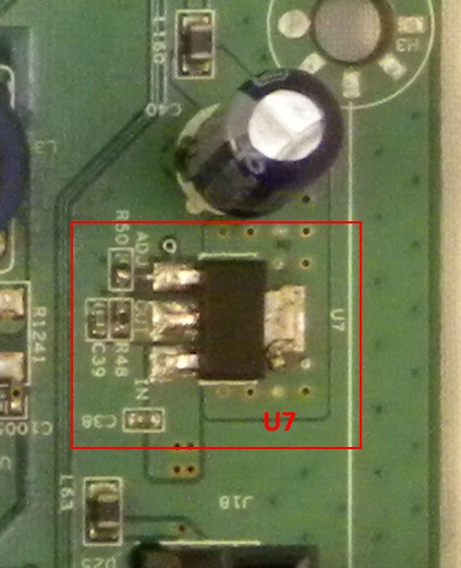

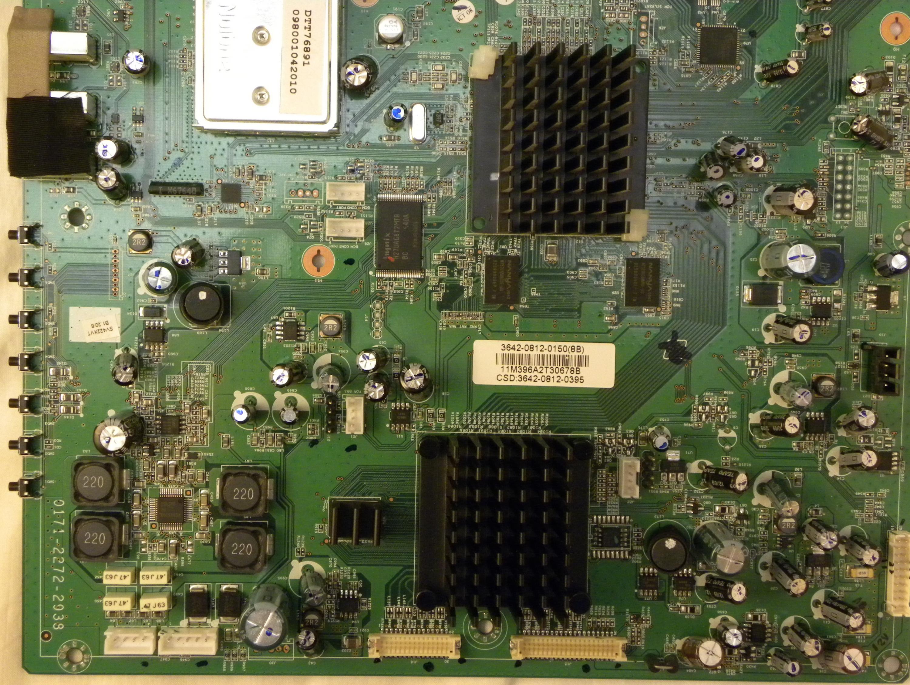

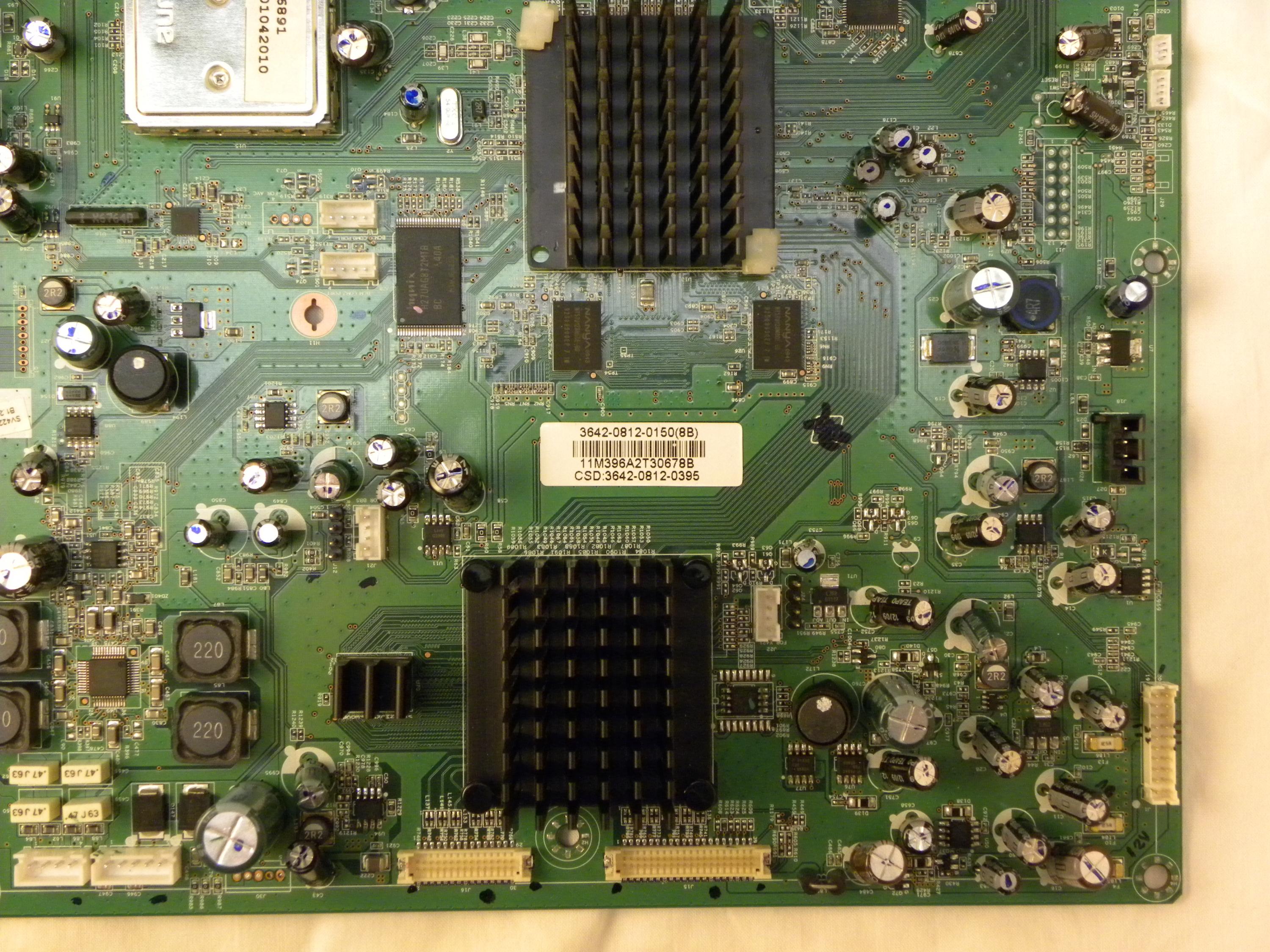

          OK, it appears the resistor network is intact as well as the 2 capacitors....
          using a Fluke 115 meter set on ohms and an ESR meter I got the following reading,
          Pin 2 to R48 =.01 ohms
          Pin 1 to R48 = .01 ohms
          Pin 1 to R50 = .01 ohms
          R50 to GND = .01 ohms
          R50 to R48 = .01 ohms
          R48 = 94.8 ohms
          R50 = 110 ohms
          C38 ESR = .19 ohms and is connected pin 3 to GND
          C39 ESR = .09 ohms and is connected pin 2 to GND
          Pin 1 to GND = 110 ohms
          Pin 2 to GND = 204.7 ohms
          If the original VR was good and the tv did not work why did the tv start working when I put a bad VR in?
          I added a close up photo of U7 for reference
            Re: Vizio SV422XVT - Standby light, no image, no sound.
            So what was the Voltage reading of U7 (LD1117) when the TV failed the second time? 4.17V at the output?
            May be something got disturbed in that area and it starts working, I just hope that nothing got damaged running at 4.17V instead of 2.5V.
              Based on the value of R48 (FBr, 94 Ohms) and R50 (ADJr, 110 Ohms) measured in the circuit, the Vout should be around 2.7V.

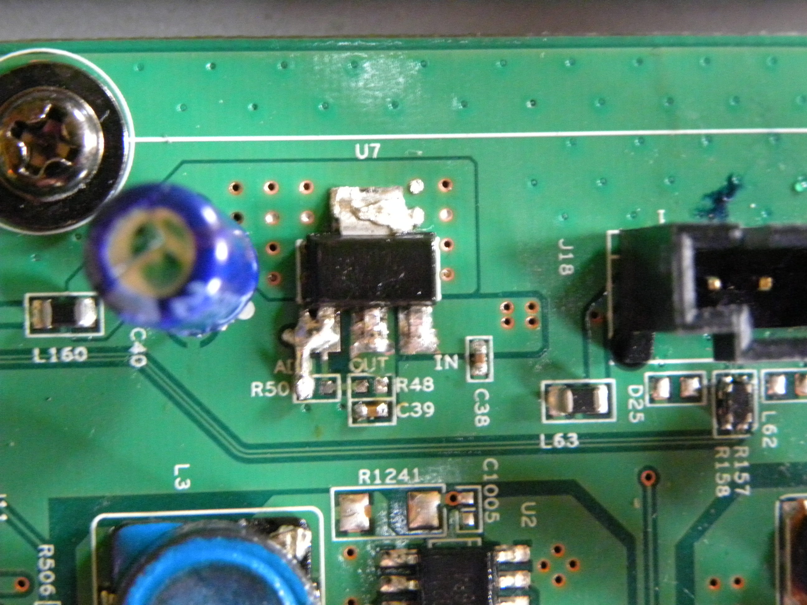

                        Alrighty then, that worked, now I have Vo=2.5v @ U7. Actual measurements are:
                        U7
                        LD1117
                        25A
                        Pin 1 (gnd) = .004
                        Pin 2 (out) = 2.505
                        Pin 3 (in) = 5.115
                        I have included a photo of U7, I removed SMD R48 and R50, I soldered a jumper from Pin 1 to GND.
                        That solved the overvoltage at U7 Pin 2 but now I still have the original problem. The Vizio ON/STBY light blinks orange/white pauses on orange and blinks again. No screen image, no backlight, no sound.

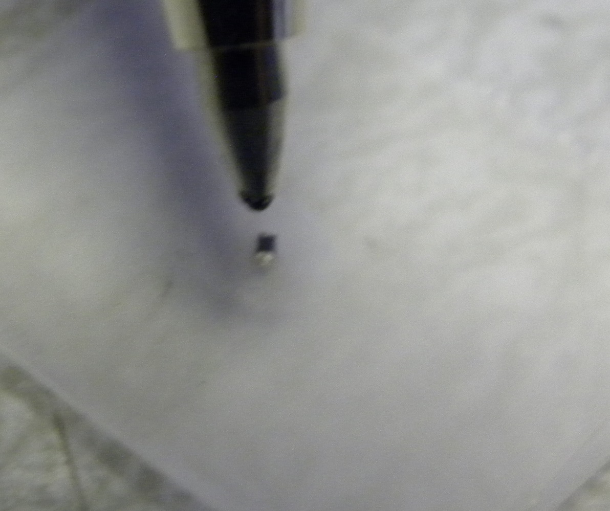

                              The 2 smd resistors are very tiny and either due to my lack of experience or the equipment I have, both resistors were lost immediately after removal. I think they in a ball of solder in my carpet.
                                Try heating the main board with hair dryer, disconnect other boards (such as WIFI, IR board) that are connected to the main board except the power supply board and see what happen.
                                http://www.shopjimmy.com/catalogsear...Vizio+SV422XVT
                                • What?
                                  • Aug 2010
                                  • 82
                                  Holy Cow, I just found one of the resistors while I was cleaning up my work station. Actual reading is 110 ohms, that must be R50, but I have no way of knowing, sorry.
