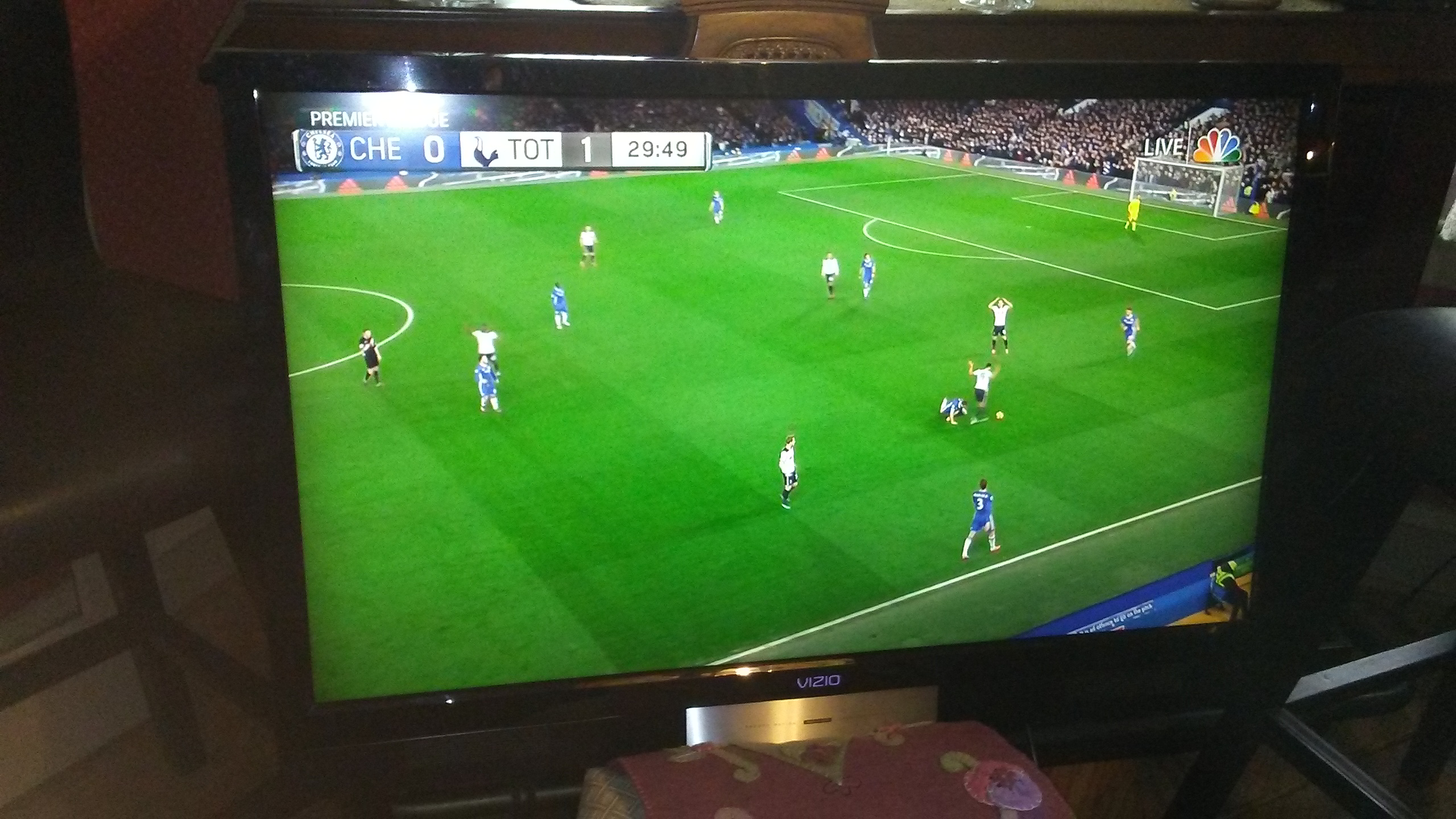

        UPDATE:
        Happy day! I got a used main board #3642-0812-0150 on Ebay for $87 including shipping.
        Installed, it came on, cleared all data via the menu, did a channel scan and voila', it works great!! Again, thanks a bunch for all who helped and offered support. BADCAPS.NET is awesome!
