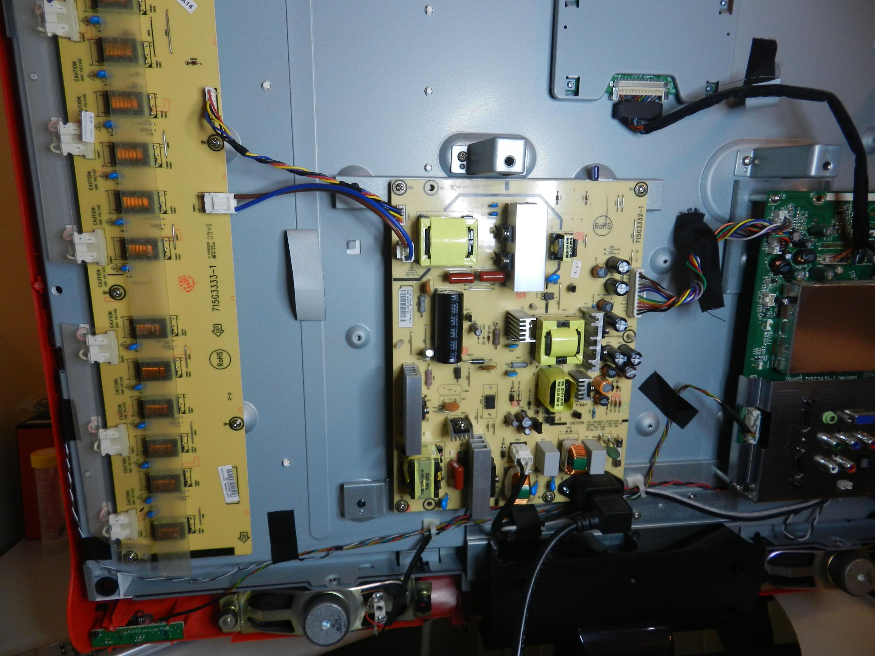

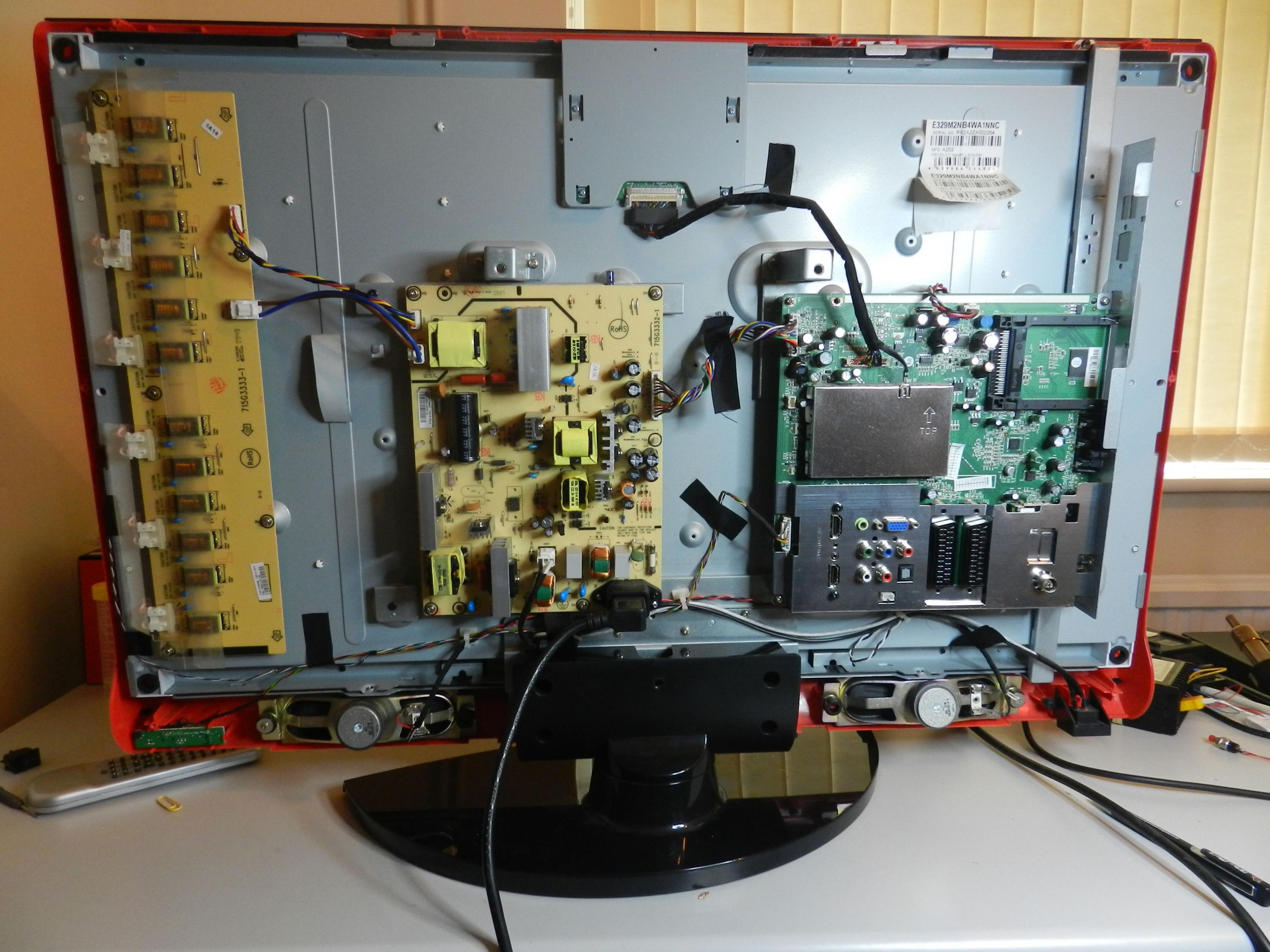

    Set is an AOC L32WA91. The service manual for the L32W961 power supply appears to be identical.
    The set appears to be working, volume up / down but the backlights are not working.
    There is not even a quick flicker from the lamps when the set it taken out of standby.
    Removing the cables from PSU to the main board and switching on and the backlights still fail to come on or flicker.
    Using a CCFL tester the tubes have been tested and they all light up.

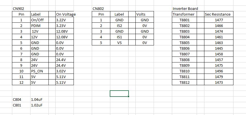

    The inverter transformers have been checked and readings given below.

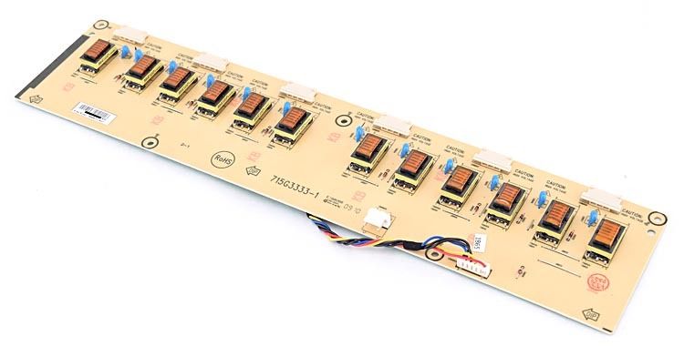

    For the transformers on the inverter board the minimum secondary resistance is 1445 ohms and the maximum 1496 which may be slightly above the recommended tolerance.
    The driver chip is OZ9976 and shorting the timer input Pin 11 did not result in any change. The two mosfet drivers checked out OK out of circuit.
    Power supply: 715G3332-1
    Inverter: 715G3333-1
    I'm suspecting the OZ9976 IC but any hints gratefully received

    Are you getting boosted Pfc voltage across the cap matey ? Also whats the input voltage to the driver fets ?

      Re: AOC L32WA91 - No Backlights
      Hello Reeceyburger123
      I'm getting 394V across the cap (C920) out of standby.
      At R801 (fusable resistor) feeding the mosfets the voltage is 390V DC with respect to the negative leg of C920.

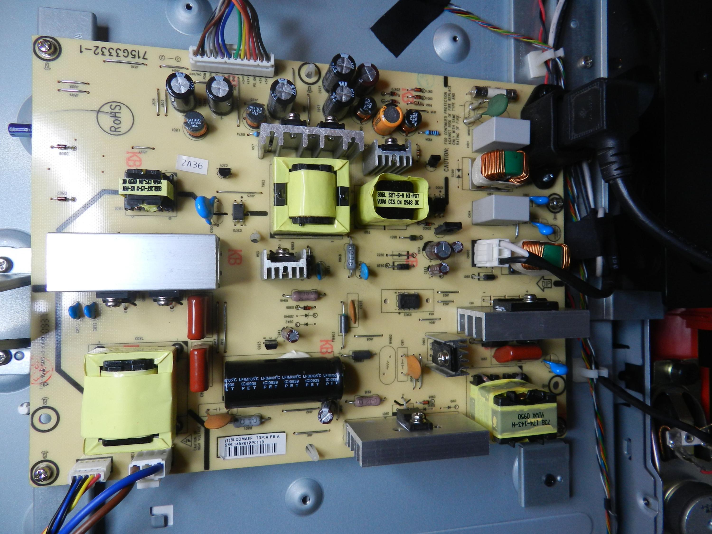

            There are many version of this 715g3332-1.
            Which one of these has the matching barcode #?
            http://www.shopjimmy.com/catalogsear.../?q=715G3332-1
            Hopefully you can get to the site, otherwise please provide what is printed on the barcode.
              Hello BudM
              It looks very similar if not identical to this one.
              AOC ADTV8LCCMACF Power Supply for L32W961
              The partial barcode on my board is (T)8LCCMAEF
                Please look at the bottom side of the board, there are many pins that has 'RESOLDER' right next to the pins.
                http://assets.shopjimmy.com/media/ca...f-bottom_1.jpg
                This board is the power supply-inverter combo, the output ACV is about a couple hundres Volt and is fed to the step up transformer on the sub-inverter board to step the Voltage to thousands of Volts to drive the lamps.
                  So you have the service manual with the diagram for the power supply/inverter combo board?

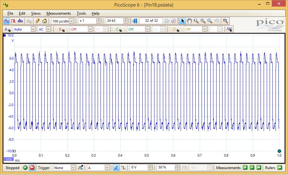

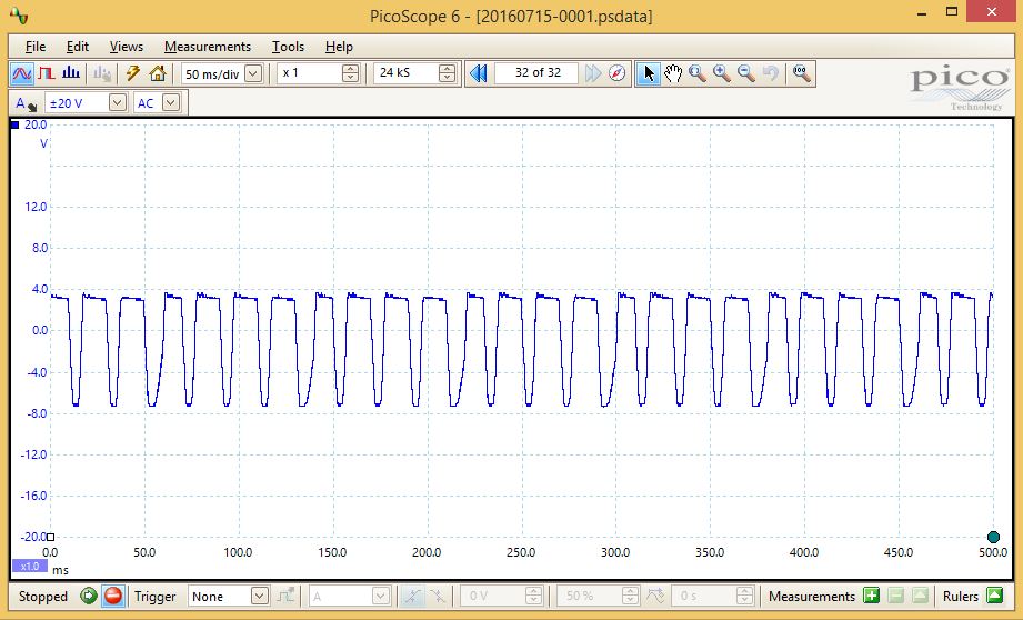

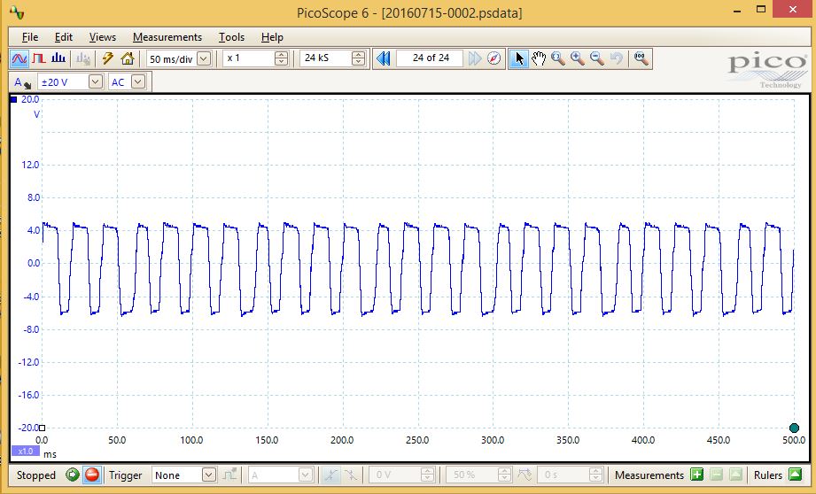

                            Here are the waveforms at the primary pins of T801
                            The scope signal is recorded 1/20th of its value so approximately 240V amplitude at 20ms
                            Edit
                            Thinking about it the results don't make sense. The OZ9976 is only driven by 12V so I cannot see how it could drive the primary at those voltages. Need to repaet test and repost results.
                            • dick_barton
                              • Aug 2015
                              • 6642
                              • Wales

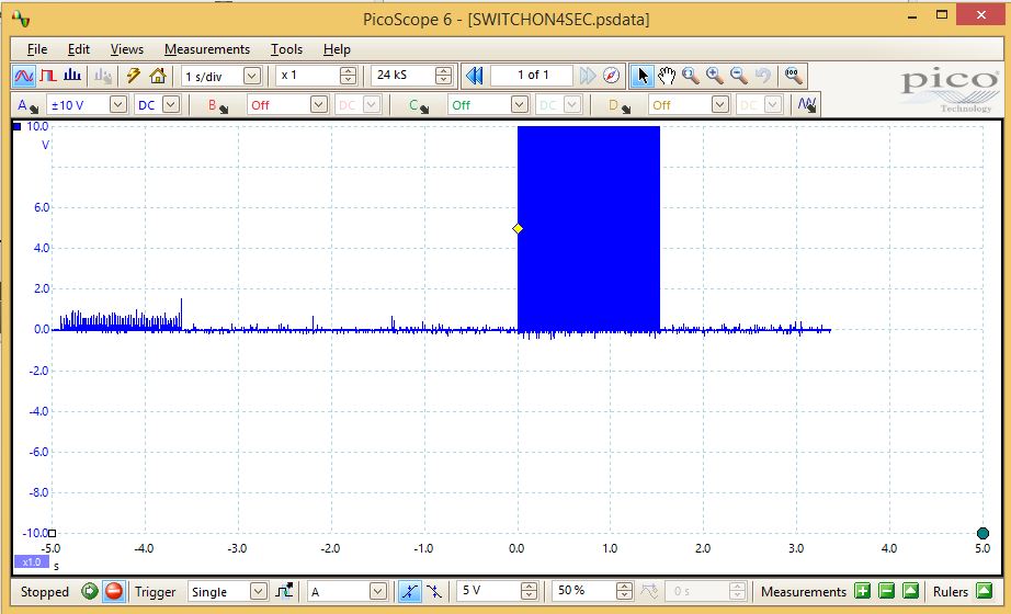

                              I above measurement were incorrect and explains why they did not make sense.
                              Measuring the signal on T801 (secondary of transformer driving the mosfets), at switch on the drive signal remains low and after approximately 4-5 seconds the signal appears 13.99v peak to peak at 44.73Khz for 1.5 seconds and then falls back to 0V.
                              There is no flicker on the lamps during this time.
