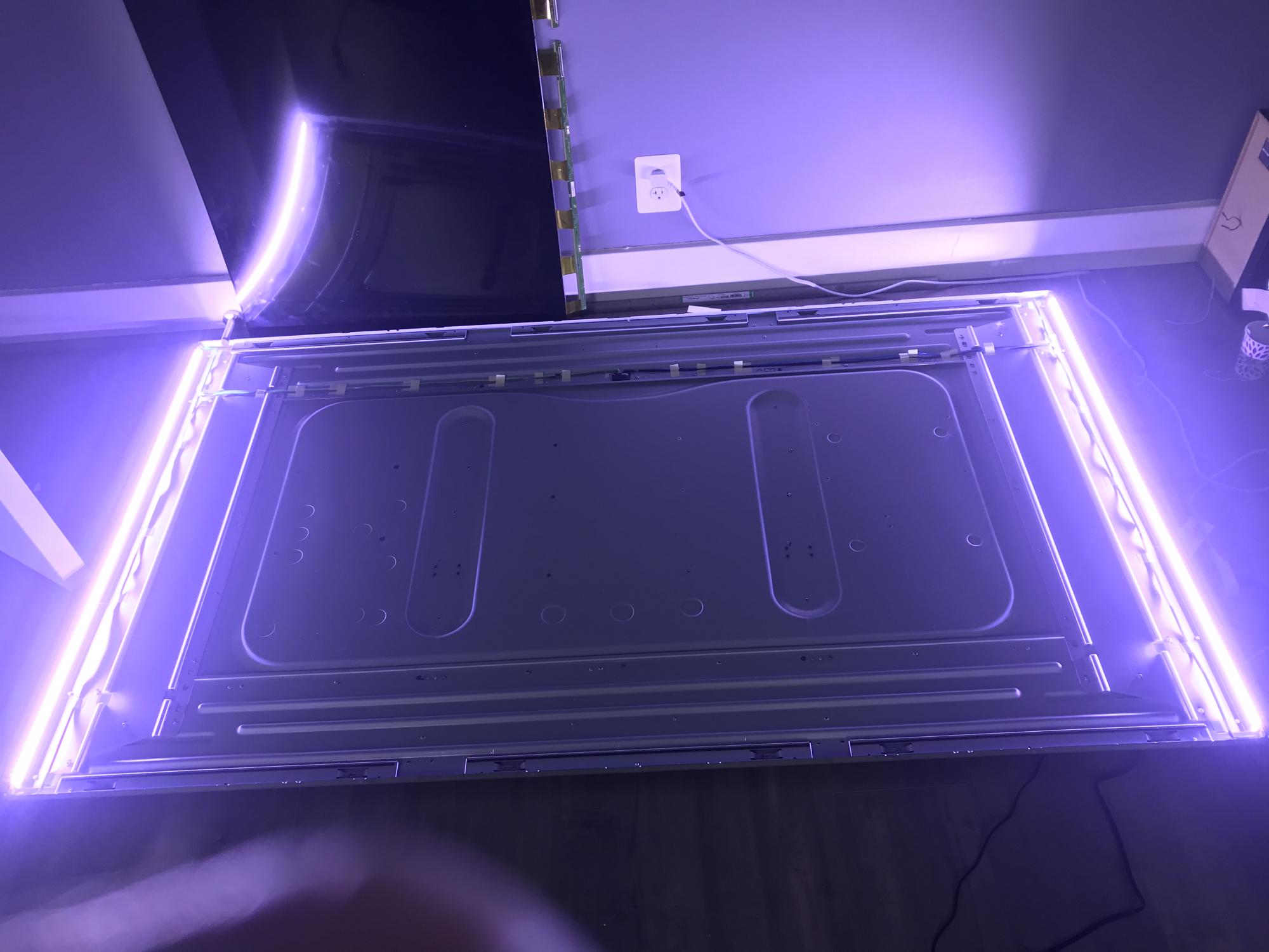

    the backlights flicker when watching tv. Everything else works as it should. Also it's not the picture that's flickering just the leds.
    I tested the leds and all light up and measure 77.5v volts. I took the tv apart to double check leds and they all work and light up perfectly.

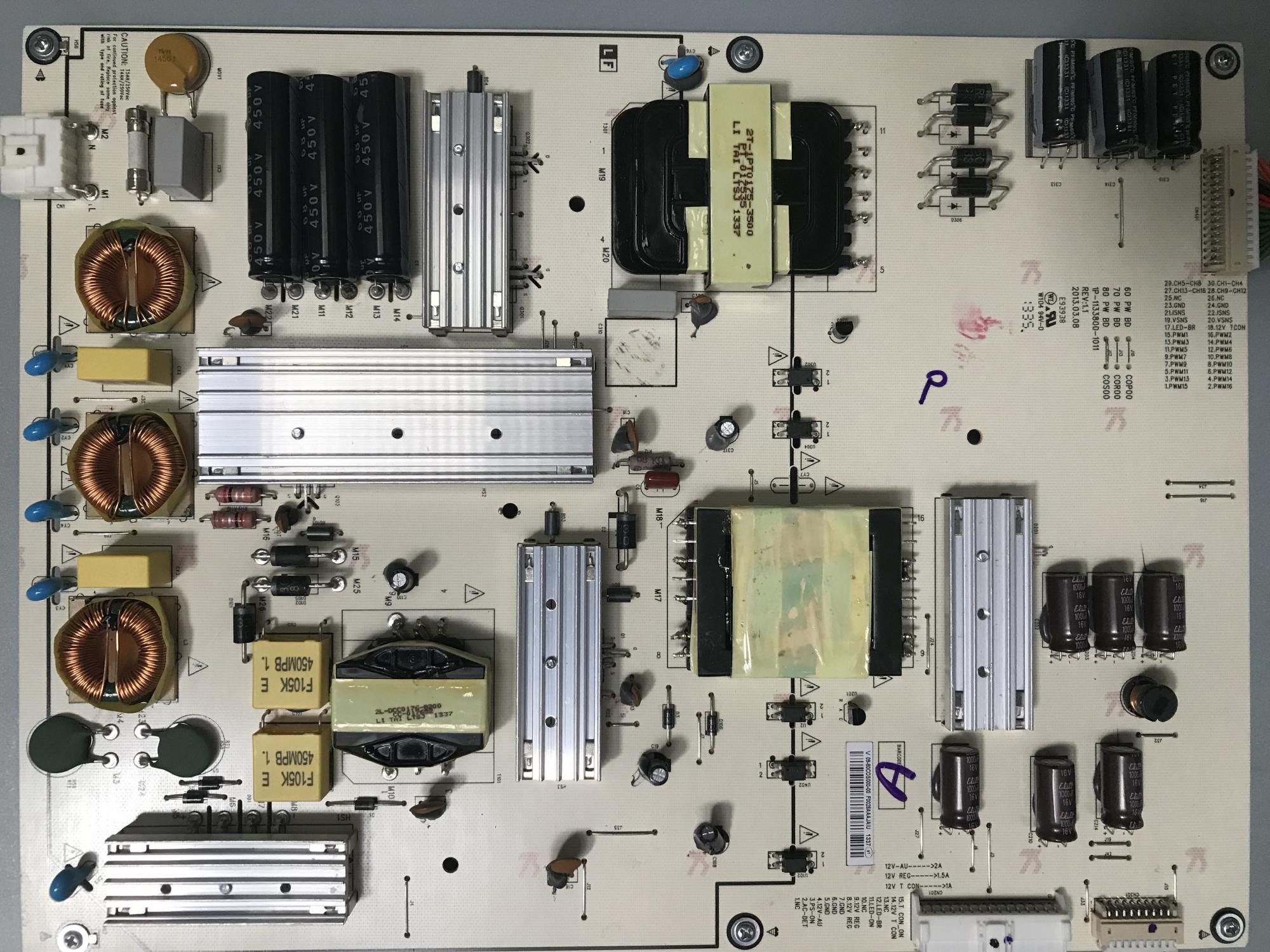

    I believe it's the power board causing the issue however I cannot find a replacement board so I'm stuck to finding the bad component. The power board has a sizzling sound coming from the backlight transformer. I replaced that and problem persist. Also replaced the film capacitor next to it and that seemed to help with the sizzling noise but not completely and still flickers a little bit.

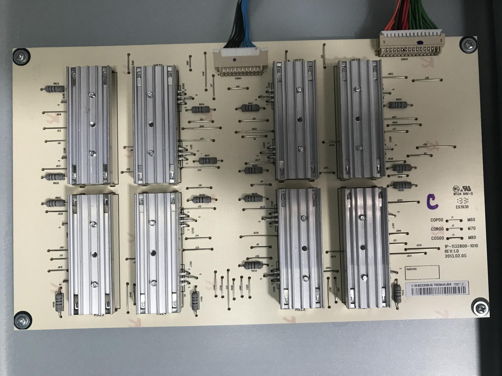

    All voltages on the led driver board are steady and do not fluctuate.

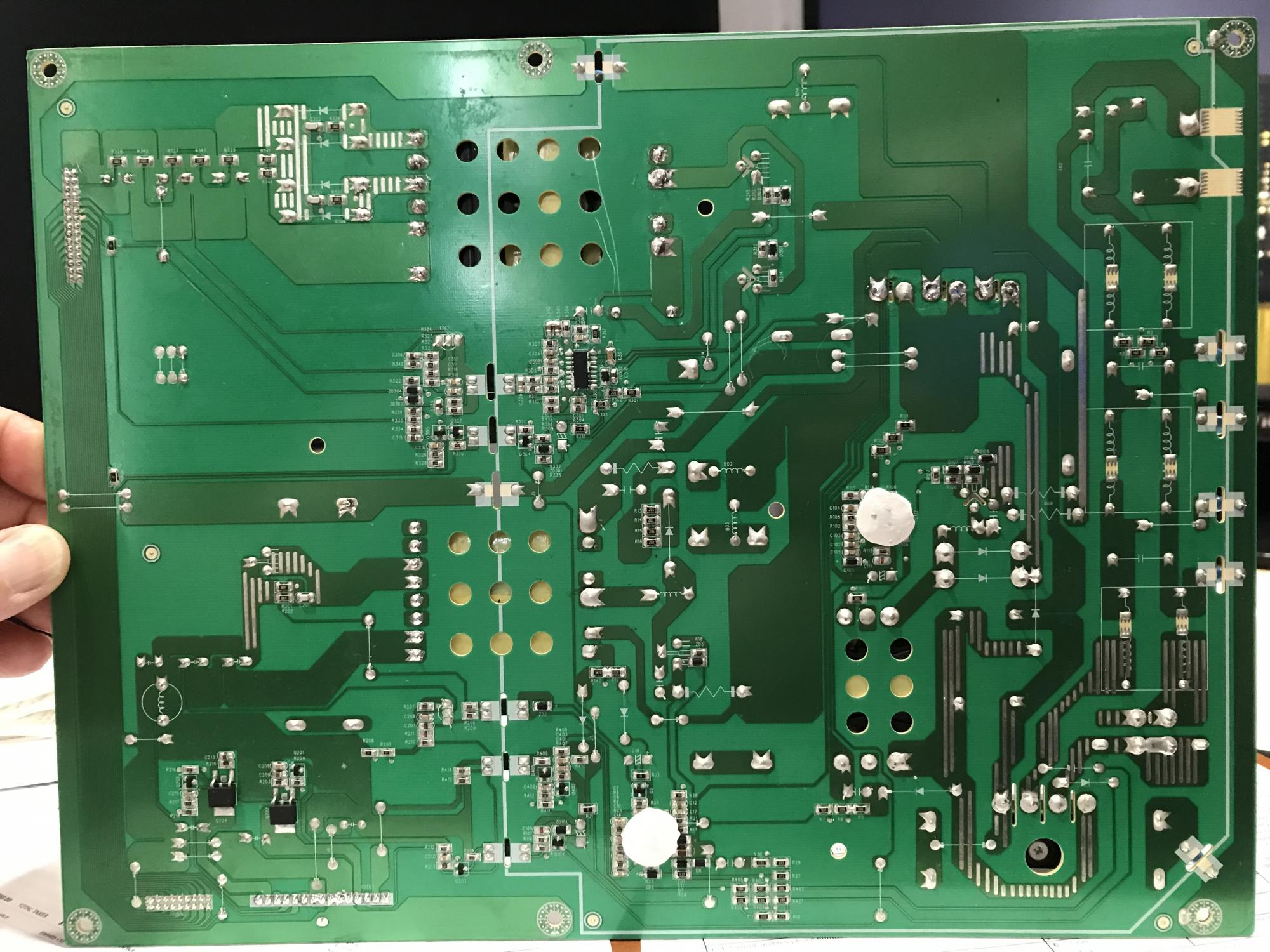

    Quick update. It's definitely the power board causing the problem.
    When I lift the board the flicker gets worse and if I set it back down its not as bad. I'm not sure what's short but I have tried re-soldering some of the main areas but still the flickering occurs. The whole board looks like it's cold soldered from the factory. I will definitely re solder some more areas,
    But here is a picture of the back of the board if someone sees something else please let me know.

      You might want to check all the grounding points, usually the screw mounts to ensure they are clean and tight.

        Thanks for the suggestion. I did check that after posting just to make sure. Even re soldered the contact points to make sure there was good contact. I think we are on the right track just can’t narrow it down.
        Unfortunately same flickering occurs.
