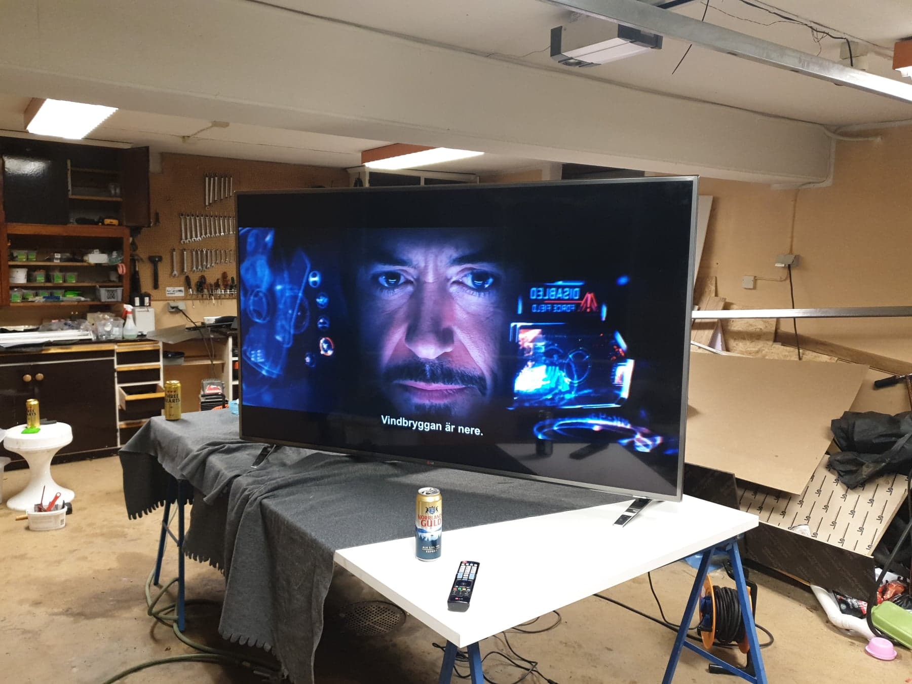

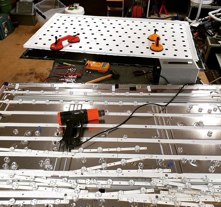

              • bult
                • Jun 2016
                • 2
                • Sweden
                #47
                Re: LG 70LB7100 no backlight after 2-5 min
                I ended upp taking the panel off. The problem was with some of the LED´s. Some were shorted others were open. It was a pretty easy job but time consuming since I ended up testing every LED separately. Gluing the lenses back took some time... And yes, my garage is a mess...
