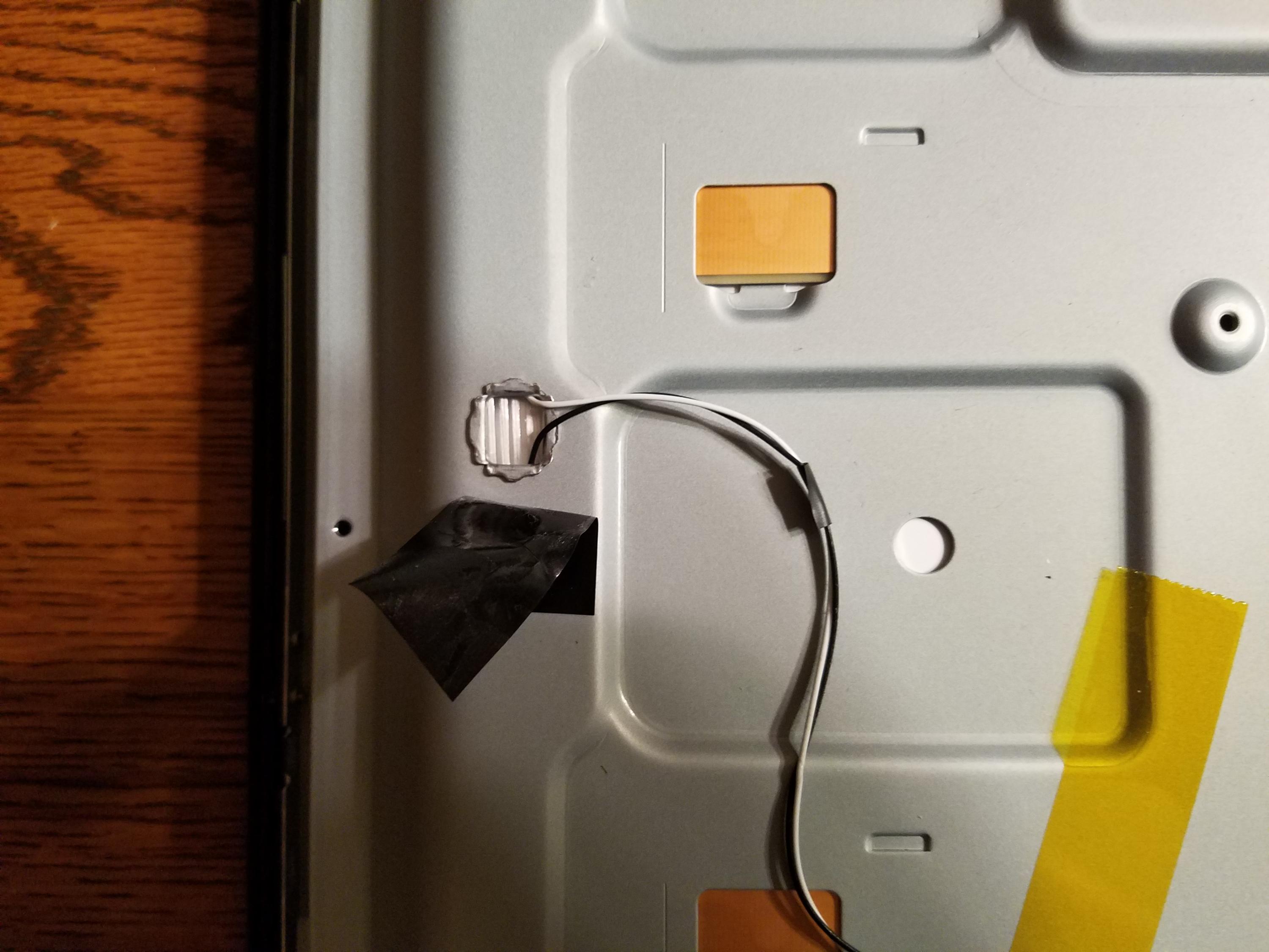

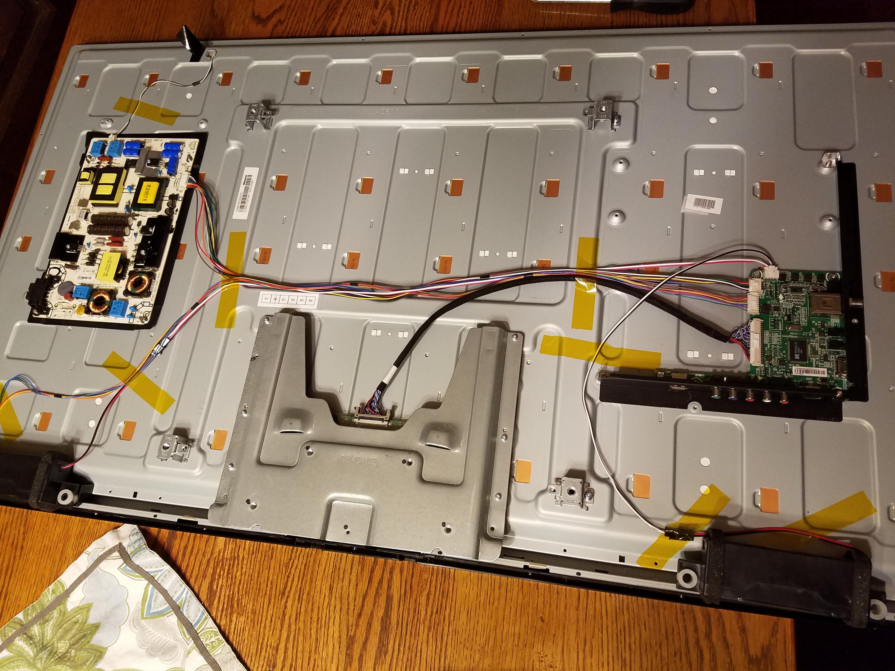

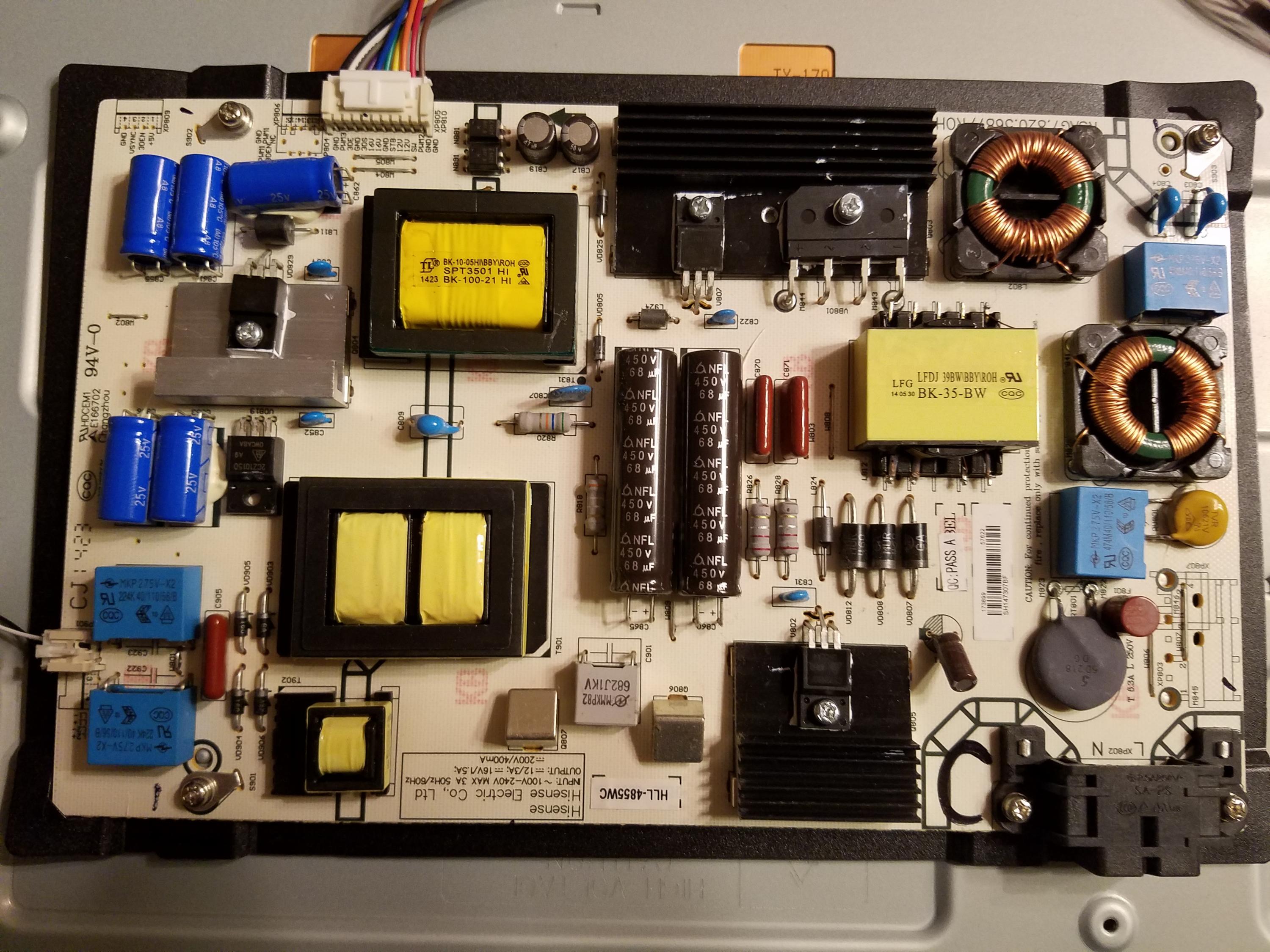

    First thread posted here! I have an Insignia LCD tv that once turned on, the standby light blinks 5 or 6 times and does not have the backlight on. I opened it up and couldn't find a backlight inverter, but rather just a power board, main board and T-con board. I figured that the backlight inverter was built into the power board, so I went ahead and ordered a replacement. Well, it turns out that did me no good so I'm looking for ideas on what else it could be. I popped the front bezel off and had the panel out, but promptly put it back in as I didn't want to mess anything up without consulting you guys first. I figure that it has to be some LED's out on the strips, but those aren't very easy to get at and I'm hoping somebody on here has some experience with this particular set. This TV is just over a year old and unfortunately out of warranty. The power board I ordered is supposedly new from PartStore and fyi when turned on it does pass the flashlight test and the sound does work. I have attached pics of the power board, the back panel and the wires that go from the power board to what I believe are the LED strips for the backlight. Thanks in advance for any tips!
    Re: Insignia NS-48D510NA15 no backlight
    Your TV uses one LED string backlights LED, it does not have backlights Inverter, you can see the small white connector for the LED with Black and white wires that is connected to the power board and another end goes into the LCD panel.
    Before turning in the TV you will leave the black probe on the chassis, and leave the RED probe on the White wire terminal, then turn on the TV, take the reading and wait a few minutes before turning the TV OFF to see how low the Voltage will drop down to, then do the same thing again with the Black wire terminal.
    Do that again without the LED connector of the power supply board.

                      I ended up ordering some backlight strips off ebay and that did the trick for me

                        Okay so I am having a similar problem. I measured the voltage and it is 409v with or without the led strips connected. I am confused by that, isn't it supposed to be 0 volts with the LED connected if they are bad?
                        Any help would be greatly appreciated!
                        • bplatzmarcum
                          • Dec 2017
                          • 3
                          • US
                          I should say black is 409V and white is 0V
                            The black lead is the feeding Voltage to the Anode of the LED string.
                            You have open circuit in the LED string.

                              Hey guys, found this forum after having a similar issue. The TV turns on, sound works, but the screen is all black. It briefly came back to a very dim life after I left it unplugged for a day or two, but then back to nothing.
                              Anyway, I did the multimeter tests and got:
                              Wires Connected:
                              Black Terminal - 399-400
                              White Terminal - 0
                              Disconnected:
                              Black - 398-399
                              White - 0
                              I left the TV for a half hour or so each time and got no variance aside from that one volt.
                              So, I assume that means the LED strip is bad? I ordered a new one and it should be here next week. Any other input or advice on replacing the strip once it comes in? I have a pretty decent crafting skillset, but electronics is not my forte. Anything else you guys can tell me would be greatly appreciated.
