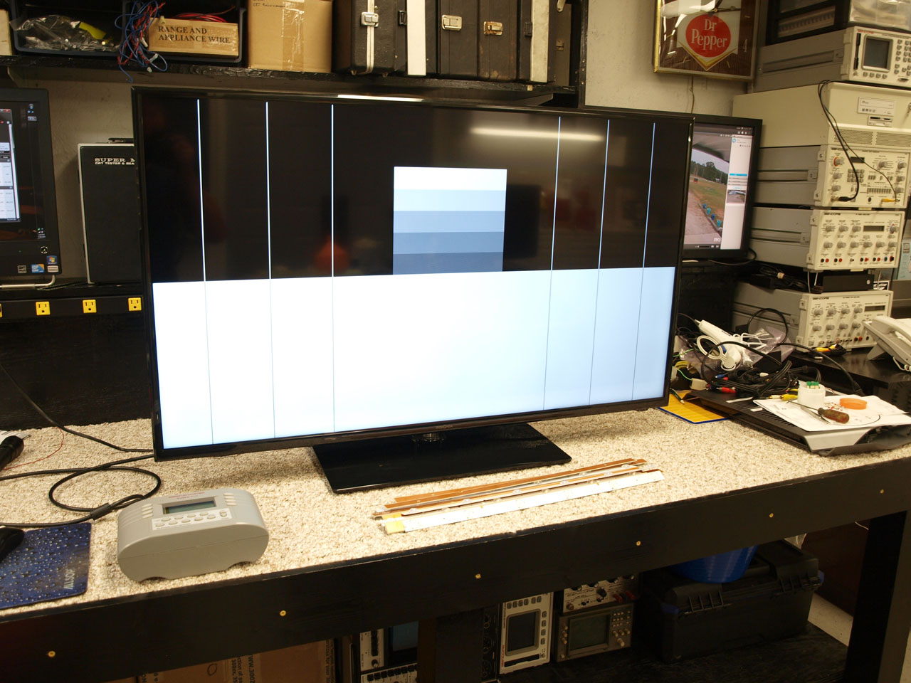

                As mentioned on page 1, its not shutting down, the driver out has ~340v present.....but no lights. FLashlight trick shows image (test pattern).
                Does anyone know how Hisense/Insigna datecodes breakdown? This set is "14D10A".... What is the breakdown for this?

                  If you have voltage present, then an LED has likely failed open circuit in the string.

                    I ordered some strips for this set. Being a freebie, it was worth the $40 gamble, the set came from a clean home....its in mint condition with remote that's not worn & grimy.

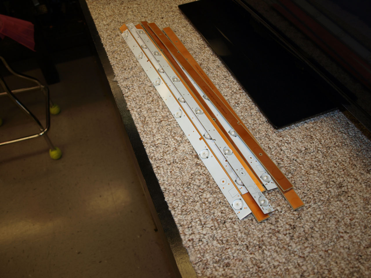

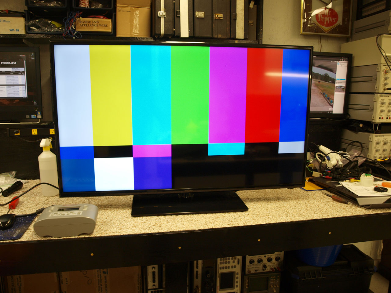

                                  The strips came in yesterday....so today's task was installing them. I won't go into the disassembly & reassembly ordeal or post all the pics I took, as this would be nothing new for you seasoned TV techs (albeit this was my first surgery of this kind on a LED TV).
                                  In the end, it was a success.
                                  The culprits....not sure which is bad...I replaced them all. I did order one of those LED strip testers, I'll play around with it with these strips when it gets here.
                                  Yay!

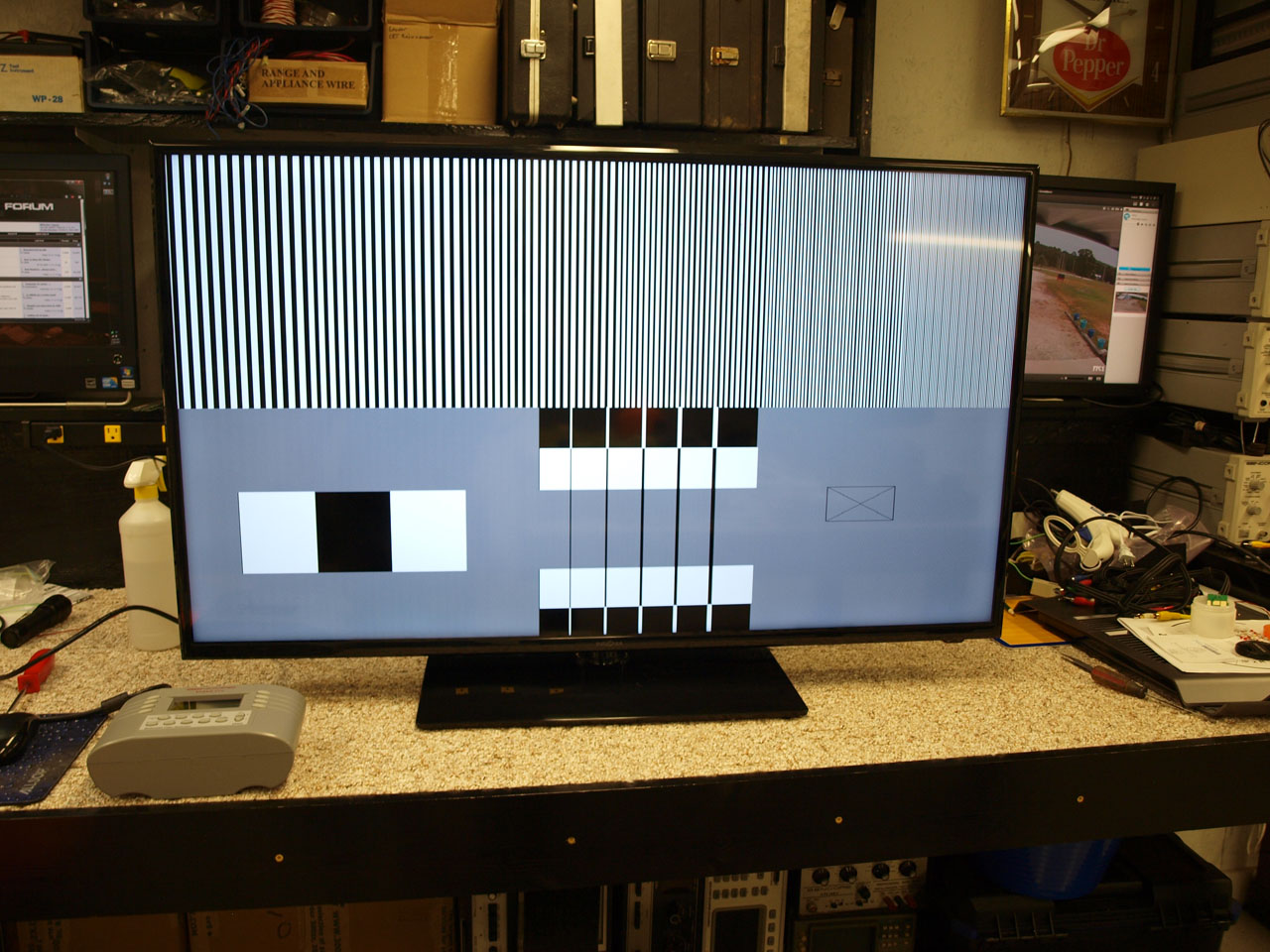

                                        FWIW, I narrowed down the bad strip. Using my bench supply with no current limiting, turned all the way to zero volts with my ammeter in series, I slowly increased voltage until ~150mA was reached on the ammeter....which it appeared to have the LED's fully illuminated. I didn't drive them any harder than that, I didn't want to cook the good ones, I can see some practical uses for these. @ 150mA, the voltage was ~+17v. The 3rd strip I tested failed to light (open)...the other 9 were good and consistent with eachother on power consumption.
