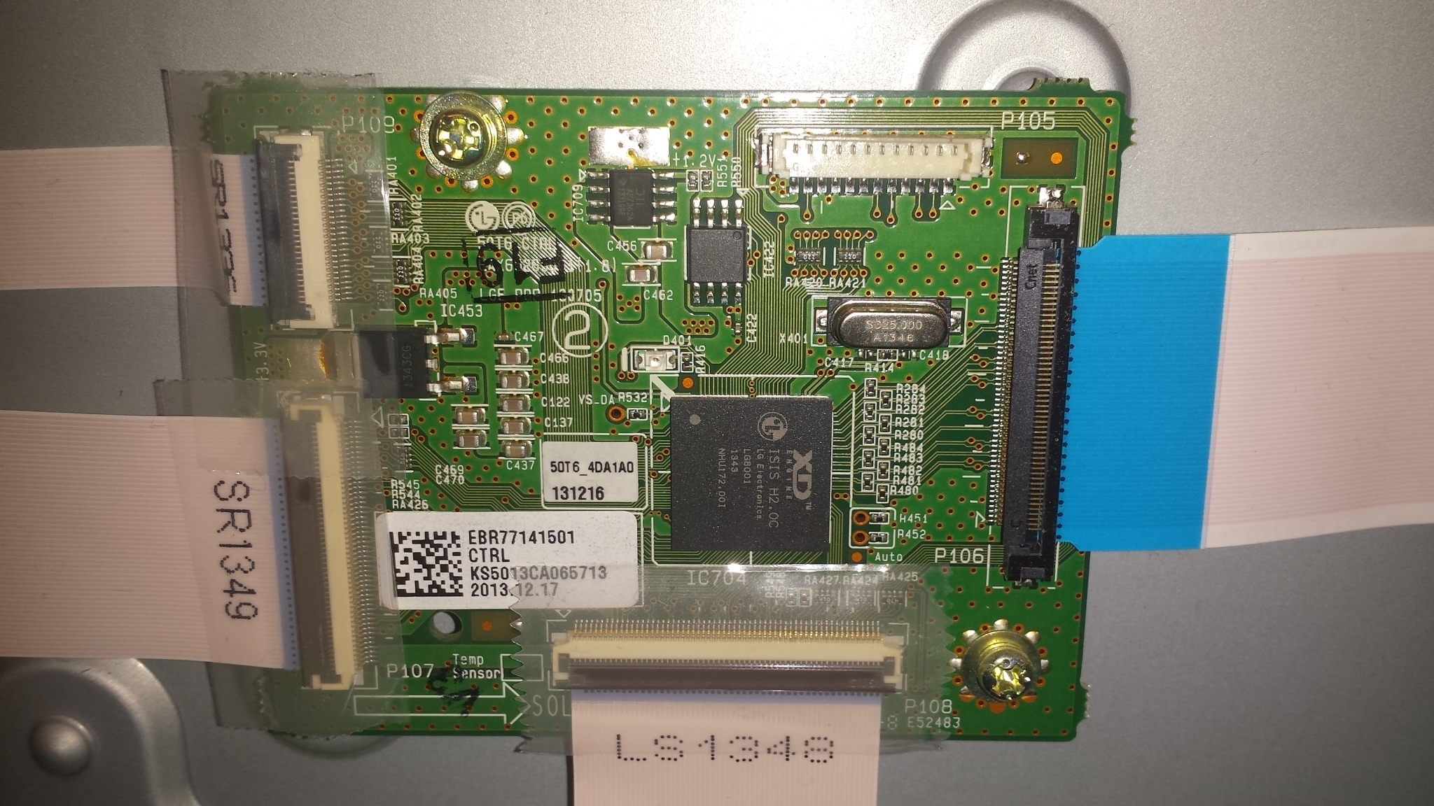

    Lg 50pb560b-ua
    I have the above set with a bad M.B. but a good Power supply. I want to do a screen test to check the panel before proceeding. I could not find a Service manual or a set of schematics.
    Does anyone know how to jumper the Control board EAY63168601 for self test to verify the panel and other boards are good? Do I jumper the two pads
    between IC704 and R451 and R452?

    Re: Lg 50pb560b-ua
    Yes

      Re: Lg 50pb560b-ua
      Ok thanks. I thought that would be it but I wasn't sure due to no
      Service Manual, Schematic. I will do it tomorrow. Thanks
