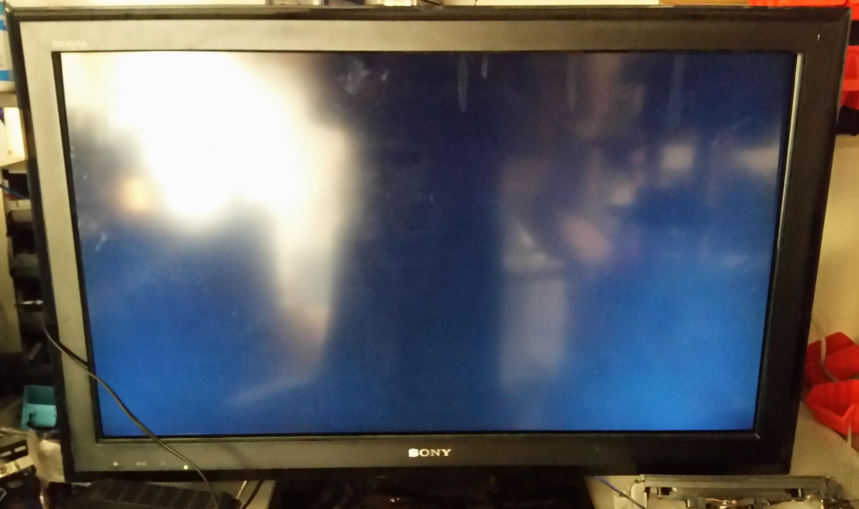

    Hi to all
    Long time reader first time poster.
    I have problem with the Sony KDL-37S5500, Main Board 1-878-999-22 A-1641-831-A. PSU SONY PSC10270F 3H267W.
    First the image looked like washed I tried to reset the cable on the T-con Board but nothing cnanged.

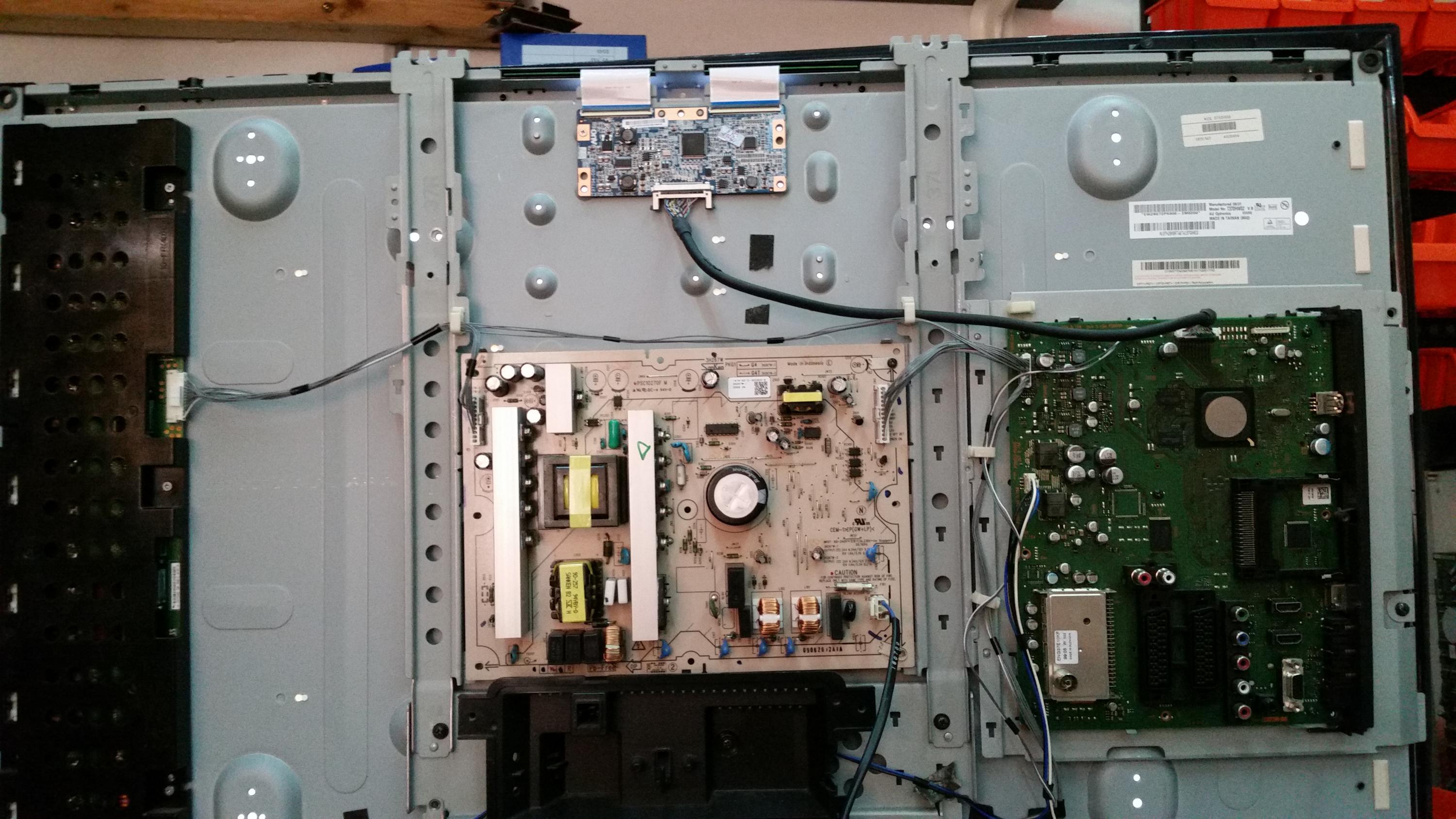

    Can you post some sharp pictures of your boards and the layout which would help us help you. Have you tried to do an firmware update.

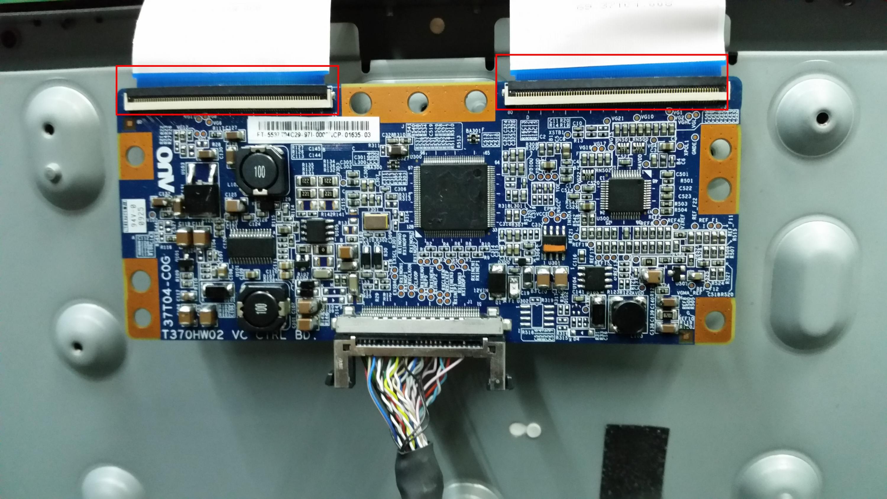

          Pictures from the boards
          http://imgur.com/a/3R5Kr
            Re: Problem with Sony KDL-37S5500

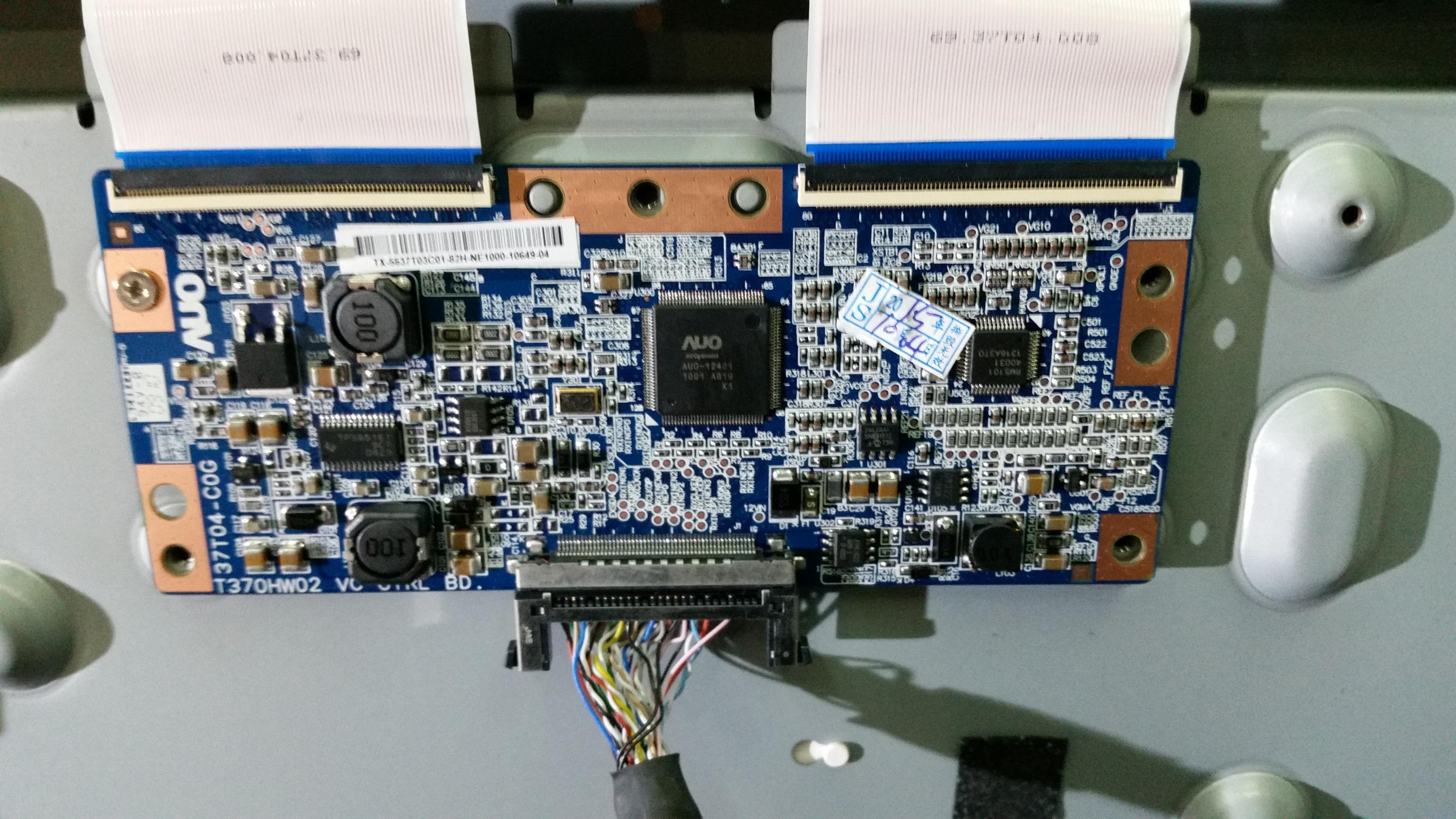

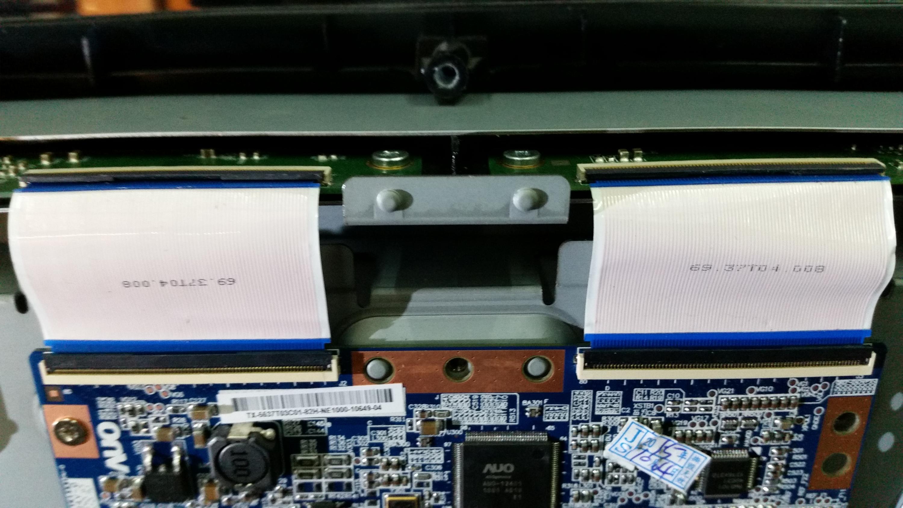

            You better check those cable conductor traces to see if they are damaged, since the problem got worst then you need to recheck yours works with all the old board back in place.
            I can see that the flex cables between the LCD panel and the T-CON board are in crooked and half way in! You don't see that?
            BTW, the washed pictures is more likely due to bad U500 GAMMA IC
              I put the board just tu take picture.When i reseted the flat cables the first time when the tv had picture, i disconected one side and half of the panel went black.
              Now nothing is changing wit ore widout T-con conected when i turn on the tv
              The n flat cables are ok, chackt good
                    Can you seat all cables correctly for us and then take a picture for us to see?
                    Understand that you may of been a long time reader but not a poster - You may/may not know how to insert the cables correctly but either way we ourselves have no idea what your skill level is So we have to assume you are new to working with such devices.
                    I agree with above - Your initial issue would of been the AS15 gamma IC.

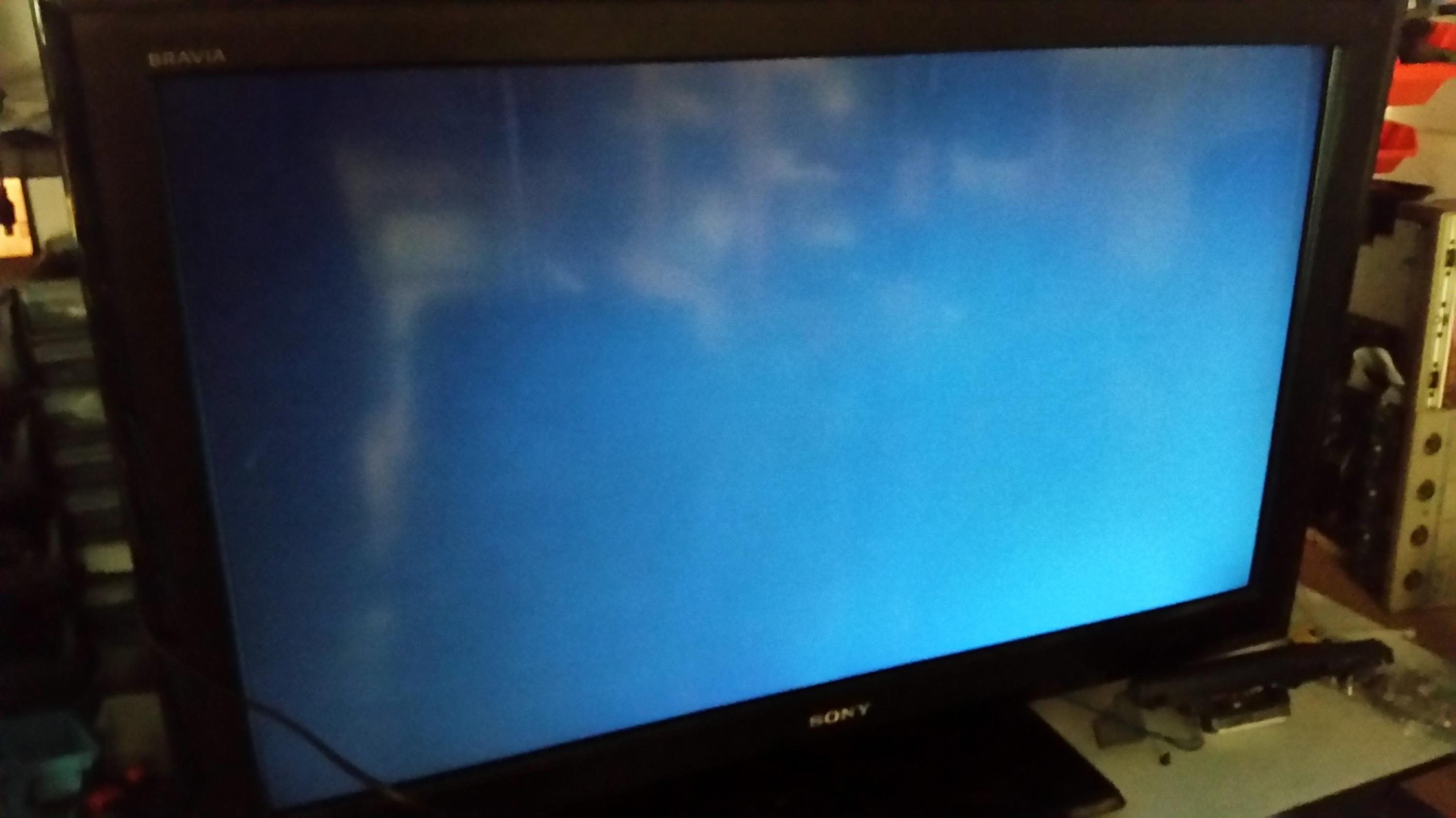

                      Sorry for the misunderstanding and waste of time.
                      Pictures.
                      On pictures 4 and 5 is the screen when the tv is on

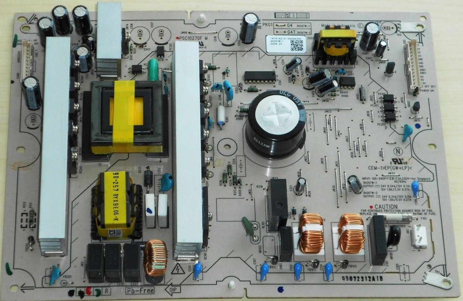

                        please put back all original boards MB and T-CON. and let check why yours PSU over clock the 15 Volts to 17..etc.
                        disconnect the cable between MB and T-CON from the MB side and tuen on,, check the 15 Volts remain High or back to normal.
                        if remain high put back the cable above and try to disconnect the IR section MB and check the 15 Volts again.
                        if it remain high put back IR and disconnect the speaker and check.
                        between the ribbon cable the right side one,, look bad
                        this is ur PSU
                          https://www.badcaps.net/forum/attach...6&d=1467208983
                          Are you sure those cables seated properly? They still do not look like they are all the way in or straight at both ends of the cables. The Right one does not look well.
                          https://www.badcaps.net/forum/attach...0&d=1467208983
                          Is that what you see on the screen before you start changing the boards?

                            Are you lifting the tabs to insert / disconnect those ribbon cable?
                              Diah i measured everything you suggested no changes on the 17v
                              i tried with other T-con and mb same 17v.
                              The cables are connected good i reconnected them 50 times in the last 3 days
                              The icture of the screen is after i changed the t-con.
                              First when i started the tv the picture was like on this video just more intens.
                              The video is not mine, i hope that is no problem.
                              https://www.youtube.com/watch?v=4nYQfE2yBJ0
                                do it for the 51 time, but this last time please inspect their pins with Magnifier, also with DMM as diode peep on methods between both end sides.. there it may one pin Brocken.. please check this for yours sake of spending time.
                                • dr-mr
                                  • Oct 2014
                                  • 11
                                  • Macedonia
                                  I chacked the flat cables under magnifier with strong light and with continuity test on the multimeter, thay are ok.
                                  I hawe another lvds cable, i changed it, no changes with the tv
