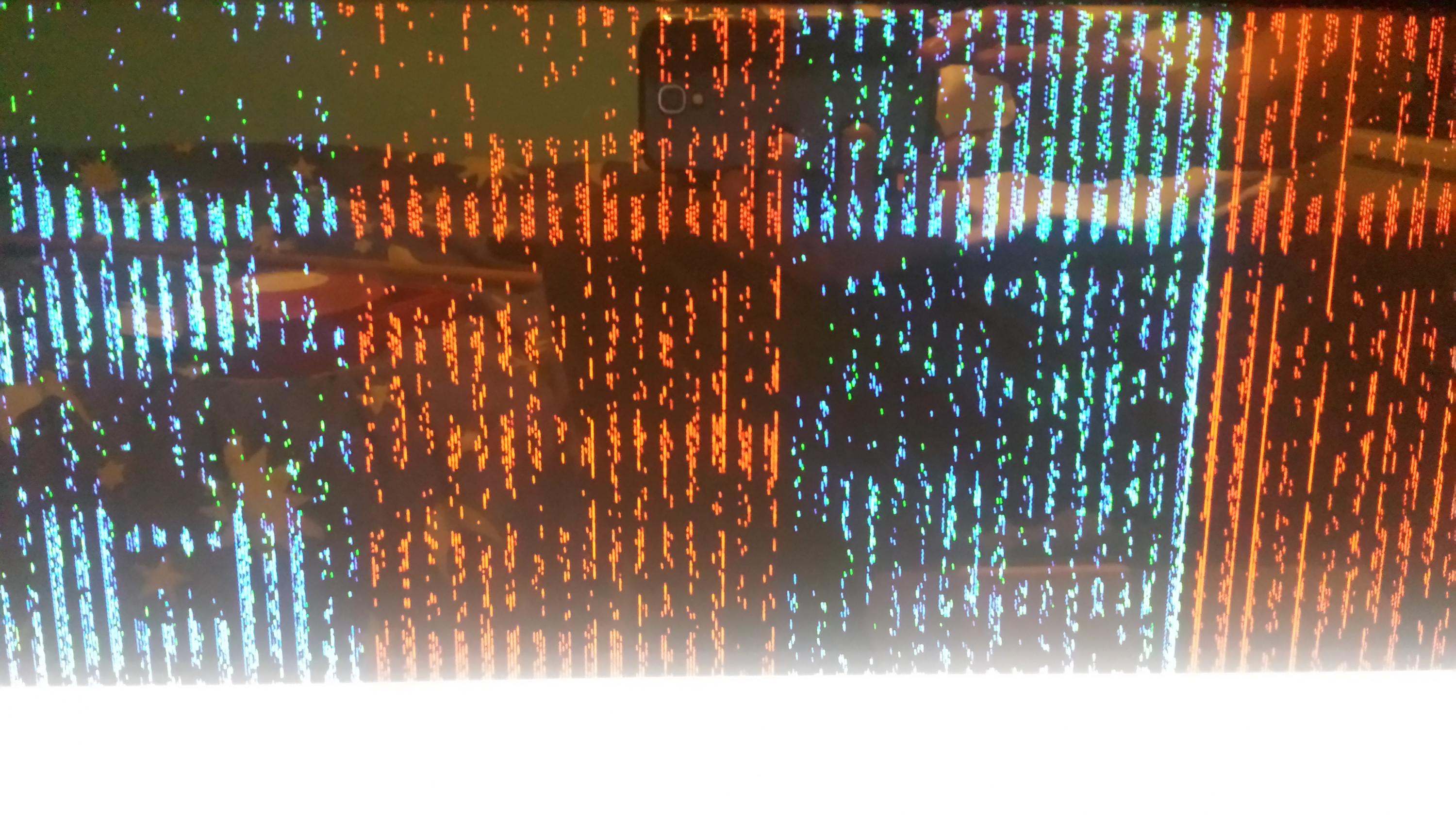

    I have an issue with this plasma TV. When switched on from 'cold' the first 2 minutes of the image is obscured by vertical wide red and blue columns, as can be seen from the attached photo. This is the same for all inputs.
    Can someone please advise which board is causing the issue.
    Your help would be greatly appreciated.
    Thanks in advance.
    Delphi

      A-board, one of the BGA chips has broken solders highly likely. Trying warming that board with a hair dryer before you turn it on and the problem may not be there on startup but either you'd have t replace the board or find someone who do do BGA work.

          Thanks for your help. I was hoping it wasn't the A board, as they are impossible to find. I'll do the confirmation tests as suggested and let you know the results.
          Once again, thanks for the quick responses.

              Thanks for the tip. The TV is fine after 2minutes. I'll first confirm issue with hairdryer and then remove the board and clean it up, maybe run solder iron over it. Oven idea is very interesting.

                Okay...So I managed to get a replacement board off E-bay. I put it in last night powered up and it looked like the bars had gone. However, it only stayed powered on for 3 seconds after which it went into standby with the red light flashing a sequence of 4 flashes. Tried powering back on...Green light flashing quickly, then back to the red light sequence. I dropped the old board in and the same thing is happening! Arggggg!!

                  Check the SS board RJP30E4. Also check SN board especially the recovery cct where the SS connects to.
                  Vsus most likely shorted.
                  I'd replace the M81735P driver on the SS too for good measure if those IGBTs are shorted

                      Just a quick query, I gather the 4 blink code, which relates to power supply board issue is being caused by the short circuit on the other boards? I suppose if disconnecting those boards, if the led blink remains 4 blinks then it would be a P board issue.

                        Okay...so I disconnected the right side board and still flashing 4sos. However, after reconnecting right side board and disconnecting left side board I get 2sos. So does this mean that the left side board is duff together with the A board? Thanks

                          No idea. Disconnect P2,P11,P35, the 3 white ribbons at the A-board, turn it on and see if it passes.
                          Turn it off and don't reconnect P35,P2,P11 for a good 5-10 mins for the residual voltage to drop as a spike especially P35 can damage the panel.

                            Okay...I disconnected the 3 ribbons to the A board and still get 4 flashes. I checked the resistance of the SC and SS main voltage input terminals and can confirm there are no short circuits. Maybe the supply to the A board has been affected? 15v or 5v??

                              Sorry, I didn't disconnect the P cables. It passed the test and remained a stable green light.

                                  That would mean either sn or ss. May not be dead short but low enough to trip 4 blink and it would not take much to check for shorted transistors on either board

                                    What does P35 supply? Can I connect P35 and power up to see if it still passes the green light test, which would definitely condemn the SN/SS boards? Unless, P35 is an auxiliary supply for the SN/SS boards? I'll do some more measurements, but am thinking more likely to be the SN board. Will get back with my results, when I get the time.
                                    Thanks for the invaluable help so far. It's a shame it had to come to this, when the original problem I could have lived with.

                                      p35 powers the panel through the c boards and ribbons. You probably could do that but be warned if you disconnect or reconnect whilst there is any residual power(stored in the caps) and spike , good chance the panel can be damaged.
                                      Highly unlikely that is your 4 blink. You could hook it all up and disconnect p2 and if it went 7 blink then the 4 blink was the SN board, if still 4 blink then disconnect p11, reconnect p2 and see what happens there

                                        Thanks. I've been doing some resistance checks on the semiconductor devices, such as the RJP30E's on the SS board and D461, D725 and Q441 on the SC board. When we talk about 'shorts' are they straight 0ohms, or is 0.17ohms - 17ohms okay? I'm testing the devices in circuit. Thanks for the P35 explanation. I will try the P2/P11.
